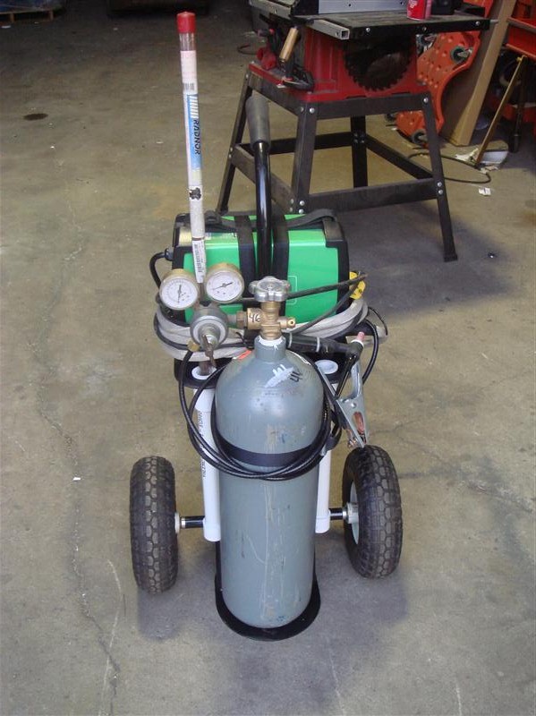

    I'm going against the grain! I hate flux core wire! I use copper wire and drag the bottle and welder using my cart made from a cheapo northern tool dolley. The good thing about the Imig is that you can do both mig and stick weld.

    Portability is nice.
    You can either get a small C25 bottle for that purpose or you can also get a very small CO2 setup that uses paintball cyls that you can have filled at a lot of sporting goods stores and stuff. Not as clean as C25 but super portable. Have a look.
