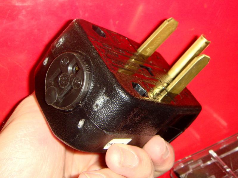

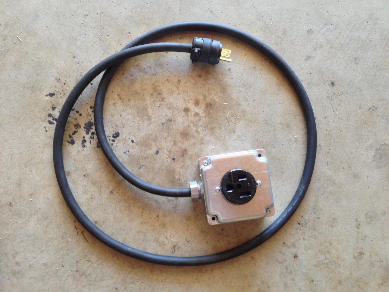

    Pieces of the puzzle falling into place........... fab'd a 220-115V adapter. I've got a 100' (very beefy) extension cord I'll be using for this repair. I'd probably get at it but it's BLAZING outside and much more enjoyable to be surfing the web with a cold drink by my side. Did I mention I was retired???

    Just a heads up. Be sure you have the hot and neutral on the correct poles on your adapter. It is kinda counter intuitive as to which is which because the blade/color standards are different between 240V and 120V. You want to make sure that the neutral is on the white wire of the welder, which will be the narrow blade on the 240V plug but the wide blade of the 120V plug.
  3. #43
    Thanks, that's the way I wired it.

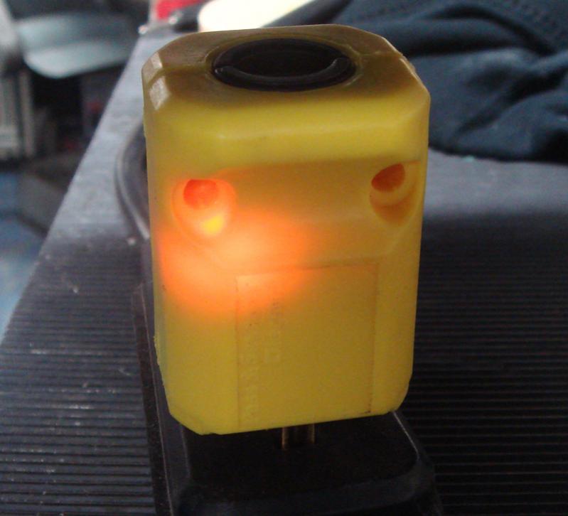

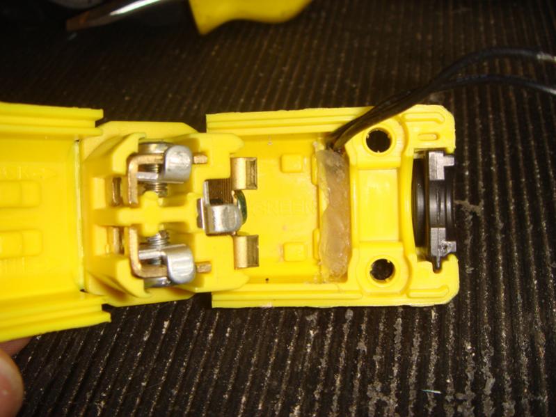

    Not sure if they have made that a feature, yet. From what I gather the welder checks to see if the white is hot, if it is it switches to 240V mode, if it isn't it goes to 120V mode. So if you swap them, it thinks it's on 240V, but running way under voltage and not good. There are real old posts about it damaging the machine. Nothing lately, so no idea if they added something to idiot-proof that. I put a small neon bulb in my plug so I could see that things were good before I powered up the machine. With something portable, you never know when you will run into a mis-wired outlet.
ID:	10569 Click image for larger version.
    I made my adapter the other direction to keep things compact, and allow me use the same type extension cord for 120V or 240V. Less stuff to haul to a jobsite.
    snip..............
    snip..............
    I take it your adapter is 220 (at the wall or extension)--->115. That's a cool idea ~~~~
    Didn't know the "automatic voltage detection" worked that way. Thanks for pointing that out.

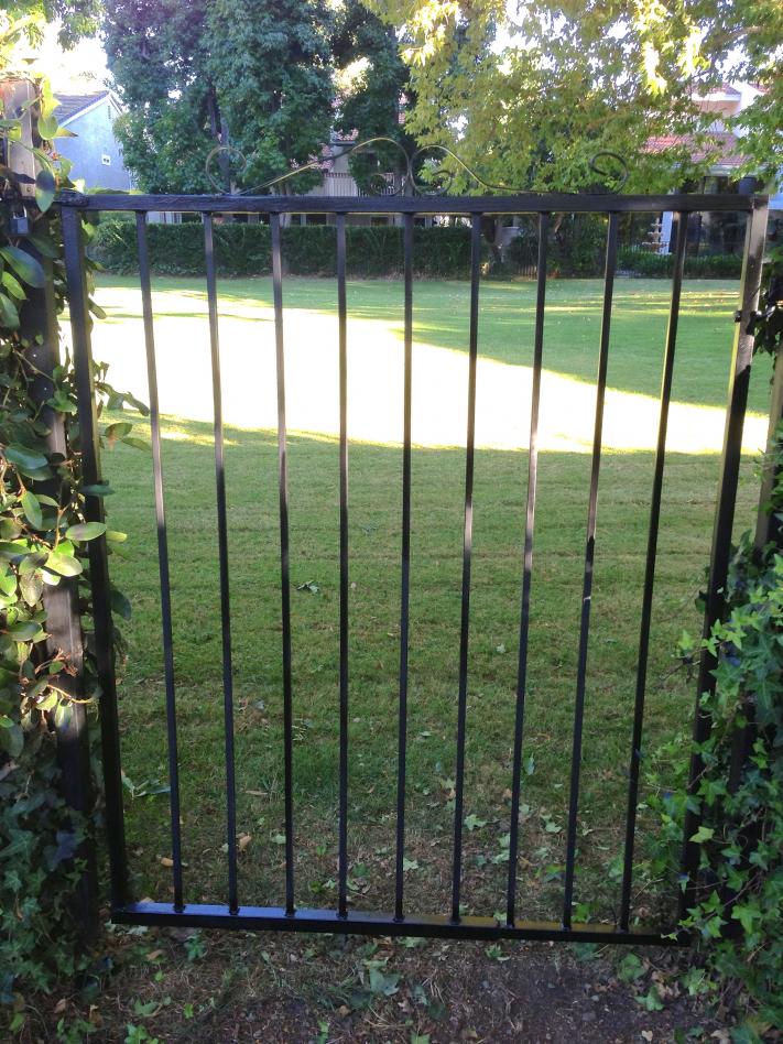

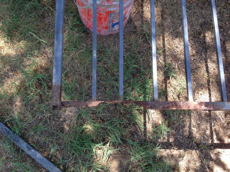

    OK, I finished the gate repair ............. still have a bit of fence to repair though.
    Here's the before and after pics:
    and the after:

    One thing I found (big surprise!) is that welding rusty thin wall tubing is hard! i.e. easy to blow through. In all honesty, I'm thinking this is a temporary repair at best and hopefully the ivy will help hide the rest of the repaired fence.

    Looks good. You weren't kidding about rusted. That was pretty bad. The best thing is to just cut it back far enough to get a little something to weld to. Was it all at the bottom from sprinklers? If so your repair should be ok provided they keep paint on it. So what did you end up using, MIG or flux-core?
  10. #50
    The rust was mostly at the bottom but there's one top rail that needs replacing. It turns out the flux-core wire feed worked GREAT!
    Glad to hear it- I'm a little surprised to hear the flux core wire worked, since your material was thin. Guess I'll have to expand my expectations and try FCAW on thinner stuff.
  12. #52
    I turned the voltage WAY down to 15v and the wirefeed at an indicated 90. It almost felt like was "soldering" at that point.
