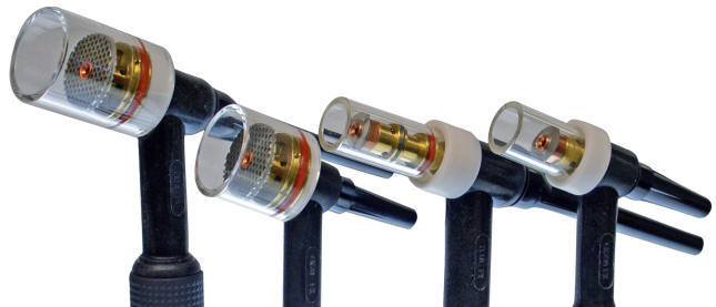

    semi-recently, I upgraded to a CK Worldwide 130 series flex-loc torch and LOVE IT! It was much easier on my hands for welding thin walled tubing for car projects (SS and AL).
    Although this torch + Weldcraft #12 cup w/ large diameter lens is better than the huge wp25? Everlast torch I had before, the #12 cup (1 & 7/8" length ?) is still too tall (long) for this ck 135 series torch. It forces me to tilt the torch away from the material at an awkward angle just to fit the cup an appropriate distance from the metal.. So, that hand position of angling the torch away from the metal makes it challenging to hold steady. With smaller cups, this problem is gone, but I don't get the good gas flow of the #12.
    If I had a shorter #12 cup length, the torch would be more parallel to the tubing, thus easier to keep my hand steady, thus better looking welds .
    So, do you guys know of any GOOD new stubby #12 welding cups that work with large diameter gas lens and still provide good gas flow? I ask because I've heard in the old stubby ("short length") cups didn't provide as uniform gas coverage compared the full length #12 cups. I was hoping some new better designs exists, so do you guys know of any?

    The teflon is a heat insulator. It protects the torch from the heat of the cup. With thin wall tubing and that giant cup I rather doubt you build too much heat. so you could probably trim some off, especially with a water cooled torch. It sounds more like you need more practice. That kind of welding is done day in and day out with nothing larger than a #7. Also the main reason to use a gas lens is to allow longer tungsten stickout. With the setup in your picture the tungsten could be out at least a quarter inch from the face of the cup, so you would have a lot better visibility. I don't see the tungsten at all. It also takes a lot of argon for that setup, to get proper flow velocity.
    CK makes what you want... but I agree with Rambozo.

    Gas Saverâ„¢ kit part numbers (pdf) http://www.ckworldwide.com/gas_saver.pdf
    The reason to use a larger cup like this isn't for better gas flow but for higher amps and larger tungstens. Actually, a larger cup without a gas lens makes it MORE difficult to establish a good gas flow. Turbulence is increased. The weld examples that are in the background look really unsteady, and my guess is that it's because you are loosing sight of the bead with the cup... A gas lens has been proven over and over to provide better flow patterns and coverage, and to provide gas coverage to the surrounding area even. If you want to use a stubby gas lens (9/20 series) then that makes more sense to me because you are going into the opposite direction of sound welding theory.

    I just picked up a #8 cup to use with my small gas lens, so will be testing it today. As far as hand comfort goes, it's MUCH better than the #12 cup I was using .
