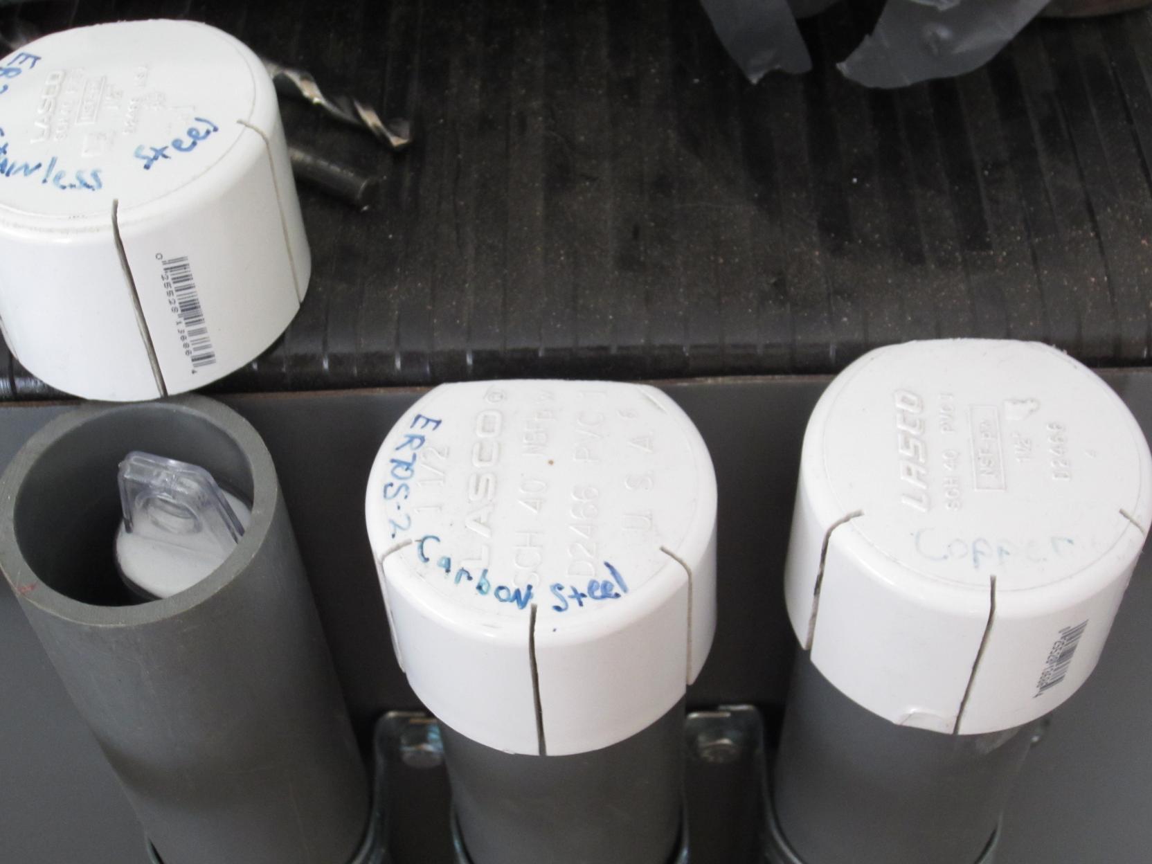

    I used the grey 1-1/4" PVC on my welding cart with slip on end caps, and glued the caps on one end while simply notching the other end's end cap. Once I figured out that the un-notched cap wouldn't remove without pliers and swear words, I notched them. They come off easy now. I keep the tubes that the filler rod comes in though and I simply slip those tubes into the PVC. The cool thing is the factory filler rod tubes will hold around 3 pounds of rod, so you can pile all of the different diameter rod of the same kind (say 309L or ER70S2) into one tube. Same basic idea though. I think I have 5 or 6 tubes on my cart at this point, so there is plenty of rod storage!

    That makes perfect sense with the notching of the caps Andy,thanks for the insight I shall do the same .
    You're very welcome! I originally sanded them so they "popped" on and off easier but after I left them overnight, I still had trouble removing them the next day. Live and learn, I guess!
    Interesting. I'm glad I saw this post as I'm sure I would have just tried sanding them as well. Thanks!
