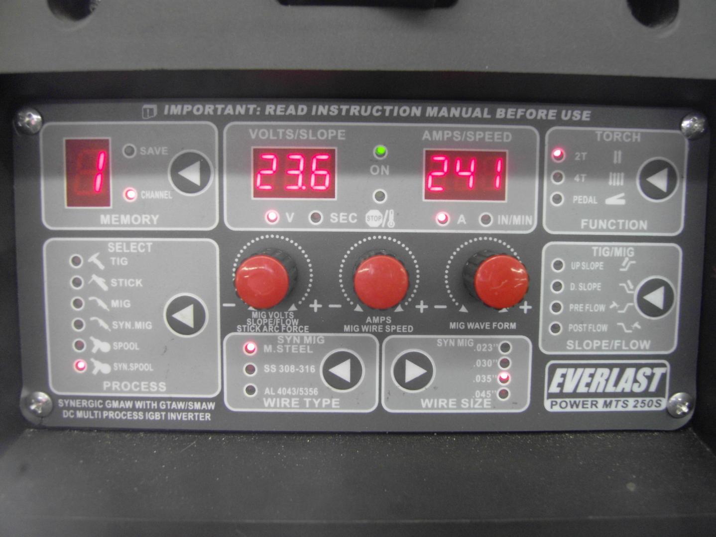

    Code 802.
    I keep getting code 802.
    Start machine get 25.9V in Syn. Spool wire set to .035.
    Start welding for about two seconds then the spool gun stops.
    Machine has code 802 shut off machine restart volts 25.9V or 26.0V weld two or three seconds then it stops again.
    Restart machine get 25.9V use selector go through everything back to Syn. Spool now volts is at 23.6V welder work and does not shut off.
    Restart machine get 25.9V start welding for about two to five seconds then machine quits welding and code 802.
    Restart welder get 25.9V use selector go through everything back to Syn. Spool now volts is at 23.6V change to 25.9 it welds O.K. select any wire size everything work. Shut of welder restart 25.9V any wire size machine welds two or so seconds then quits then I get code 802.

    Overcurrent. Check your exact input voltage. If it's a little low it can create a higher amp draw at higher voltages. Also can happen at higher volts/lower volts if your wire is on the metal when you pull the trigger.
    My in Voltage is 242V to 243V. Also just remembered it spray welded before and now it will not do it when it was spray welding it was very quite and no splatter now it has fine splatter spray. I will test Voltage will I weld to see if it changes that the input.

    What is the 802 error code? I don't see any codes listed in the manual. On-board diagnostics are great, but only if you have the key.
    Just overcurrent of the input or something more specific? Is there a list of codes somewhere?

    Figured out one problem it seem to be the Spool gun why I do not know. Change to the Mig gun and see pics.

    Will need tech to figure out what went wrong with the Spool Gun when it is plug in and the machine is turned on it goes to 25.9V or 26.0V every time but in other setting they stay the same.
    I've never tried spray arc before but it seems like low wire speed would cause the melted tips.
    As a test to help narrow down things, does the spoolgun work in the non-syn mode?
    And how does the wirespeed control on the gun work?
    I'm thinking that if the pot for wirespeed on the gun is bad, then in the SYN mode, the welder will get bad data and make changes in voltage to try to keep things in sync.
    But that still doesn't explain your error code.
    The wire speed controller work you can change the speed will it is running for a short time then it stops.
    It works in none SYN mode but can not get it to spray just weld with fine splatter for a little longer then in SYN mode then it burns the tip also the wire speed is at full can not go any faster.

    Sounds like it's in the spool gun for sure. I would still say that there is an intermittent open or short that is giving the SYN mode fits, and causing it to crank the current through the roof to try to compensate. Maybe something as simple as a bad wiper in the pot for wirespeed. In non SYN mode you might not notice the wire speed changing if it was only a few milliseconds, but the SYN mode would react to it.
    Too bad your other spoolgun isn't the same, that would let you verify things easy.
    Have you turned your burn back OFF for aluminum? Also have you fine tuned any in synergic mode with the spool gun? You likely will need to retune some, depending upon a number of factors. But honestly, I'd go to a .045 for the .035 aluminum.
    Rambozo, synergic doesn't work by reacting.
    Are you using pure argon or argon/helium on aluminum?
