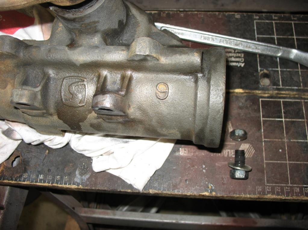

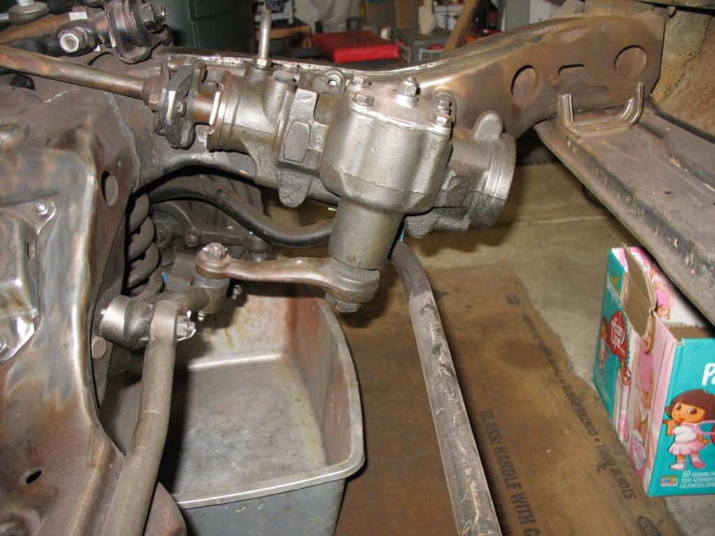

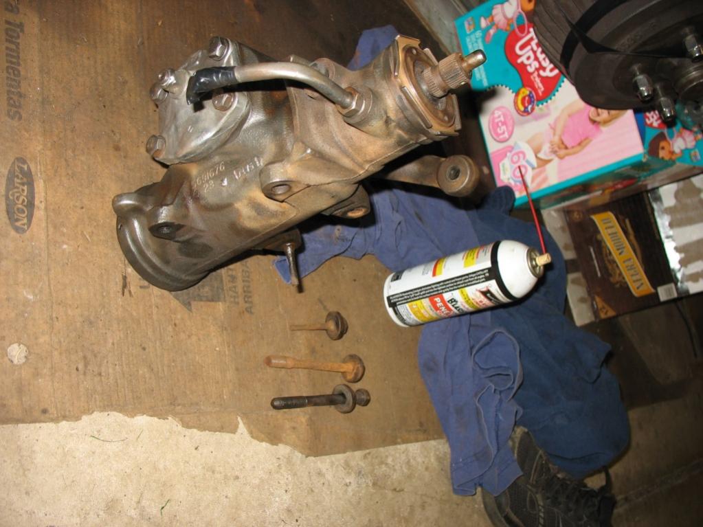

    I've got a 67 Cutlass Supreme Convertible and am spiffing up the engine compartment. I decided to take off the steering box. It's bolted to the frame with 3 bolts. 2 bolts came out whole and 1 didn't.
    Starting Point:

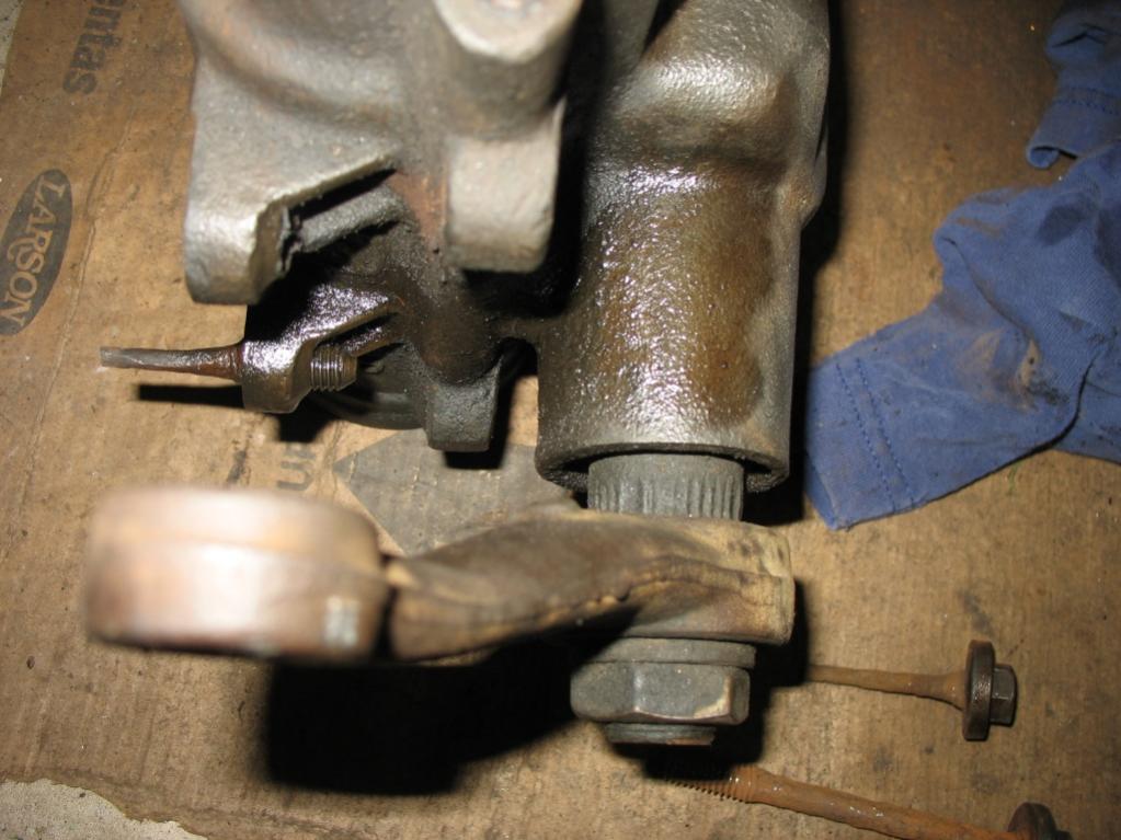

    After removal.
    There's the 3 bolts - 1 good, 1 partially rusted and one in pieces.

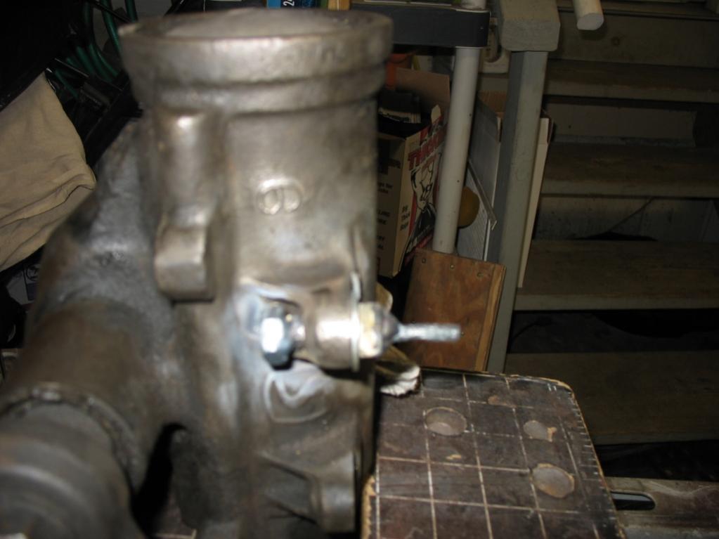

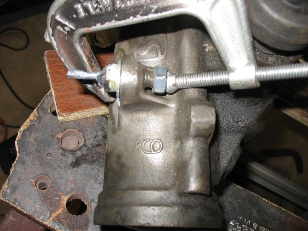

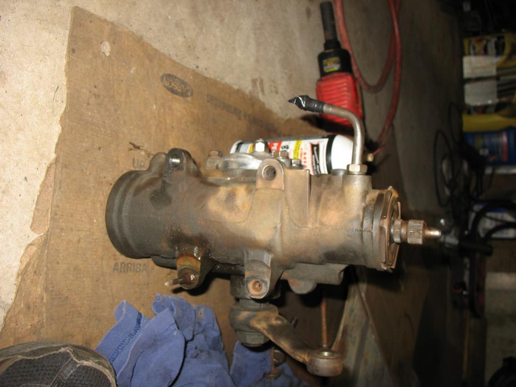

    What's left in the steering box.

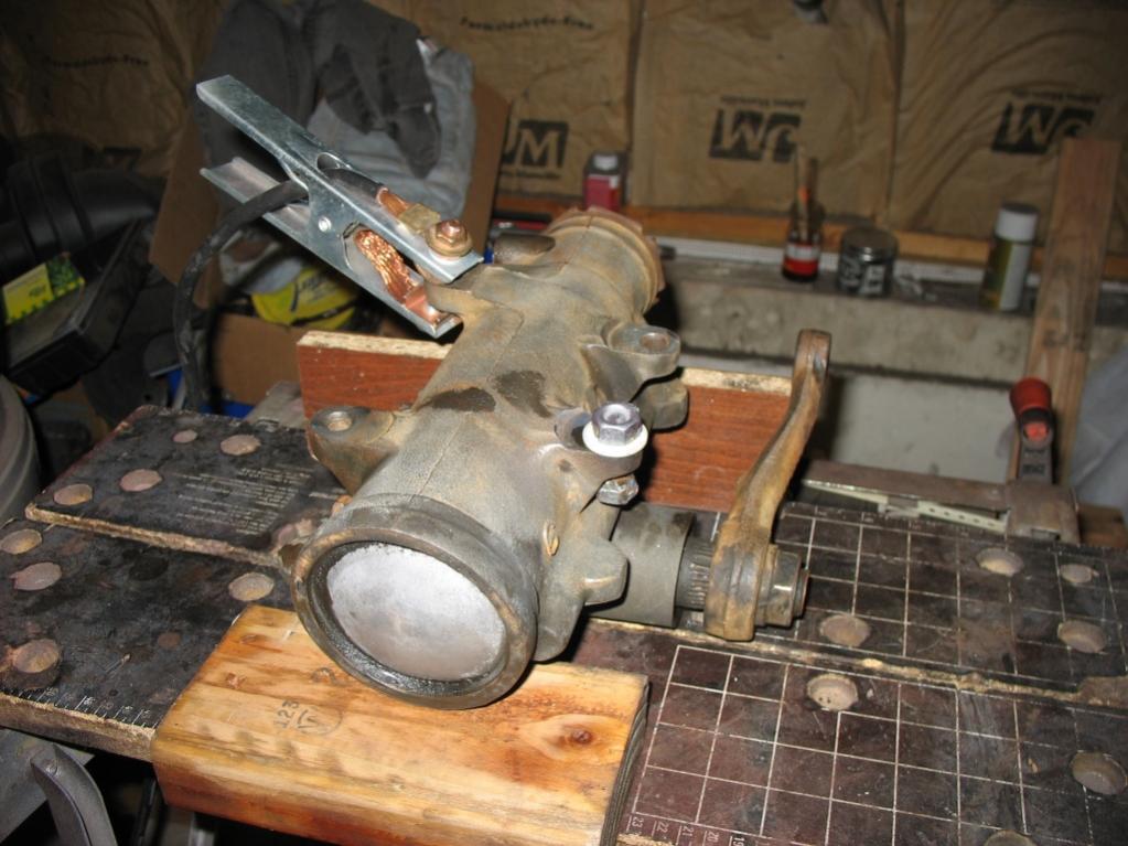

    Putting on a nut with a washer to weld to the bolt.

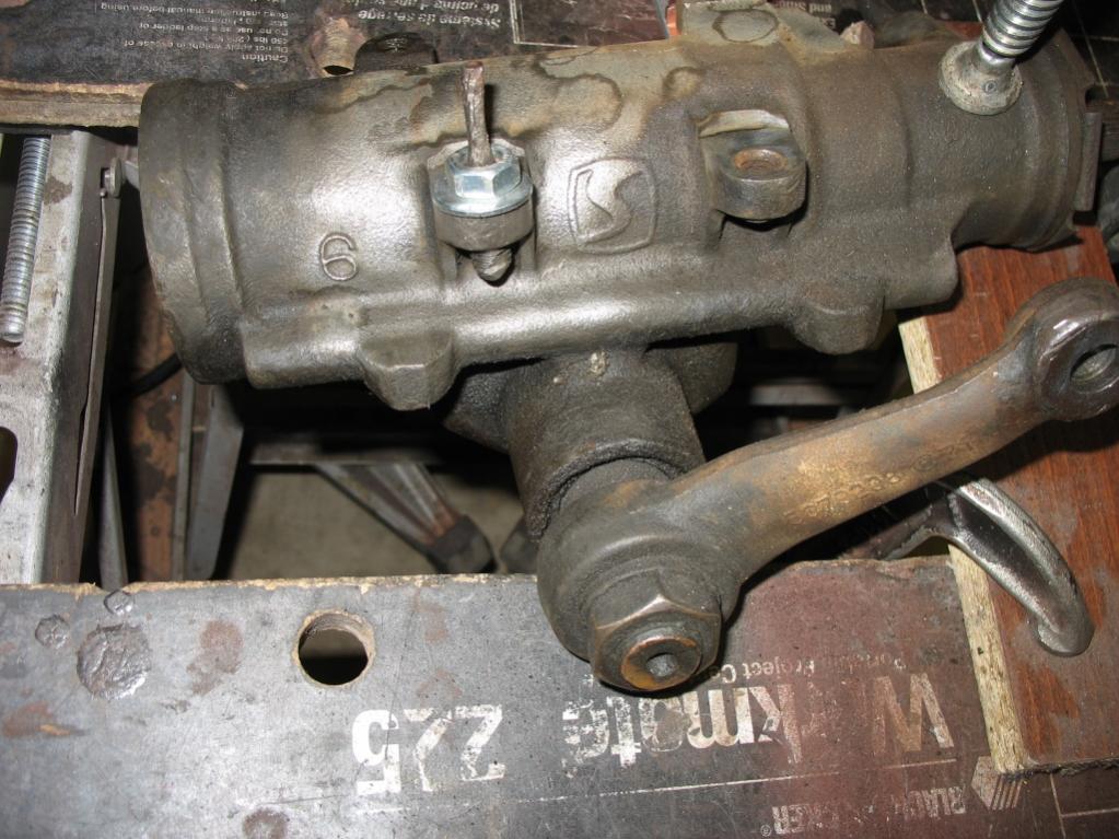

    Putting a nut on the other side in hopes that I could put a wrench on both sides.
    After nuts are welded on both sides.

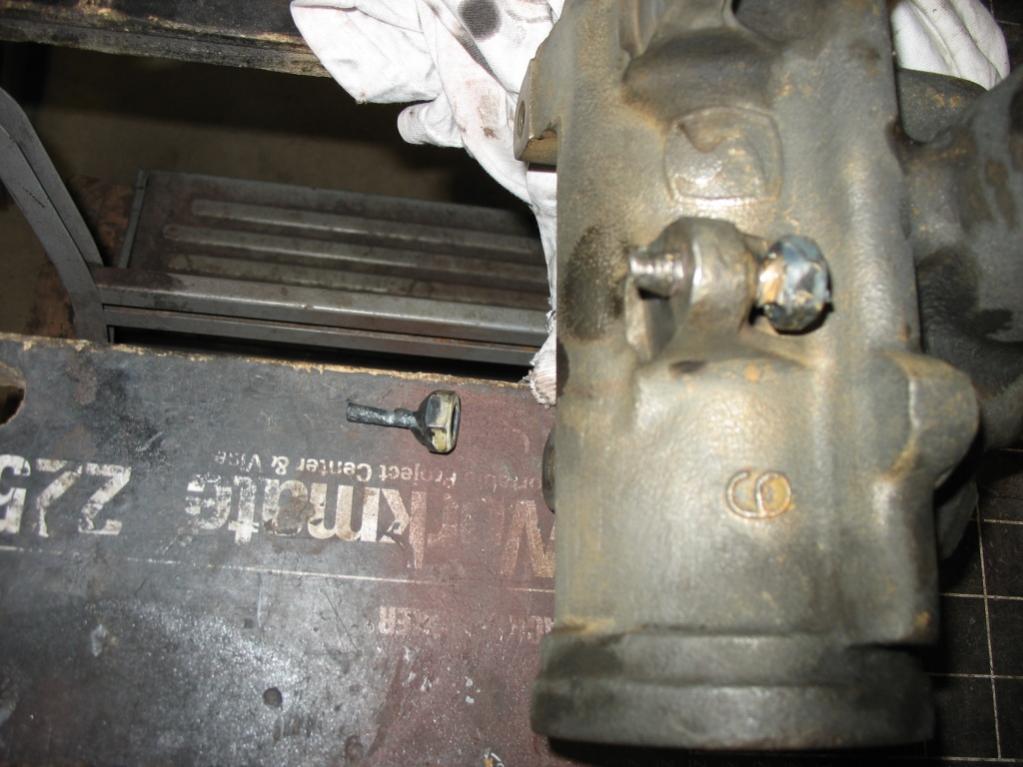

    One snapped off.

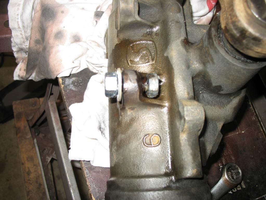

    Weld another nut on.
    Yay, the nut on the left is turning!

    And here's the end, with the bolt removed! I used a cut off disk in a dremmel to cut the bolt with the nut on the right.
