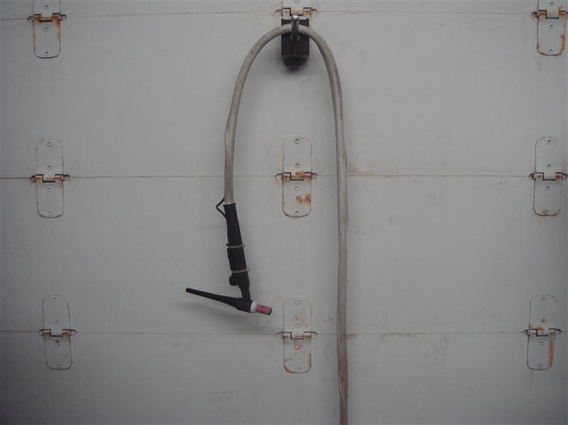

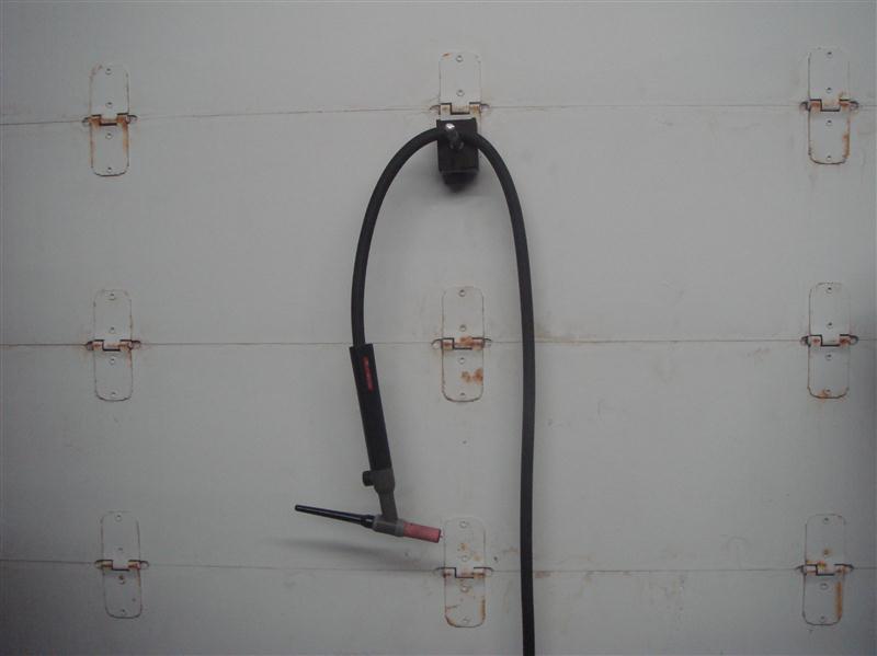

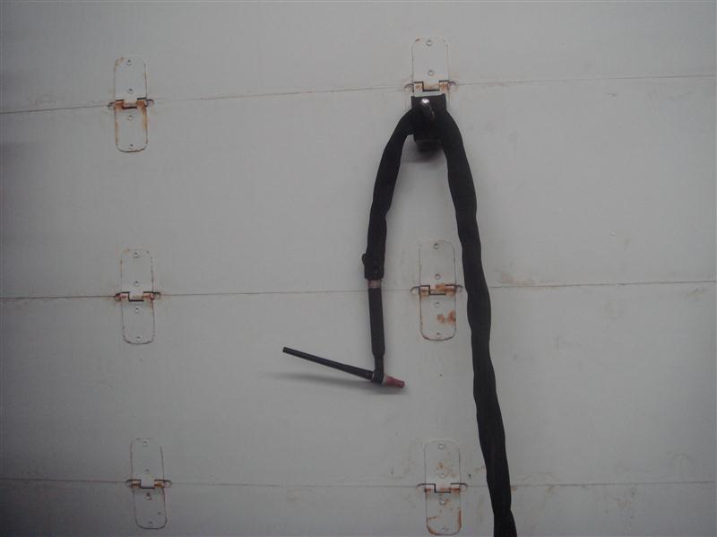

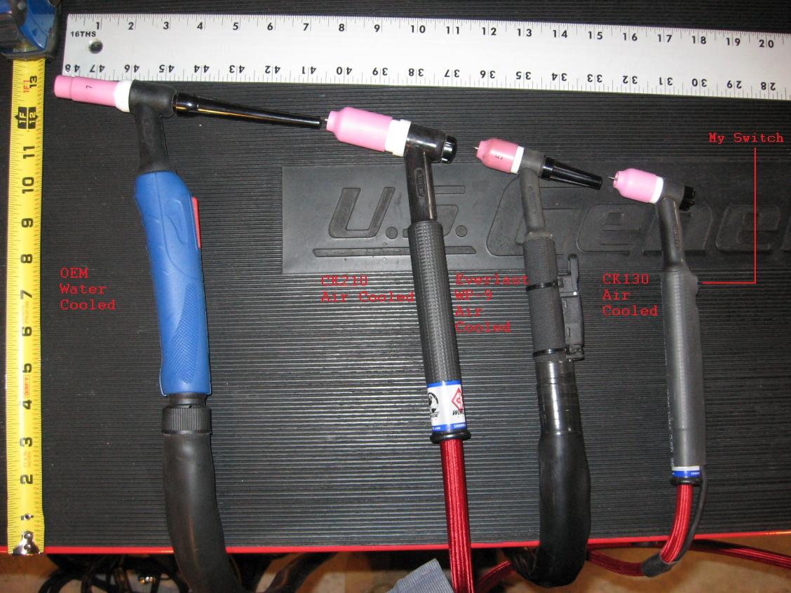

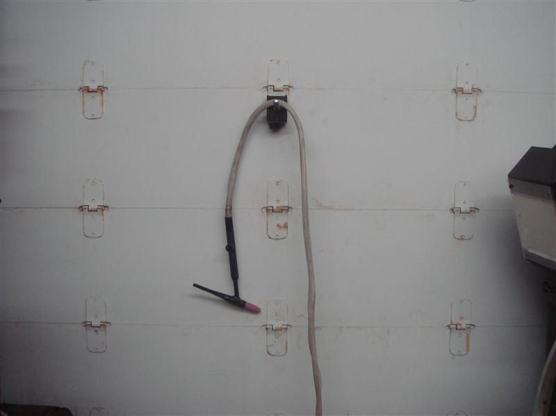

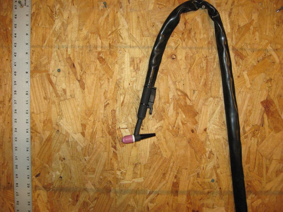

    Here are some comparison pics of my torches. I took them to show the difference in cable flexibility .

ID:	10183 The last three on the toolbox have a gas lens on them.

    Wow...that superflex cable is well... super flexible.

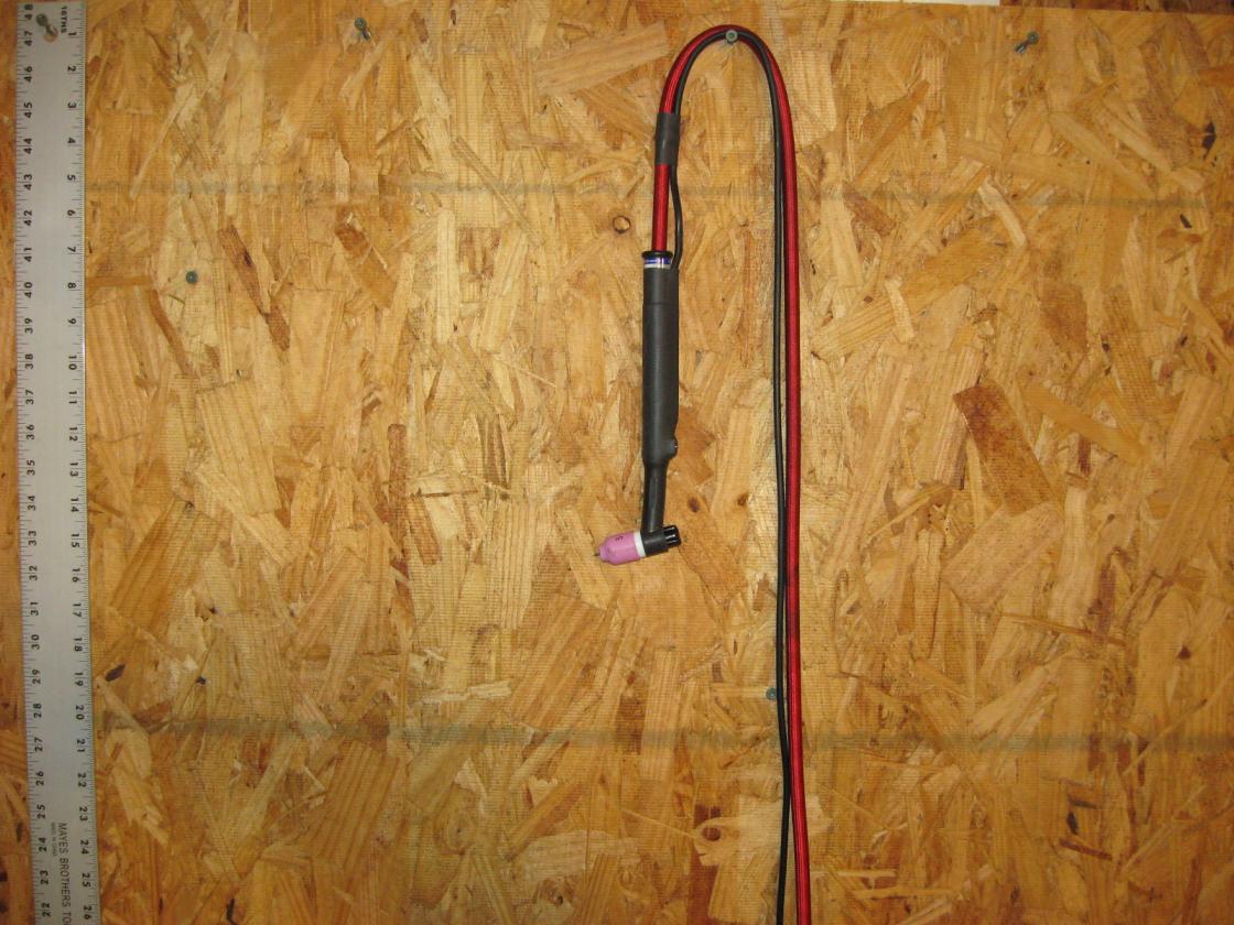

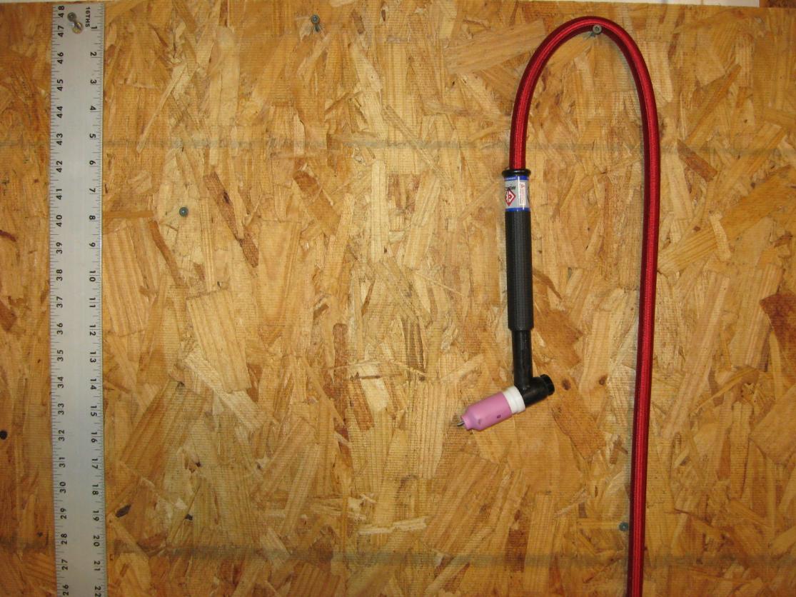

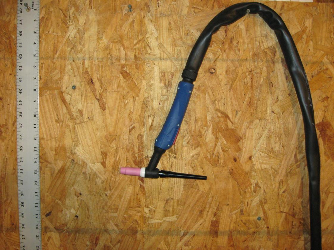

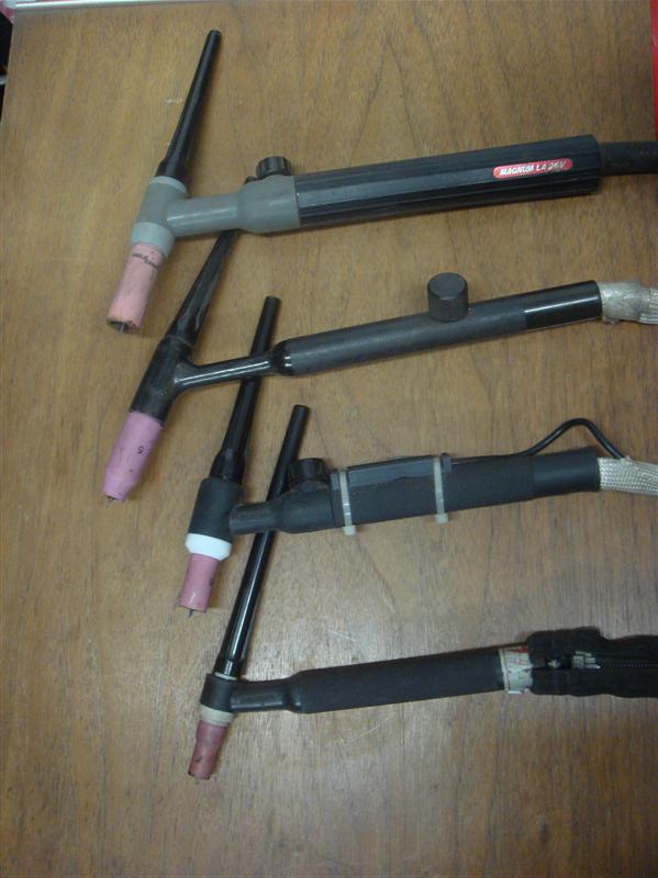

    Here is a comparison of a few different torches.
    The top is a Lincoln Magnum 26 rated at over 200 amps. It is a club, but it stays cool and works well.
    Next is an unknown brand 17 with standard hardware. This is not silicone covered, and it can get toasty even with the long thin neck.
    Next is the Everlast WP-17 with stubby hardware. I don't have a lot of hours on it, but so far it works fine and doesn't get too warm.
    Last is a WP-20 water cooled. By far the smallest and never gets hot. I like real thin gloves so that is important to me.

    And here are the lead flex tests.
    The Lincoln has a huge one piece cable but it is pretty soft and flexible. The next one is a two piece set (separate power and gas) basically just like a ground cable and aquarium tubing inside a fiberglass sheathing. Next is the Everlast one piece but with a small control wire added, also in fiberglass sheathing. And last is Weldcraft 3 piece water cooled set in a cable cover. I don't remember if this is the standard or deluxe version, but it looks like the vinyl set.

    None of these are what I would consider light weight cables, but they are all pretty soft.

    Thanks for your input Rambozo. I like welding with thin gloves as well, but I have found that a larger torch is easier to hold, even with slightly thicker gloves. I like the idea of the flexible cables, so I'll check my options when it comes time to make a purchase.
