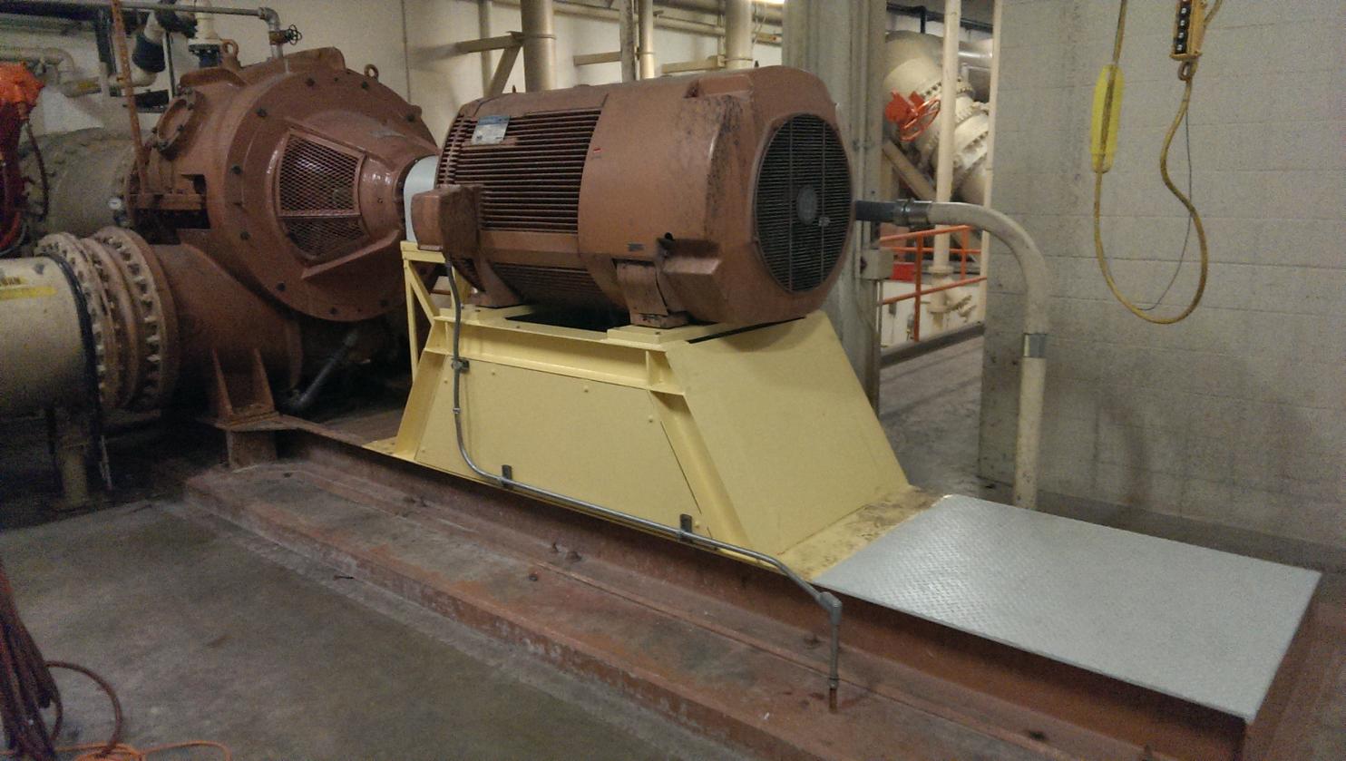

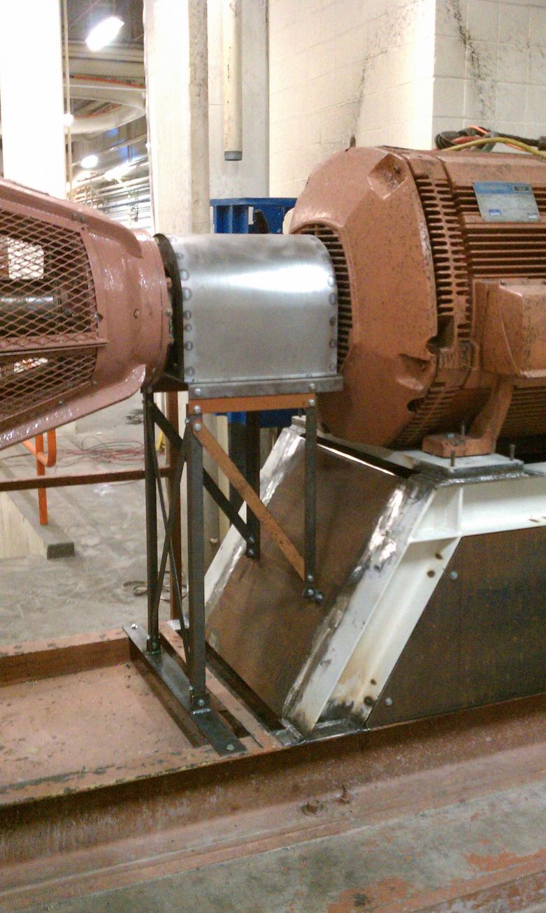

    Ive been in and out of this forum for a while, its been a busy year. I thought i would share my first project at my new job in san jose. It is a motor base and coupling shroud. I didnt take a lot of pics of the process, as I was new at on the job.

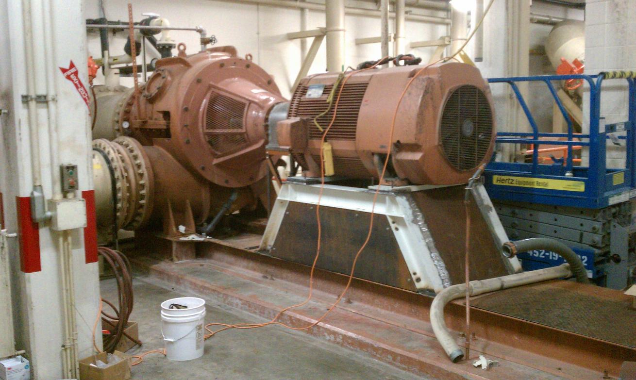

    The base is made from an I beam and some cross plate that the motor bolts to. The motor is a 200hp 8000lb GE.

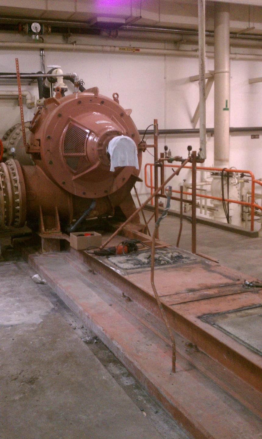

    Area before base.

    The whole mount was welded with 7018 rod.

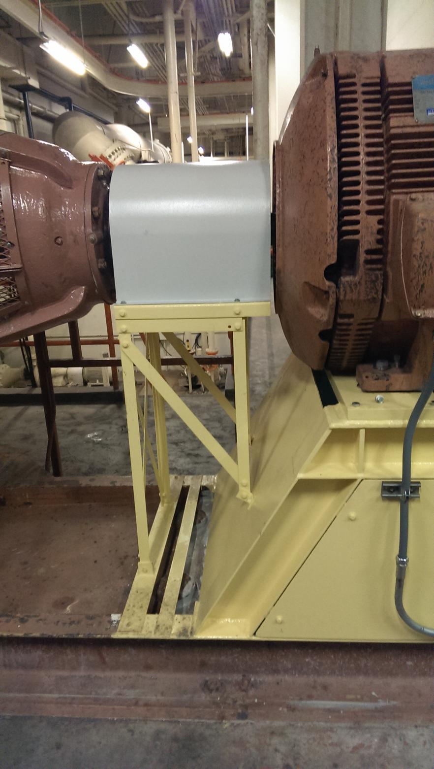

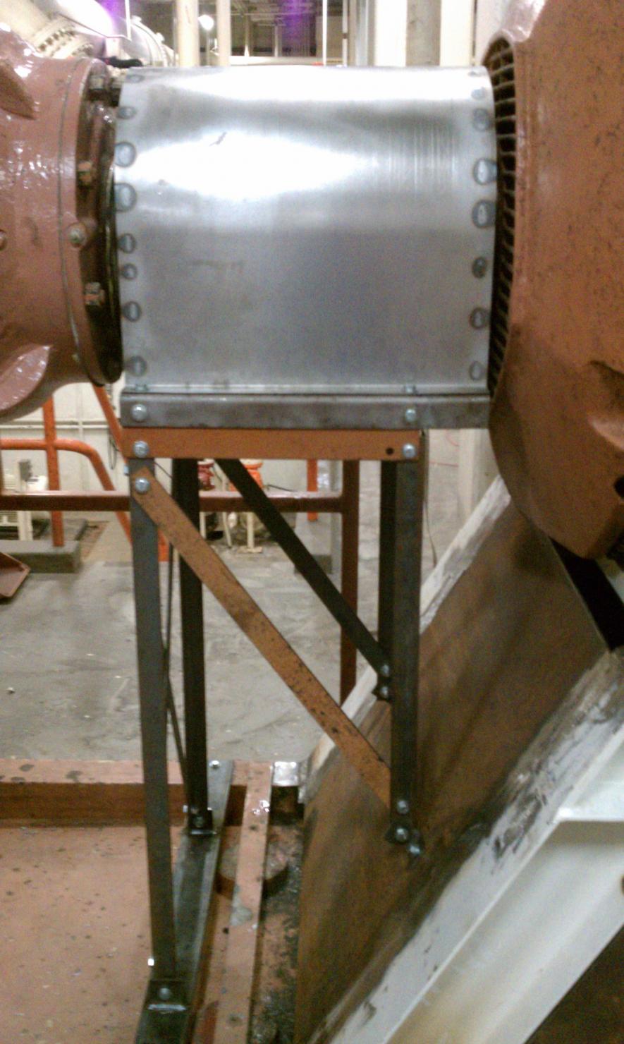

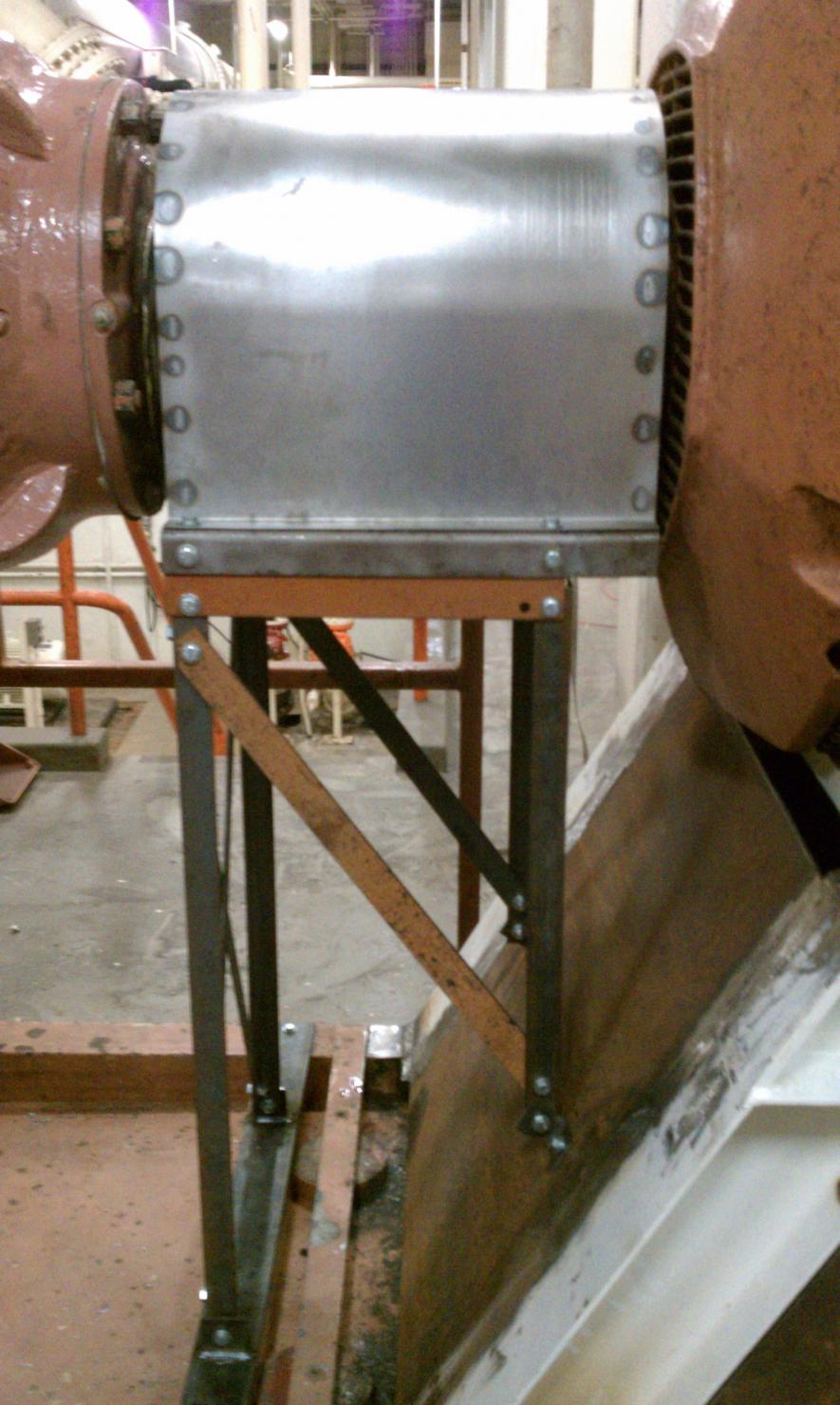

    I made the coupler from steel. it was all mig welded

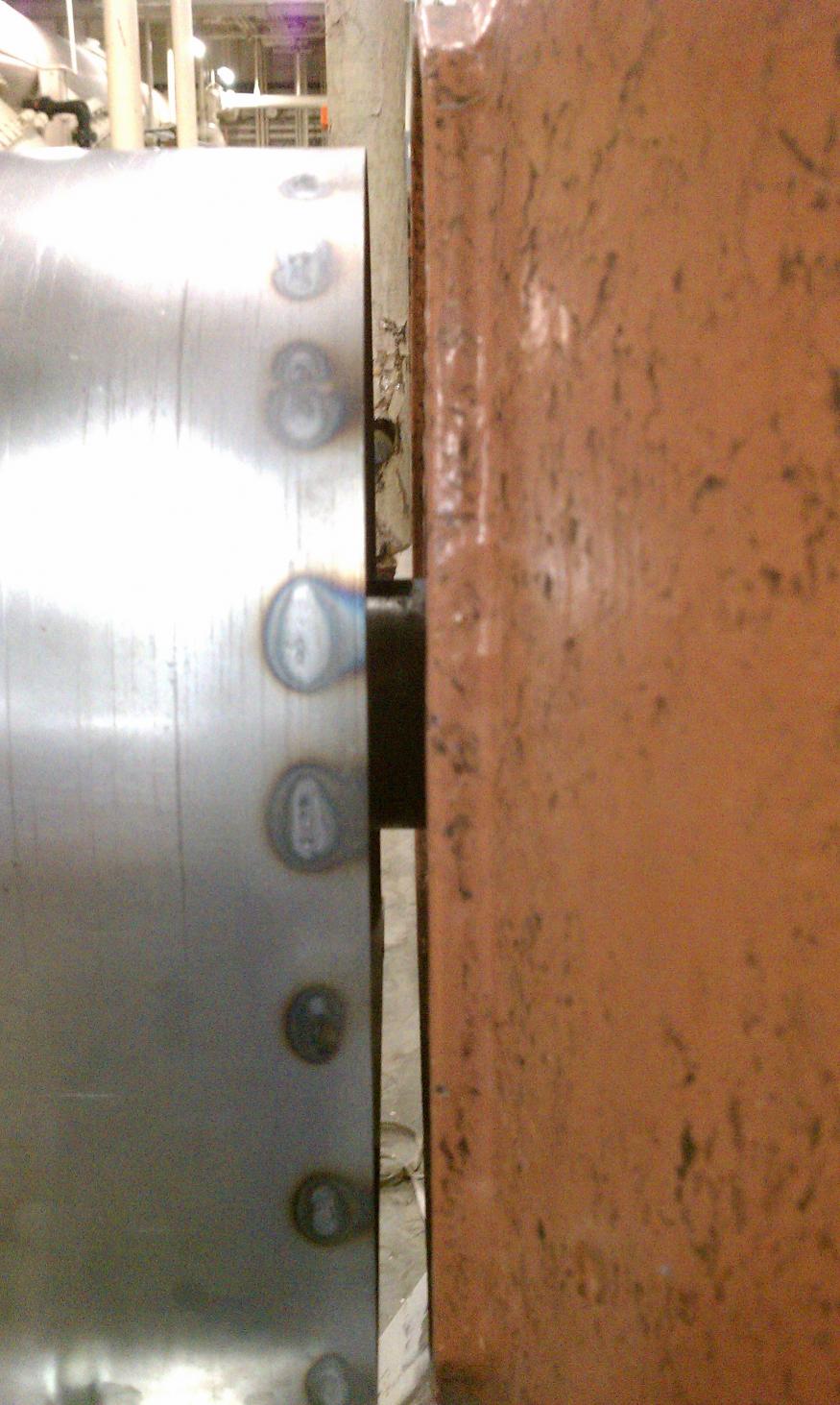

    The gap is only 1/2"

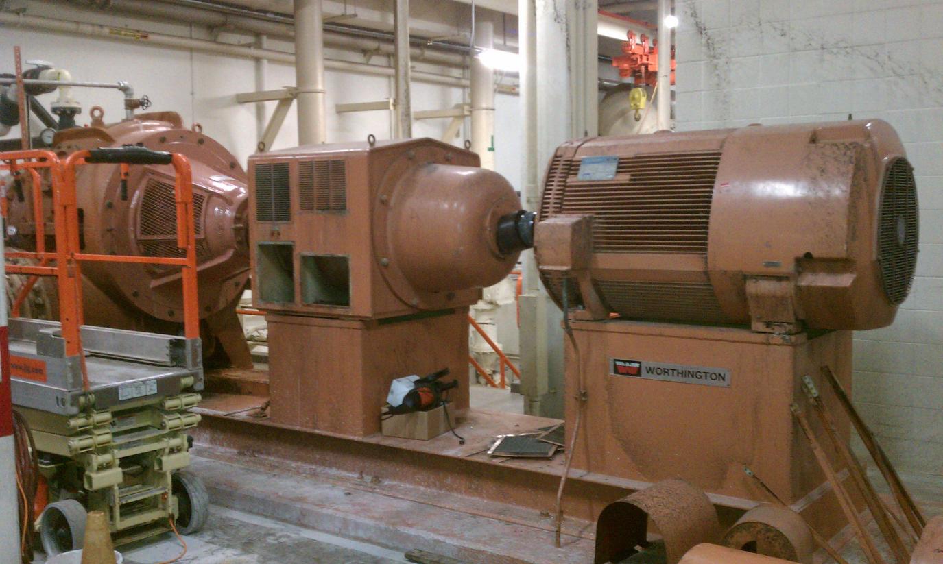

    Here is a pic of the old mount. We are changing to variable frequency drives hence not the need for the magnetic clutch.Click image for larger version.

    Pretty cool work. What happened to the old base?

    The old base was cut out and scrapped. It was basically a hollow box. The new base is a lot more resistant to vibrations. The motors with vfd's can get some strong harmonics.
    The motor is bolted to two plates spaning the witdh. We drilled and taped the holes in the shop. It was all measured carefully and fabbed pretty accurate. It was made .25" short so it could be shimmed and aligned precisely.

    After paint.
