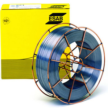

    Your right they don't but I made a unit to hold the small reels it is a drive from a old Hobart Mig welder with adjustable speed on it. I see the wires is available at Linde Canada Limited they are ESAB Dealer they show the ESAB OK Aristorod 12.50 ER70S-6 being Blue color.

    I found on ESAB site why the blue coating and how good the wire is.

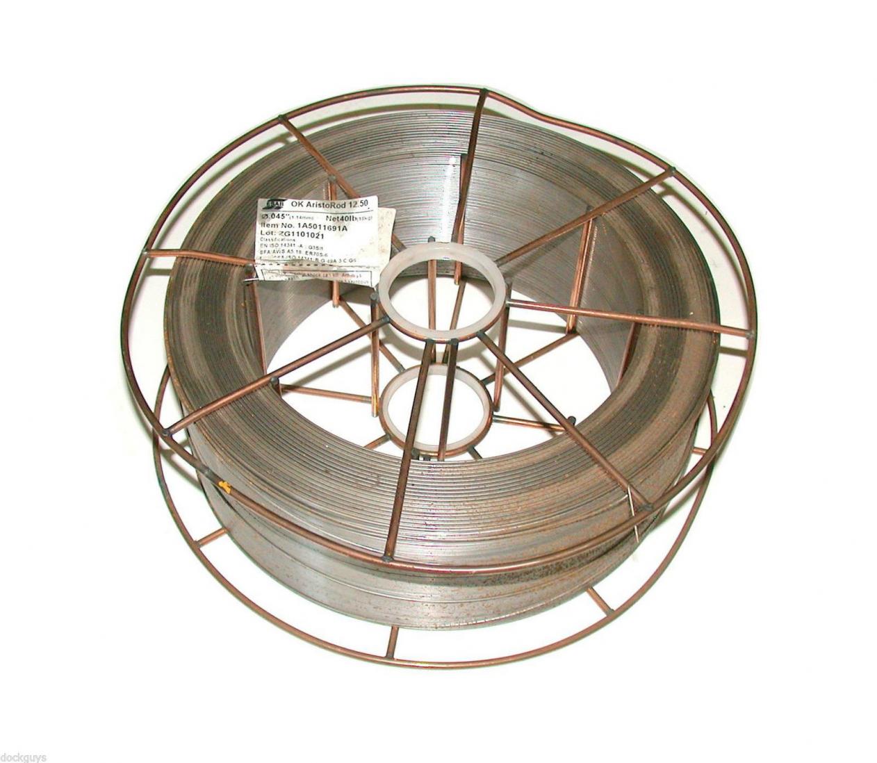

    My roll of Aristorod 12.50 is silver.
    ESAB CANADA site show it blue, see link. I look on three sites and they all use the same picture so it is hard to tell. I will find out when it is in my hands.
    http://esabna.com/ca/en/products_cat...?Product_ID=71
    The wire is bluish in the lighting because it is steel. It's uncoated, meaning it is not clad with copper, but it does have a light wax like coating. It's not wax, and it feeds great, but it won't readily rust...and over time it'll leave a slight powdery, waxy residue under the drive rolls...harmless, but whatever it is, protects things really well.
    Someone thinks they're going to get $100 for this mess on ebay... I don't think so. Click image for larger version.
