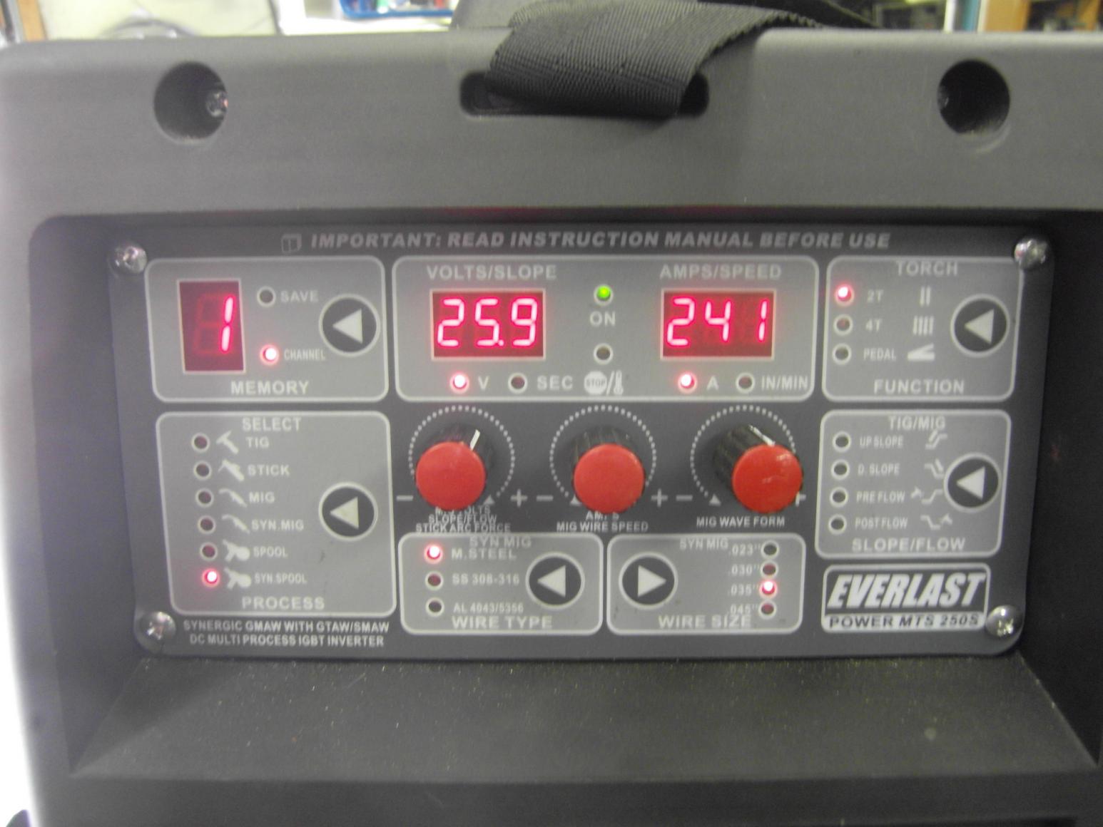

    Code 802.
    I keep getting code 802.
    Start machine get 25.9V in Syn. Spool wire set to .035.
    Start welding for about two seconds then the spool gun stops.
    Machine has code 802 shut off machine restart volts 25.9V or 26.0V weld two or three seconds then it stops again.
    Restart machine get 25.9V use selector go through everything back to Syn. Spool now volts is at 23.6V welder work and does not shut off.
    Restart machine get 25.9V start welding for about two to five seconds then machine quits welding and code 802.
    Restart welder get 25.9V use selector go through everything back to Syn. Spool now volts is at 23.6V change to 25.9 it welds O.K. select any wire size everything work. Shut of welder restart 25.9V any wire size machine welds two or so seconds then quits then I get code 802.

    Overcurrent. Check your exact input voltage. If it's a little low it can create a higher amp draw at higher voltages. Also can happen at higher volts/lower volts if your wire is on the metal when you pull the trigger.
    My in Voltage is 242V to 243V. Also just remembered it spray welded before and now it will not do it when it was spray welding it was very quite and no splatter now it has fine splatter spray. I will test Voltage will I weld to see if it changes that the input.

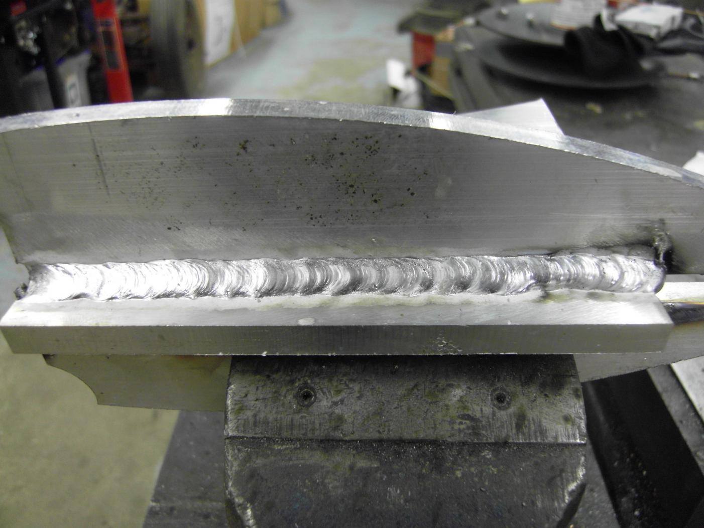

    Well I test on alum. with old settings and it welds then quits and melts the tips off.

    problem welding tips melting
Name:	2-old weld Alum..jpg
    old weld no problems

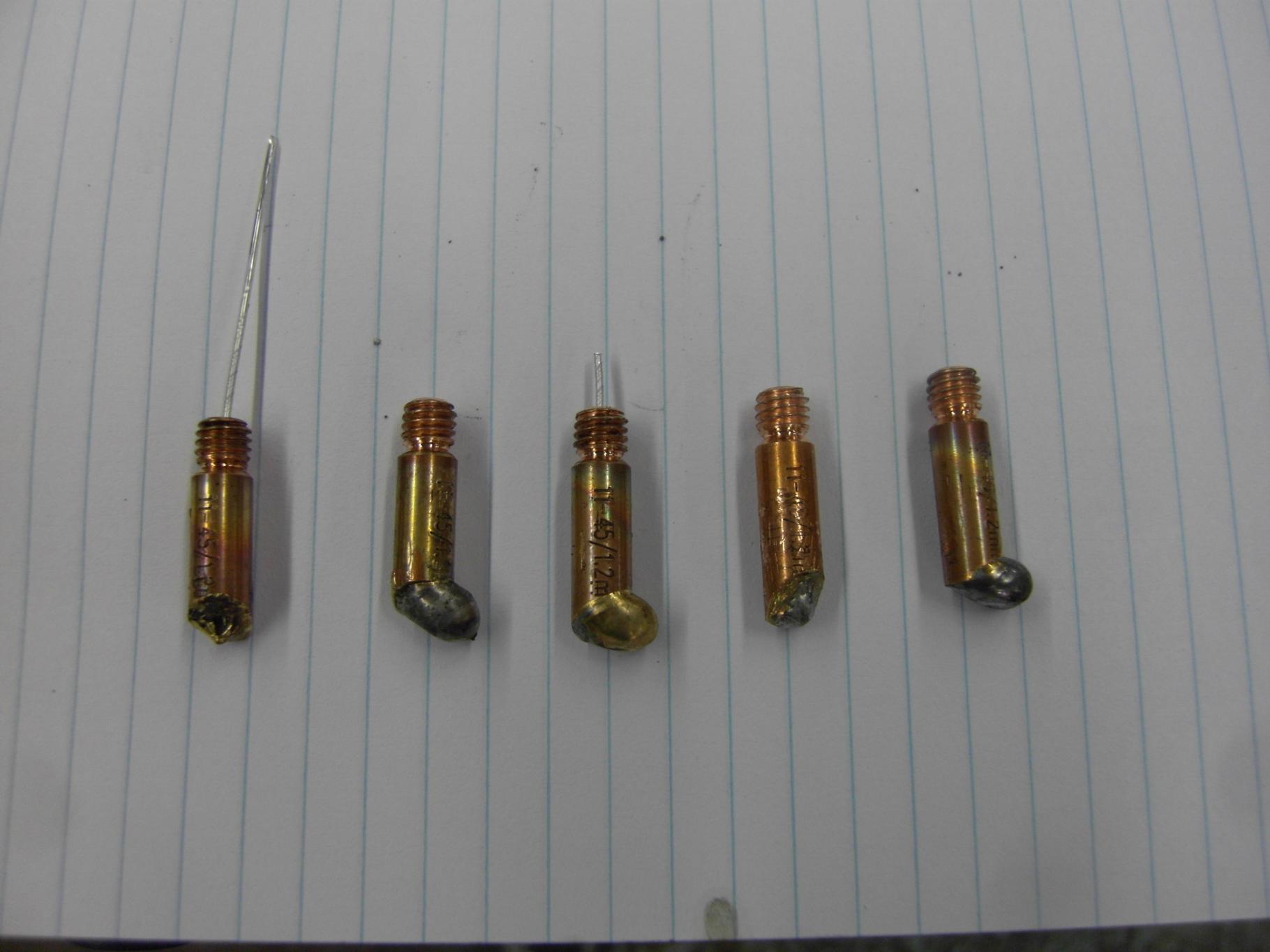

Name:	3-tips melted alum..jpg
    tips

    I've never tried spray arc before but it seems like low wire speed would cause the melted tips.

    What wire diameter and what wire tip size are you using?
    Steel .035 tip .035 Spool gun
    Alum. .035 tip .040 Spool gun

    Have you turned your burn back OFF for aluminum? Also have you fine tuned any in synergic mode with the spool gun? You likely will need to retune some, depending upon a number of factors. But honestly, I'd go to a .045 for the .035 aluminum.

    You are over thinking this. The unit sends voltage to the wire feeder...that's it. The input is analog on this unit from the wire speed controller. If something is wrong, it won't read it. My guess is that he may be using another gas or the wire is siezing in the TIP from over expansion...because I had this issue on one of our other migs personally and solved it with changing to a fulll .010 size larger. No issues now. Same basic gun. When you are spray welding, especially with aluminum, a burn back occurs instantly. It's not something you can react to or even the machine can react to. ANOTHER possibility is the arc force is set poorly for operation with the spool gun. This WILL affect performance from my testing.
    Another issue, is the diameter groove may not be ideal for the wire size. I don't know, but it's a possibility and the diameter of the groove affects wire feed speed.
