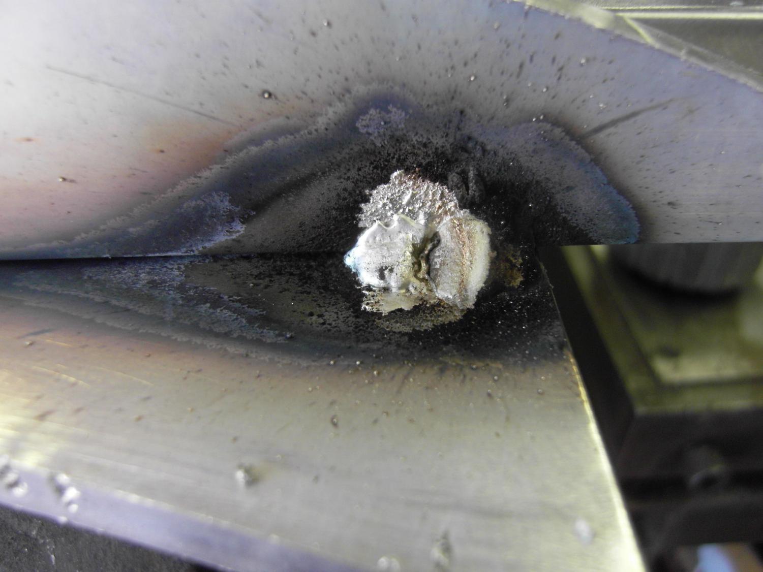

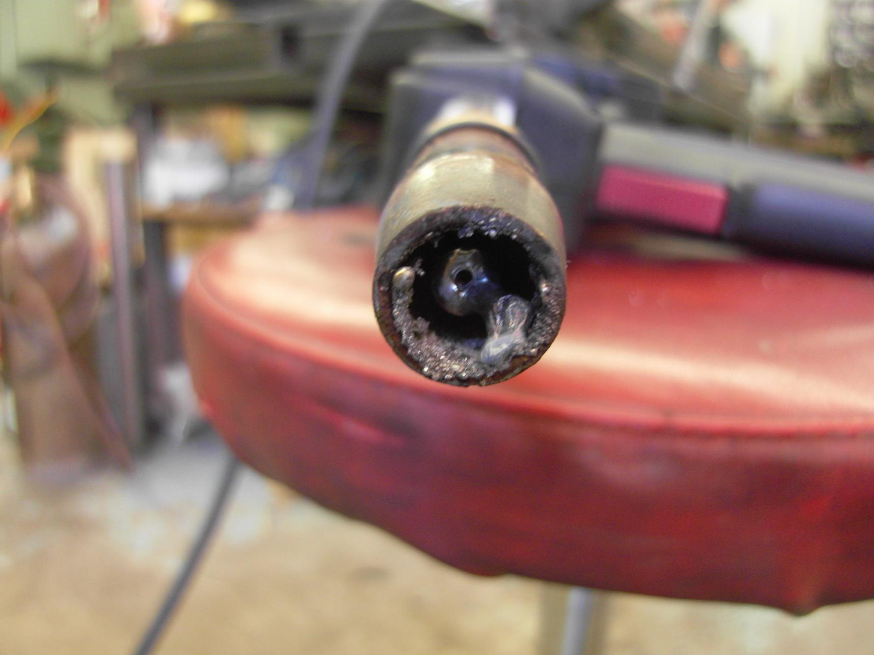

    Well I tried .045 alum wire in SYN Spool, wire type Alum., wire size .045 auto 100% Argon, tip .062 wire, speed full and Volts 23.6V amps 241.
ID:	10103Click image for larger version.
    Conclusion don't use in SYN Spool mode and Alum. just Steel and SS.

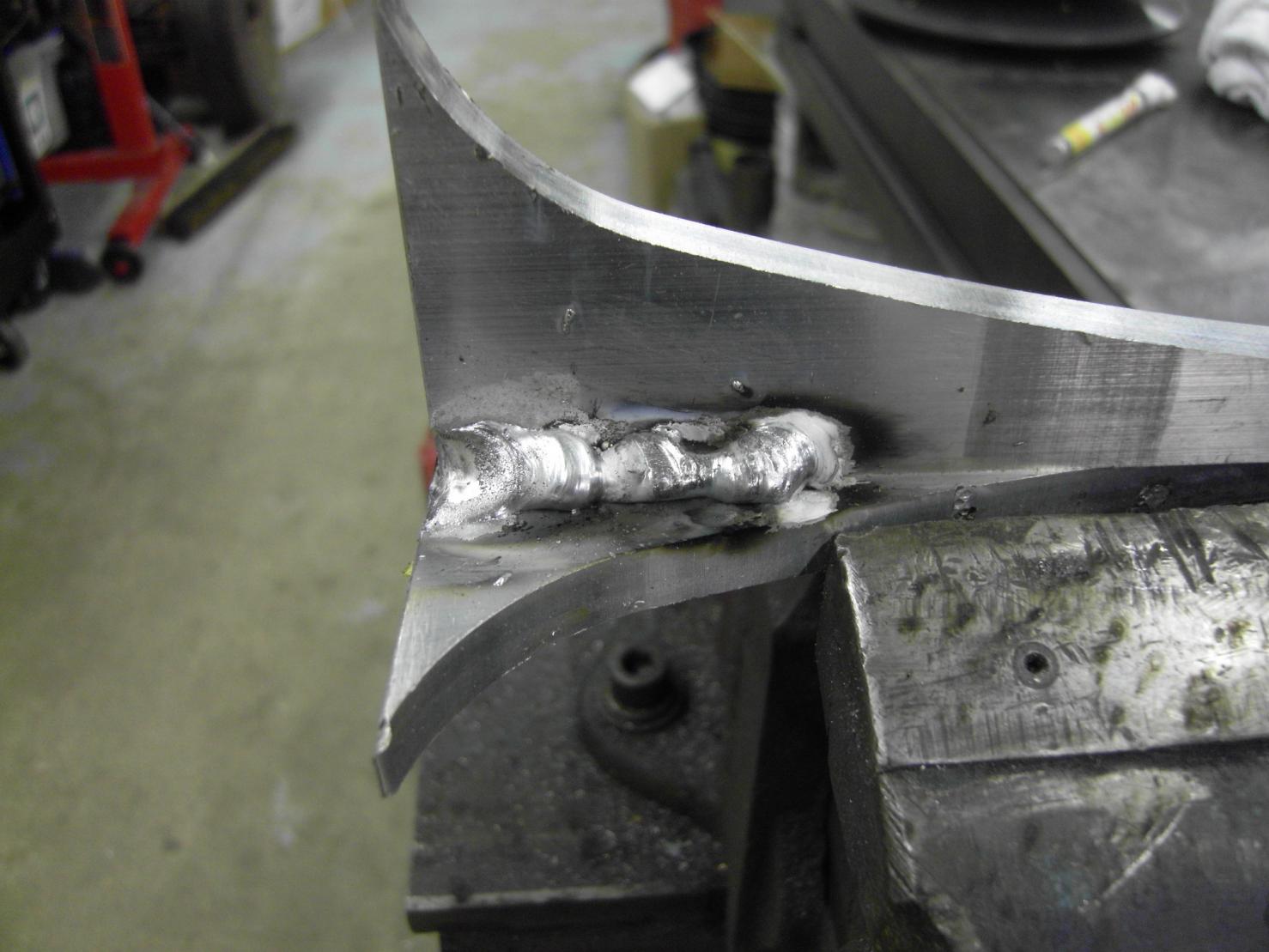

    Now test again set in Spool none SYN mode Volts 23.5V and Amps ? wire speed 404 in/min wire .045/ 5356 tip .062 100% Argon.
    Weld very messy but did weld stopped after 2 in.

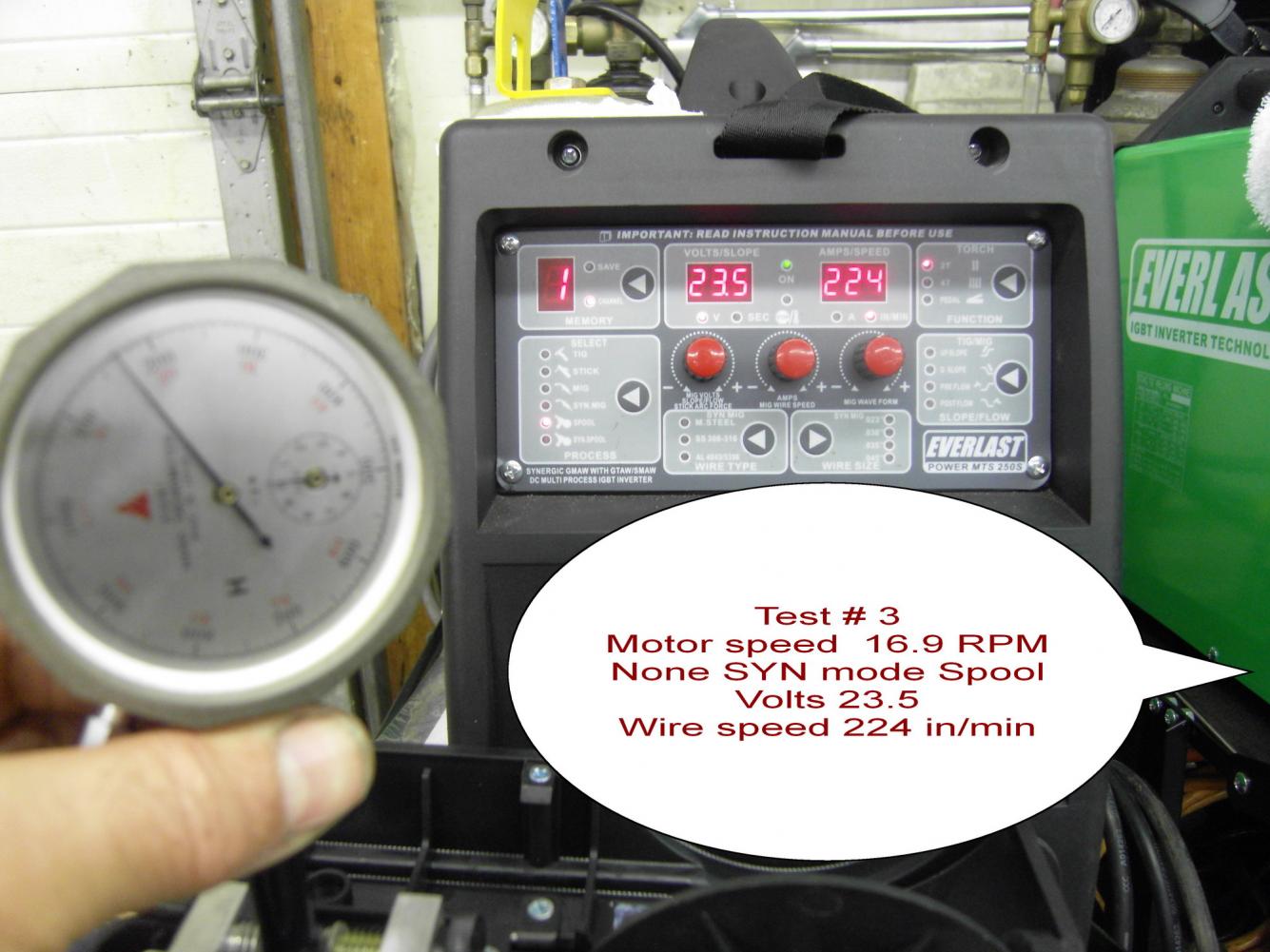

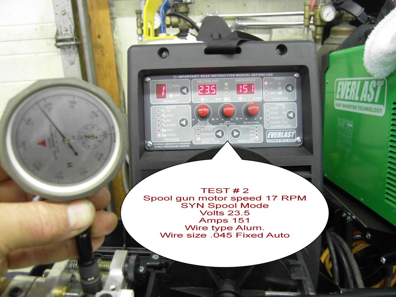

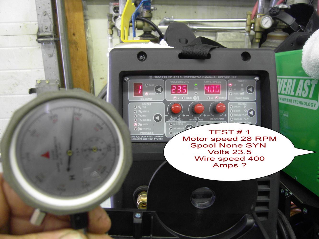

    Did you watch the tutorial yet onl youtube yet? Amps adjust the wire speed and wire speed adjust the amps in ANY mig system. This is a basic concept in MIG that the wirespeed controls the amps, and although they read differently they are controlling the same thing. Although it registers as amps in synergic mode, it doesn't mean you can't adjust the wire speed against the voltage. Again, at 241 Amps, you are going to burn things up anyway because the spoolgun is duty cycle rated for 200 amps. Anything above that is limited operation. Turn it down to 150 or so on amps...when you do, it will slow down the wire speed. Amps are a function of wire speed and wire diameter. As we have said in, you may need to retune for optimal operation. I'd back it down a half a volt as well. Turn your amps down to 140-150 and then readjust your voltage back up to 23.
    In testing the motor speed on the Spool gun as close as possible to the been the same settings I got.
    Test # 1 Spool None SYN
    Motor RPM 28 at 23.5V 400 in/min
    Test # 2 Spool SYN
    Motor RPM 17 at 23.5V 151Amps
    Test # 3 Spool None SYN
    Motor RPM 16.9 at 23.5V 224 in/min
    Conclusion with RPM the same in SYN mode and None SYN mode volts the same inches per minute are not the same not even close 176 in/min less.

    Again, Kempy, not following you here. It seems you are replying to my questions or thoughts... but on a different plain. I never said set it to 15 volts. Set at 15 volts, and at that amp setting you will have issues. Reset the volts in synergic mode to 23V AFTER adjusting the amperage to 150 BEFORE you try to weld or take measurements. Please try to punctuate better because it's very, very hard to understand what is being said... Use fuller sentences as well. I am just not following you that well. I am really only trying to help, but its like we are both speaking English but somehow not communicating very well.
    My guess is that when welding too hot initially, over the duty cycle of the gun, you MAY have burned up something inside the gun. That would account for the change and some of the issues you are seeing.
    Burn back is caused by poor shielding, the wire staying energized after the gun quits feeding, holding too long of an arc at start. (The gun must be really close), Starting on oxidized metal with poor conductivity at the start, Too high of wire speed feed at the start resulting in a "blowing" off of the wire, Too long of an arc length at start (should be 3/4" or less, better at 1/2" or less) or poor contact between the contact tip and the wire, and even dragging/seizing between the contact tip and the wire, One more could be drive roll slippage.
    The wire feed readings/amp readings on a gun without welding are not accurate. It would be best to have someone weld while you watch the changeover from IPM to actual amps while welding to compare the two.
    Instead of worrying about gauging RPM, just measure wire spool off with the gun pressed for 15 seconds and multiply the length of the despooled wire by 4 to get inches per minute. Just roll it back on when you finish each test. This is a more accurate way.
