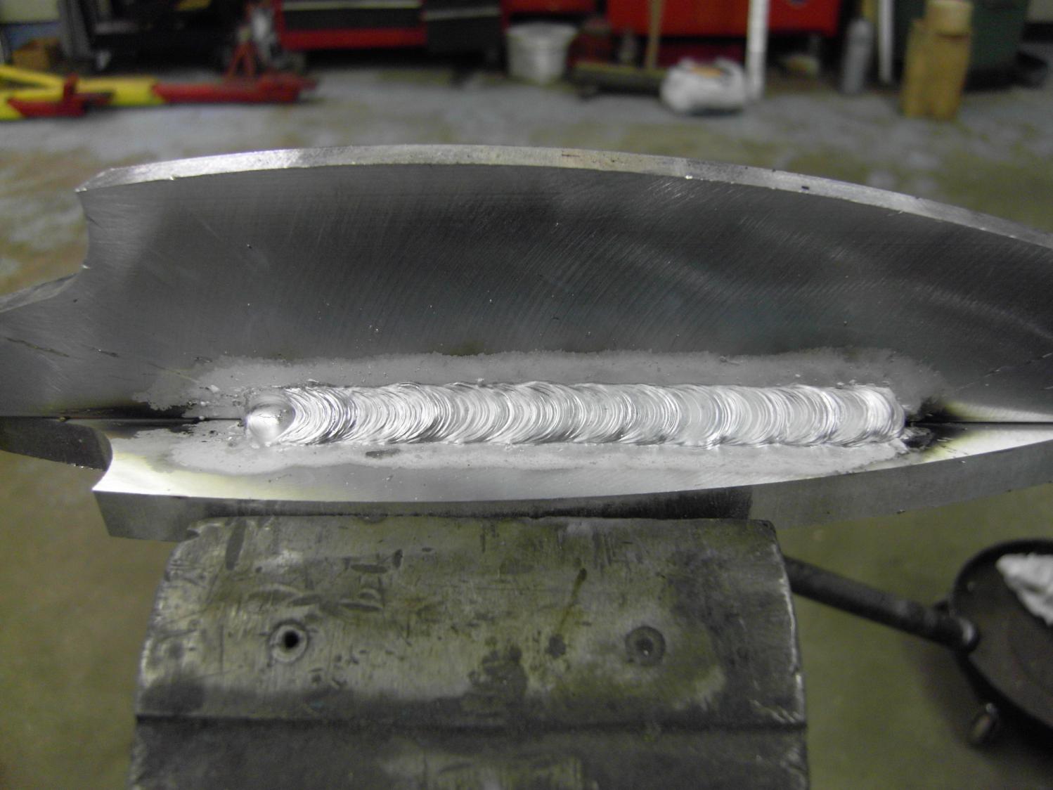

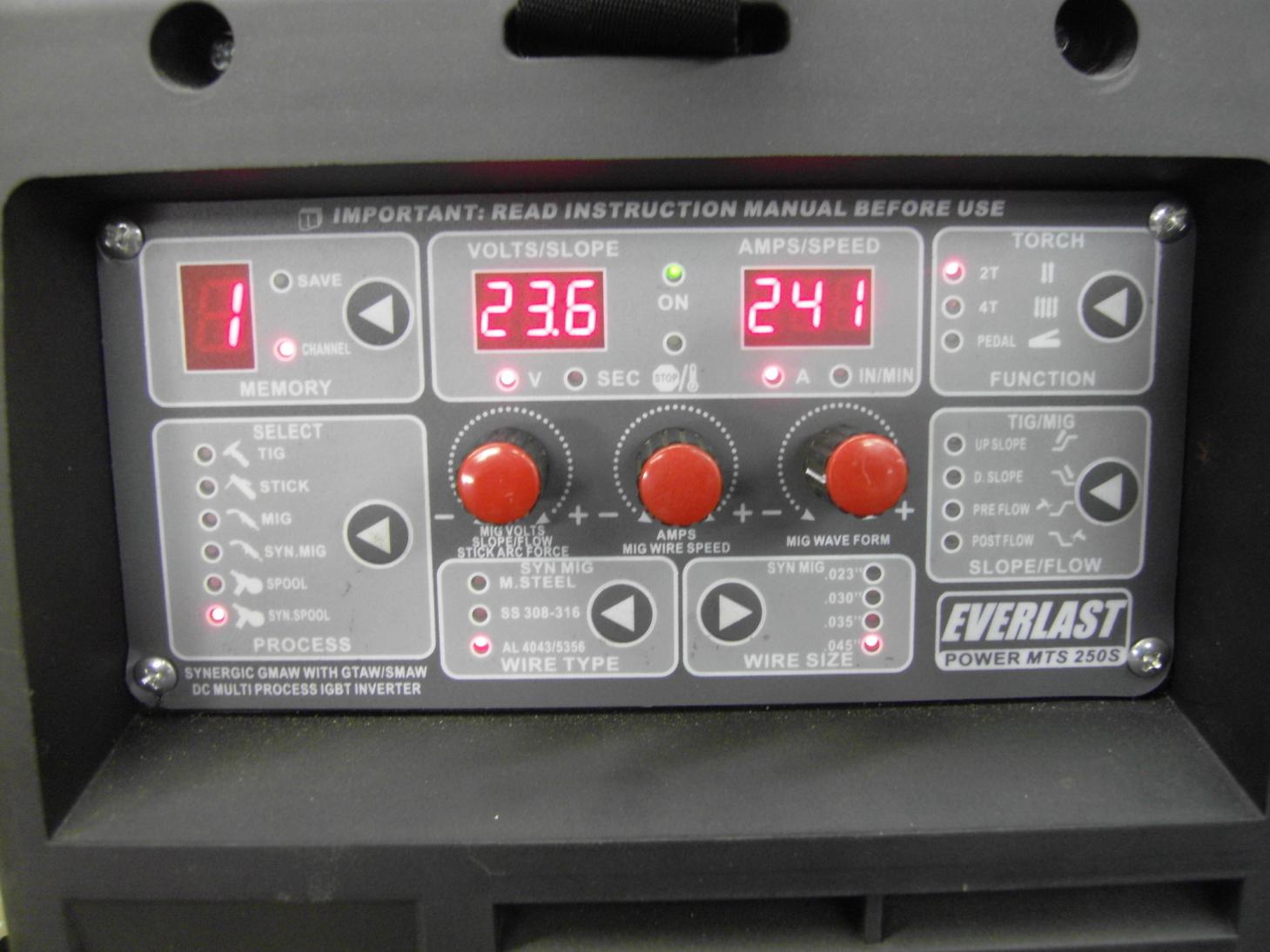

    Test with new tip .045 wire alum. 4043 .035 in standard Spool gun weld OK.
Name:	1-set spool 23.5v 600.jpg
ID:	10091Click image for larger version.
Name:	2-set spool 23.5v 600.jpg
    Test with new tip .045 wire .035 in SYN Spool same settings 23.5V to 23.6V wire speed the same full speed as with standard setting in spool gun still melding down tips.
Name:	1-SYN mode face.jpg
ID:	10093Click image for larger version.
Name:	2-SYN mode tip melt.jpg
ID:	10094Click image for larger version.
Name:	3-SYN mode two welds melt.jpg
    Conclusion testing in SYN Spool mode steel or alum. takes time and uses up a lot of tips and wire.

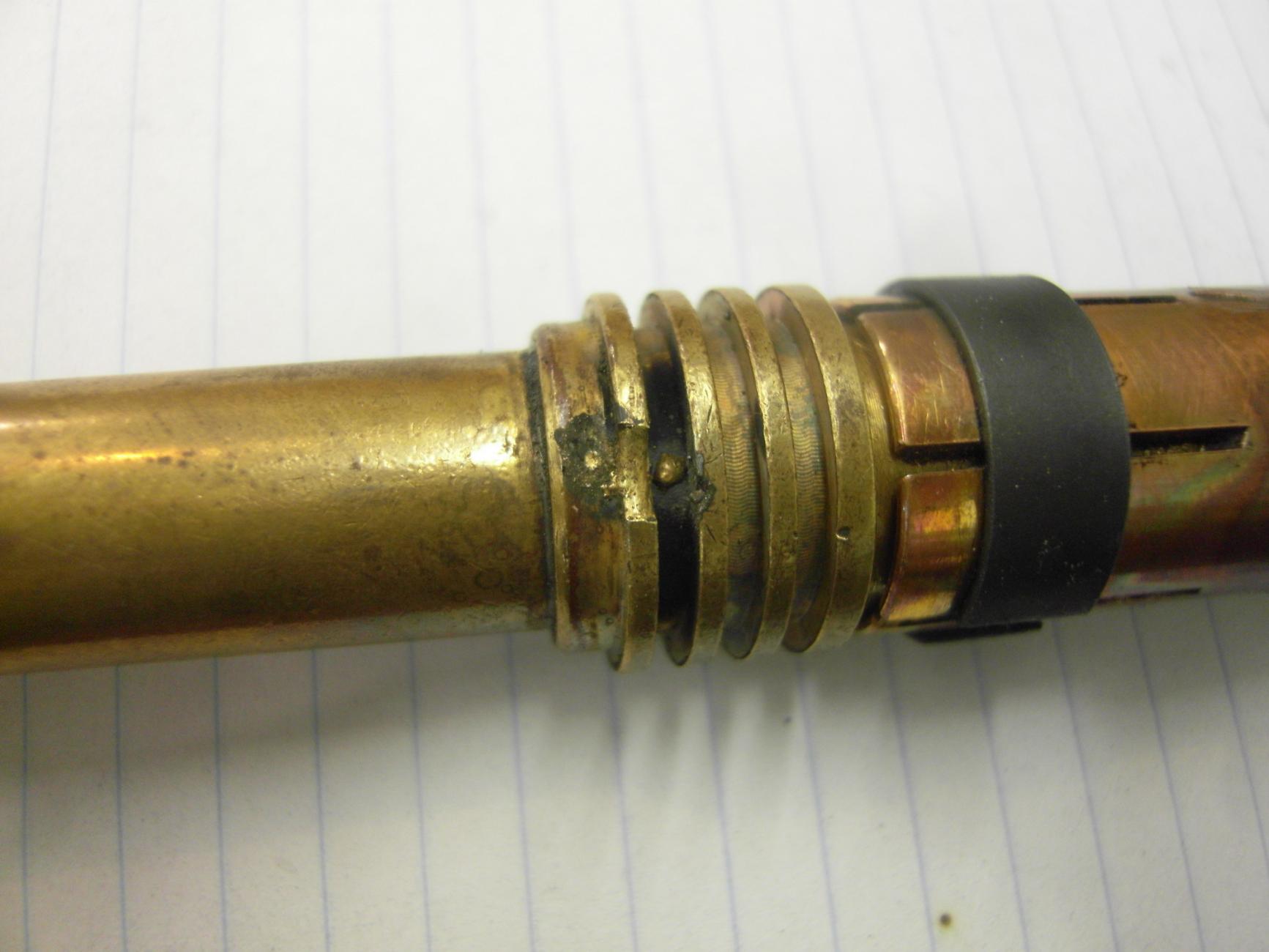

    Just welded a truck crack in a truck frame and when I moved the spool gun sideways to weld around the frame support the gun cooling rings touched the frame and arced, I did not know that the neck was live also.

    That seems odd. Doesn't that make the nozzle live, too?
  8. #28
    Yes it is also live the nozzle is not insolated like the Mig gun. If the splatter builds up it sometimes arcs and sticks to the wire and goes in to the weld so I have to keep it clean or keep putting Rocol spatter release spray on the nozzle.

    I have never seen a GMAW nozzle that was energized during welding. I suppose if there was a buildup of spatter or wire from the tip to the nozzle it could happen, but to have it energized intentionally during welding is odd. seems that there is something wrong with grounding or design of the gun.
