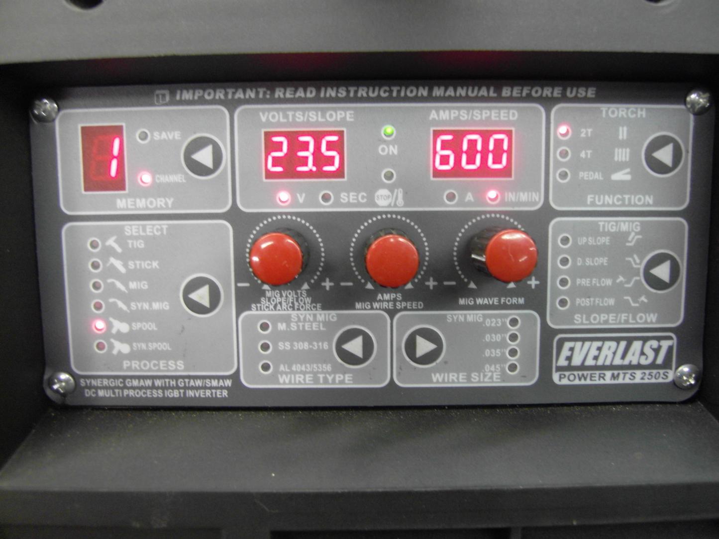

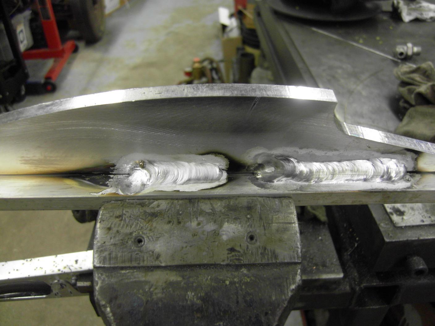

    Test with new tip .045 wire alum. 4043 .035 in standard Spool gun weld OK.

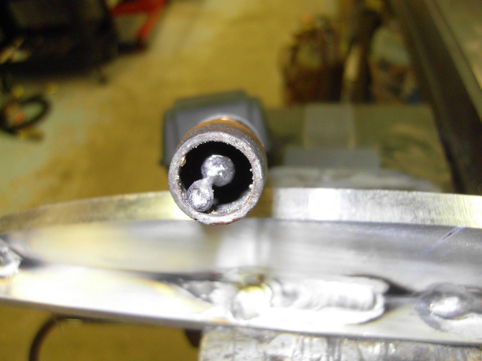

    Test with new tip .045 wire .035 in SYN Spool same settings 23.5V to 23.6V wire speed the same full speed as with standard setting in spool gun still melding down tips.

    Conclusion testing in SYN Spool mode steel or alum. takes time and uses up a lot of tips and wire.

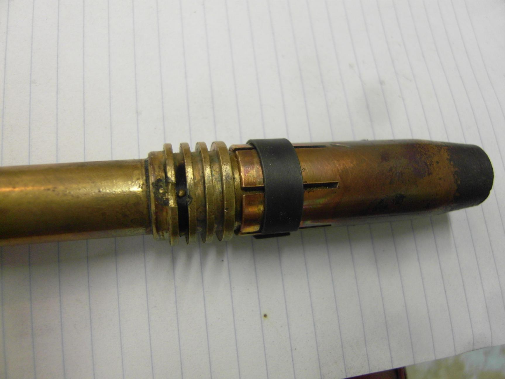

    Just welded a truck crack in a truck frame and when I moved the spool gun sideways to weld around the frame support the gun cooling rings touched the frame and arced, I did not know that the neck was live also.

    That seems odd. Doesn't that make the nozzle live, too?

    Yes it is also live the nozzle is not insolated like the Mig gun. If the splatter builds up it sometimes arcs and sticks to the wire and goes in to the weld so I have to keep it clean or keep putting Rocol spatter release spray on the nozzle.

    The neck/nozzle was like that on the regular mig gun that came with my 250p... first time the nozzle touched in a corner it burned the edge off it.
    The spatter bonded to the nozzle like mad as well. It just would not release like on a bare copper one so I replaced it with the 20' profax. I want to purchase a spool gun for my machine but I don't want a live nozzle.

    When I first got the machine end of April 2013 it work very well and held the settings in Aluminum SYN mode.
    Conclusion for 802 code is with a lot of playing around and using up gas, wire, hydro and time, it only really happens in SYN spool mode on wire type Alum 4043/5356 mode and wire size Auto to .045. burn back off Mig Wave Form on or off gas used was 100% Argon.
    Change gas to 25% Helium 75% Argon it works a little better and longer but melt down did happen and not as clean a weld as with 100% Argon.
    Adjusting things and using Unibraze S-6 wire in SYN Spool, wire type M Steel and wire size 0.035 or 0.030 it works and will spray with Argon/Co2 mix but will not spray with Lincoln S-6 wire.
    Adjusting again and using Unibraze 316 wire in SYN Spool, wire type SS 308/316 and wire size 0.035 it works and sprays using Argon/Helium/O2 mix.

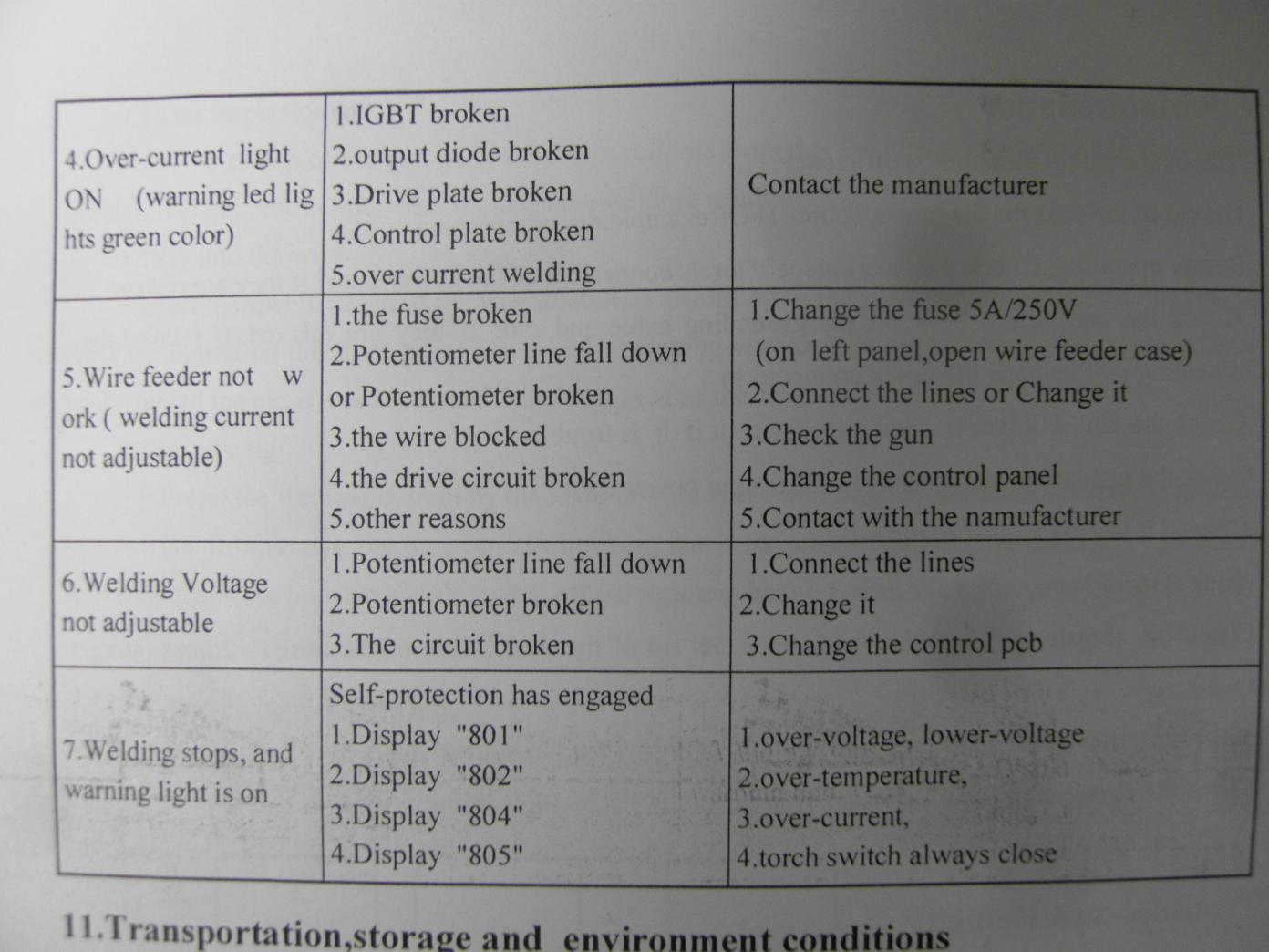

    CODES for MTS250S-2013
    801 = Over-Voltage or Low- Voltage
    802 = Over- Temperature
    804 = Over-Current

    I have never seen a GMAW nozzle that was energized during welding. I suppose if there was a buildup of spatter or wire from the tip to the nozzle it could happen, but to have it energized intentionally during welding is odd. seems that there is something wrong with grounding or design of the gun.

    According to the factory, the gun will run .045. By the way, there is a typo error in the codes you posted. 802 is an overcurrent.

    This is the page out of the MTS250S book on codes and the cover of the spool gun.
