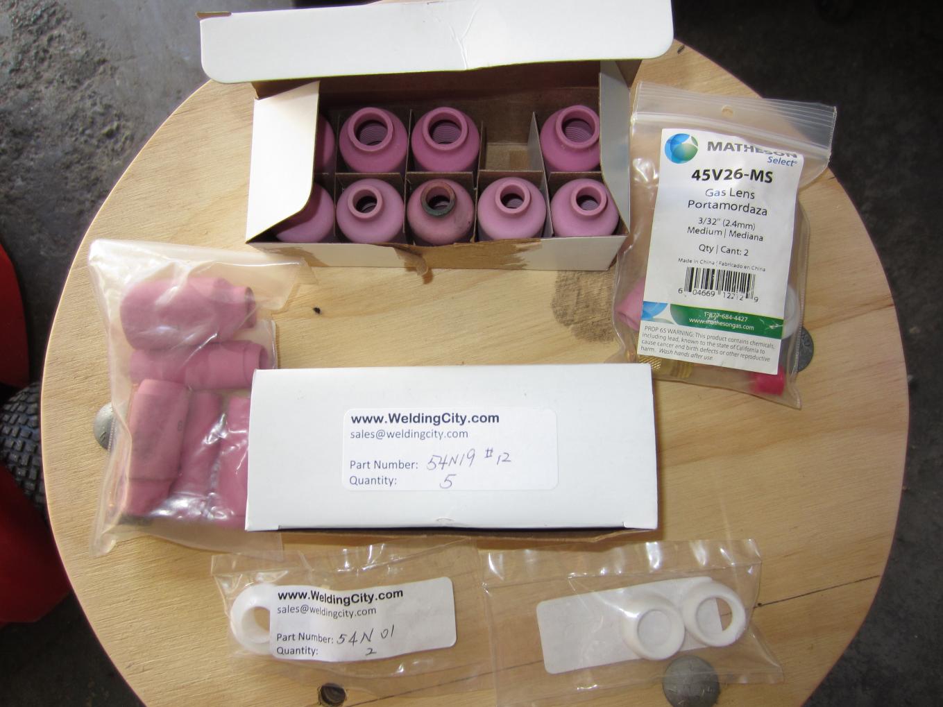

    For either torch type, are the consumables and assorted parts standard?
    In other words, can I go into any welding shop and pick up gas lenses, cups, tungsten, replacement torch parts, and so on? Or will I need to look for specialty products to fit, or order them from somewhere?

    Most all around here carry weldcraft. So you should me OK. Take the torch with you and they will be able to stock them if not.

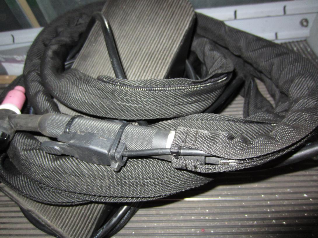

    I brought a ceramic cup with me to the welding shop, along with a collet (just for the hell of it) and they had all the parts I needed in stock and they were standard 17 style torch parts. I received the black handled torch and I actually really like it a lot.
    Once I realized that the parts were standard, I went to weldingcity.com and spent about $50 (total with shipping) on 2lbs. of stainless rod, a new cloth zippered cable jacket for the torch, and a ton of different sizes of gas lens cups. The ceramic cups were $2.45 for a minimum order of 5 (49 cents each!), and the welding shop wanted $2 to $6 per ceramic cup! I did spend $3 on one special extended cup for getting into tight spaces, but I bought like 17 cups for around $10. I like to keep an overkill of supply on hand (especially when it's extremely cost effective)...plus I've had a few "slips" of the torch and those ceramic cups don't like hitting the floor too often!
    It may not be an issue for you, but I just changed the cable cover/jacket on my torch leads to a zippered cloth style one and it made a huge improvement for me as far as flexibility goes. I no longer feel like the torch is twisting my hand as I weld. I think that upgrade was like $15.
ID:	10519   Click image for larger version.

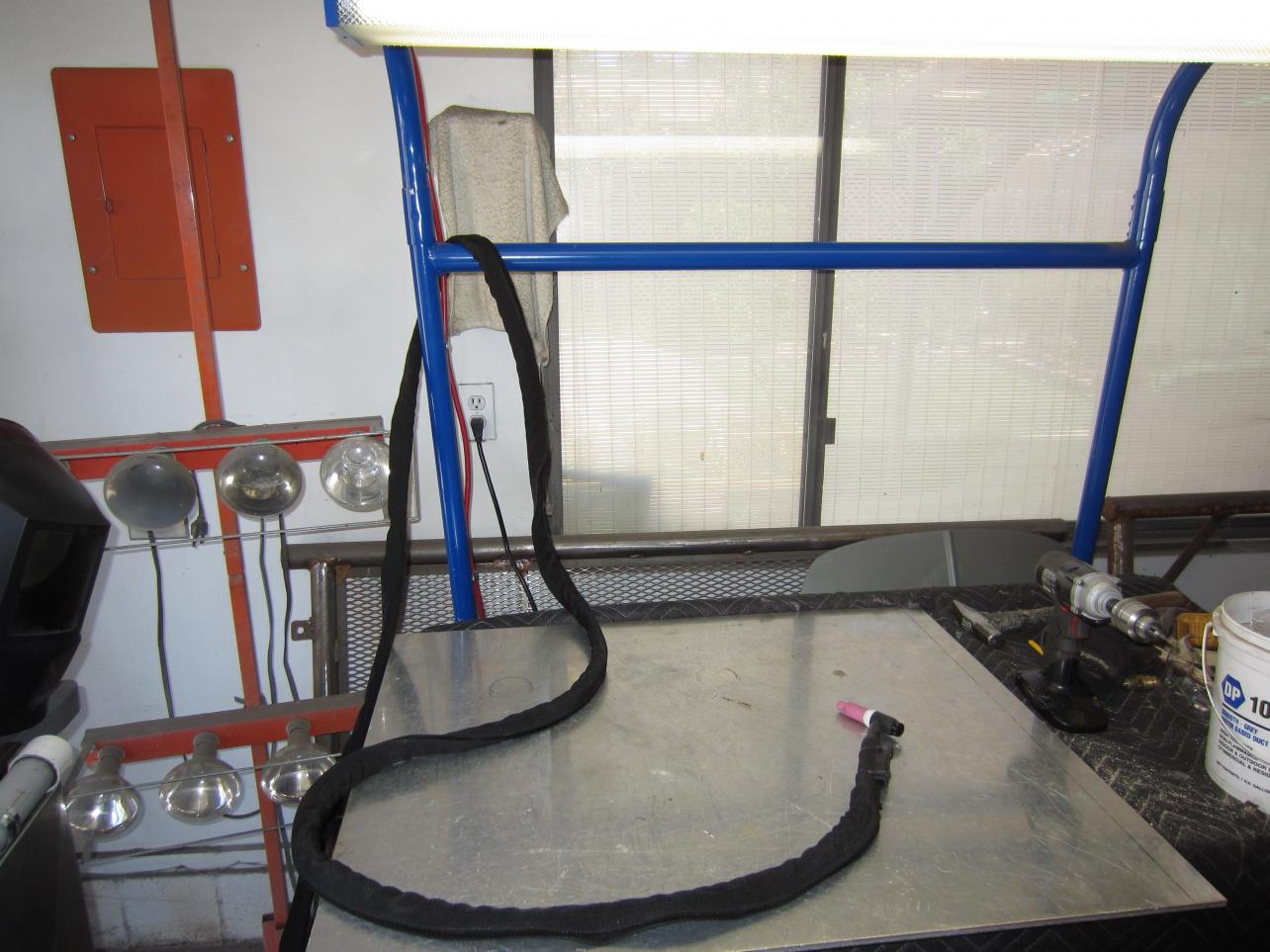

    Good little upgrade to the torch with the more flexible jacket. Does it pick up much off of the floor?
    To be honest, it doesn't really hit the floor. If it did, I'd say "Yes", but I route it from my welding cart directly behind the job box I use for TIG welding. As you can see, I added a crossbar to the rack that supports the light fixture, and I route the torch through the crossbar for ease of use. It keeps all the tension off the torch when welding, plus the leads are always off the floor. I bet the jacket would capture every little piece of hair and lint if it did sit on the floor when welding though. My yellow lab isn't allowed past the door opening, yet for some reason I have clumps of dog hair on the floor at all times....and multiple tennis balls, bones, chew toys, etc.
    Was it this one?
    http://www.weldingcity.com/tig-torch...-w-zipper.html
    Or this one?
