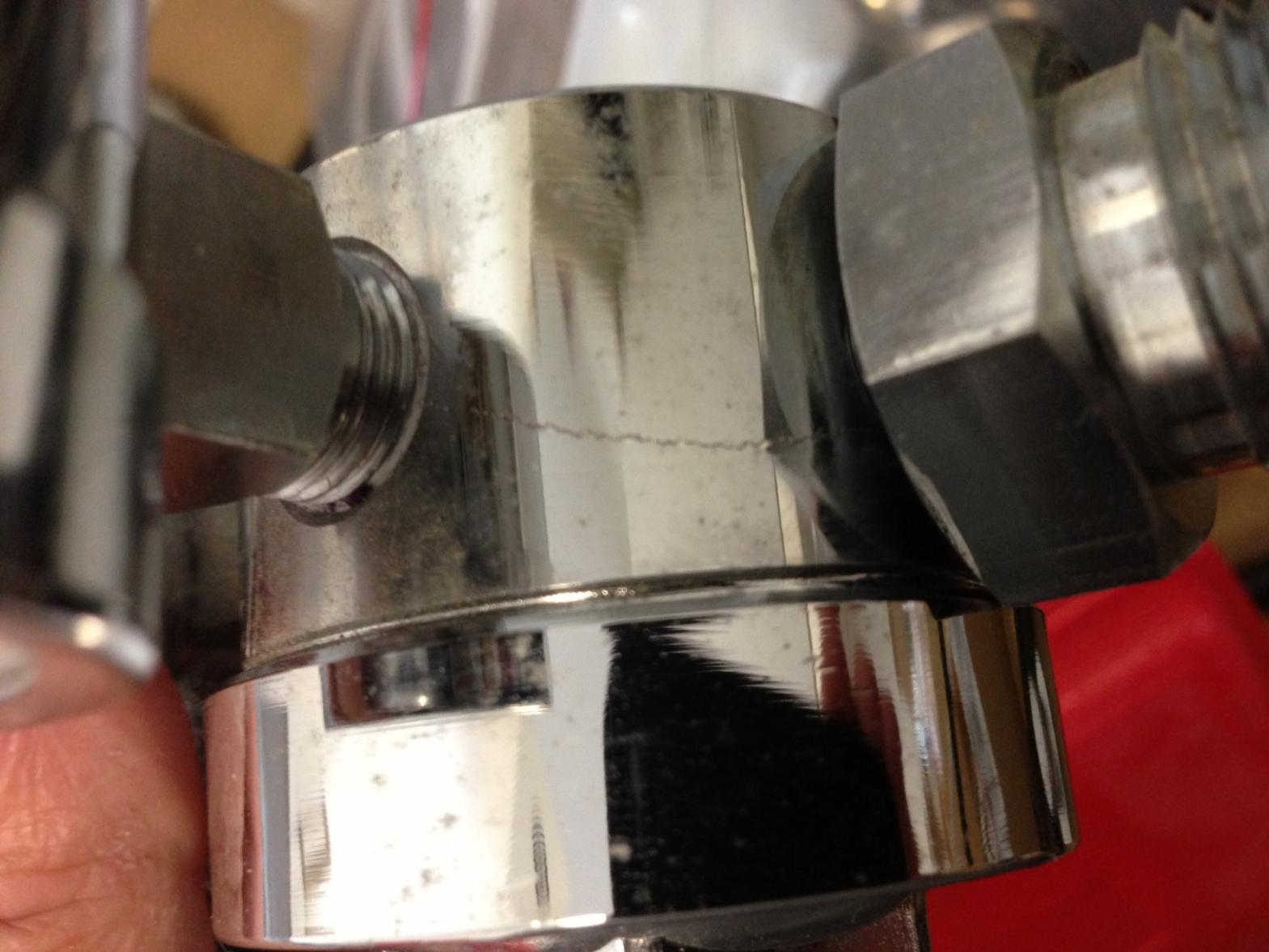

    I know I'm not the only one with this problem... and I'm sure Everlast is addressing this. But these regulators (Model GH-25 made by the Zhejiang Bril company in China are downright dangerous - mine split right down the middle (see pic)!!! If you have one of these regulators keep a close eye on it if it's not leaking. Personally, I'd pitch it in the nearest dumpster!Click image for larger version.
Name:	Crack in Regulator.jpg
    We've changed regulator suppliers recently and most all the new ones are made from billet brass. This is the older style. If yours is less than 6 months, we can send you another unit.
    On the other hand, I've got one of those I've had for nearly 4 year now. No issues.
    As usual you guys are right on top of things. I just posted the picture for other users that might still have these units. Clearly this supplier had issues! Cheers!!!

    Maybe it was dropped somewhere along the way or over torqued at the factory. How old is it?
    We have had a couple cracks over the years, but we have sold way more than a couple welders.
    But either way, that needs to be remove ASAP, it could be really dangerous. Call Oleg and see what he can workout for you. I have used the local HF ones, Clarke knock-off if you need one this weekend in a hurry. If on sale, and a 20% off coupon they can be had for about $26-28 dollars.
    I tossed my regulator the day the 250EX arrived as I didn't trust it and bought a Smith instead. I bought the 250EX for the machine alone and it's been behaving ever since.

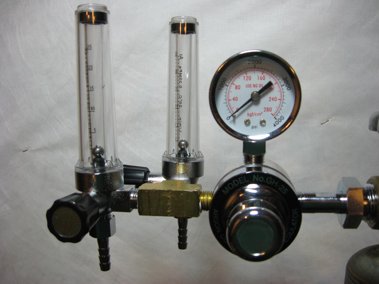

    I've got 3 of the chrome regulators and never had a problem other than a blown pressure gauge. The new ones may be higher quality, but old design allows you to make a dual flowmeter for purge. Click image for larger version.

    Mike, I'm surprised that you're only aware of "a couple" cracked Everlast flowmeters.
    Over a year ago, I informally counted (and provided links to) six different forum members reporting cracked Everlast flowmeters in this related post:
    http://www.everlastgenerators.com/fo...8076#post18076 {/quote]
    I didn't mentioned, we did have a bad batch of them "at one time" awhile back, as that was a unique case. And we handled that, sometimes we do have an issue like other companies, but all in all there is no problem with the regulator. And as always we resolved any problems. It was something sort of beyond our control.

    Mark: I'm disappointed by the initial reply you posted here, which appears to downplay the severity of the safety problem reported by the original poster, by instead discussing how one flowmeter that you own has been in service for 4 years (which has nothing to do with the potential safety risk of the *cracked* flowmeter, intended to contain in excess of 2000 psi in normal use, as not only reported by the OP but similarly reported by apparently many other users.)
    Have you actually tested *in a reliable way* the flowmeter you mentioned is in service to verify it's actually crack-free, and also otherwise safe? (e.g., has a properly functioning safety valve, and no main valve seal leaks?) The problem with these "hairline fractures" is that a simple visual inspection is insufficient to find them. Finding them reliably, IMO, requires using something like a leak-detection solution applied liberally while a flowmeter is under pressure, or submerging it under water while under pressure. Or at least verifying that the tank pressure gauge on the flowmeter registers full pressure long after the tank knob has been turned off, to hopefully provide some assurance that there are no cracks which are leaking.
    If your flowmeter hasn't passed at least one of those tests, how do you know it doesn't actually have the same hairline fracture reported by many others? I can add some personal experience with a cracked regulator, that such crack is not something I'd expect someone to be able to easily find by naked eye.

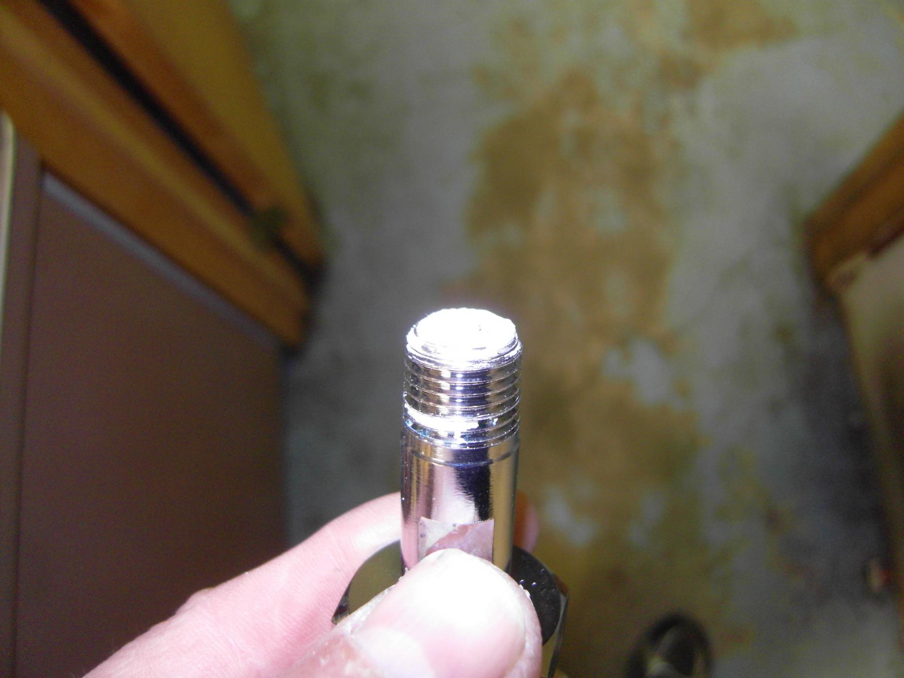

    Regulator for MTS250S plugged with thread sealant when I was going to use a second bottle with different gas I thought I would use to regulators and a Y manifold but it would not flow took it apart and the tank inlet was full of sealant.
Name:	regulator inlet pluged with sealer.jpg
