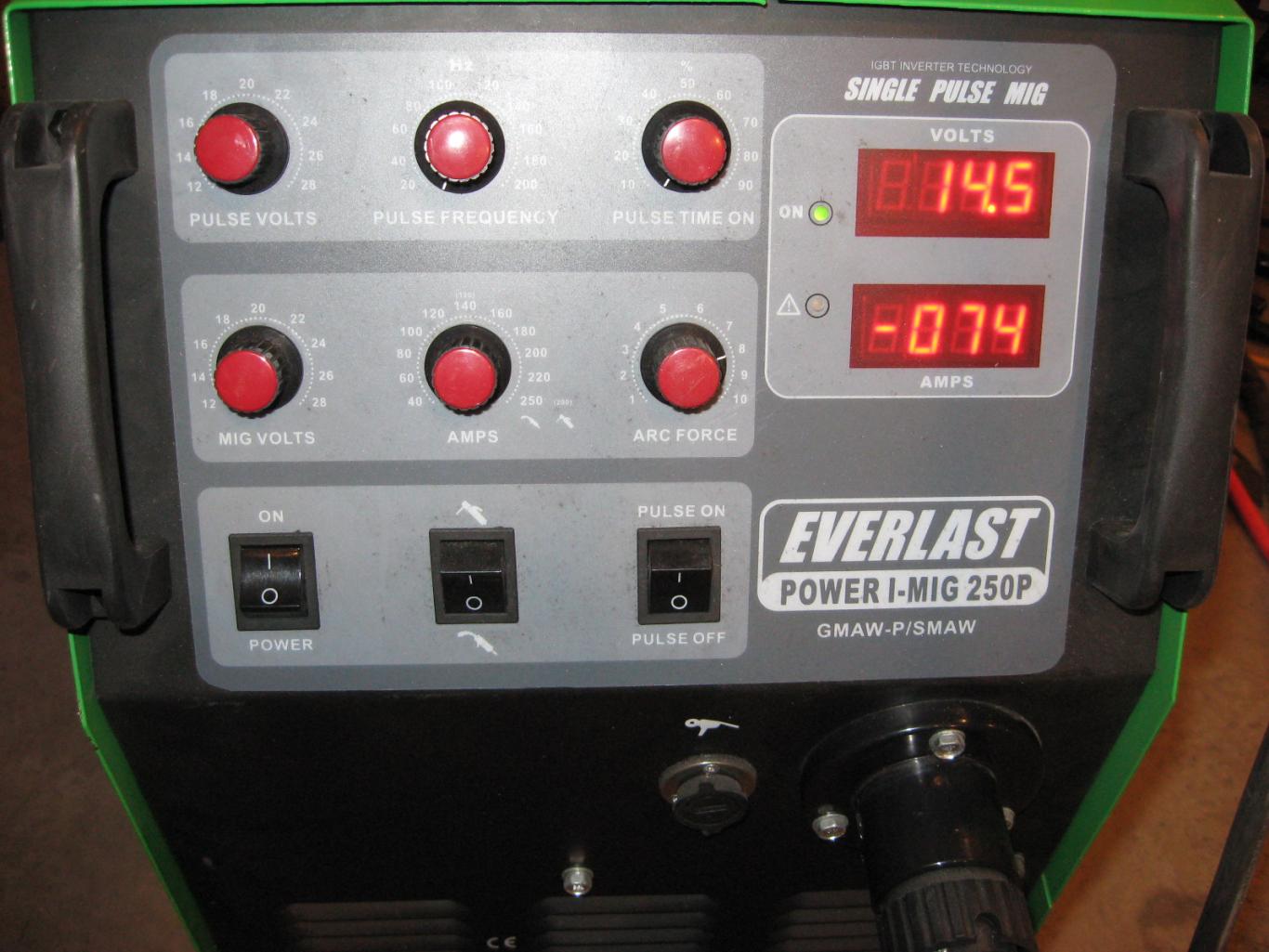

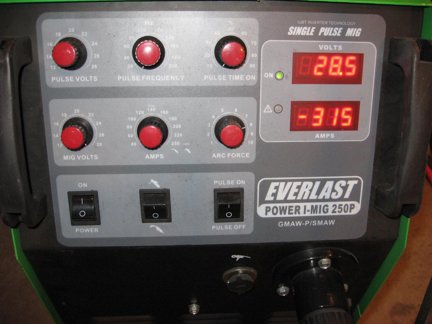

    I think you would love the 250P. The advertised specs aren't exactly correct... it has a little more range. Volt range is 14.5 to 28.5 and wire speed is barely moving to around 400 ipm.

    Thanks, Zoama. I was worried that the posted 26 Volt max was right on the bottom edge for spray on 1/2" aluminum per the Miller guide.

    The 250P will spray with ease. In testing on steel, I turned the volts and wire speed to maximum and it sprayed cleanly using 75/25 argon/c02.
