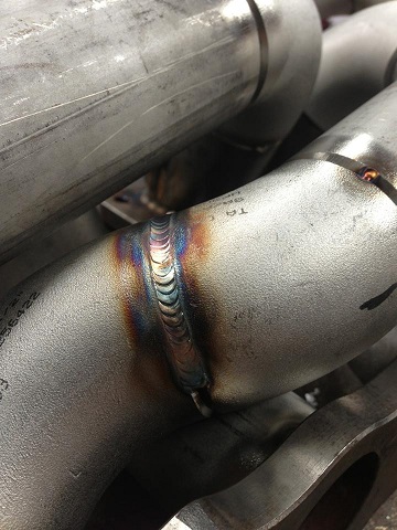

    Been a while so I decided I would post some quick projects I have been working on with my 200DX. Everything I do is pretty much automotive related.
    Schedule 40 304SS Piping for a turbo manifold. Beveled edge and backpurged and the inside looks just like the outside as seen here with full penetration.

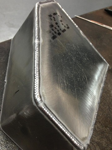

    Aluminium Icebox for Turbo Car

    Beautiful welding as far as I can tell on my phone.
