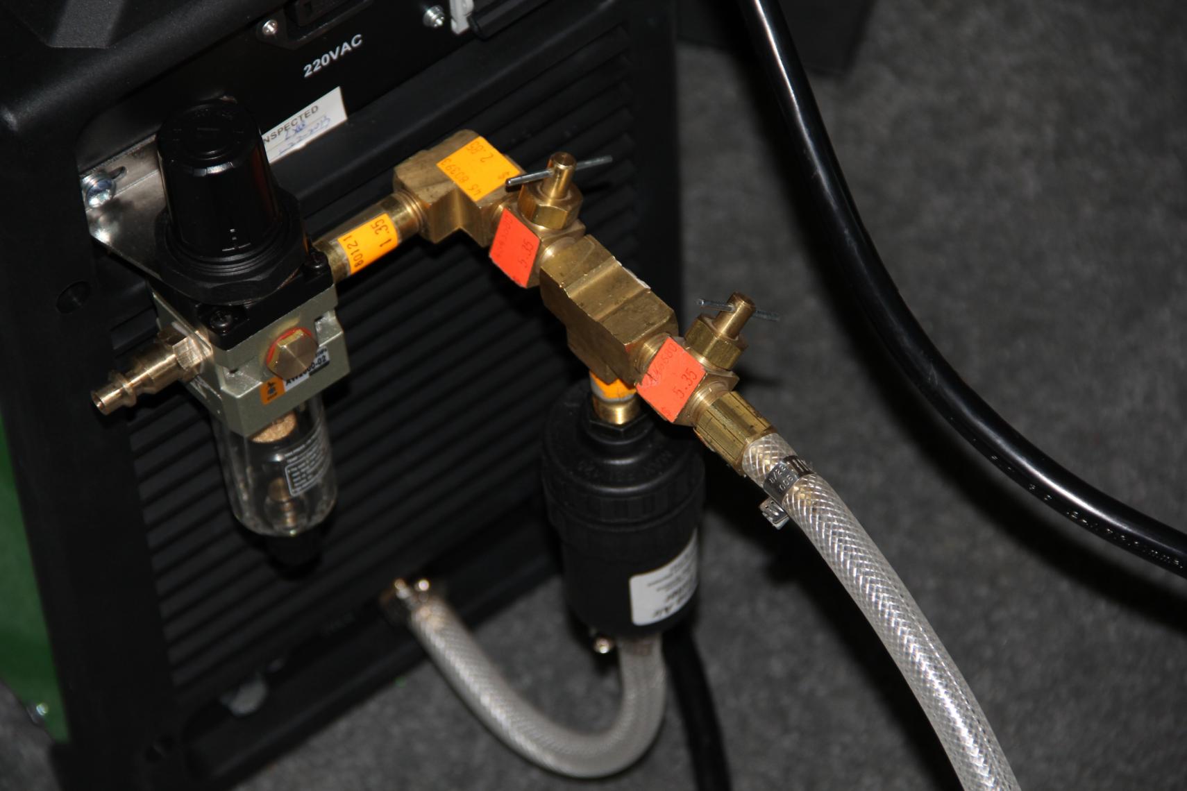

    whats the best way to plumb in the air dryer right after the fliter/reg thats on back of the powerultra205p
    iam thinking of hard plumbing from filter to air dryer and a ball valve on so i can use argon or air
    so filter valve then tee one side down to air inlet one side a valve from the gas
    someone posted a pic of theres a month back looked nice and clean he had both air and argon going though the dryer
    This is the way I did it on the 256 but the argon never goes through the dryer. The QC connects directly to the flowmeter line. Click image for larger version.
Name:	IMG_1156 - Copy.jpg
ID:	10011Click image for larger version.
Name:	IMG_1155 - Copy.jpg
    I cut a cheap 10' 1/4" air hose to make this. It all works perfectly and never gave a problem.
    where does the drying go ? i might be missing it in pic
Name:	air argon.jpg
    is this a good idea ?

    I have a motor guard filter on my supply line. I suggest the M-60 kit or M100 kit since they come with 3 filters and side inlet/outlet http://www.automotivetoolsonline.com...it_p_9417.html
    Quote Originally Posted by travis View Post
    Looks ok to me but I prefer the quick couplings since there's no way to get it wrong. Whatever works and suits you will be fine.

    That looks fine. Filtering the gas will not hurt anything. Changing the filter might be a little work, gut all worth it. Moisture really does miss up the cuts and does no help welding either.
    Was there a reason you did not go with the ball valves? FYI, I had trouble with 1/4" NPT quick connects leaking years ago, and have it all clamped, I loose no gas that way, esp on the couple 150s I still have.
    that picture was taken off a post on the forum i will use ball vaulves
    would there be a best type of pipe to use or any to stay away from ....brass copper black pipe or gavlvinized ?

    Ok on the first two, stay away from the last two. Black pipe = rust, galvanized can shed zinc particles. You can also get a nice three way ball valve so you don't have worry about mixing things up.
    Ideally, the added filter will come before the water trap/filter on the rear of the unit...not after.
