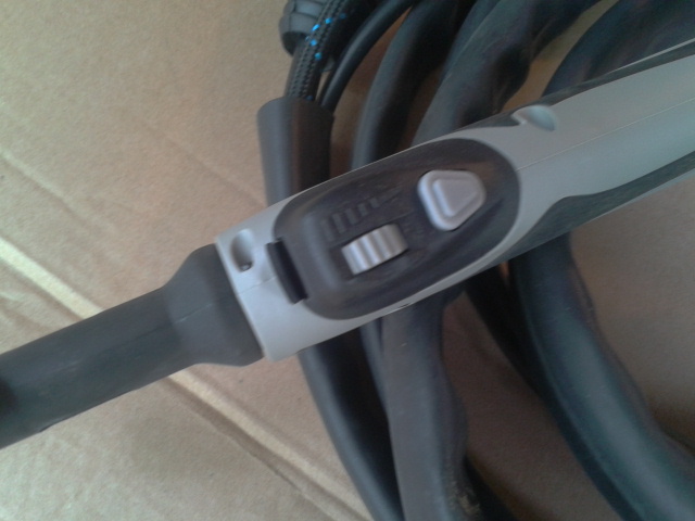

I also opted for a WP26 Air Cooled Tig Torch with Amptrol. Not that impressed with the Amptrol, as it requires a lot of force to adjust and is fairly small to grab with Gloves. Guess I will try it and see if I can get used to in in actual use. Got this, as I do not yet have a cooler, and wanted to use the machine at lower power until I either built one, or got the W300 Cooler from Everlast.

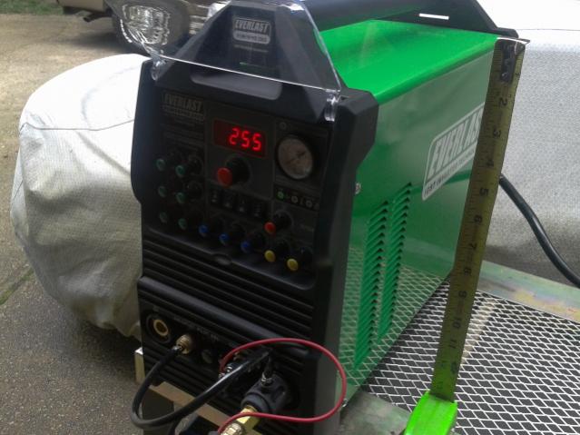

This unit is Huge, and I will need to build a new welding cart. The HF Cheapie that I have would need a top shelf extended by several inches, and the front and rear end caps of the PP256 ARE the feet, so the top shelf needs to be 25" x 10" minimum. One option is to Glue some rubber feet to the bottom of the case, so it rests on the shelf, but I want to build a cart that it will fit right, and that will hold 2 tanks (Ar and Trimix).
Also, I noted that it is quieter than the 250EX as the duty cycle on this machine is only 35% vs 60% for the 250EX (Hmm, I have a 2000CFM Dust Collector for my woodworking, it has a 4" diameter hose, add a flange to fit the back of the 256s, and raise the duty cycle to 150% !!! (just kidding Oleg).
I powered it up, after the shake test, (rattles), and it passed the smoke test (no smoke). So far so good. I'll be testing all the functions this evening, have to focus on my day job to pay for this.
