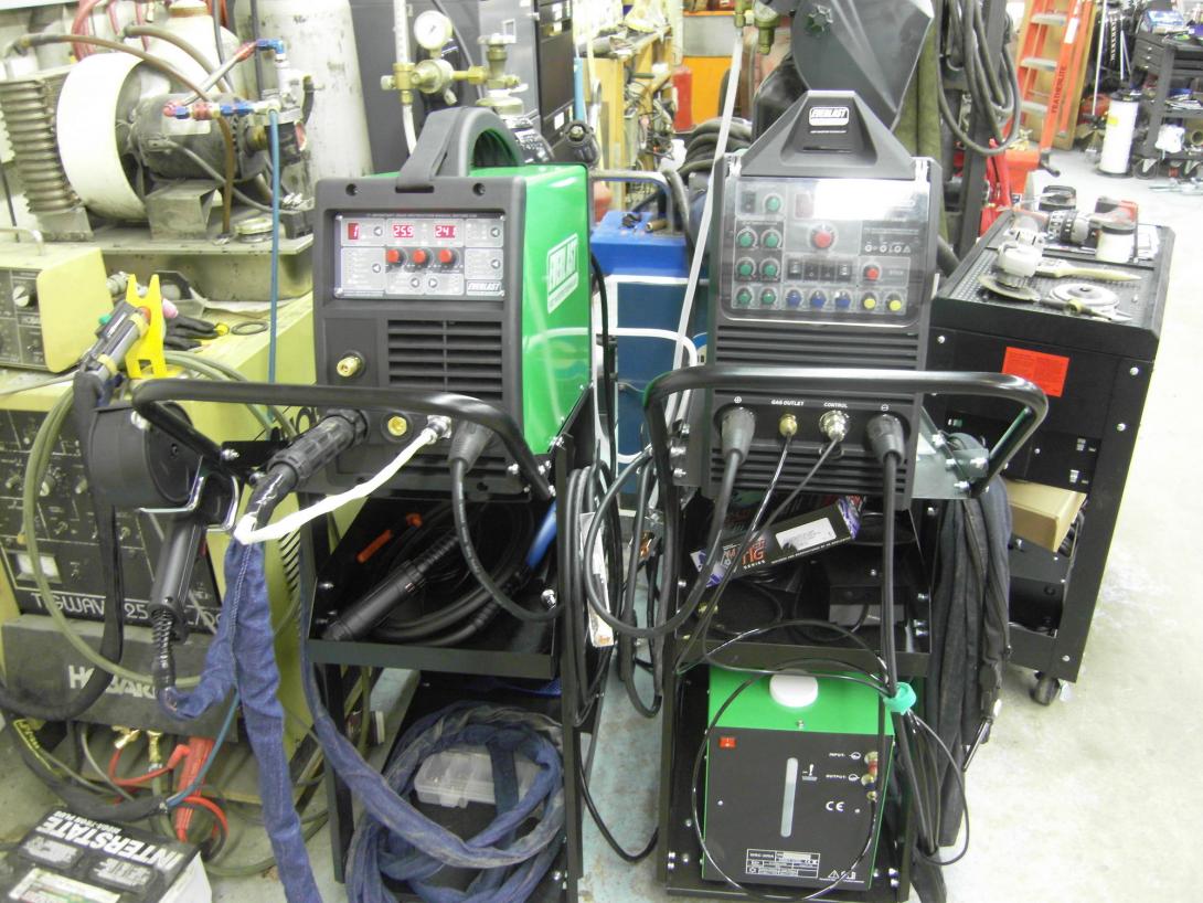

    Well got the new PowerMTS250S set it up by put 4043 .035 Aluminum wire in the spool gun it is the maximum size the MTS Spool Gun can take buy the tag on the cover. The MTS250S manual said when put in Synergic Spool Gun mode it will default to .040 wire size but it has a .045 light but the factory manual shows .040 in its picture.
    On page 24 of the PowerMTS250S manual on how to setup the Synergic and Manual functions:
    Number 3, it says( Select the wire diameter of wire being used. Select ALT default unit to full manual mode (MTS250S).)
    The factory manual on page 8 of the PowerMTS250S manual on how to setup the Synergic and Manual functions:
    Number 3, says (Select the wire diameter of wire being used. Aluminum will default to .040 & ALT. so that the wire will not jam or birds nest while feeding.)
    So never using a MTS250S or Synergic before it is all new to me so what is (ALT).
    But just setting it to Synergic Spool Gun mode and wire type to Al 4043/5356 and it Automatically goes to wire size .045 then turned the 100% Argon on and welded for its first time will try more later had to put this in the forum before going in for the night.

    There are a few corrections in that area that need to be made. But it's fairly self explanatory once you start using it. .045 is the only selection, but if you have .040 it should be close as well. The Alt was deleted after the 210S. If you want to restore defaults, just change the unit out of the synergic mode and cycle through the processes until you return. That's one of the corrections that should be made. Another is that the synergic feature has changed a little from the 210S which was used in part to base the manual on...the amperage/wirespeed feed is NOW the control knob, that adjusts the voltage up or down automatically instead of the voltage adjusting the wire speed. Of course you can override and make a new adjustment at anytime, setting a new ratio of wire speed/voltage for the welding session that will be remembered short term, if things are to your likeing.
    The bead you have looks good, but it unfortunately does not appear to be in spray. Spray itself is a quiet MIG mode, with light hum or hiss. If you hear the spattering sound of short circuit while welding aluminum, you are not welding it correctly with MIG. Spray transfer is the only acceptable process. I suggest turning up the wire speed.
    Mark
    Well that clear up a few things thanks. I upped the wire speed but nothing happen but found out the wire speed is on the side of the spool gun on the spool gun for my Power I Mig 205p it is not connected to anything. Got the wire speed up to almost the end and it just hums and hiss a little no splatter at all I did not even clean the work before or after welding it, see picture.
    I will get some time later and try steel and stainless with the spool gun in Synergic and Manual mode just need practice. I like the PowerMTS250S and MTS Spool gun very much. Just wish they would have put the inlet gas fitting to one side or bottom it hits the Argon tank but it not to bad I have to move the welder to one side to get the door open anyway.
