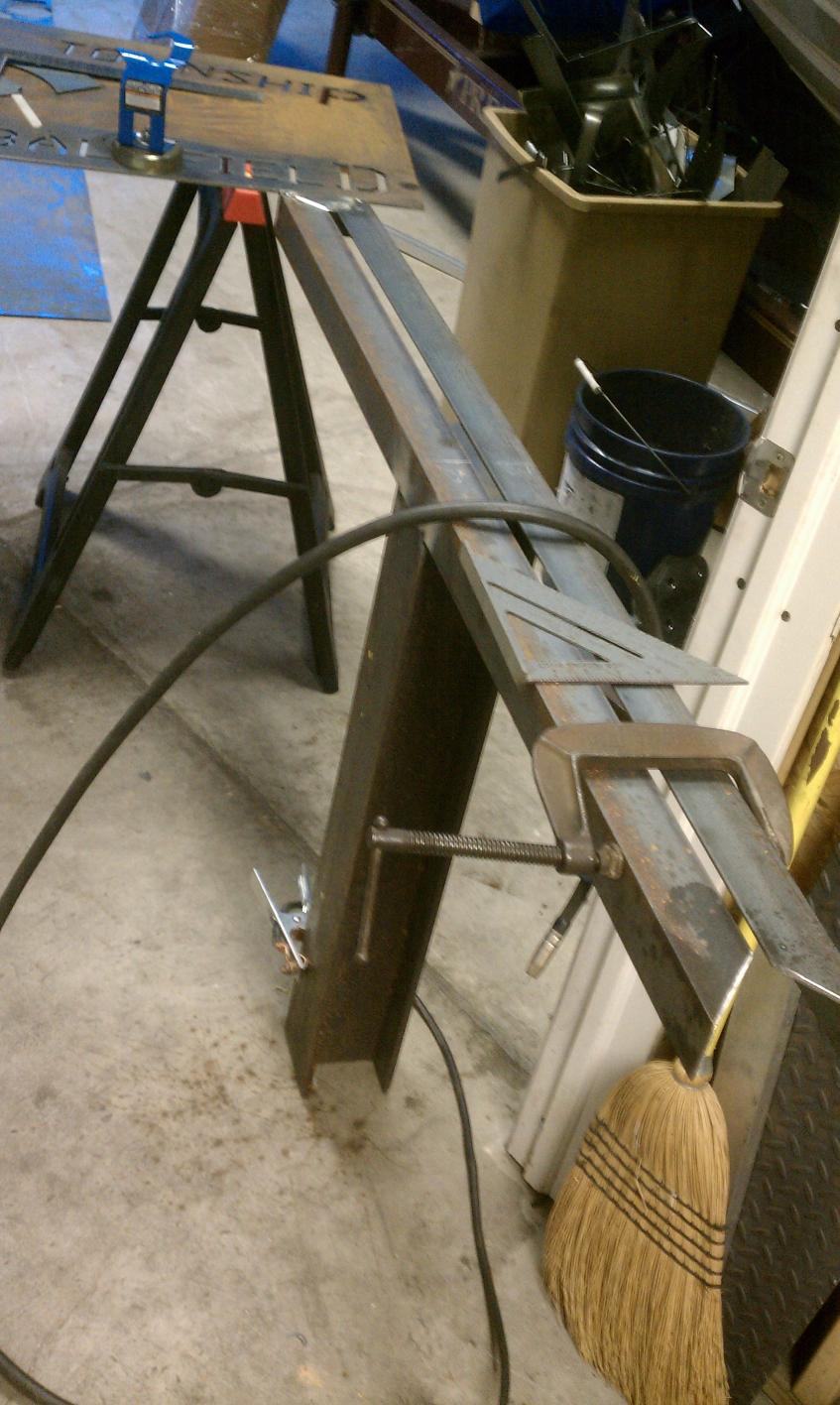

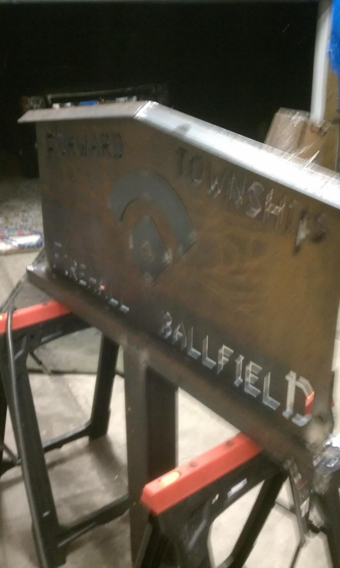

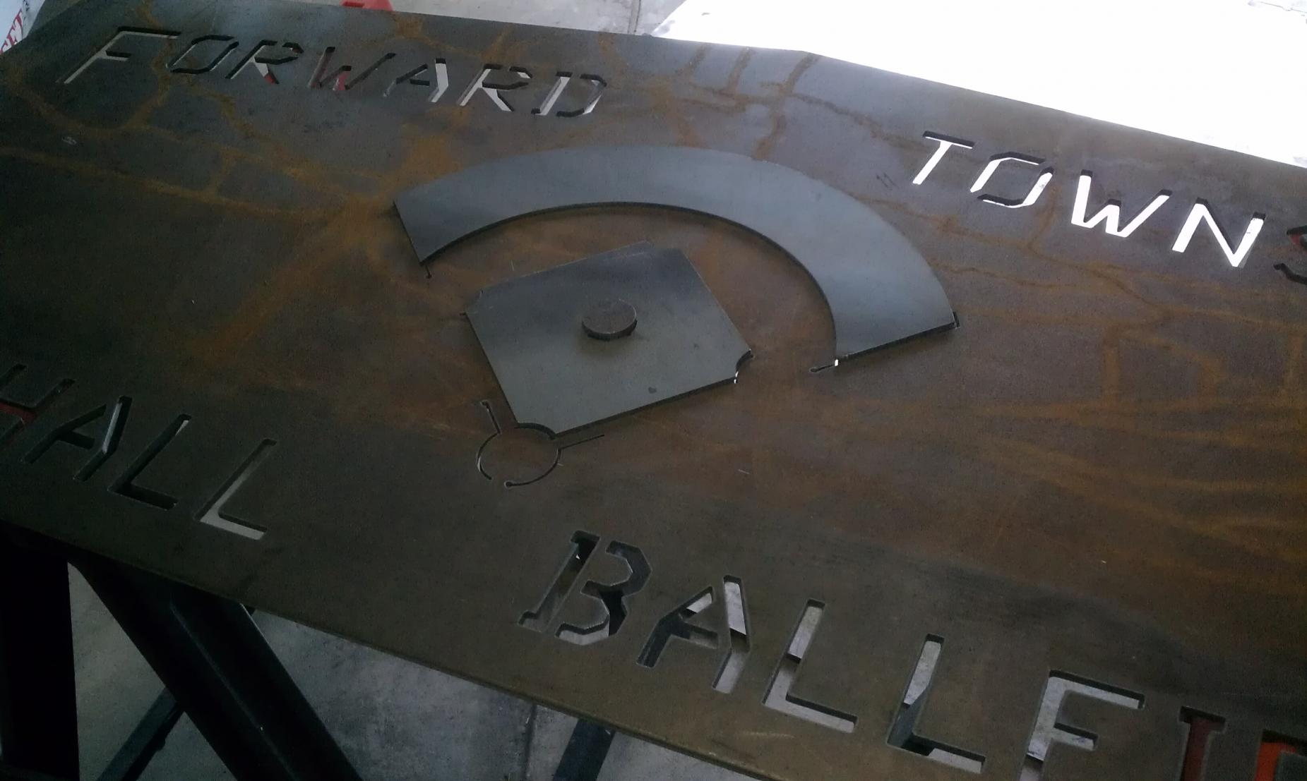

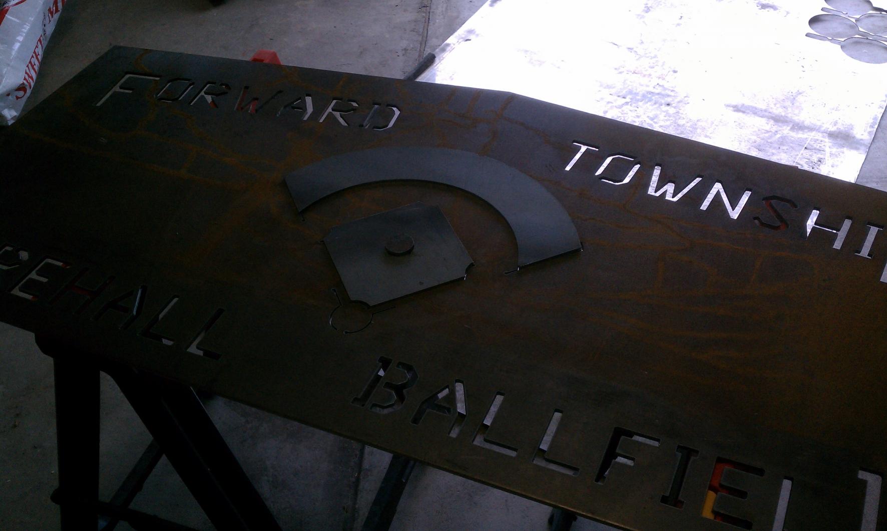

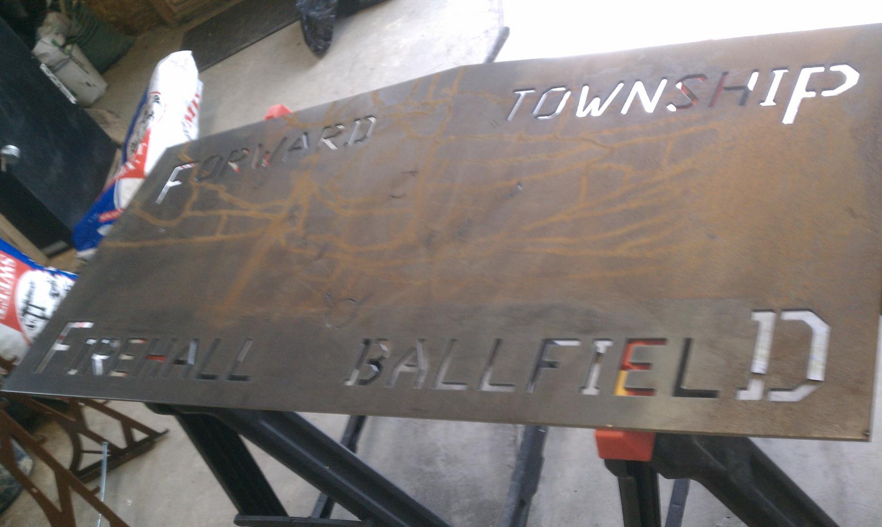

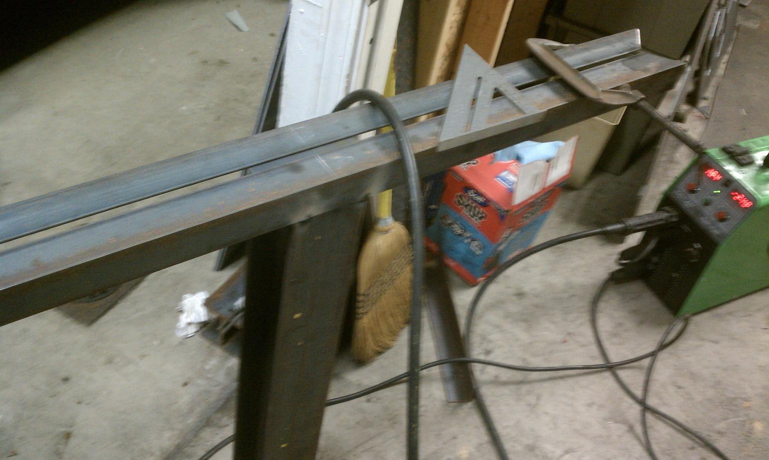

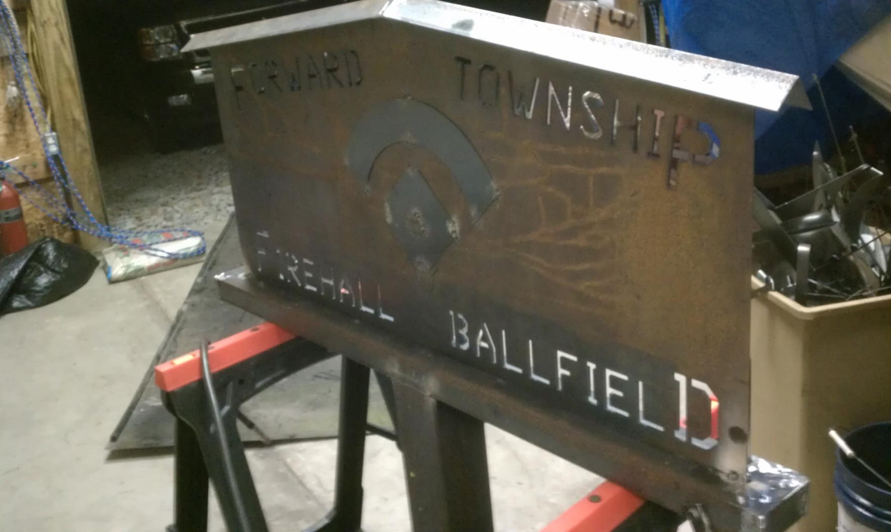

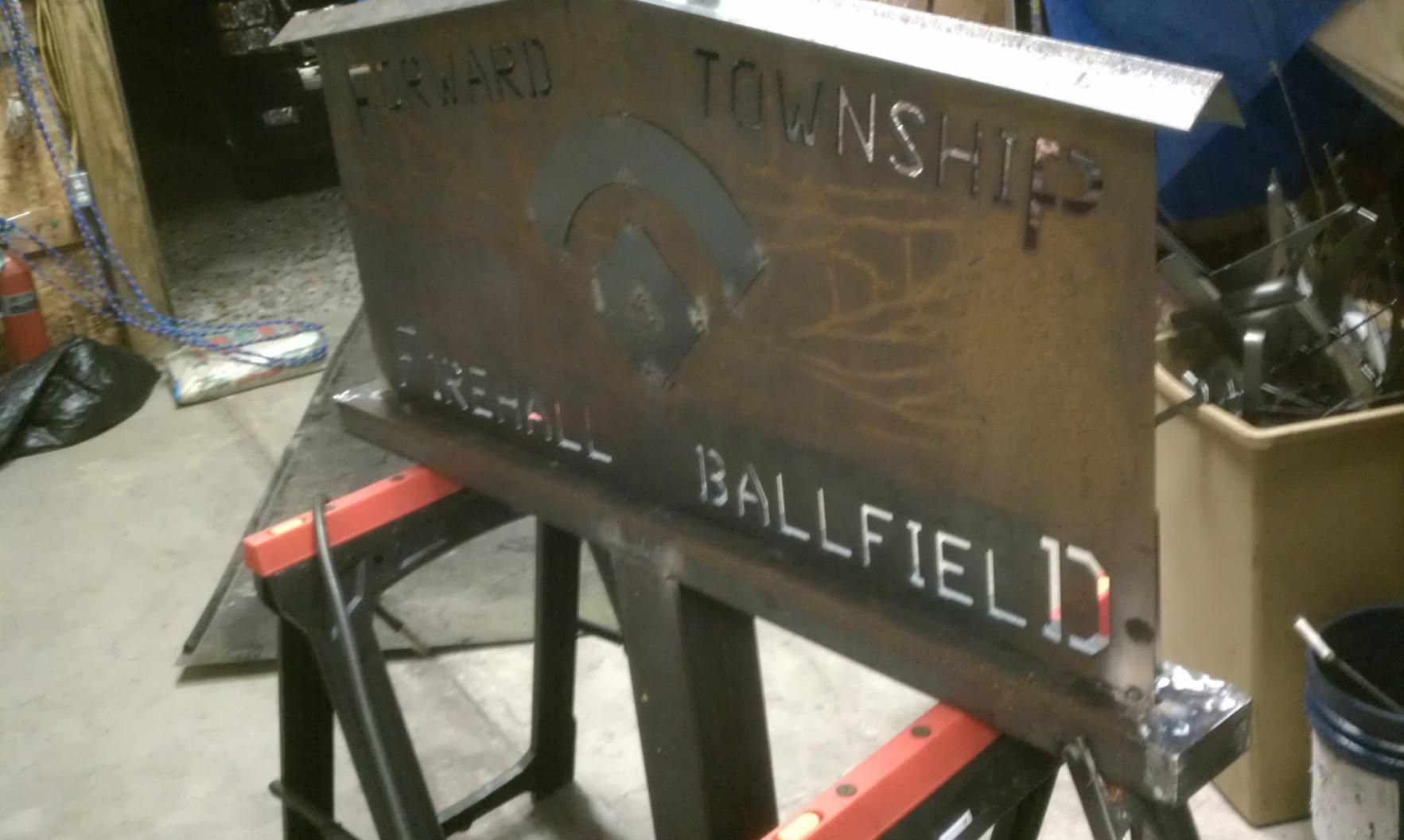

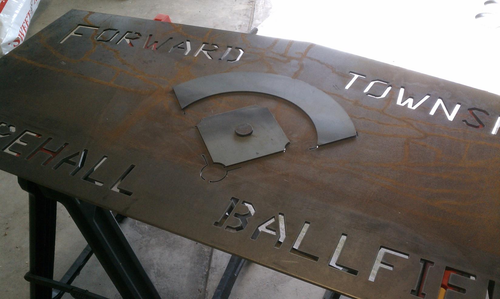

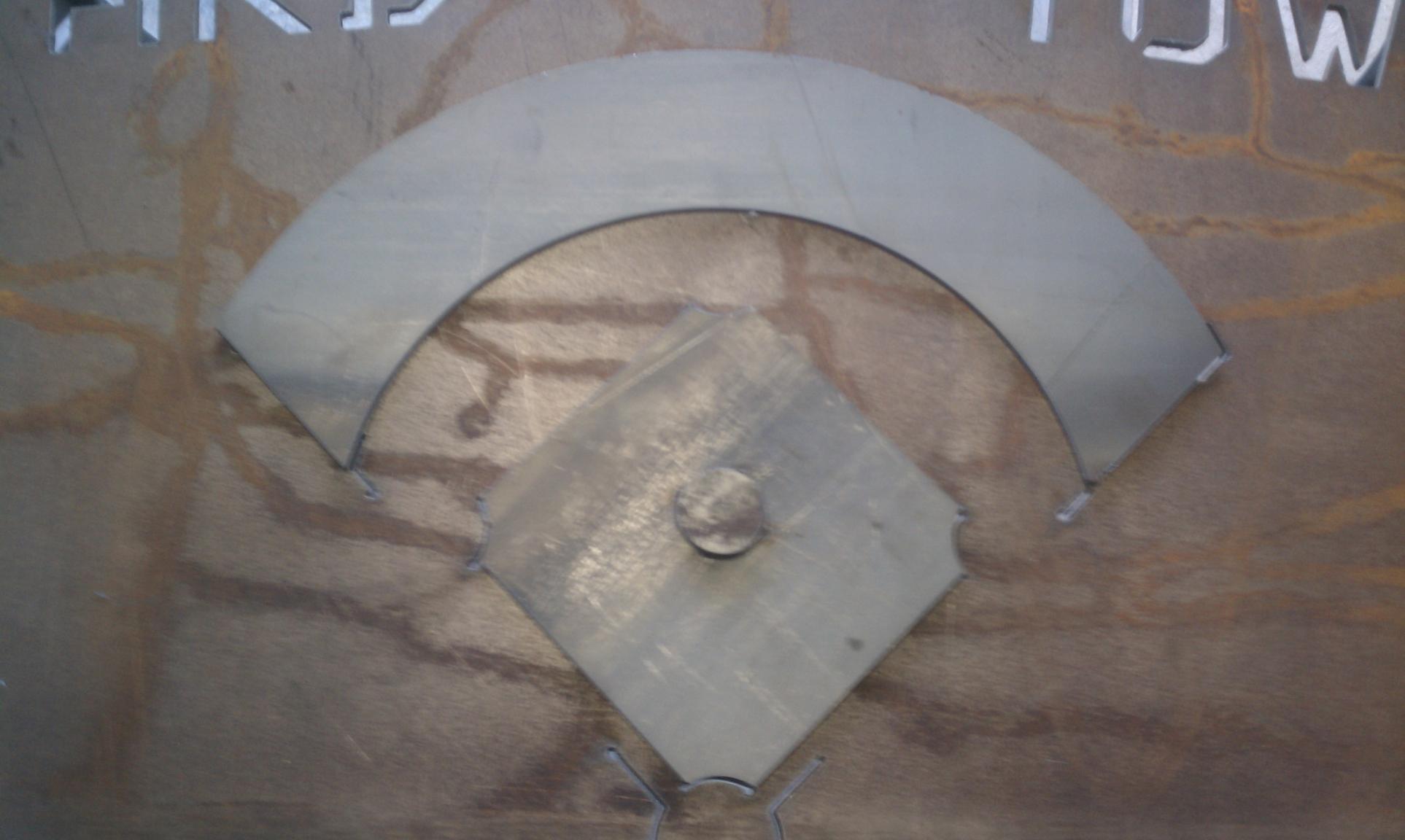

    At the fire department where I'm the assistant chief has a baseball field. It hasnt been used in a few years and became a little run down. I think the township didn't have enough teams to use the field. This is the same field where I played baseball when I was little. Had a lot of good memories there. Well anyways, they ended up needing the field this year, so some guys from our fire department assisted the athletic association and their volunteers and put in some time and helped them fix it up. New paint, new infield dirt, some stone and a little elbow grease went a long way. I have a wood CNC and made up some signs to stick around the outfield fence who donated some cash to buy supplies.

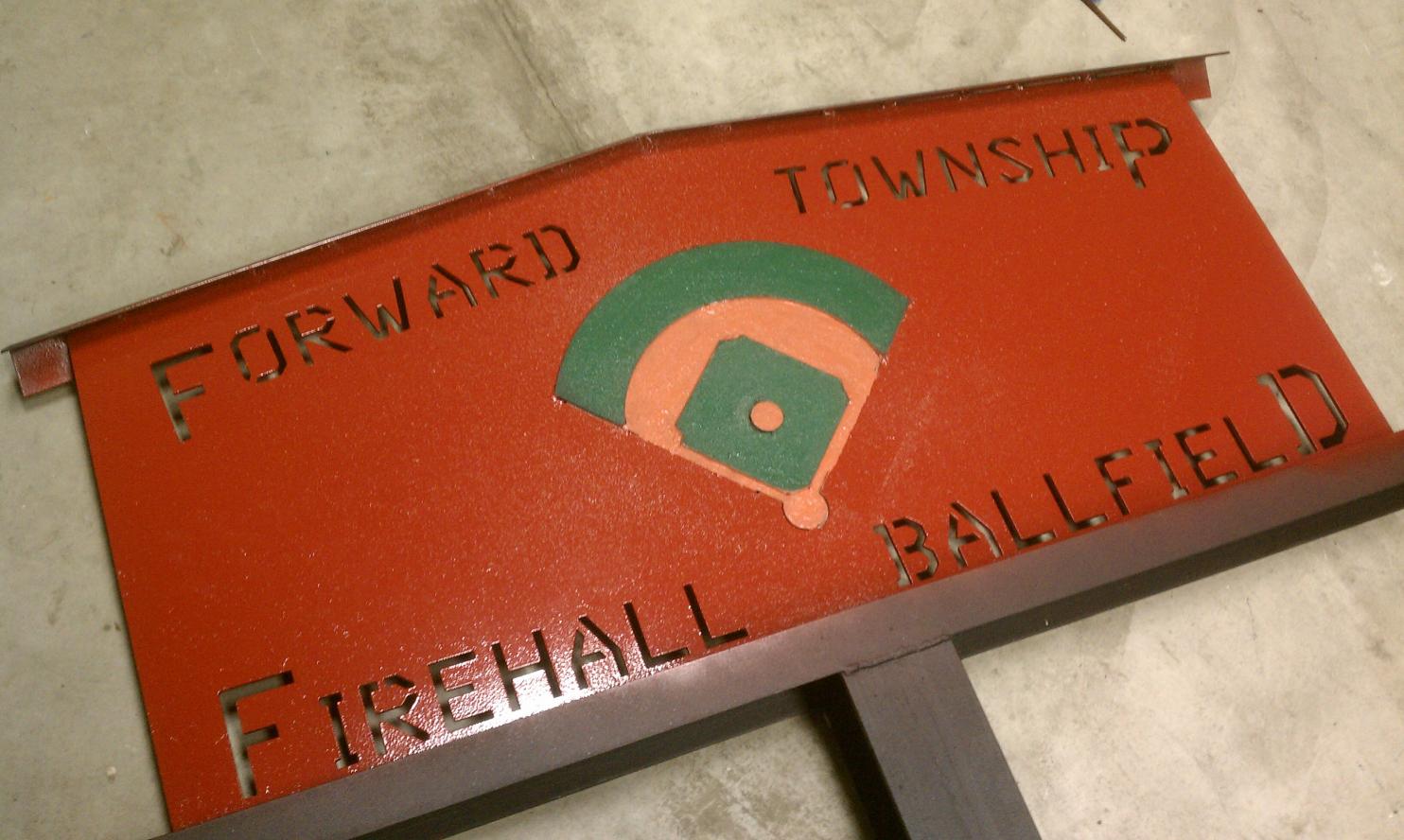

    I had some extra steel laying around from past jobs so I thought I would wip something together for a new sign for the baseball field. Here are some pictures.
    I used a W4x13 for the vertical post with 2"x2"x1/8" around the top for a seat for sign. The sign itself is made from 3/16" steel. It was cut on a CNC burn table using the PP50 and welded together with the I-Mig200.

    A little more paint added yesterday. I sprinkled some sand over the green & dirts colored paint to give some texture.
    Next step is the install at the baseball field, some touchup paint and it will be ready for the grand re-opening.

    Cleaned up really nicely. It will look great installed at the field.

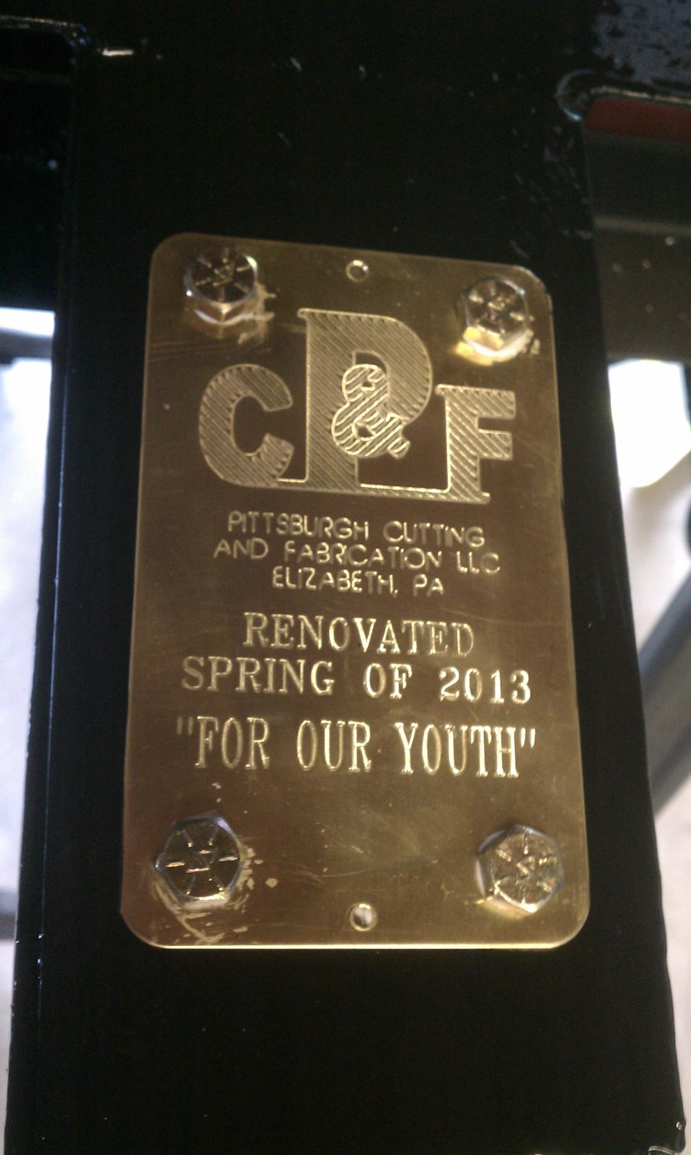

    I had an extra brass plate laying around so I engraved it and bolted it on. Just a little something extra. NOW it's complete... I think.

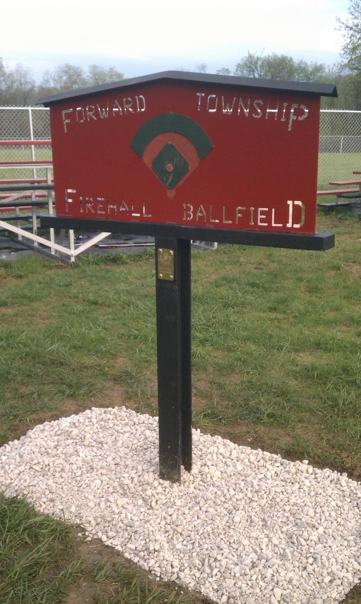

    Finished it off by adding a little stone, and now it's complete!

    Looks great! The engraving is very sharp, a nice touch. That brass plate is bolted on... I hate to think the worst of people, but are the bolts vandal-proofed? Threads permanently fouled, maybe?
    The nuts are tacked on in the back just in case, and as a little something extra, the whole brass plate is glued on with epoxy.
    Not vandal proof... just vandal resistant.
    And there is 80 lbs of concrete holding it in. Overkill is under-rated.
