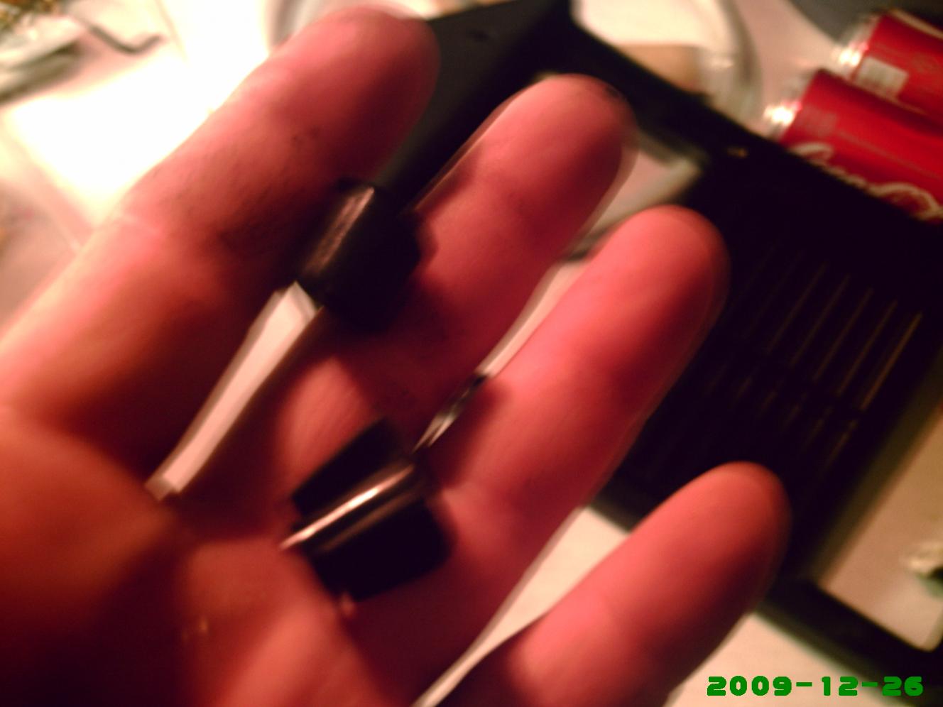

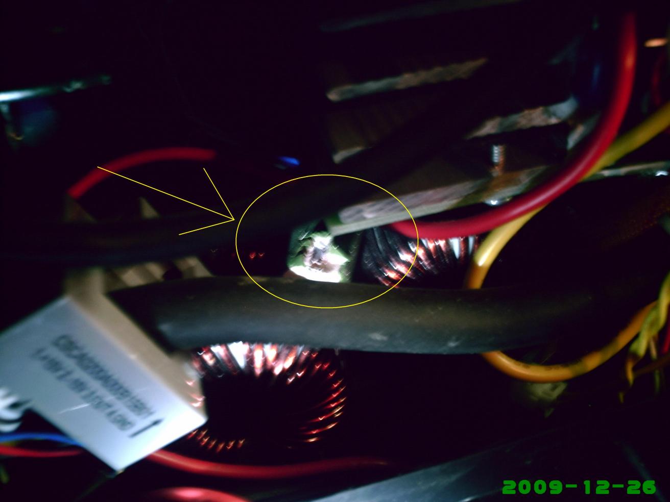

    I have a Power Master 256, Im using pure argon. I found some issues with the machine itself. Upon inspection The front cover was loose. So I removed the screws holding it on and plastic parts fell out, those were the pieces that hold the plate for the dials on.
    Then I took a light and looked in and there was a green ceramic tube that was broken or Chipped looking, then i seen it had a wire fallen off.This pice is towards the front of the macine and soldered to a board below a heat sink.
    My total weld times were only about 4 minutes on thin material at about 1/4 to 1/3 power of the welder, It had real inconsistency with heat as far as arc strength. But it seemed the foot controll had no overall effect on the heat in either 4t or 2t mode(I realize it only works in one mode) and i am real concerned about what I think is a resistor or something that is broken inside the machine and the Outer plasic face plate being broken, I have had the machine for about two days and have only checked it out one night for an hour goofing around on scrap.

    You will need to report the damage to the office as soon as possible. This is the type of damage that we see happen in shipping.
    Pictures of Damage
    Keep getting my email to warranty@everlastwelders.com returned.I will call tomorrow but This is here so it can be looked at.
    I would Like to say that the packaging was ok to me. I dont see how this happened but I guess its a bumpy ride. Just my luck sometimes, I know well get it figured out, I did send emails to the warrant area, I did register my product when I got it as well, looks like a total replacement im guessing at this point.

    This is not a warranty issue but rather a shipping issue. A phone call is the proper protocol in this instance. When the changeover of the site happened, the emails got disturbed, so I cannot say for sure if the correct boxes were pointed to.
    Packaging condition is not a good way to determine shipping damage. As I have stressed here before, customers need to be sure to go over their units thoroughly to inspect for this type of damage. Most of the shipping damage happens internally, as components get jostled around.
    Keep in mind that the office doesn't open until 9 pacific time. You may not be able to get through until an hour later depending upon the early morning call volume.
    I wish your pictures were a little more clear.....it would help to see if there is any way to get you up and running quickly until we can get this resolved for you.

    Well I looked closer and I cannot fix this with parts. Its going to have to get shipped back, I sent an email to you. I dont know what we have to do to get a claim to UPS but well get it going. The macine seems great if UPS would have shipped it here in once piece.
    I would like to say that this is NOT EVERLASTS fault but a UPS problem from shipping. The company is working with me to resolve the issue.
