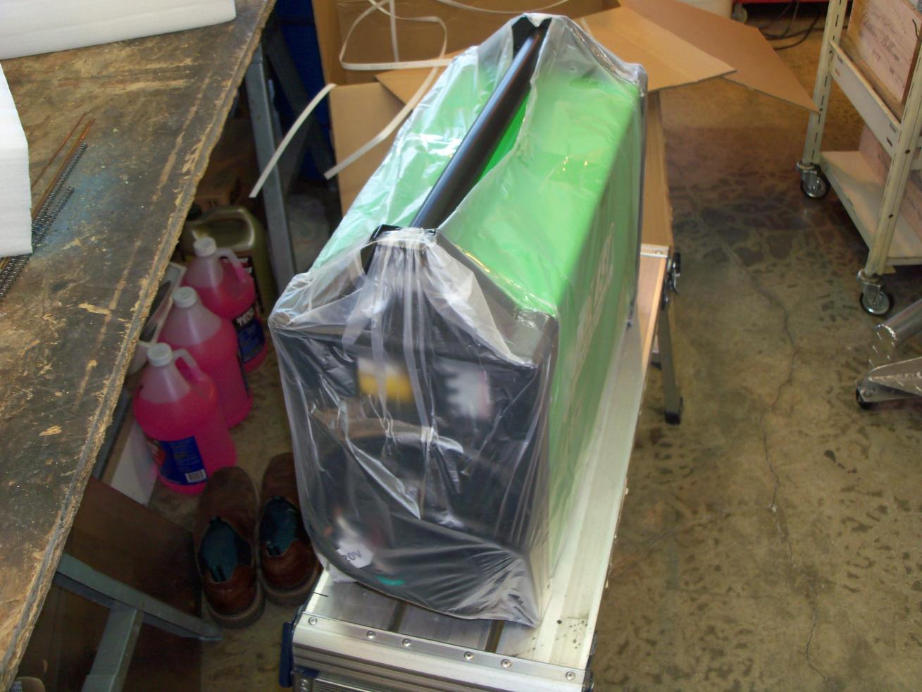

    Well, it WAS in the box, and it was Perfect, nothing broken, bent, or scratched. This is a nice machine! but looks alone are not enough...
ID:	11087 Click image for larger version.

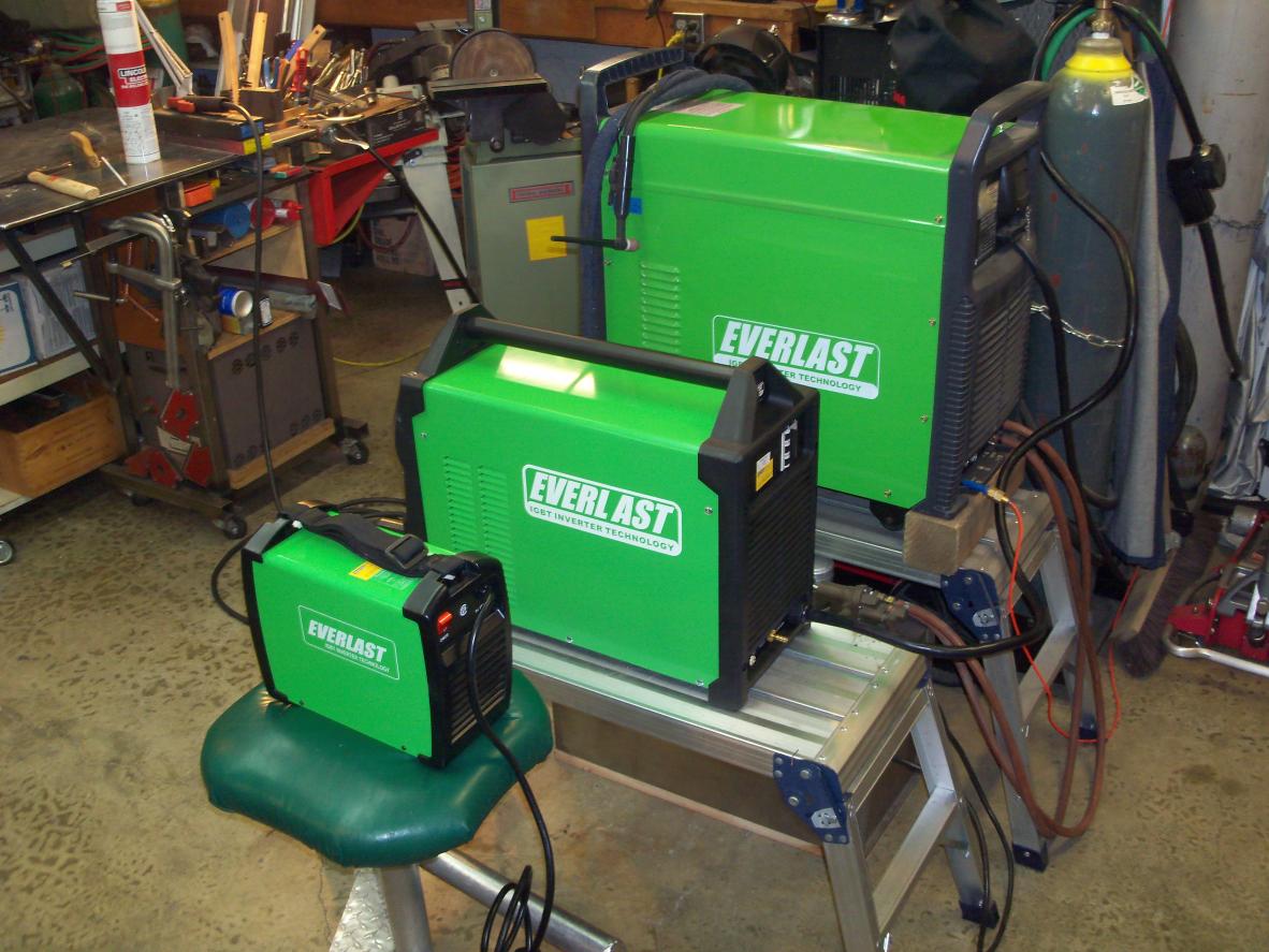

    Here is the Green contingent of the shop, Legacy 250 EXT, 255 EXT, 140 ST. There is nothing to be feared if you are considering a Green machine.

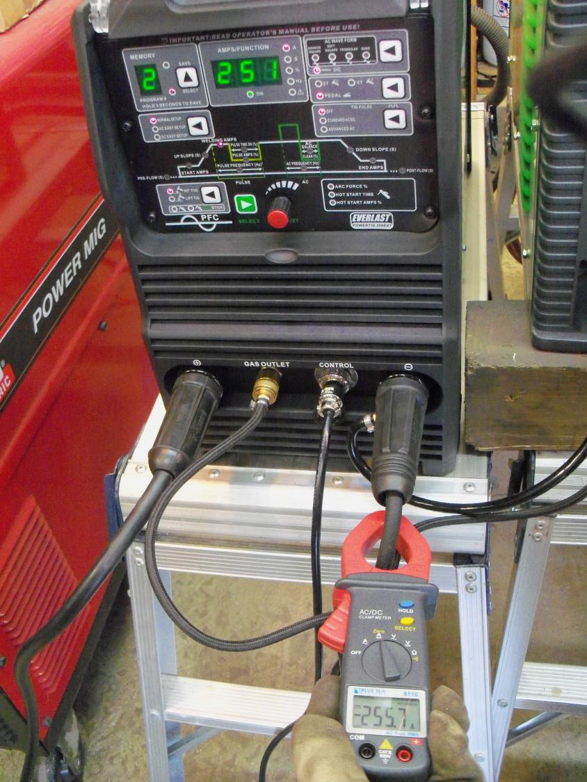

    Here is a shot of the full DC output showing 251 amps on the panel and over 255 amps on the clampmeter. This one goes to full power!
    Size comparison between the 255 EXT and the 250 EXT. I am using the 250 as part of the plumbing from my cooler to the old torch, which is plugged into the new 255. I suppose I could get some fittings and put the 250 out of work.
    End of Part 1
    Jim
    Really nice update! Impressed by the clamp-on probe DC test and look forward to the next installment in this series. They sure package the machines well now, don't they?

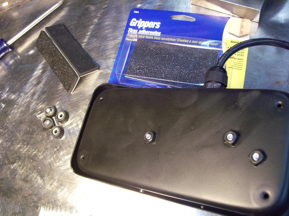

    The 250EXT is a really handsome machine but I've got to say that if all else were assumed equal, the more lightweight and compact 255EXT package would be more desirable of the two form factors if space and/or portability were a potential concern / issue.

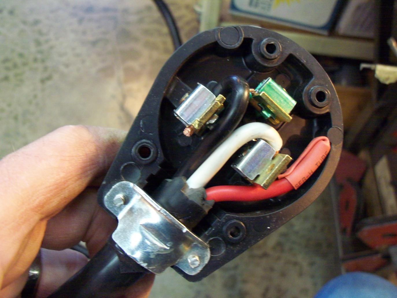

    After unpacking, I wired the cord end and watched for smoke, having seen none, I grabbed the stinger and lit up a few 1/8" 7018's and 6010's. All went well, but I didn't take any pictures.

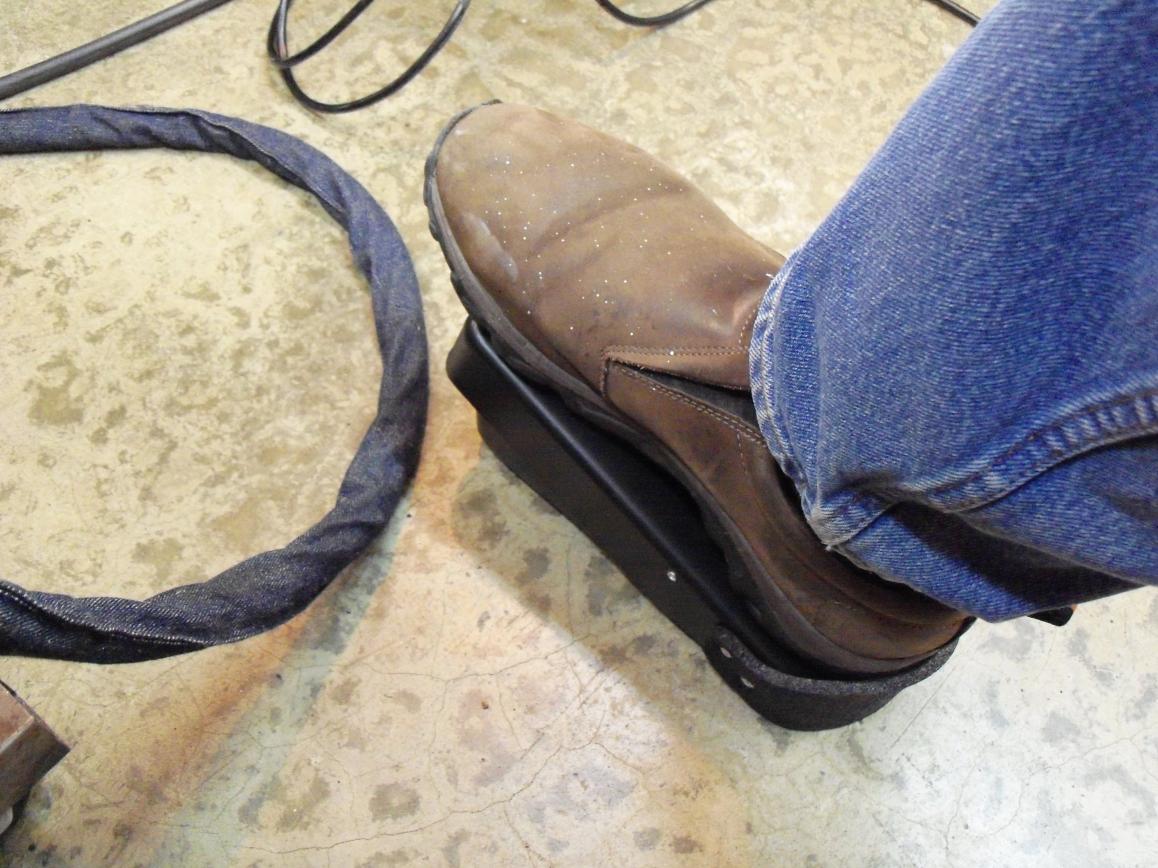

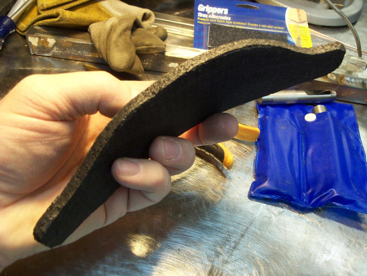

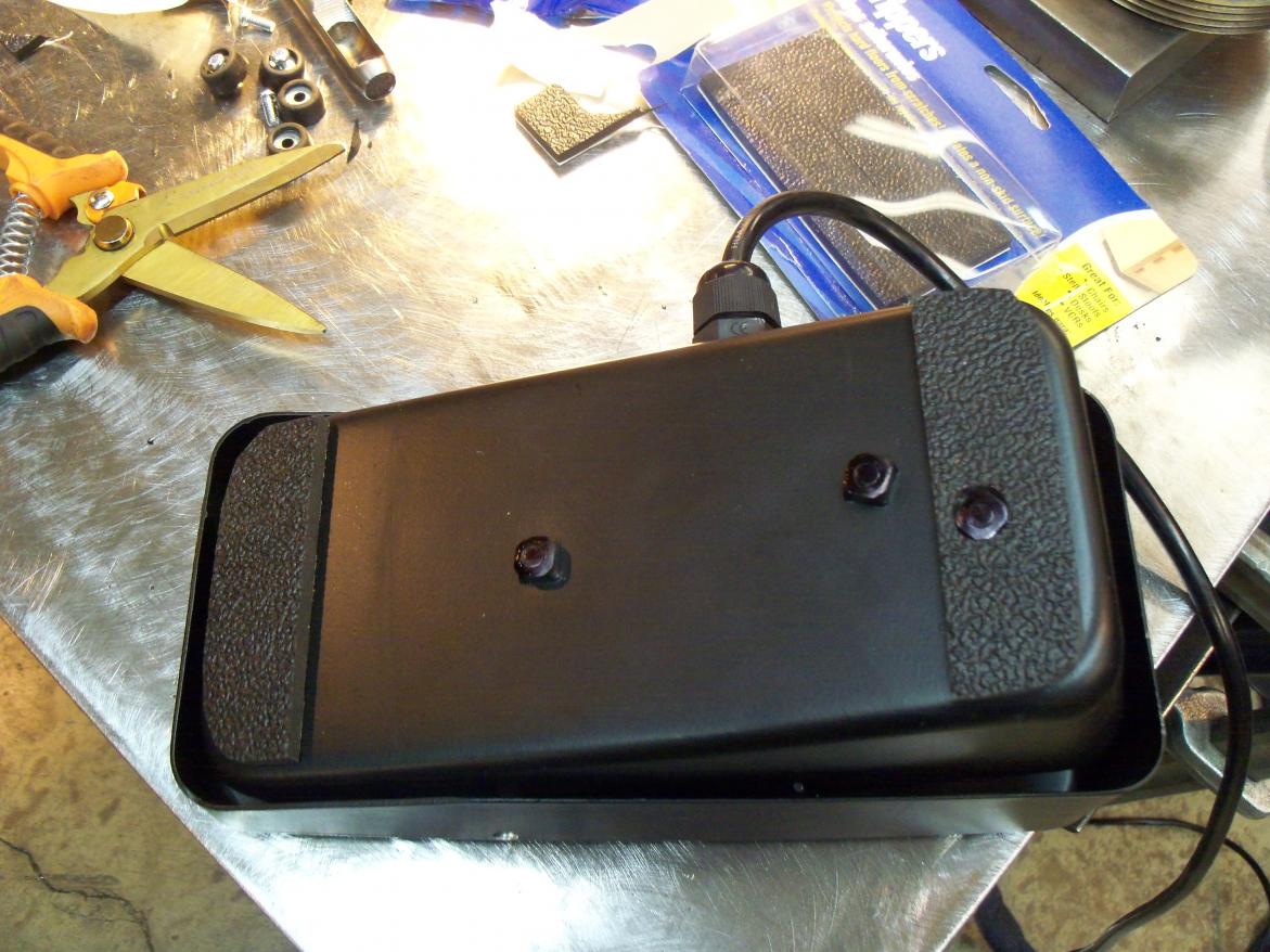

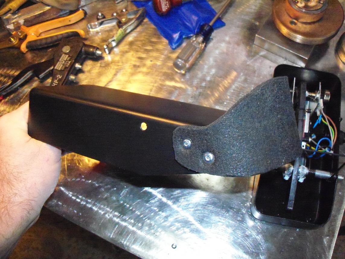

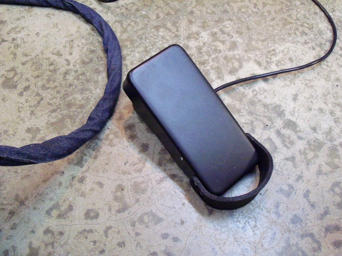

    I then took a look at the pedal in detail. I made the action a little smoother, and adjusted the pot to go full-scale with full travel. I changed out the feet and lowered it another 1/8".
ID:	11104Click image for larger version.
ID:	11105Click image for larger version.
    After locating the best position for my foot on the pedal, I made a heel strap from something like thin mudflap rubber. This works great, as it puts my foot in a position that pivots with my ankle perfectly, and I can scoot the pedal away and toward me almost like I am wearing the pedal.

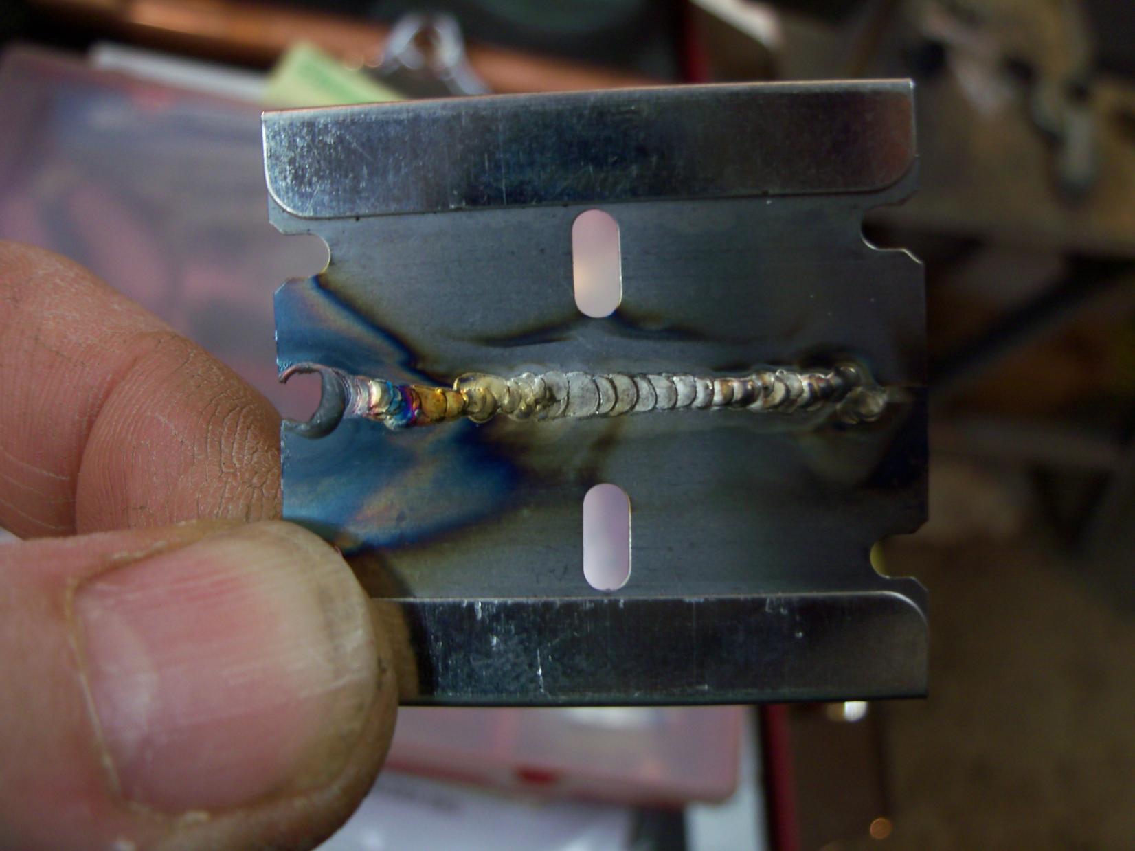

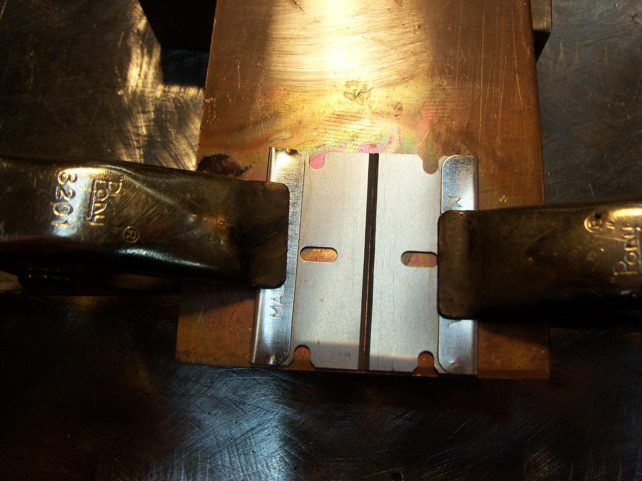

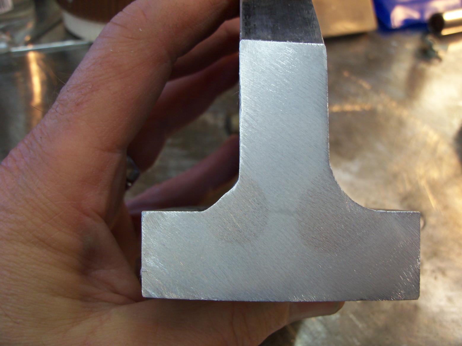

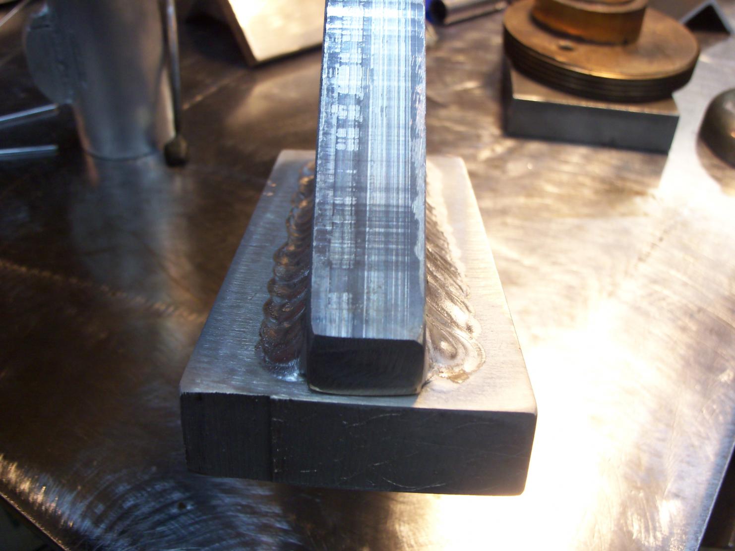

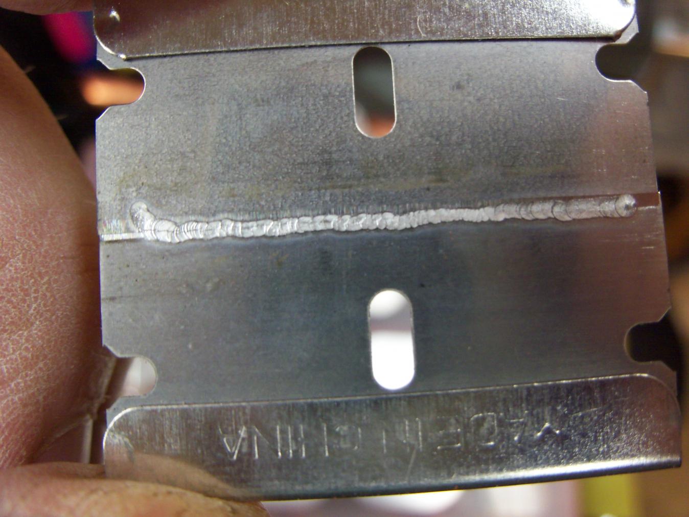

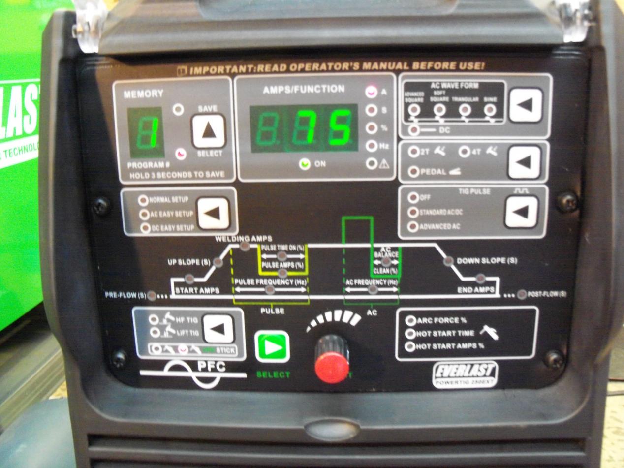

    In this episode, I will begin to demonstrate the excellent low current ability, on some stainless razor blades and, in the next part, some thin aluminum flashing. The razor blades were done using the lowest DC current settings, and some using high-speed pulse.
    This is one setup to hold the blades, another one had a polished guide to run the cup on, and gave the best results.
ID:	11122Click image for larger version.
ID:	11123Click image for larger version.

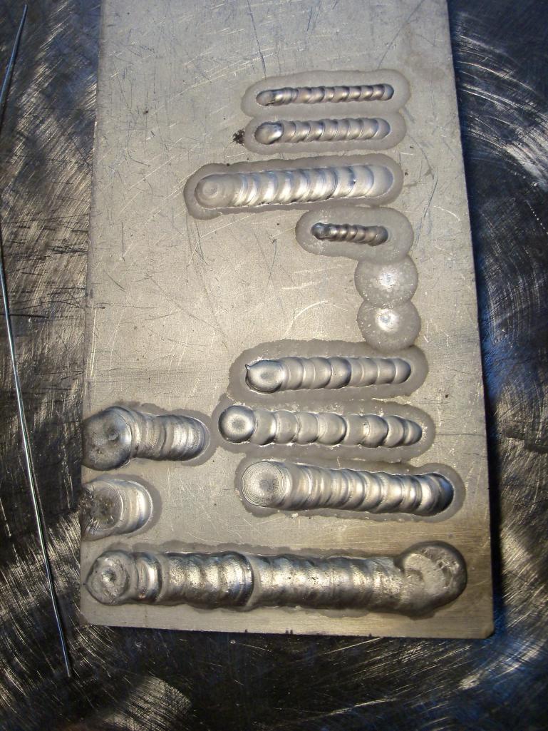

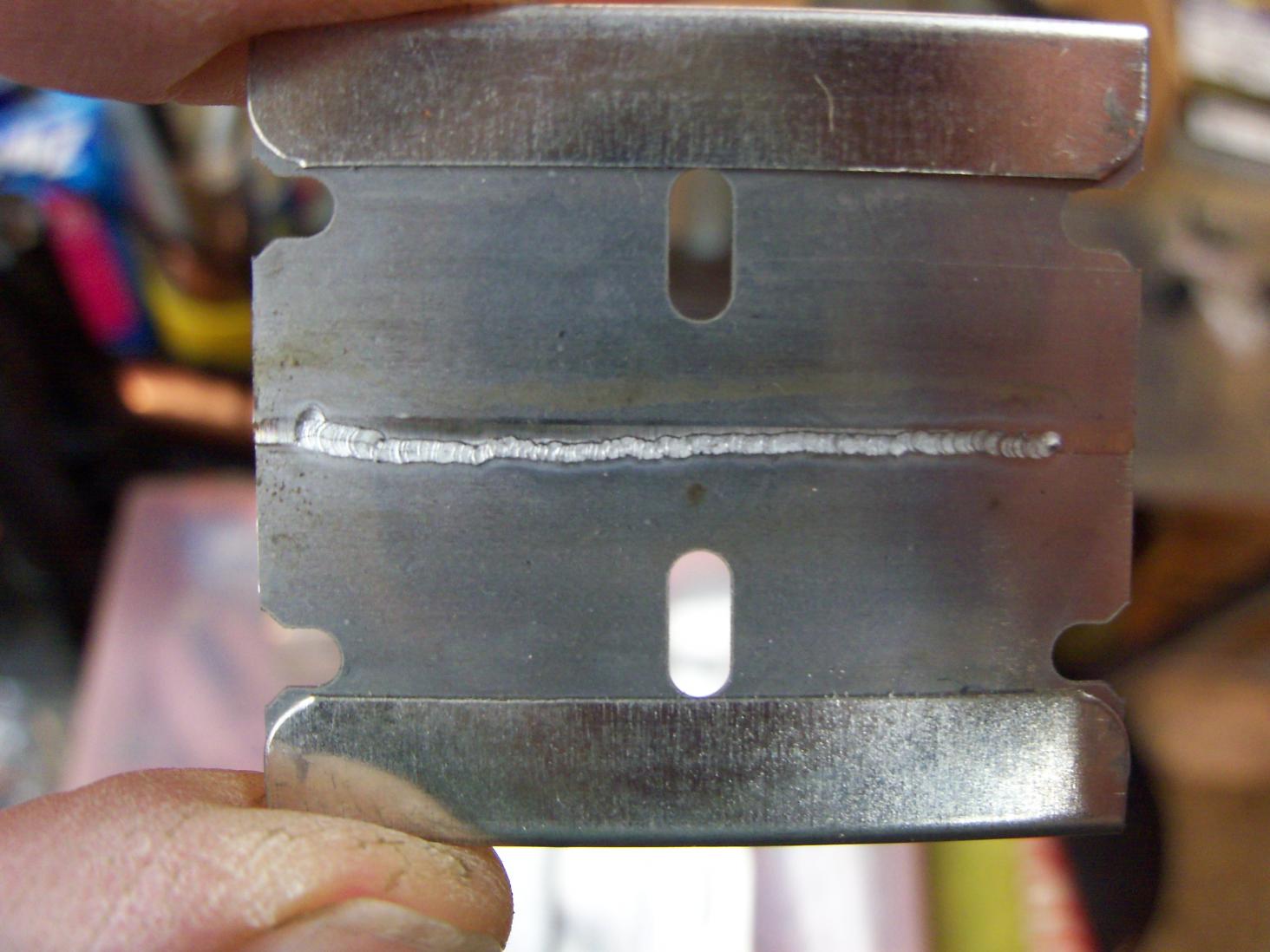

    These show how controllable the low-amp capabilities are. In testing, I can actually establish an arc on the side of the blade, and Not melt it. That is certainly low enough.
    This one was run freehand with .030" 309L add-wire. This is finicky and intricate stuff. Not sure what to use it for, but at least the machine is not the limiting factor.

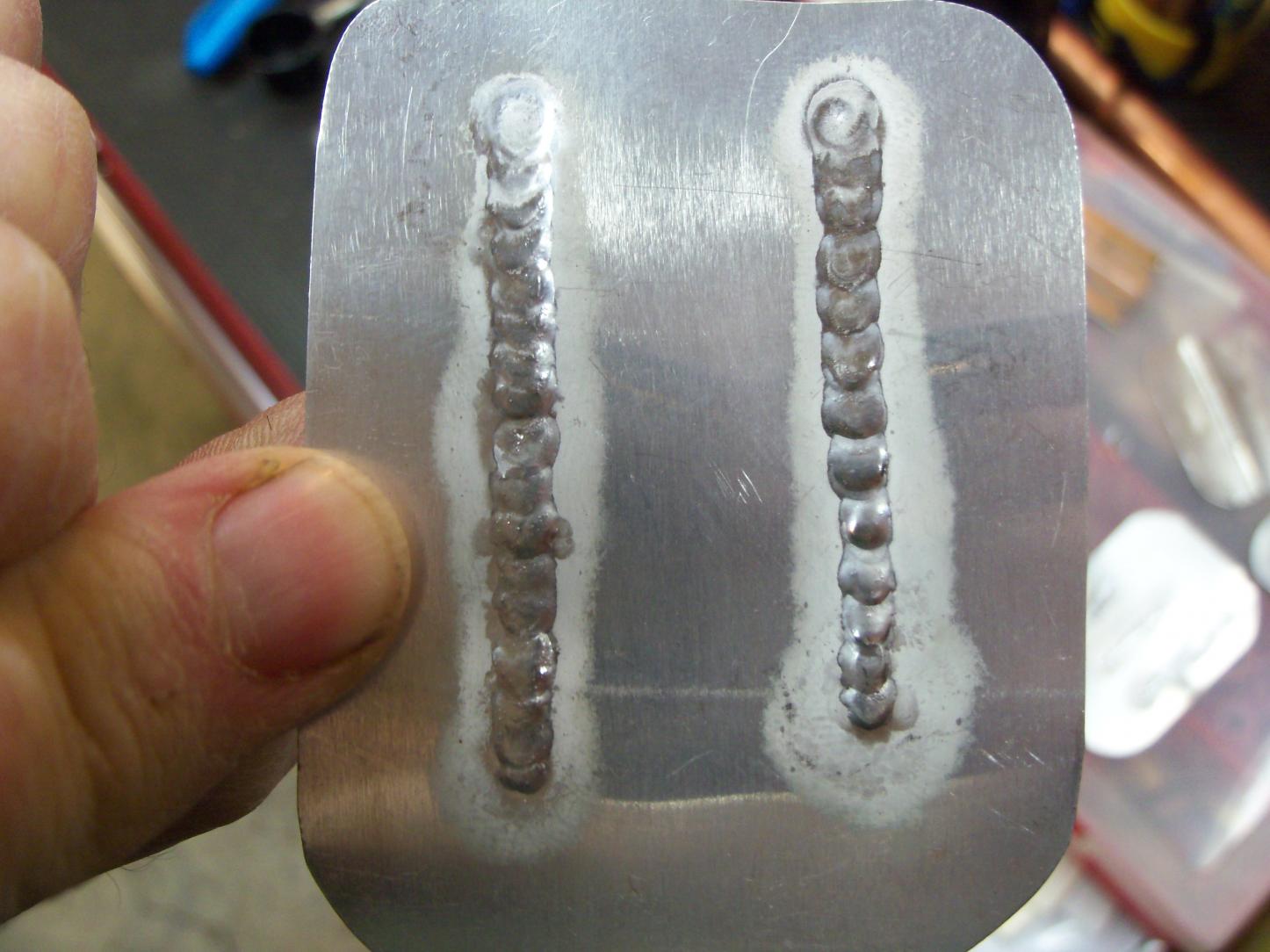

    Now onto the thin aluminum. This is 0.015" sheet aluminum roofing flashing. The settings were all under about 15 amps, and various AC frequencies, and some with 30hz pulsing. AC frequencies as high as 250hz. All using pedal control.
    A shot of my more successful samples, I could work harder to make them pretty, but this was a test of the machine's low-end, not me so much.

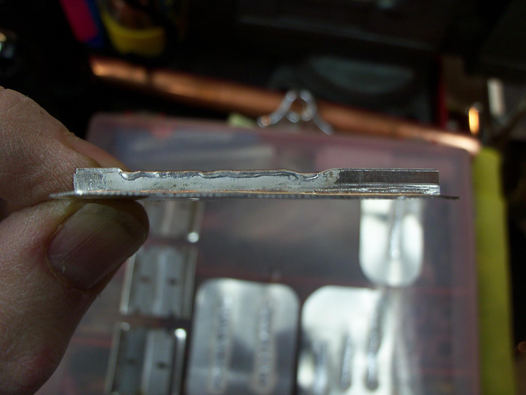

    This is a very small autogenous edge weld joining these two "L" shaped pieces. Amazing control that can do that without a total meltdown through that thin edge.
ID:	11130Click image for larger version.
    This is both sides of the same piece. I have flipped over from bottom to top. As you can see, I was able to lay a bead on just the top surface of the right-hand side of this 0.015" thin sheet. That's good and low.
    That concludes the low-current testing. The PowerTig 255 EXT excels in this department, and puts tremendous control and capability into the hands of the operator. But that's not the real story here.

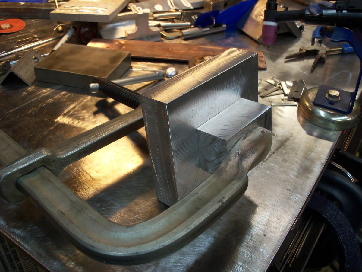

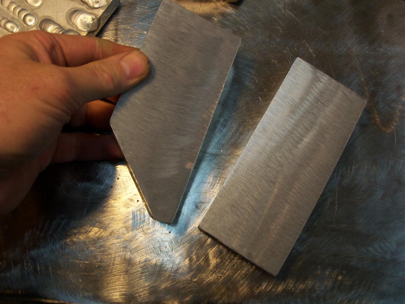

    After running some high-power AC beads, using various AC frequencies, I played around a bit and found I could actually make a dent in 1/2" 6061 plate.
ID:	11133Click image for larger version.

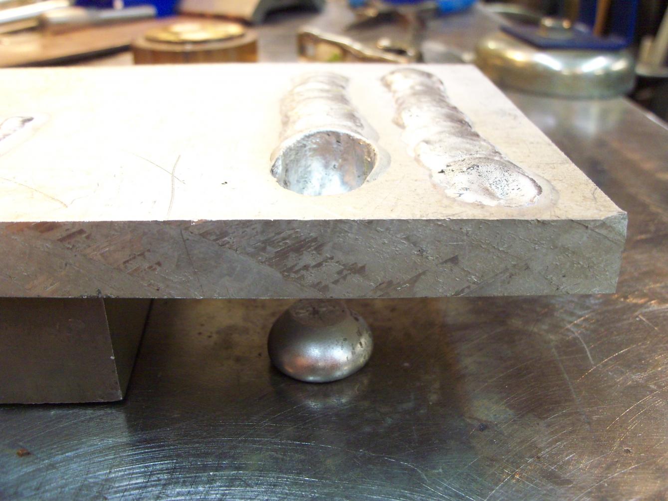

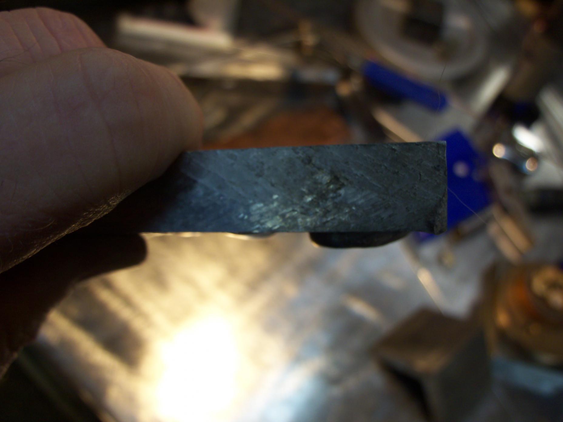

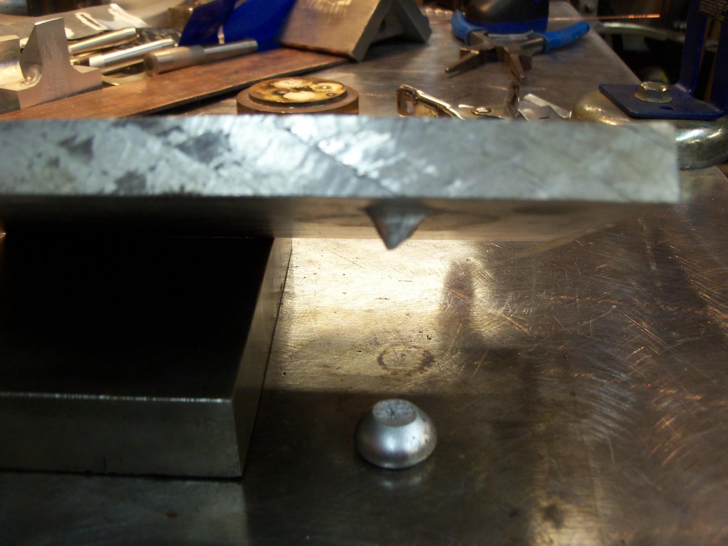

    Not only could I make a dent in it...but that lump on the bottom is where it dropped out the bottom!
ID:	11135Click image for larger version.
    I put on my stick gloves and fire jacket, as this was going to get hot!
ID:	11137Click image for larger version.

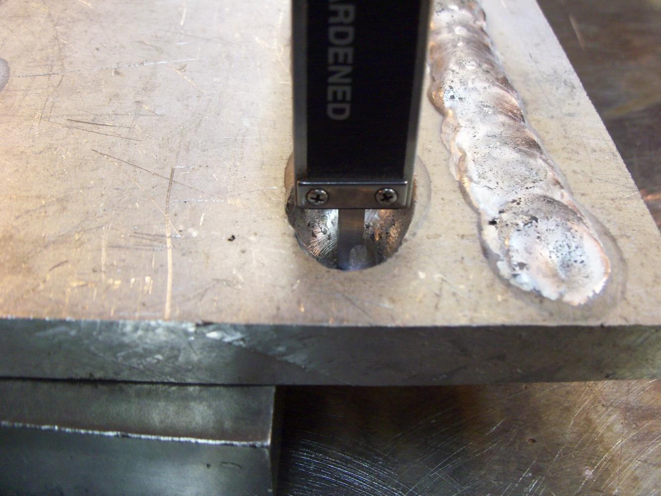

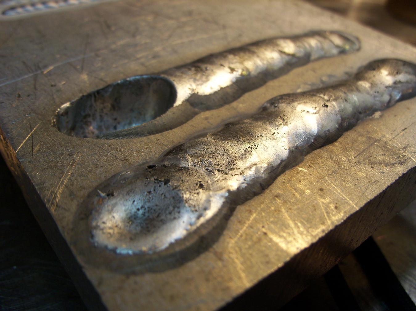

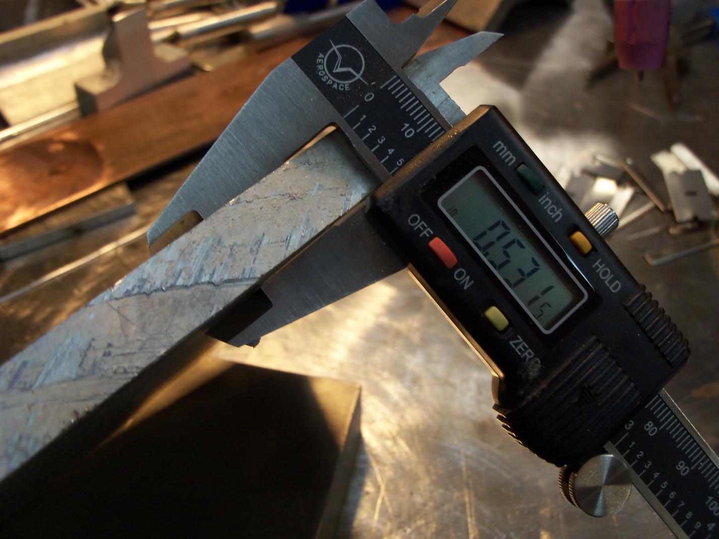

    The Everlast 255 EXT can puddle 1/2" plate! Using only Argon! No other gases are needed.
ID:	11139Click image for larger version.

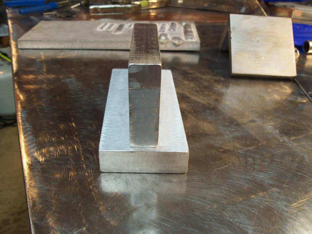

    So if it can puddle 1/2" plate, what More could it do?!?
    I'll show you, Let's travel even Deeper down the rabbit hole...

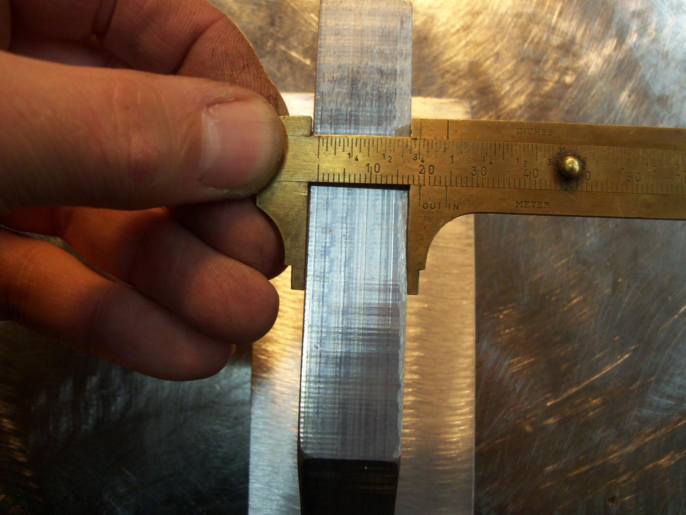

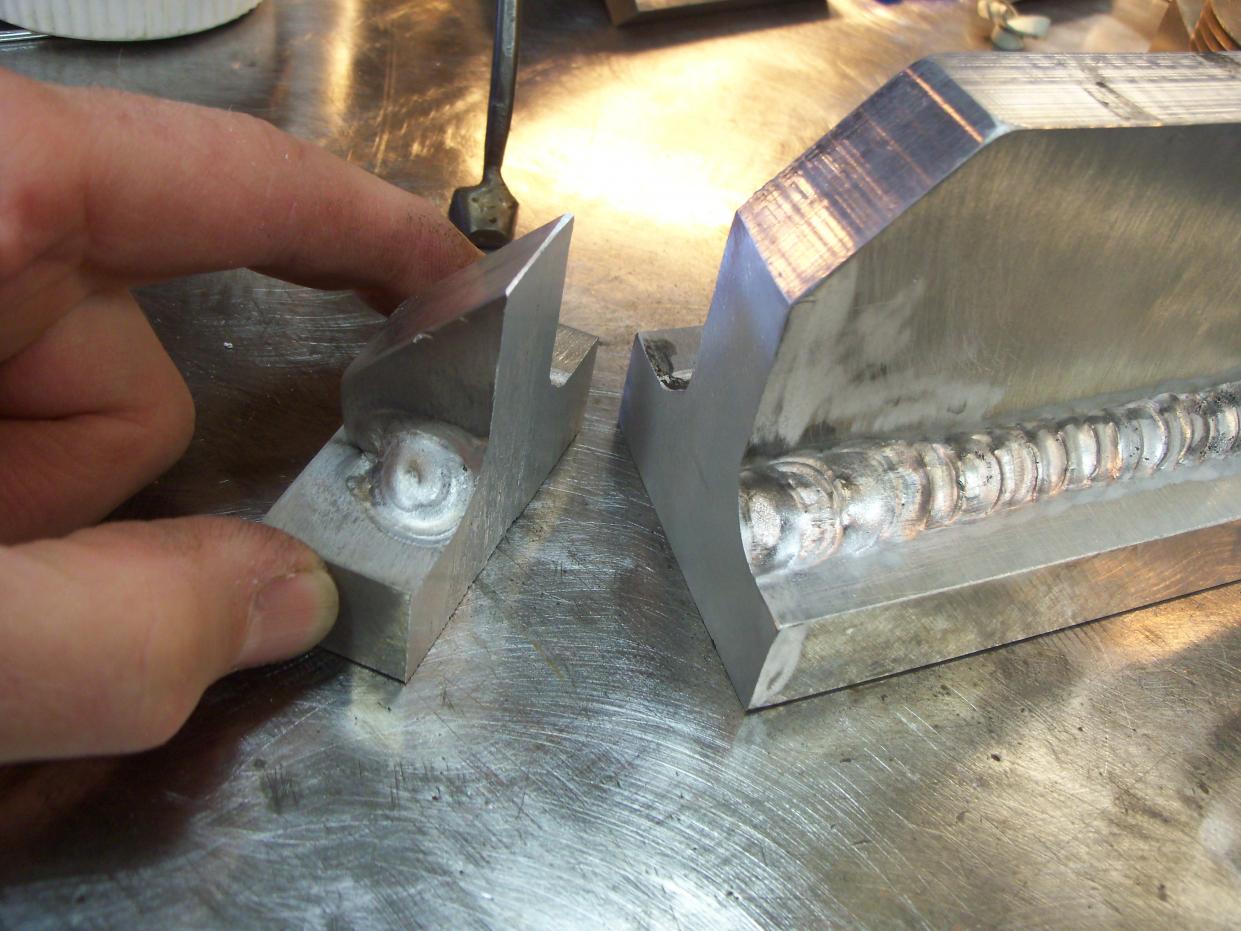

    Here is where reality distorts, and common sense is of little use. Where capability is affordable, and compact is powerful, and other topsy-turvy paradigms are in play.
    What follows is my personal journey exploring the capabilities of this amazing new machine, enjoy the ride...

    So you see, a new world awaits each of us. One without limits, small or great. Jump on board, we don't yet know where this journey ends, but I for one, do like the ride!

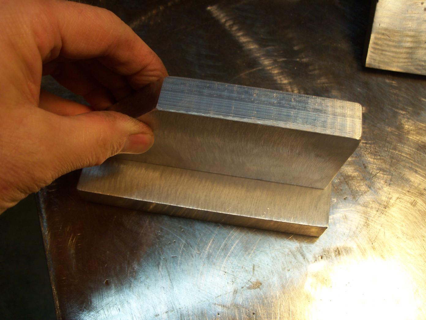

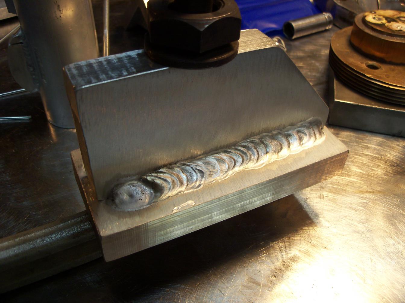

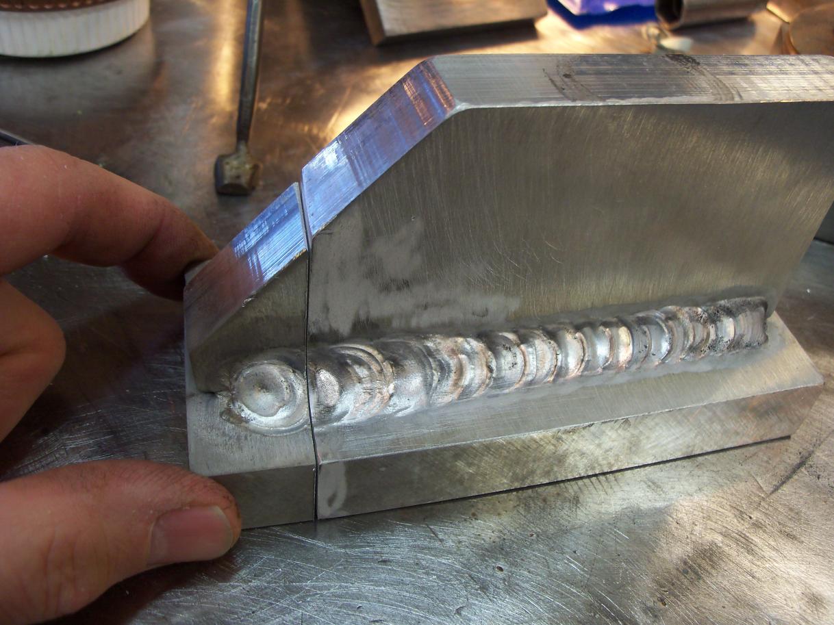

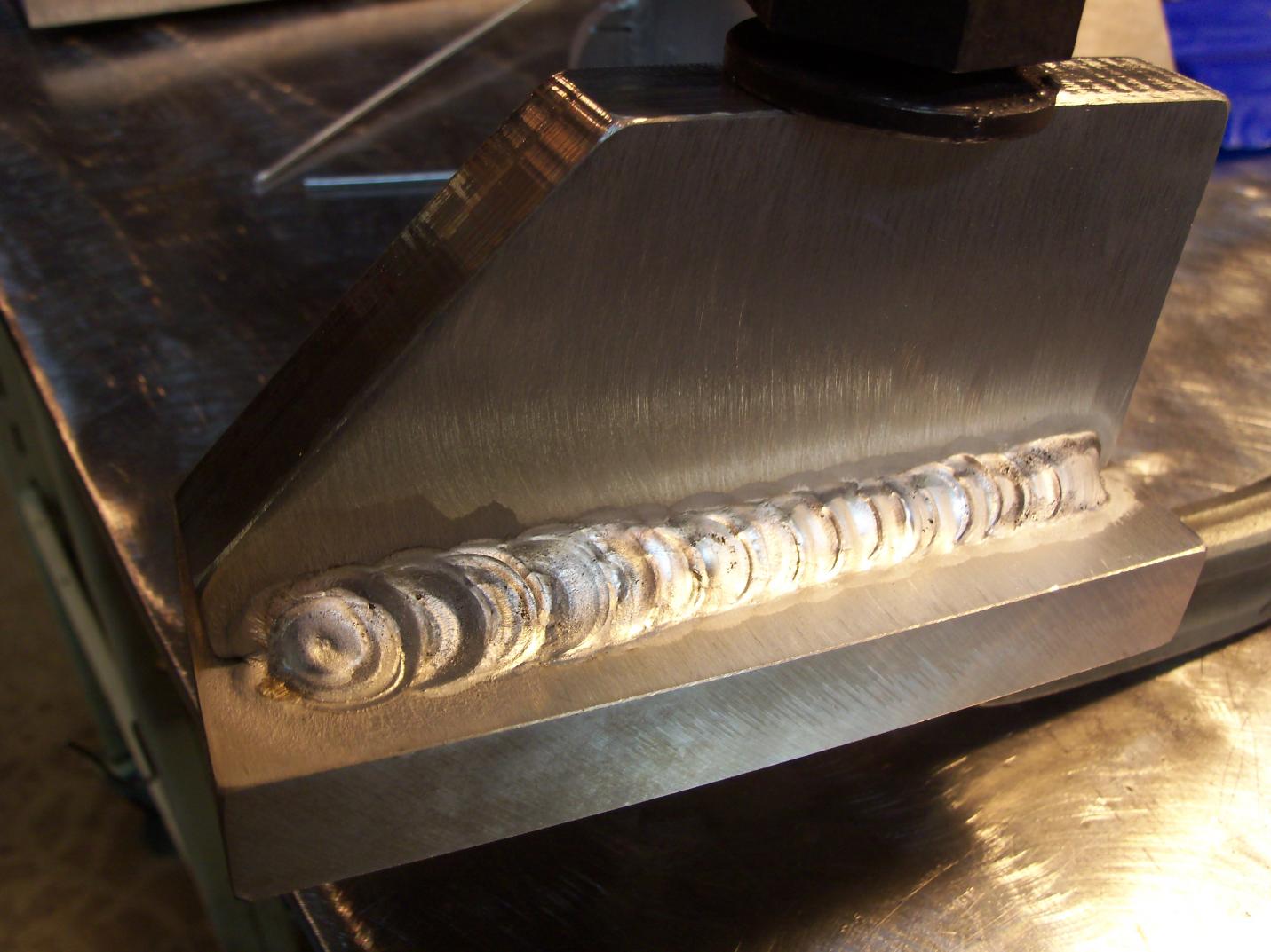

    So, What are the Limits?!?
    Where are the Boundaries?!?
    Someone Stop the Madness!!!

    Mr120 - I am glad you liked the pedal mod, it really does work well now. Thanks also for the very kind comments, I'll try to keep the future updates up to the caliber you have come to enjoy Truly though, just a mere mortal.
