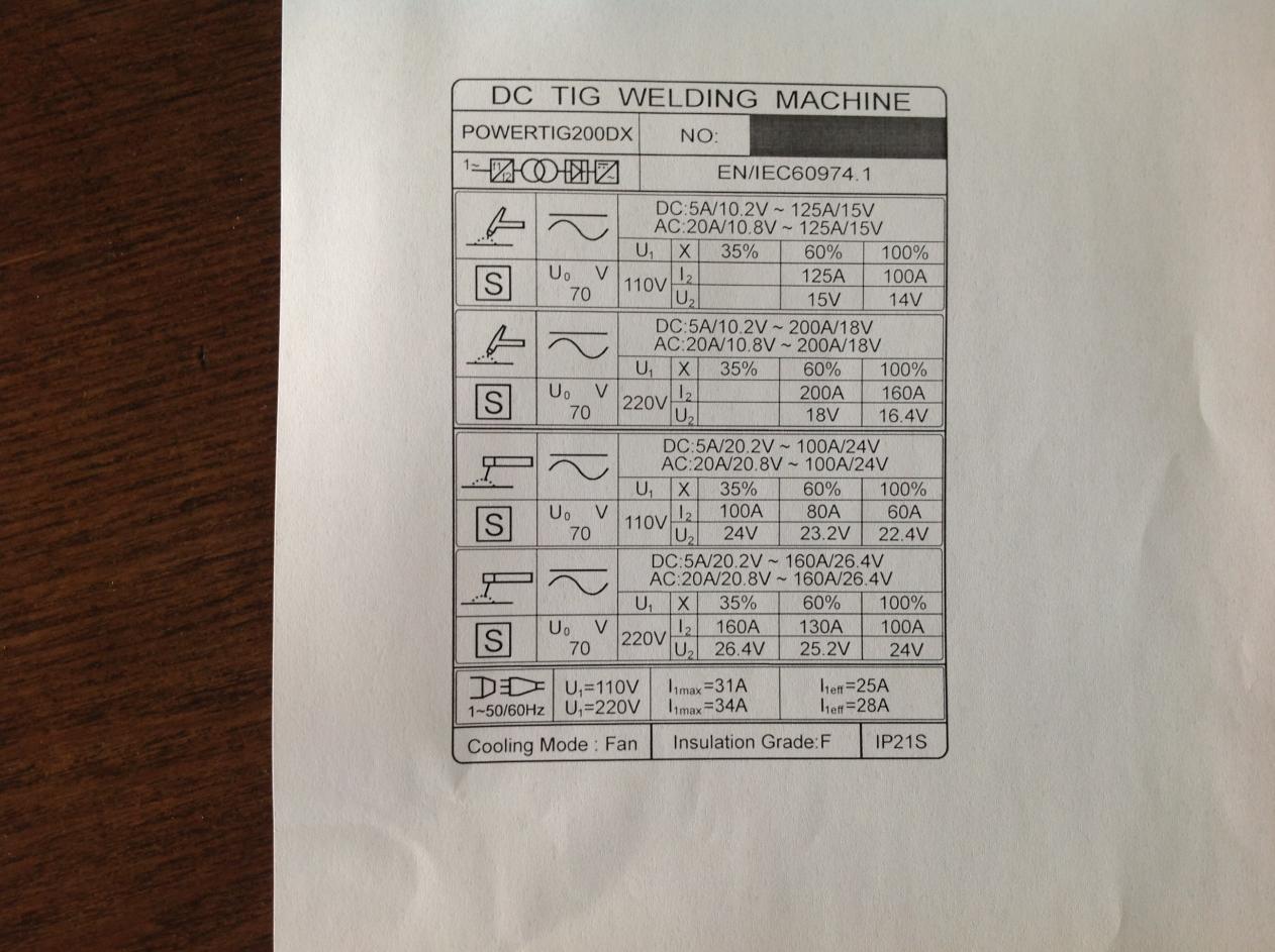

    The dual voltage model should be able to do 50A when supplied with 120v at 15a (typical plug). Now correct me if I'm wrong but that's only enough to do 1/16"steel, maybe 1/16" aluminum if pre-heated.

    Then you don't need the -D version if you have 220 and 30+ amps. Also, if you plan on 1/16" inch, even aluminum you can run extra passes on 110vac.
ID:	9875The website designates the D for dual voltage just to distinguish between the 2 models for those that need to see the specs
    Please see the spec sheet . Shipment is on board today and will be arriving in our warehouse in about 3 weeks max output on 110v at 25 amp running amps is 125 amp.

    WOW! 100 Amps, at 100% duty cycle from 110 volts. What a hat trick.
    That's 1400 watts, what is wrong with that? 15 amps at 110vac is 1650watts. The efficiency of course is not good at 110vac, but very doable with a higher amp 110vac circuit.
    Nothing wrong with it at all. I think it's great. I was alluding to the 3 "100" stats being like the "hat trick" in hockey for three goals, since it was a Canadian announcement. I'm really happy to see the higher amperage available in the lower voltage on dual voltage models. It's something few other brands bring to the table. There are plenty of places where 220 is not easy access and a generator would be more trouble or not allowed.
    Spent a lot of time in Canada, but never got into hockey. I thought it was a math not working issue, At first look I thought the columns were flipped, but they are right and math is all good. Duncan is really doing a good jobs on them and the 110vac side. I do not use 110, but the 160STH in the 90 amp range on 110vac, I bought one. And the HF was cool, and foot pedal worked with it, can not beat it for the price.
