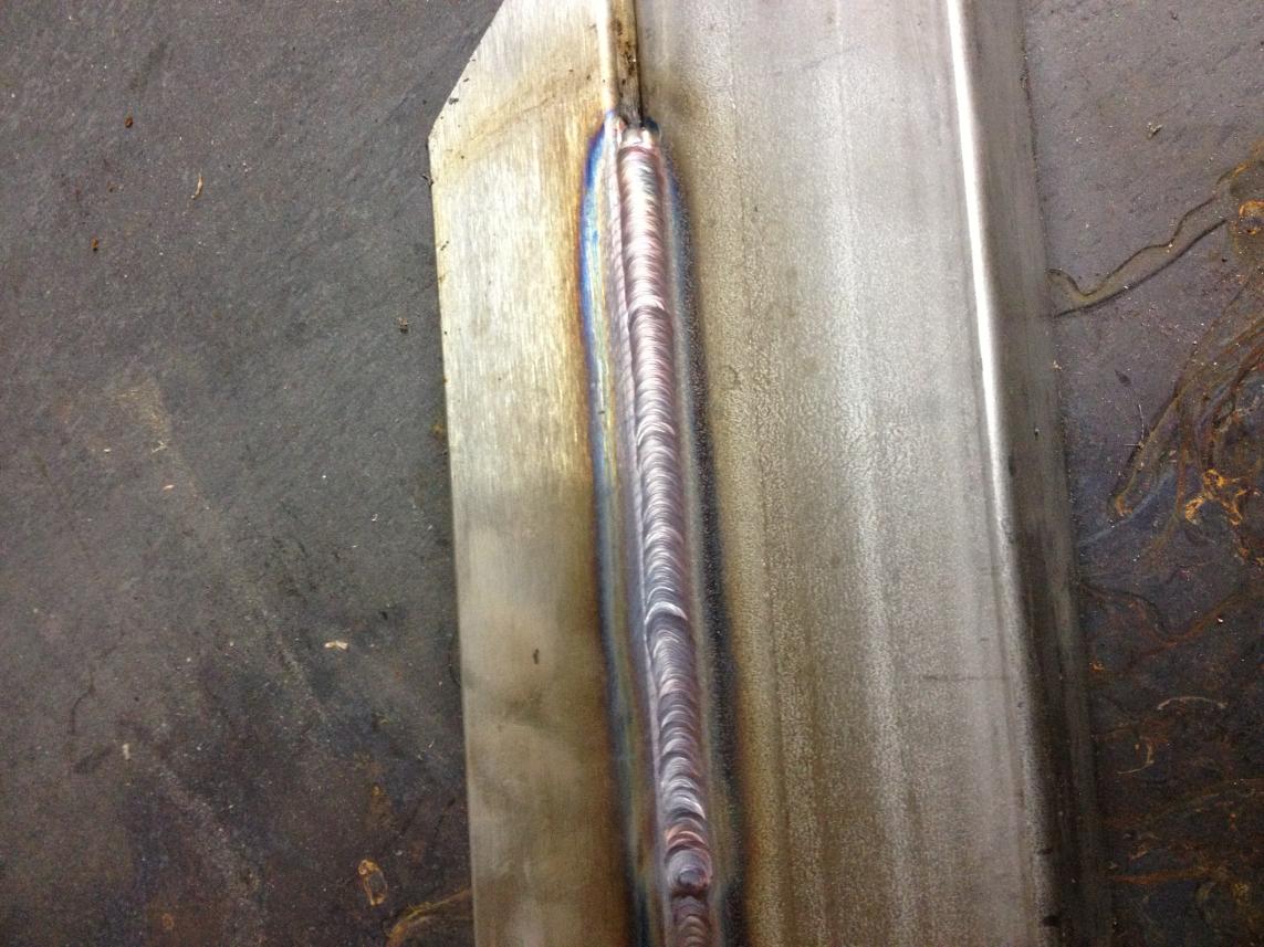

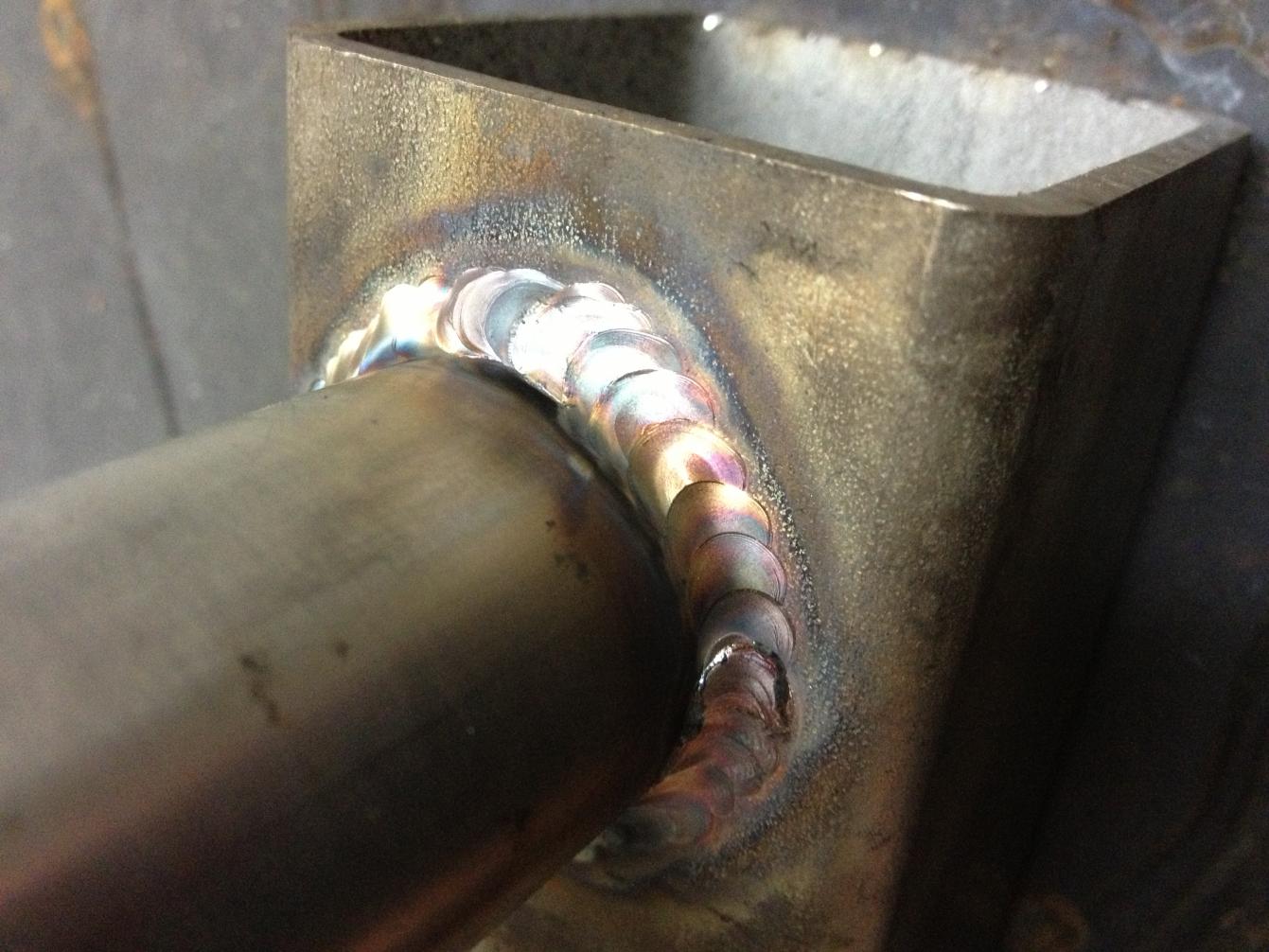

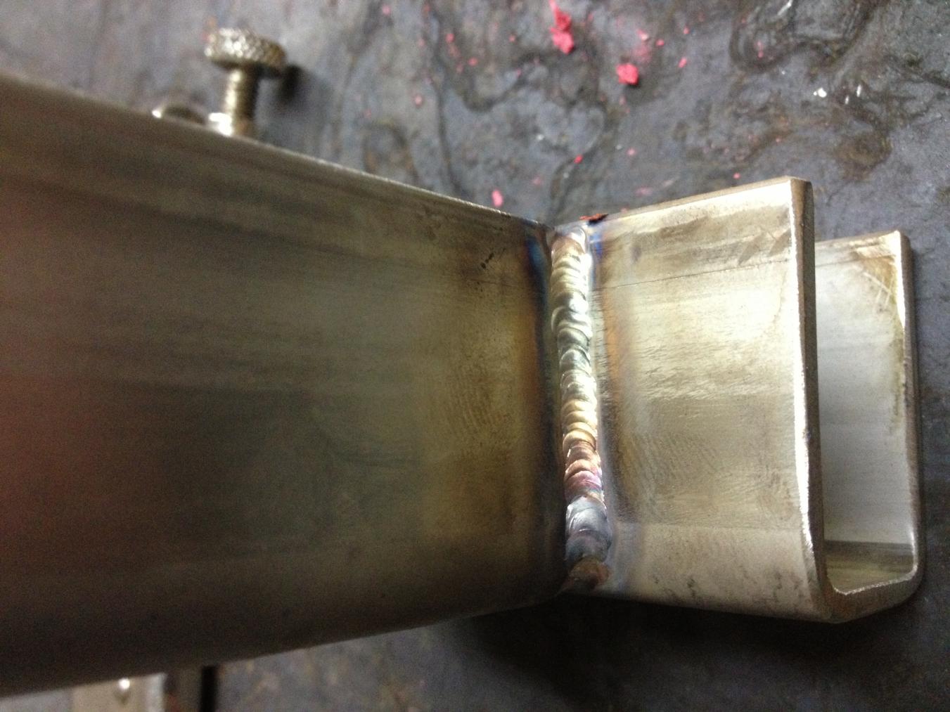

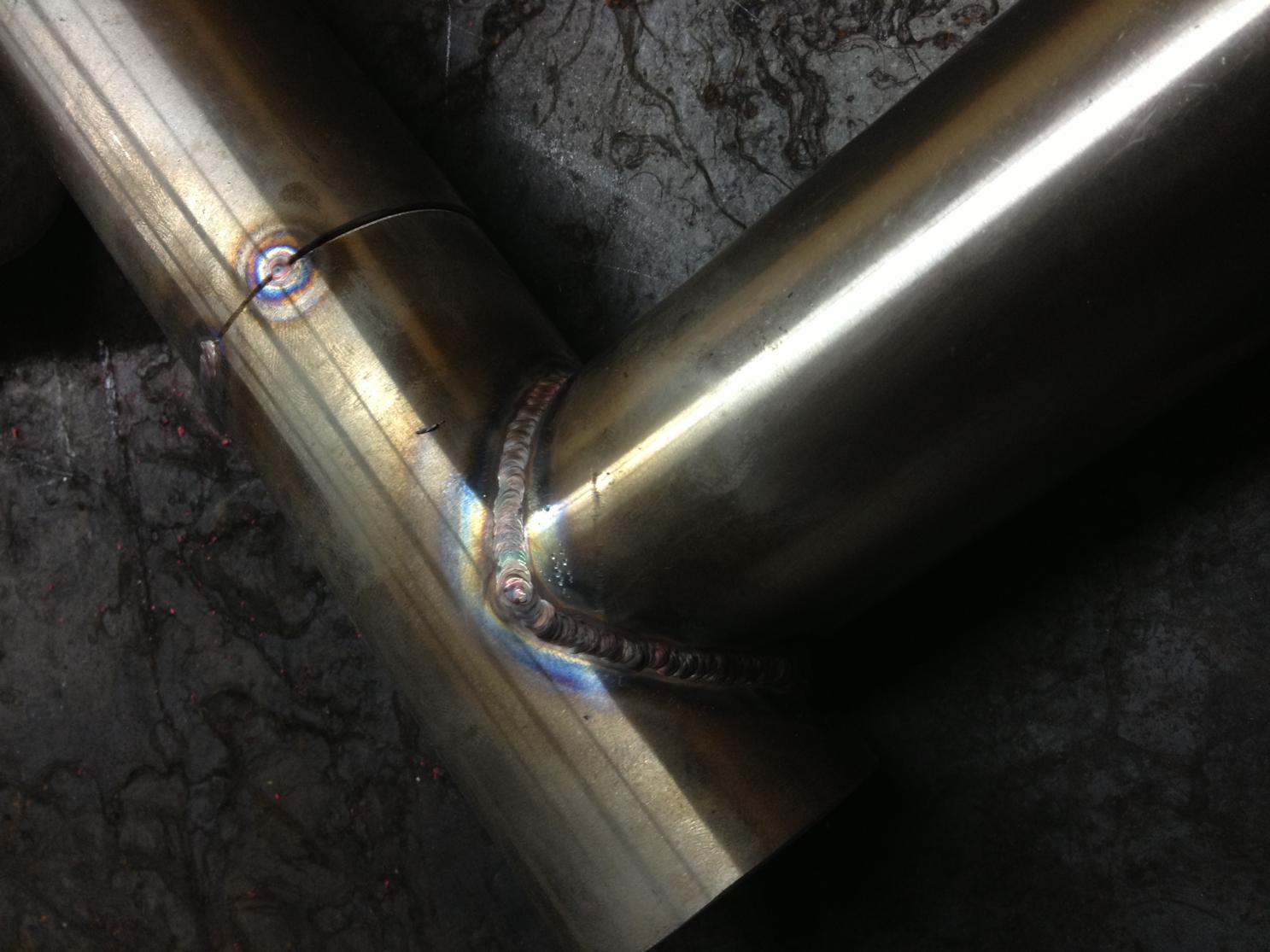

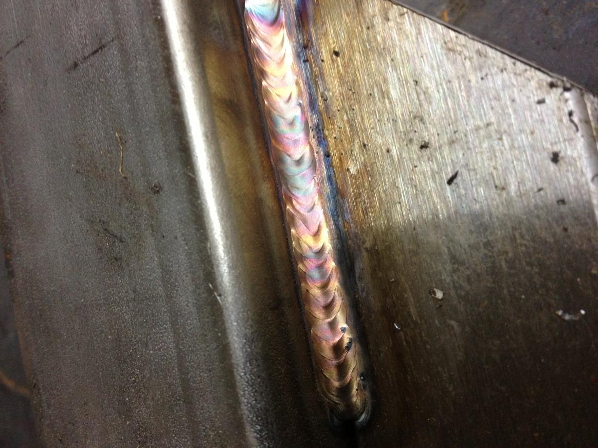

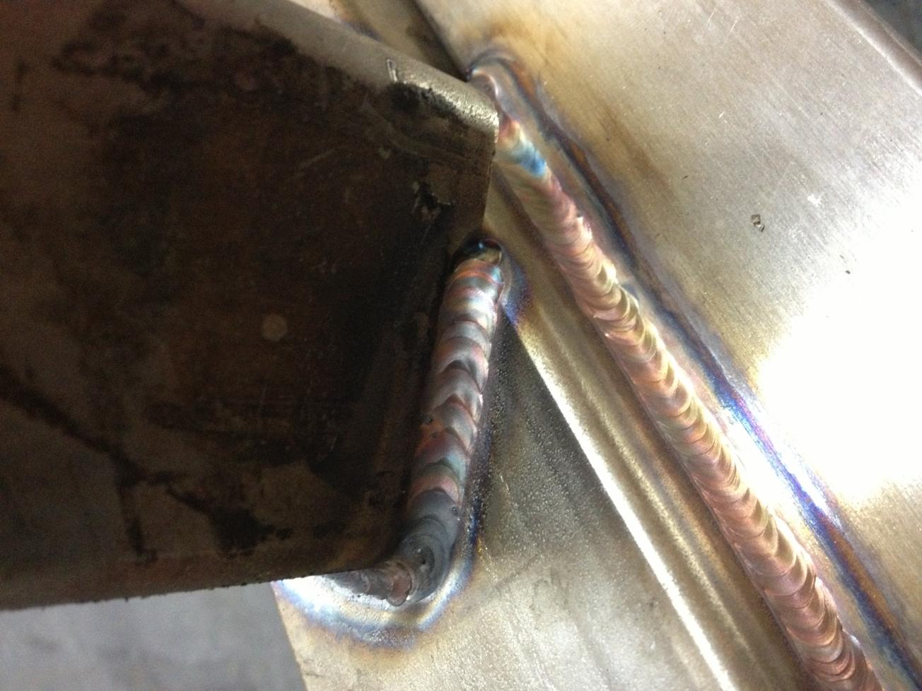

    First welds with the machine, very smooth!

    Some are with pedal, some are with torch switch, some with no pulse, some with pulse.
    I didn't really have the size filler wire i wanted/needed, so the welds could have looked better with the right stuff
    Haven't tried AC yet, waiting to build the water cooler, then ill hook up the water cooled torch and do some testing
    Very please with machine so far!
    THANKS EVERLAST!!!

    Welds are looking good, I'm gonna go out on a limb here and guess you may have welded before. (Kidding of course.) What kind of things are you working on?

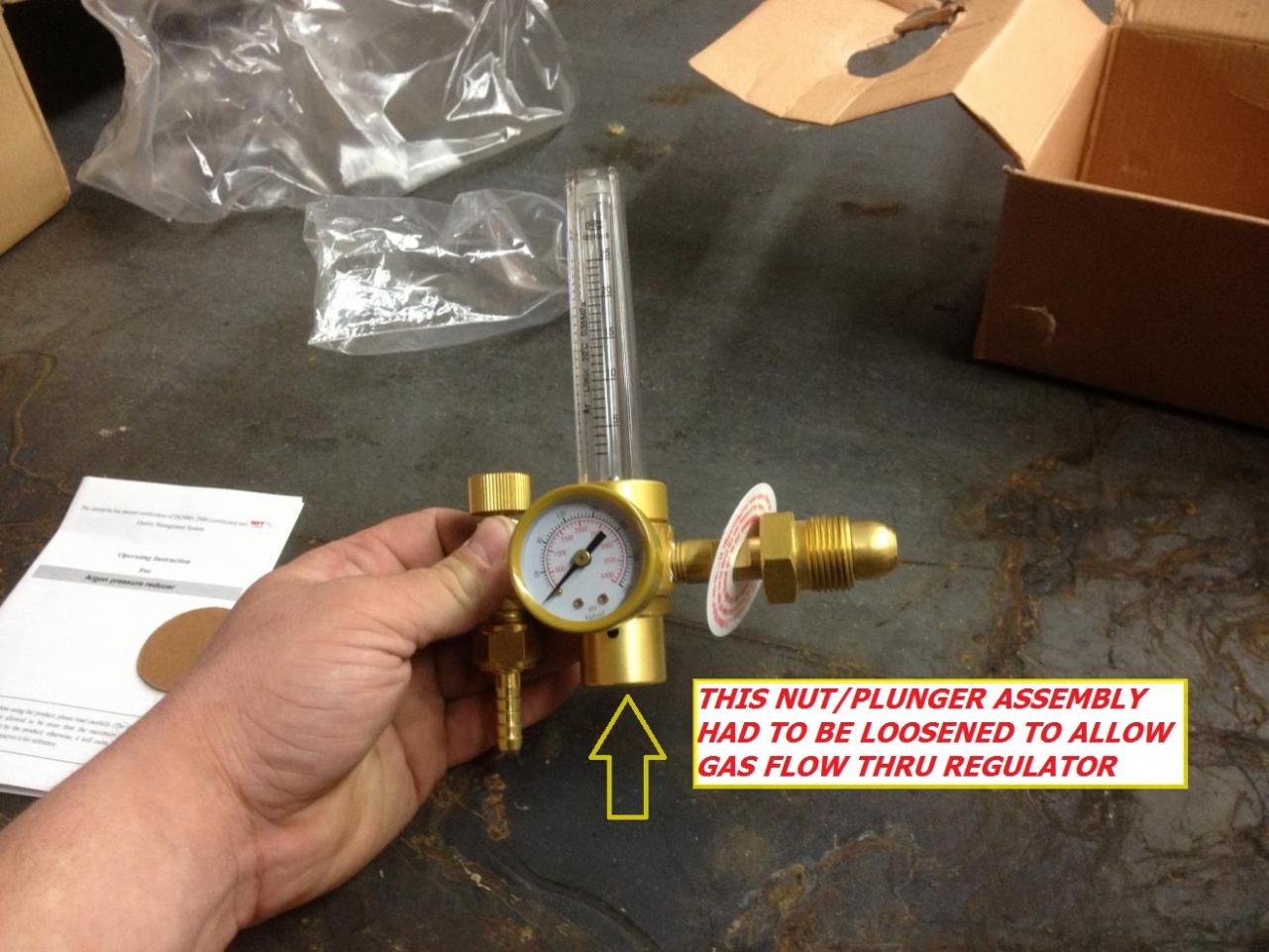

    Aj, simply remove the fitting from the water cooled torch for now (the one supplied). We don't supply clamps as they are a one use factory type thing. A small hose clamp or spring loaded fuel line clamp will work. Some people have used twisted stainless wire for a clamp. There's very little pressure on the fitting while the gas is flowing...the friction of the hose barb alone will probably hold it. We'll send you whatever you need. The regulator was one of the newer brass colored ones? What was not working about it?

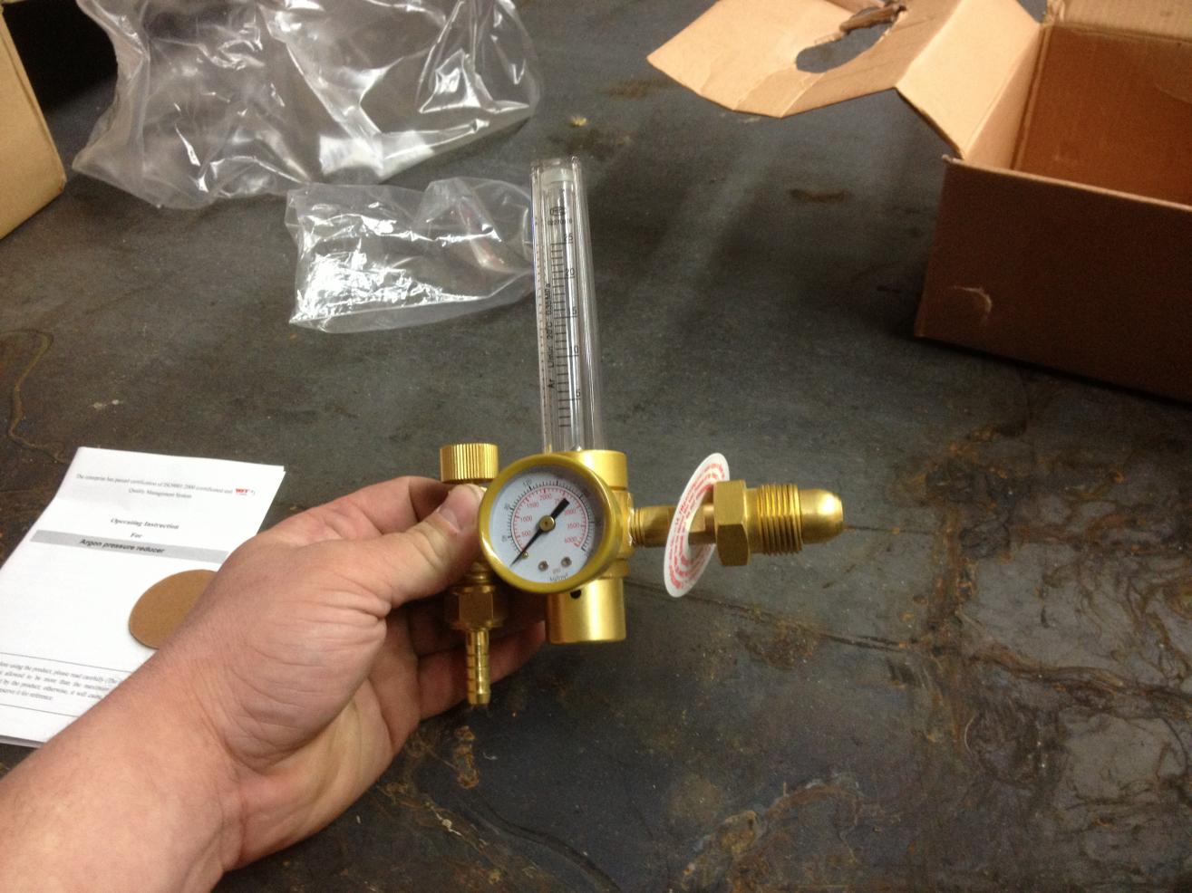

    The regulator wont flow argon! Iv hooked it up to the bottle, turn on main valve. The pressure gauge reads the bottle has pressure. Then i adjust the flow valve to set my flow out of the regulator and nothing happens... i maxed the flow valve out both directions and still nothing. I disconnected the regulator and inspected it some, couldn't really find anything wrong. The large nut the houses the plunger assembly or w/e you want to call it. i took it off and blew thru the reg. and it flowed air... so i tightened it all back up and no flow again... so i decided to just barely loosen the large nut assembly and it will flow gas like that, just doesnt seem right to me.. The reg appeared to be the all brass units

    Here is a picture of what i was talking about, if my explanation was confusing!

    Ok. That is the new style. Several other name brand companies use the same one now as we are using. It's a higher quality. I guess it's better than leaking(safer). You'll need to call ext 202 or if you can't reach that number 201 and tell them what you need or are missing. The regulator and the fitting will be sent to you.
    Just called and they are shipping both items out to me today!
