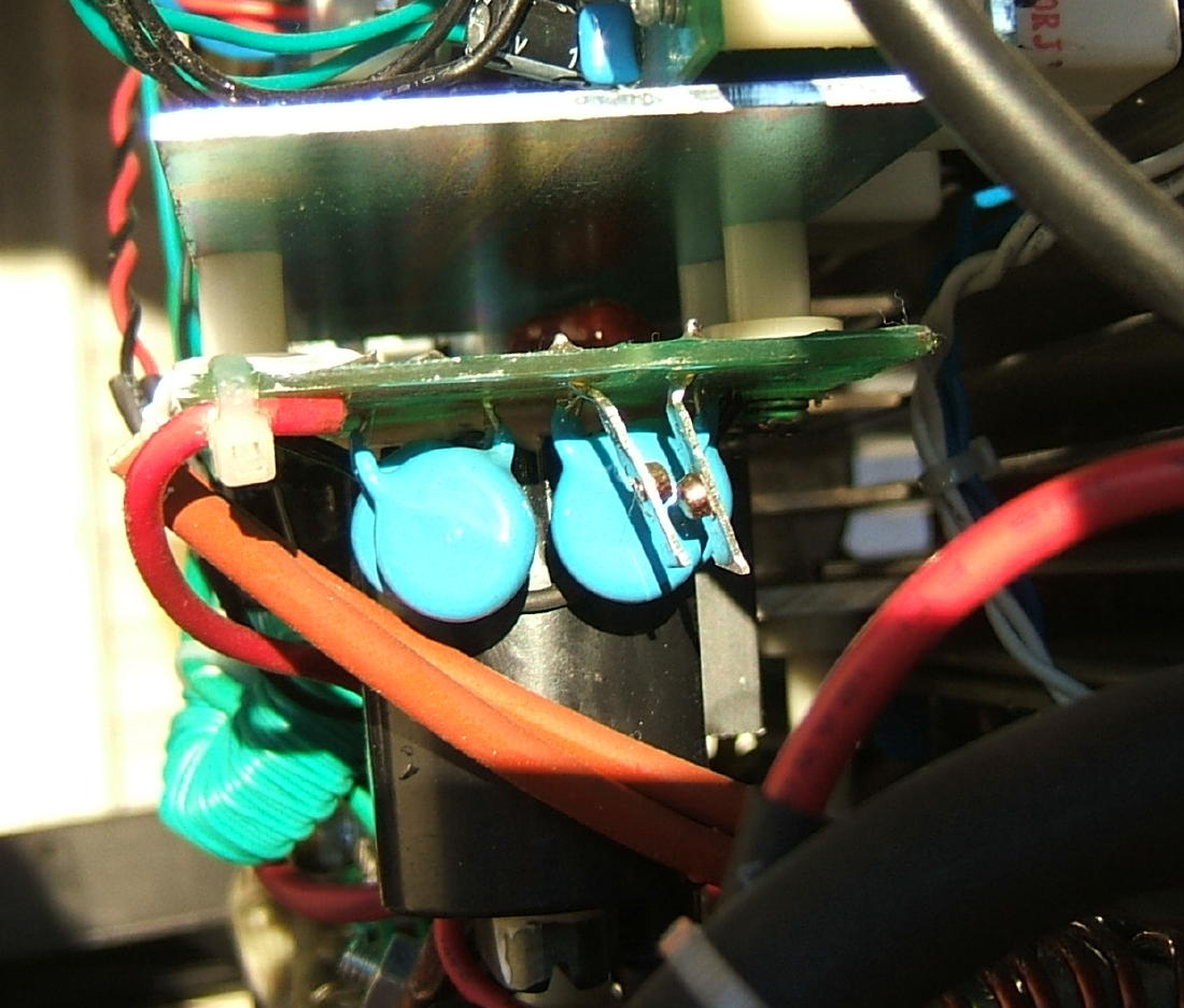

    Default points problem
    HI
    Here is what my points looked like when I got my 256.
    The points are on the left side down low on the front of the electronics inside(looking at the front) .
    Another Way to check is hook up the plasma torch and try to cut no hi freq no start.
    Many other posts about the same thing most likely its your problem too.
    have fun
    Tom

    Were you able to straighten those out and use them? or did they have to be replaced? They look kinda ... discombobulated in that picture.
    Things have changed internally since then. And if you have the S-75, it's not even close.
