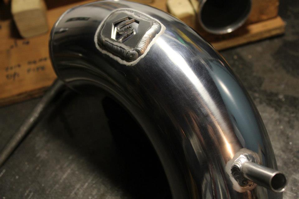

    thanks for the advice kempy. i'm not really concerned with discovering the settings and how to adjust their parameters. i made my own manual after watching the youtube video. playing with the settings is not a problem at all... understanding how they effect the weld process is where i need a better understanding. i'm hoping to get input from people who use the same welder. i'm here to learn from other's experience and to share my own.
    so far i'm happy with how it welds. i've left the default square wave for ac. i've added 25 p/s with a frequency value of +10% to help with cleaning. i experimented with sine and soft square waves but didn't have positive results. the square wave seemed to be the most stable arc. i also played with slowing down the p/s down to 5 but i found the pulses too slow and it was difficult to get heat into the base metal at lower amps. i haven't really played with the other settings a whole lot, but i'm curious to learn how the effect welding. if someone else has played with them i'd be very appreciative to hear their results.
    cheers,
    aaron
    i have a kinda european version of that machine,same features and settings etc.different colour
    +10% seems very high.on clean,new aluminum i normally use -20.i was repairing a twenty year old mower last week with terrible,corroded dirty alu and only got to -3%.
    thats with a 2% lanthanated tungsten.9 times out of 10 i just leave it in advanced squarewave,ac freq at 100,balance at -20.pulse i rarely use,maybe on .060 or less.
    weldingtipsntricks 30pps,30% on time,30% backround amps is easy to remember and effective.1 pulse per second can be handy to get into a rythm on thicker sections
    it seems to work well on ss.

    Nice job. Those are some really uniform beads.
    Nice Verry Nice.

    You do some very nice work there! I am really excited to try welding with a TIG that has all the pulse options as well as A/C capability since my simple DC machine has none of that stuff. Jody's weldingtipsandtricks videos are really helpful and inspiring! Welcome to the forum, I look forward to seeing more of your work on here. I rely on inspiration to getting me motivated, and lately I've been lacking in inspiration.
    i've found an aluminum setting that seems to work. i prefer to not use the pulse at all. it seems to throw my rhythm off.
