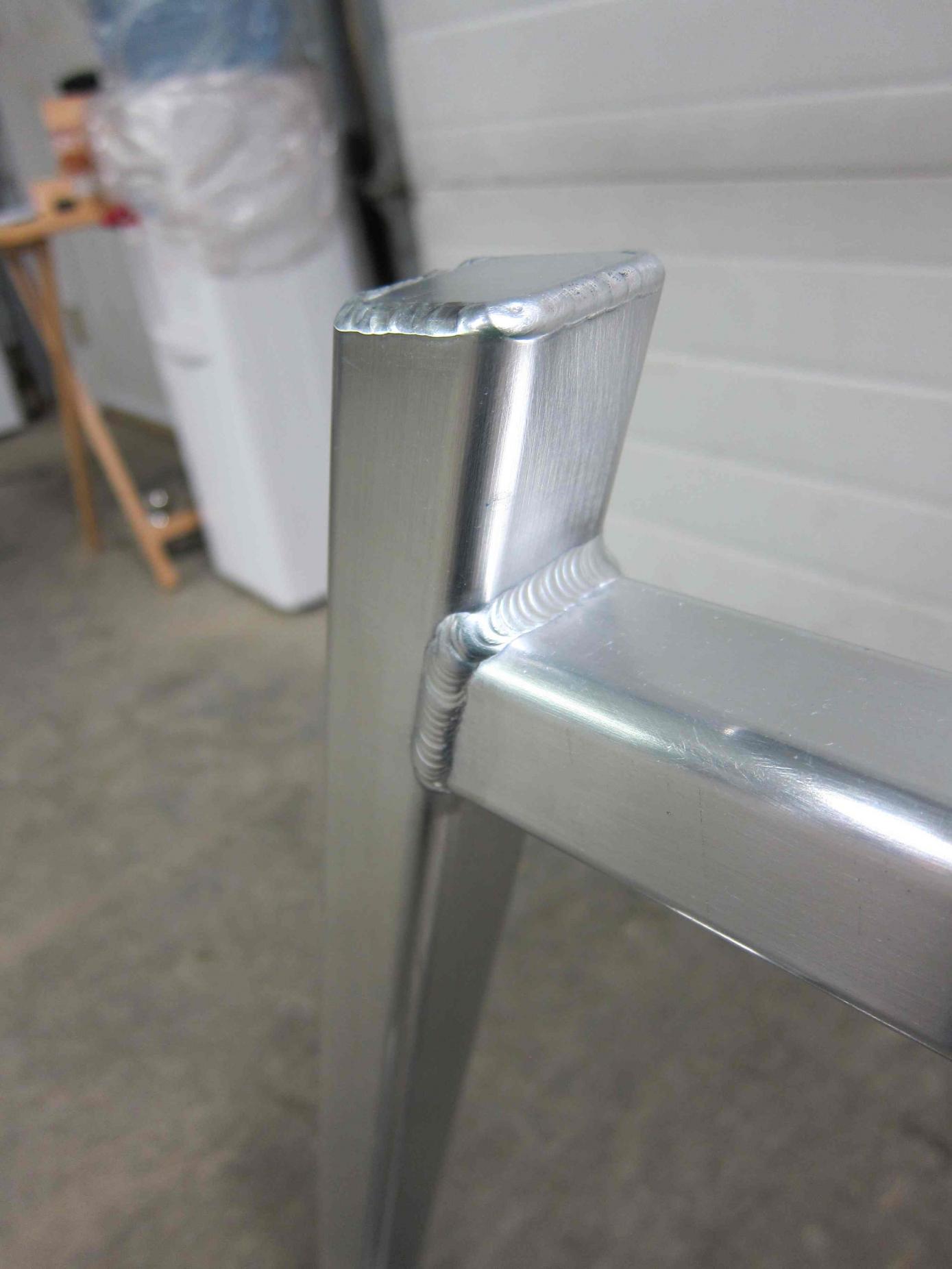

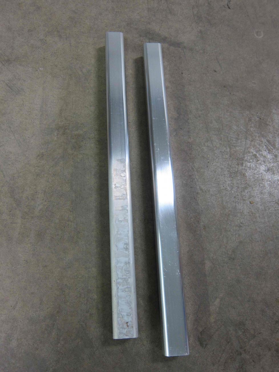

ID:	9740A cheap way to clean bare aluminum is to use an S.O.S pad. Takes a little effort but is cheap and no nasty chemicals. I think the soap in the S.O.S pad is even biodegradable.
    I even did this to 4 cyl, aluminum head and and had to replace a the valve cover gasket 6 years later and it still looks looked shiny and prevented varnish from sticking.

    It might be cheap, but for welding purposes, absolutely the worse thing you can do as you imbed metal fragments from the steel wool into the metal...and it causes more contamination than you had when you are welding.
    Maybe in theory but in reality I find aluminum welds better after I clean wih an SOS than when I was cleaning with a dedicated S.S brush then cleaning eveything after welding was complete with an S.O.S.
    The main reason for this post was to indicate that an S.O.S pad is great for cleaning aluminum irregardless if welding is involved.
    I did some a recent job with tarnished aluminum and found it easier to preclean, weld then touch up the welds after with the S.O.SClick image for larger version.
