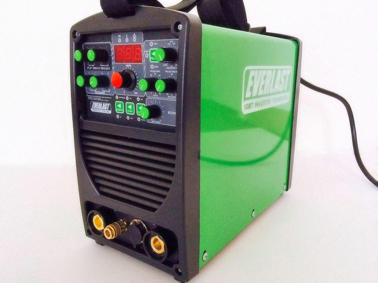

    New i TIG 200 in the vein of the new 250EX. Units after July will be renamed Power iTIG 201 so...

    Wow!
    That Power iTIG 201 unit is brilliant.
    I mean, it's a full-featured AC/DC unit in a compact form, at $699.
    Wow!

    No, it's DC only.
    OH, gee,
    My bad!
    I saw the Pulse and what looks like Frequency control and figured it was AC too.
    Also though, in the Products section of the Everlast website, even though there's no picture, it does list the proposed iTIG 201 unit as an AC/DC one.

    I saw a post on the iTIG 200 on another site about this being competitive with the AHP. Took a look over here and it doe say AC/DC and was just waiting for more info and a release date. Oh well, back to yellow.
    Yeah,
    It seems like there might still be some ambiguity. I mean, if you look at the photo, there is a knob for "Balance", i.e., AC Balance.
    So, maybe Mark would be willing to double check for us.
    Peace to you all,
    C. Livingstone
    Power iTIGs are DC only machines much like the Miller Maxstar line. That is not likely to change. The frequency and cycle controls you see are for the pulser.

    OK,
    DC it is.
