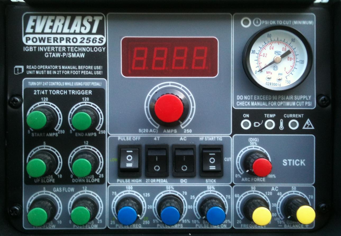

    L>R
    a- Front new design for 2013
    b- close up of the front panel
    c- front panel connections

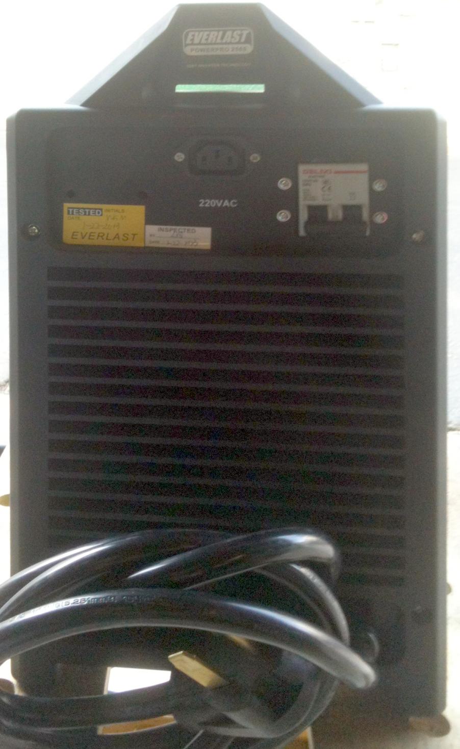

    d- rear panel

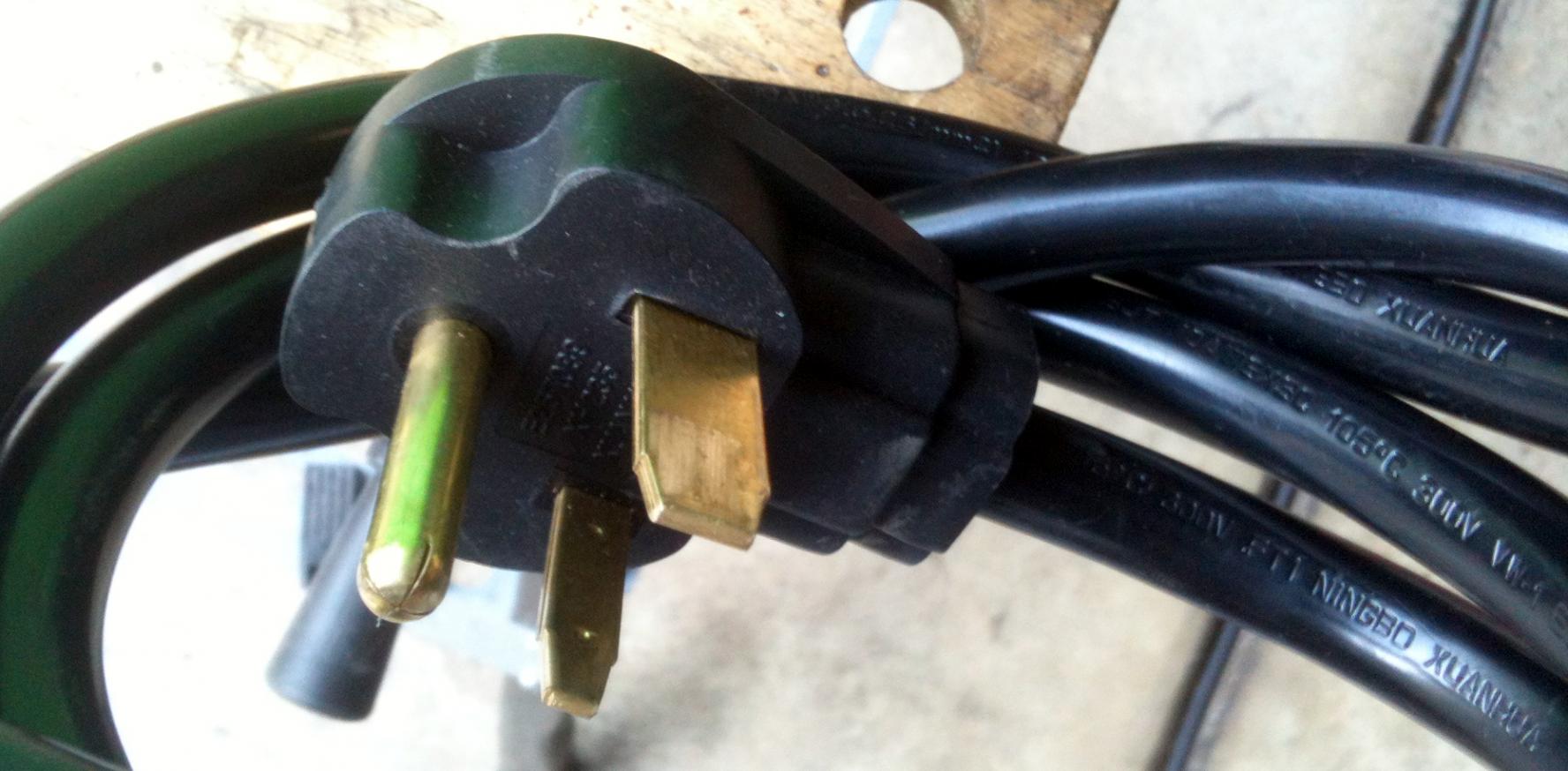

    note: I was surprised this came with a molded 6-50P installed on the power cord.

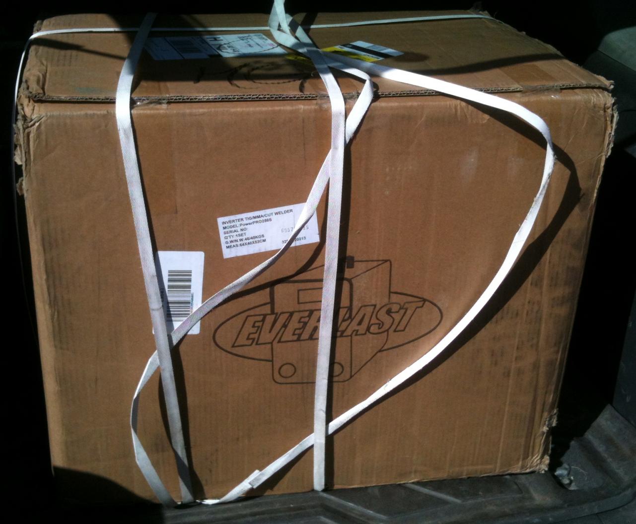

ID:	9713 Box as received from UPS. luckily it was fairly well strapped, hate to have seen it w/o 'em

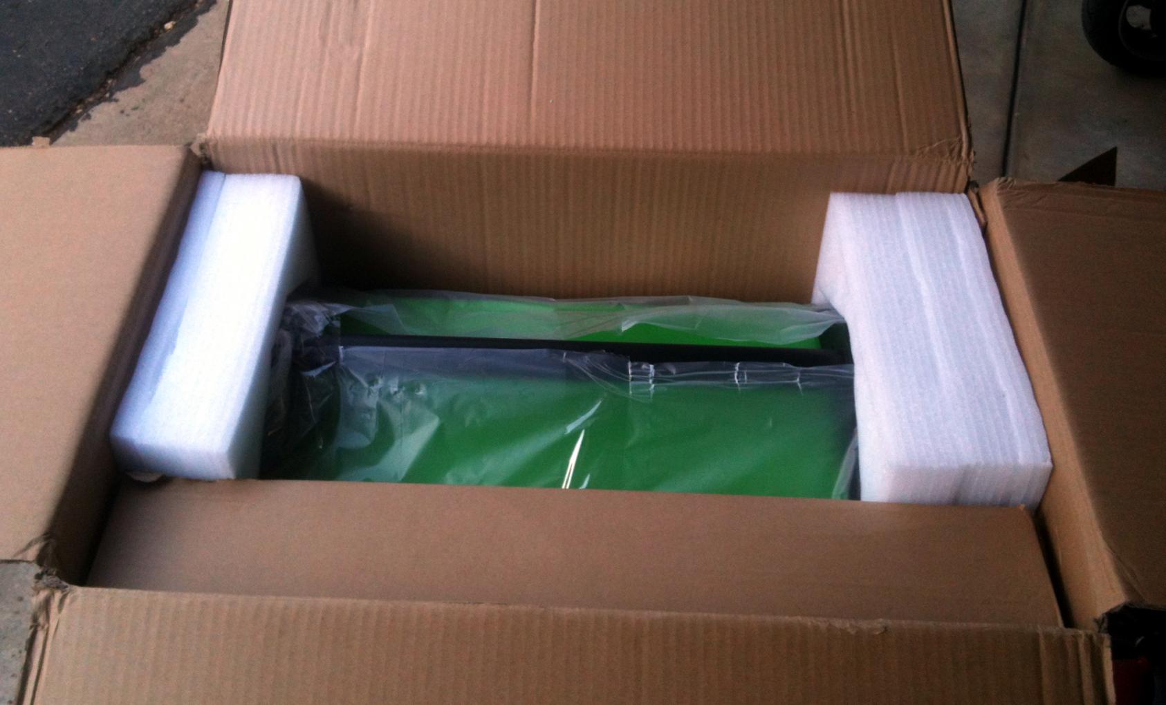

ID:	9711 opening the box for the first time (there is a double layer cardboard on top)

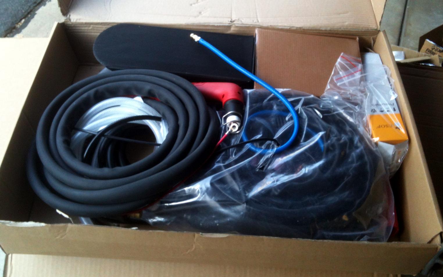

ID:	9710 the accessories box as received

ID:	9709 the pre-terminated power plug

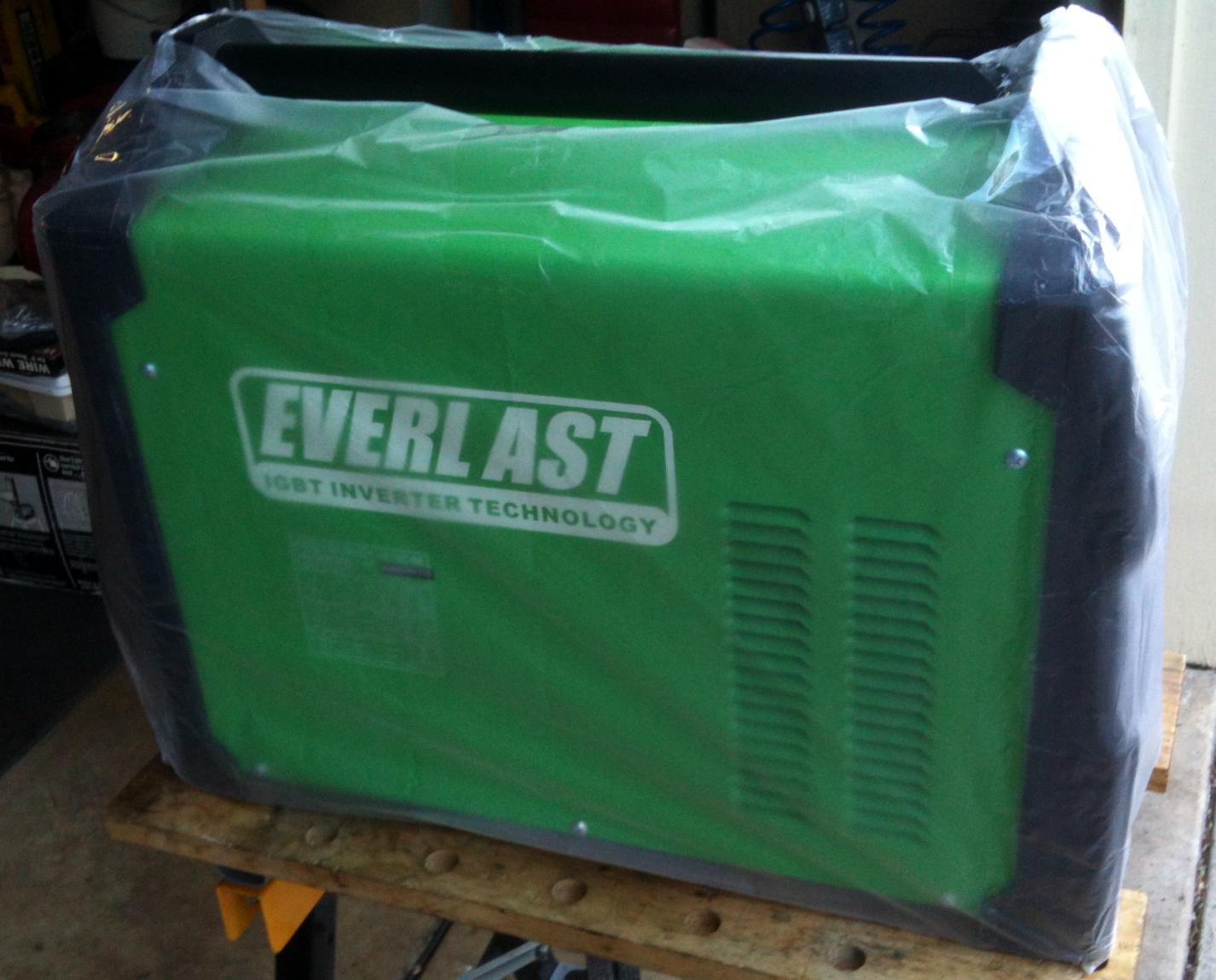

ID:	9708 fresh out of the box

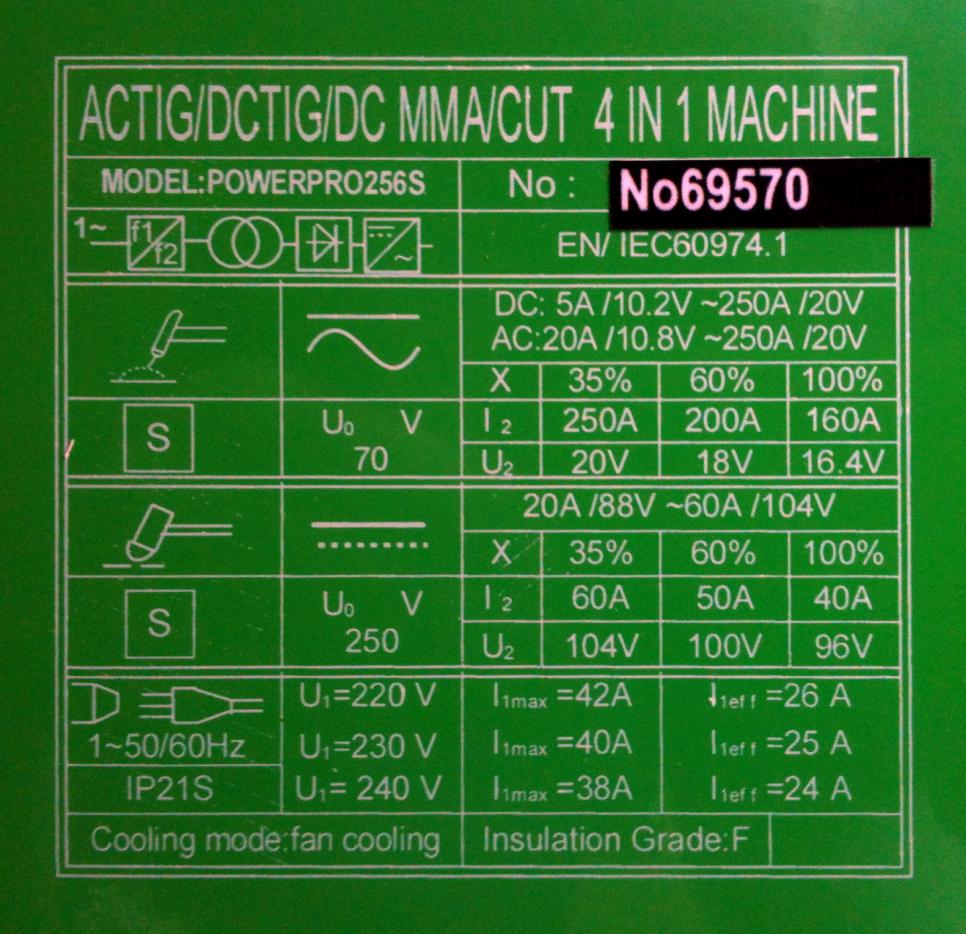

ID:	9707 data placard and unit serial number on the side of the unit

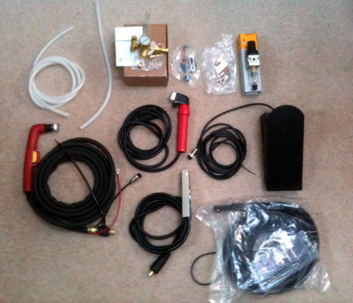

ID:	9706 accessories removed from the box

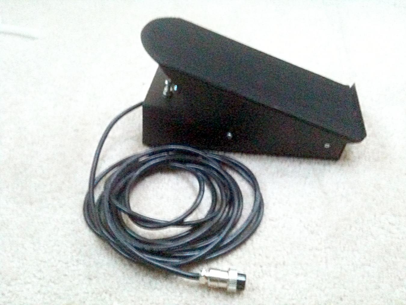

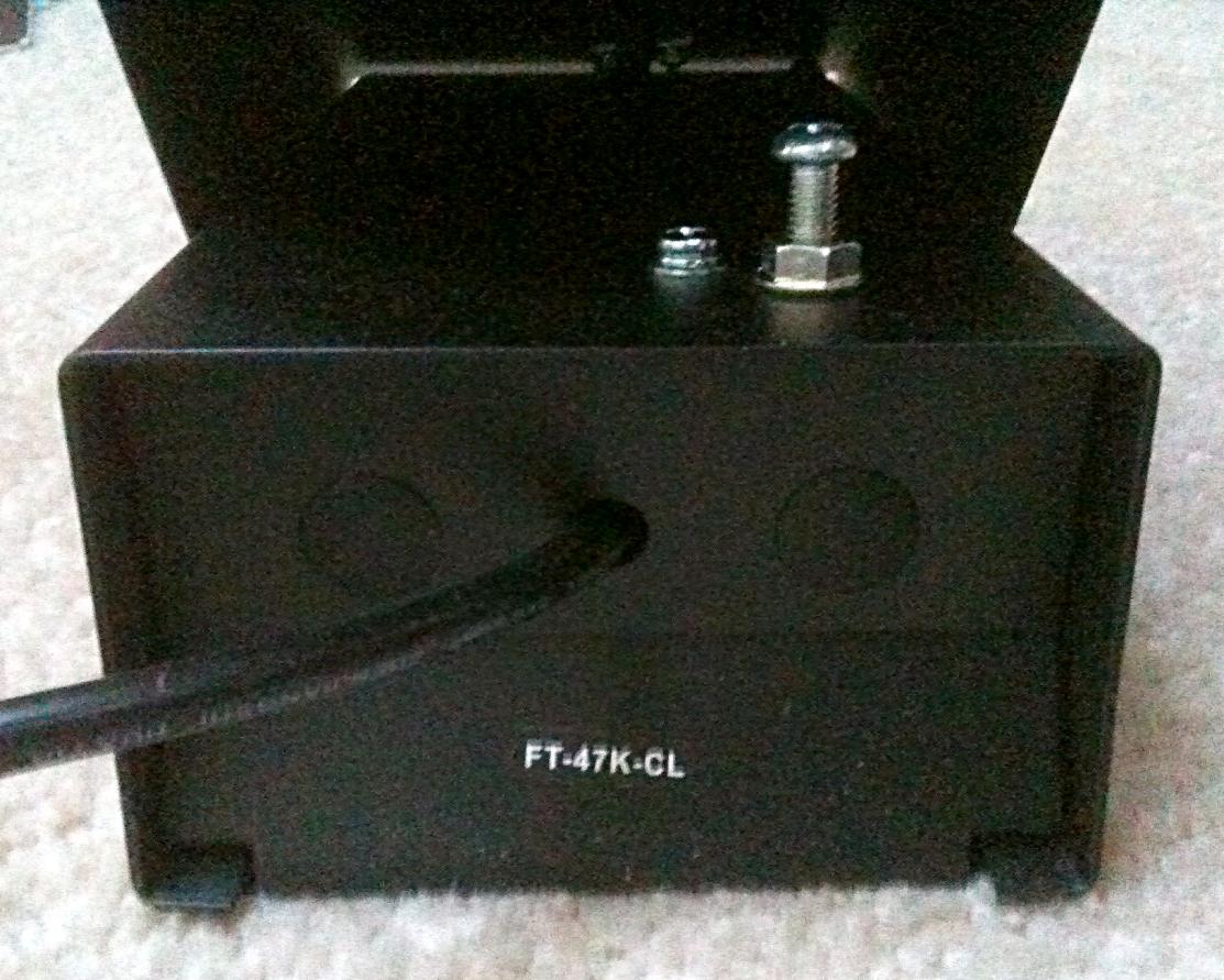

    foot control

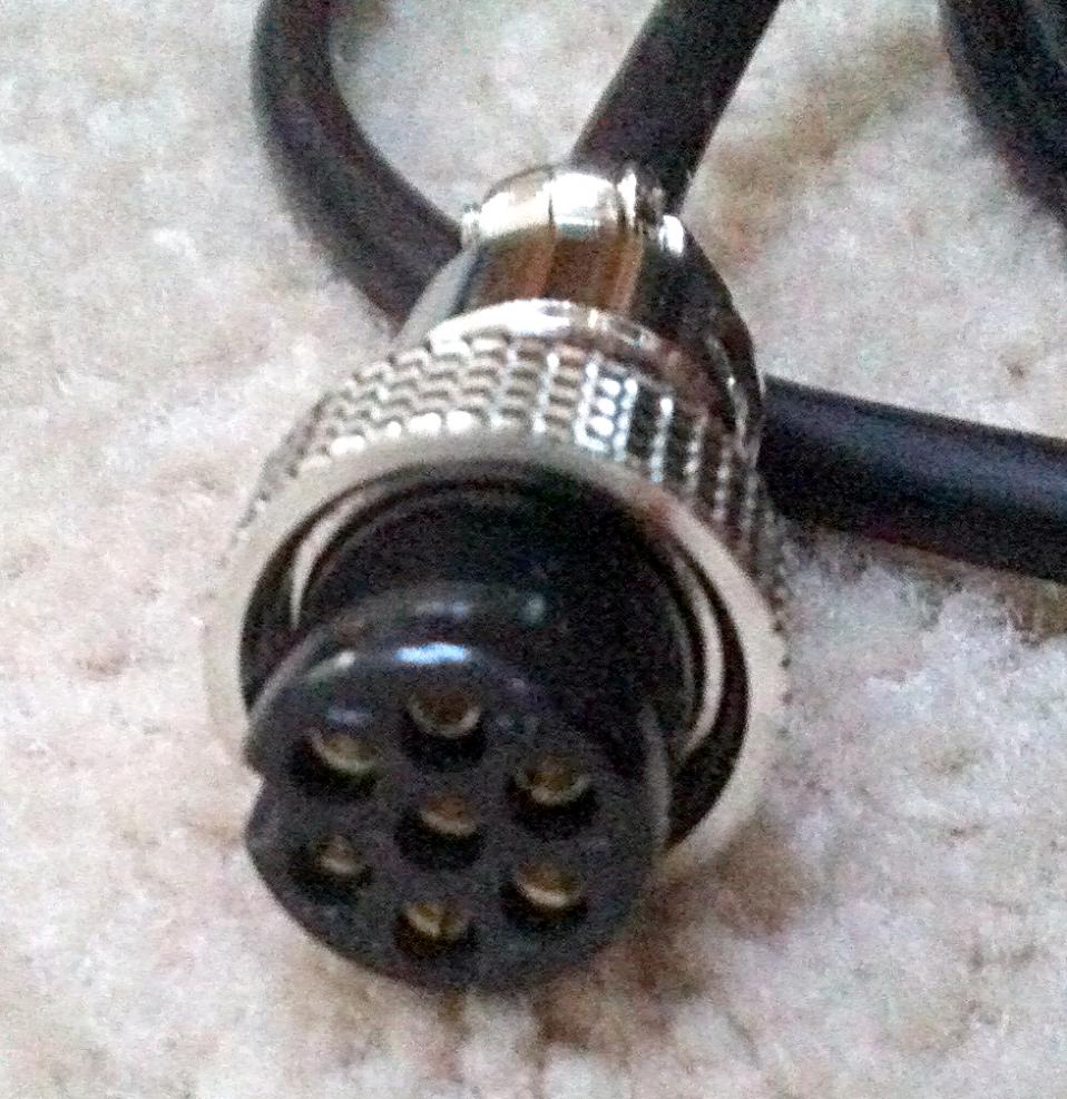

    foot control connector

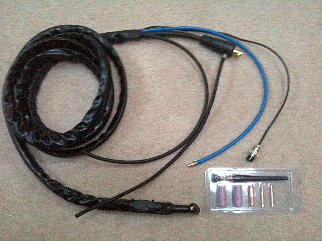

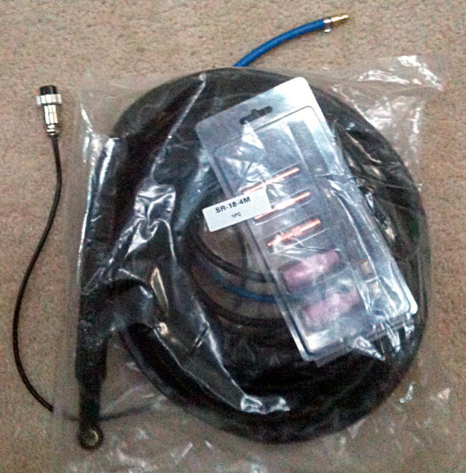

    SR-18 Torch as received

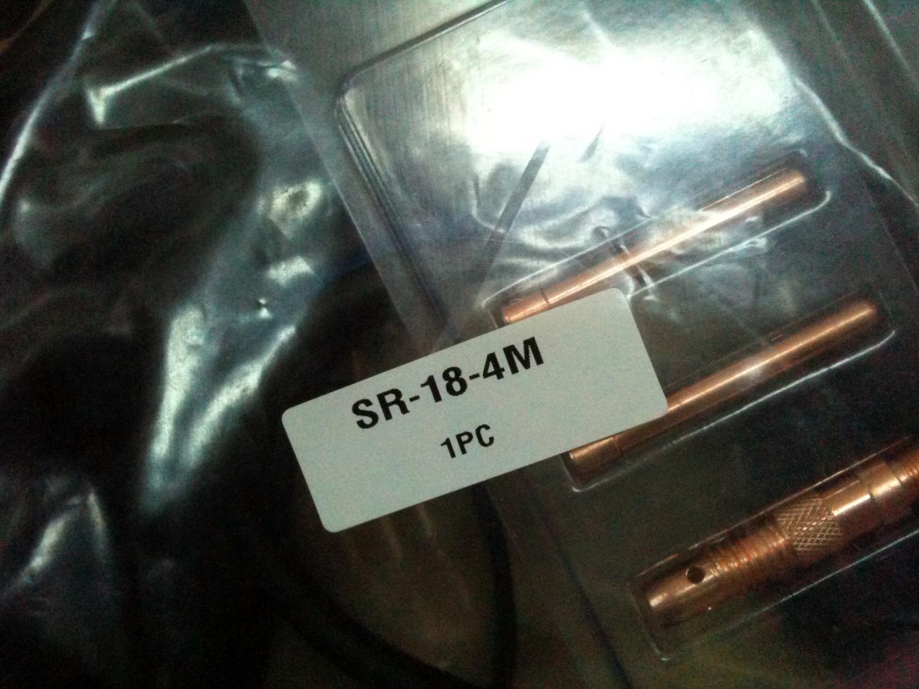

    SR-18 torch parts tag

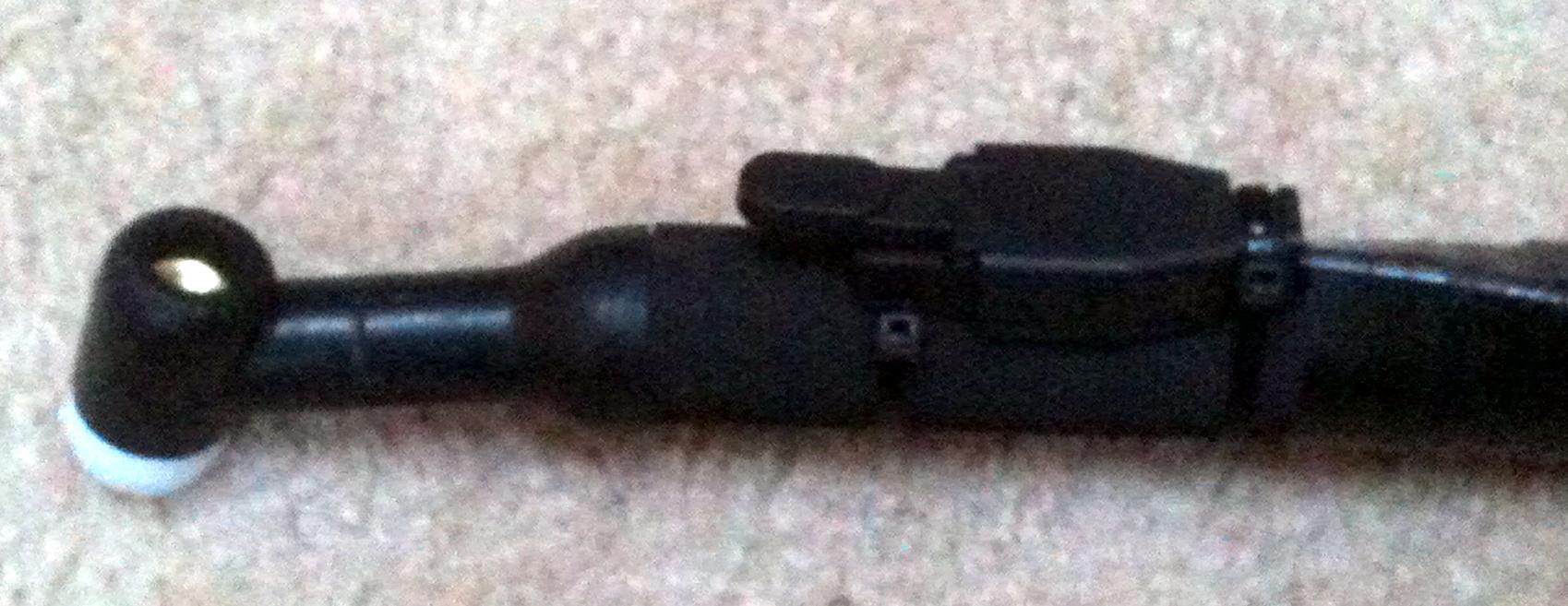

    SR-18 torch

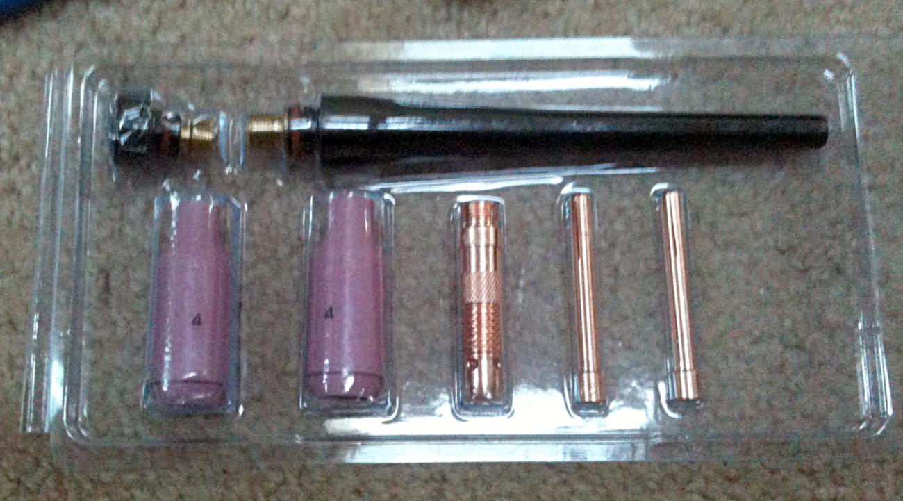

    SR-18 Torch parts

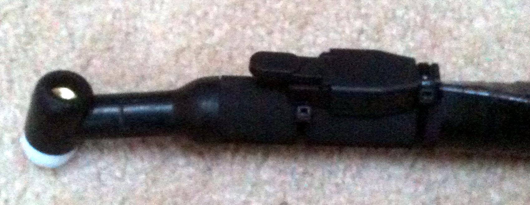

    SR-18 torch head

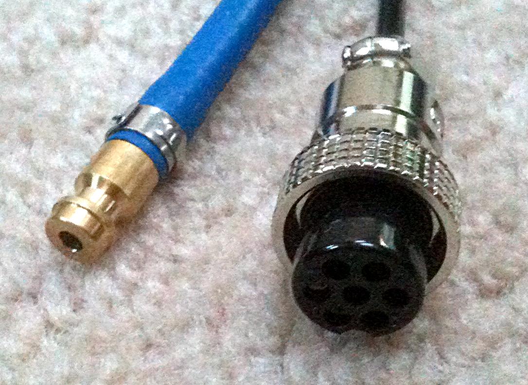

    Torch connections

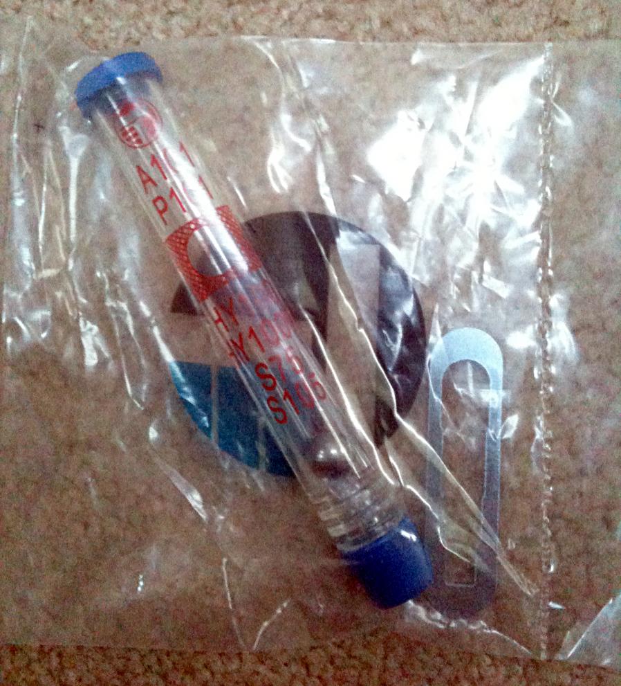

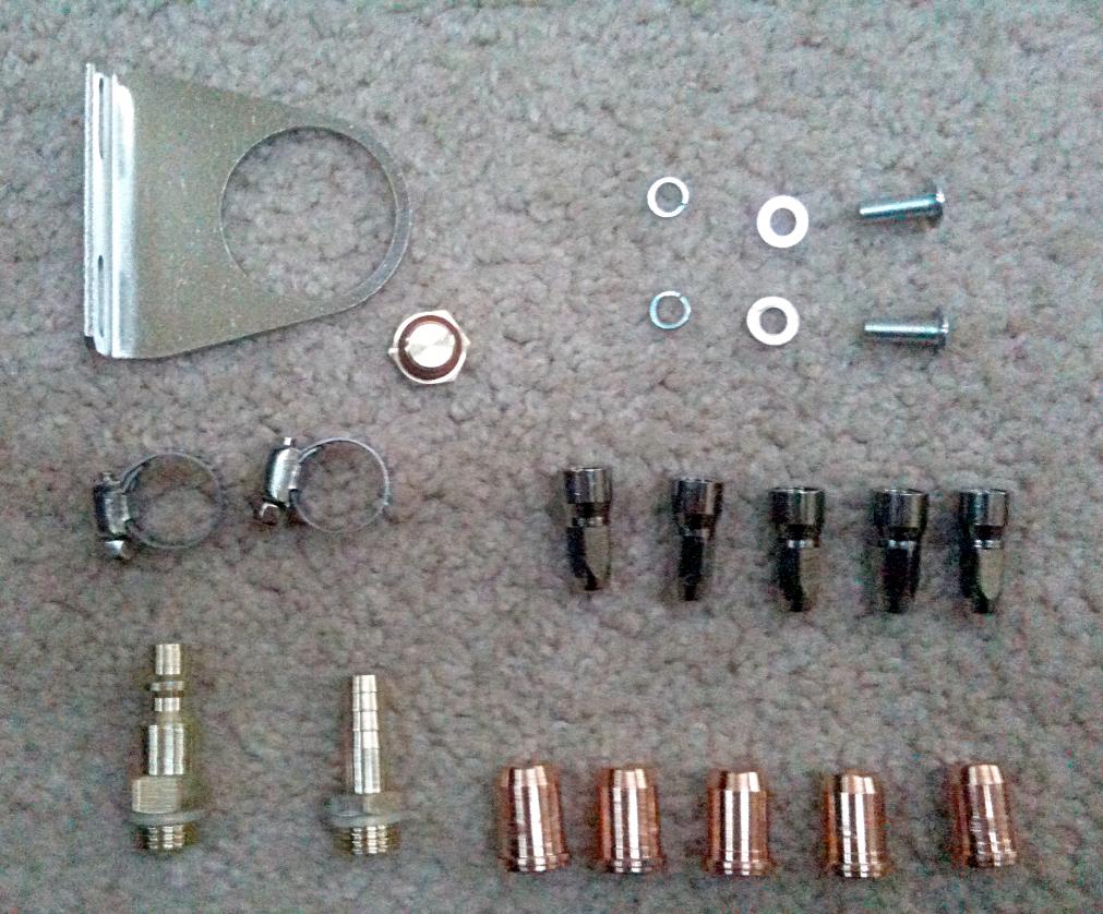

    supplied bagged hardware
    More coming. If you want to see anything specific or ask questions, please do.

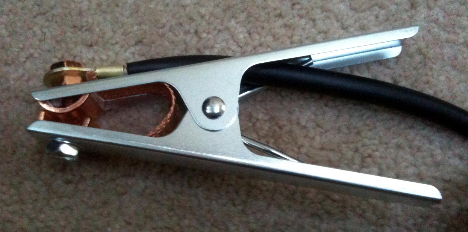

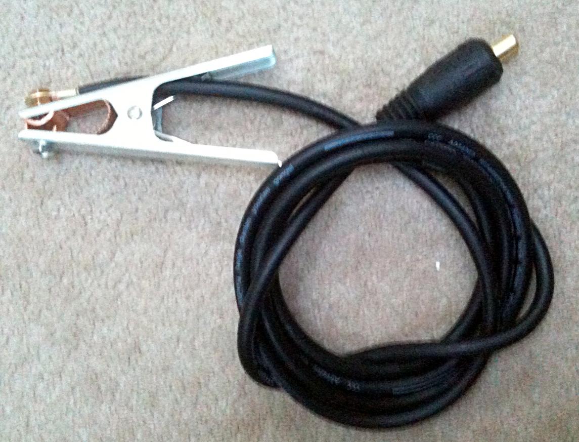

    Ground Clamp

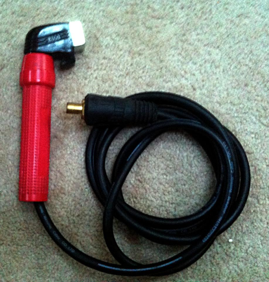

    Rod holder

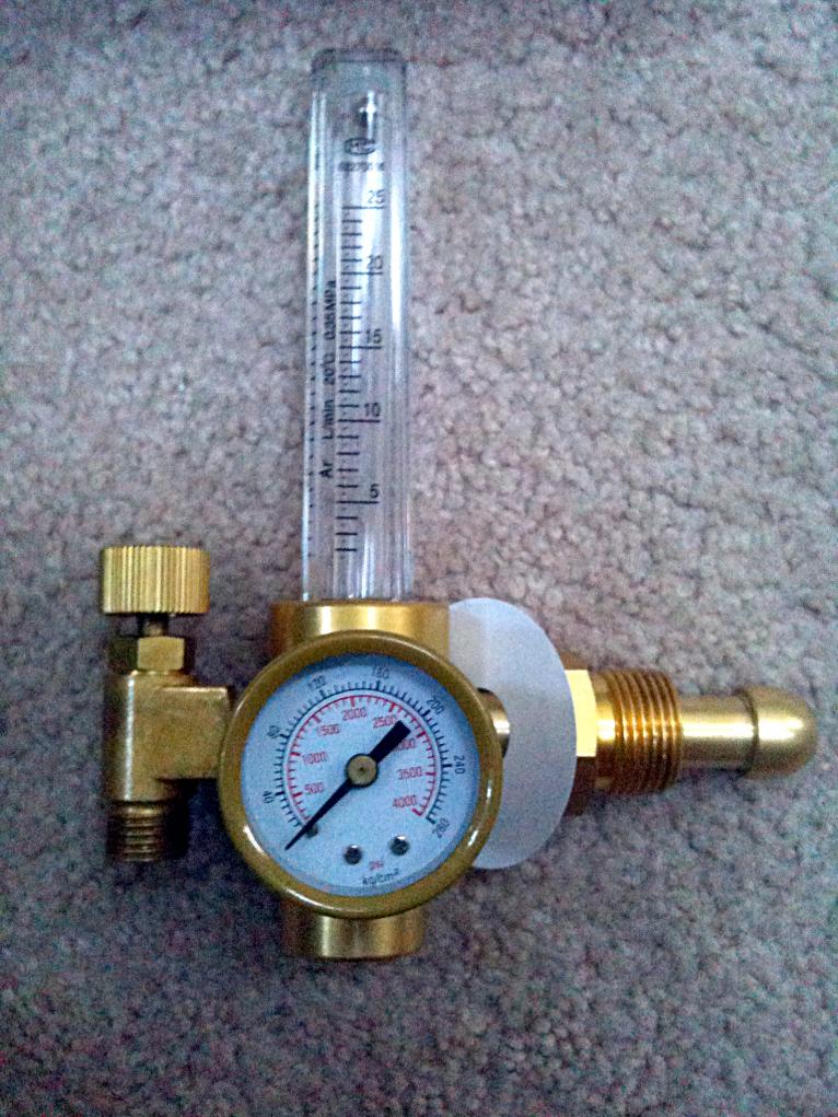

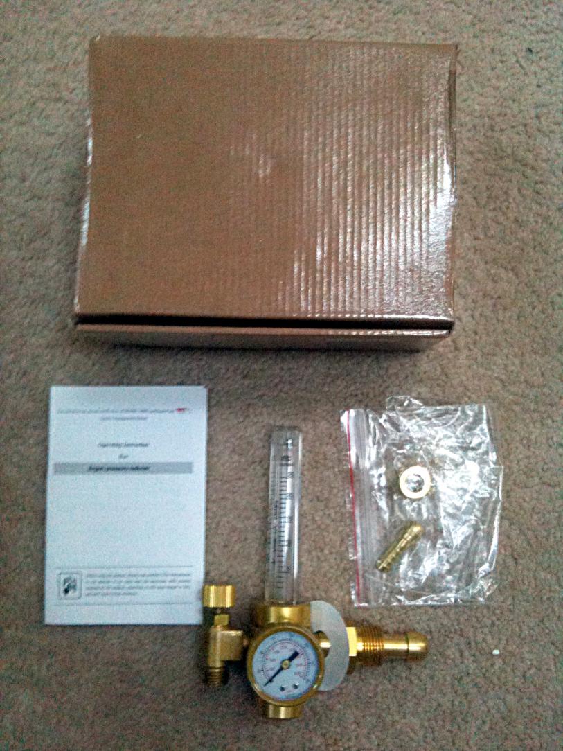

    Argon Reg/flow meter

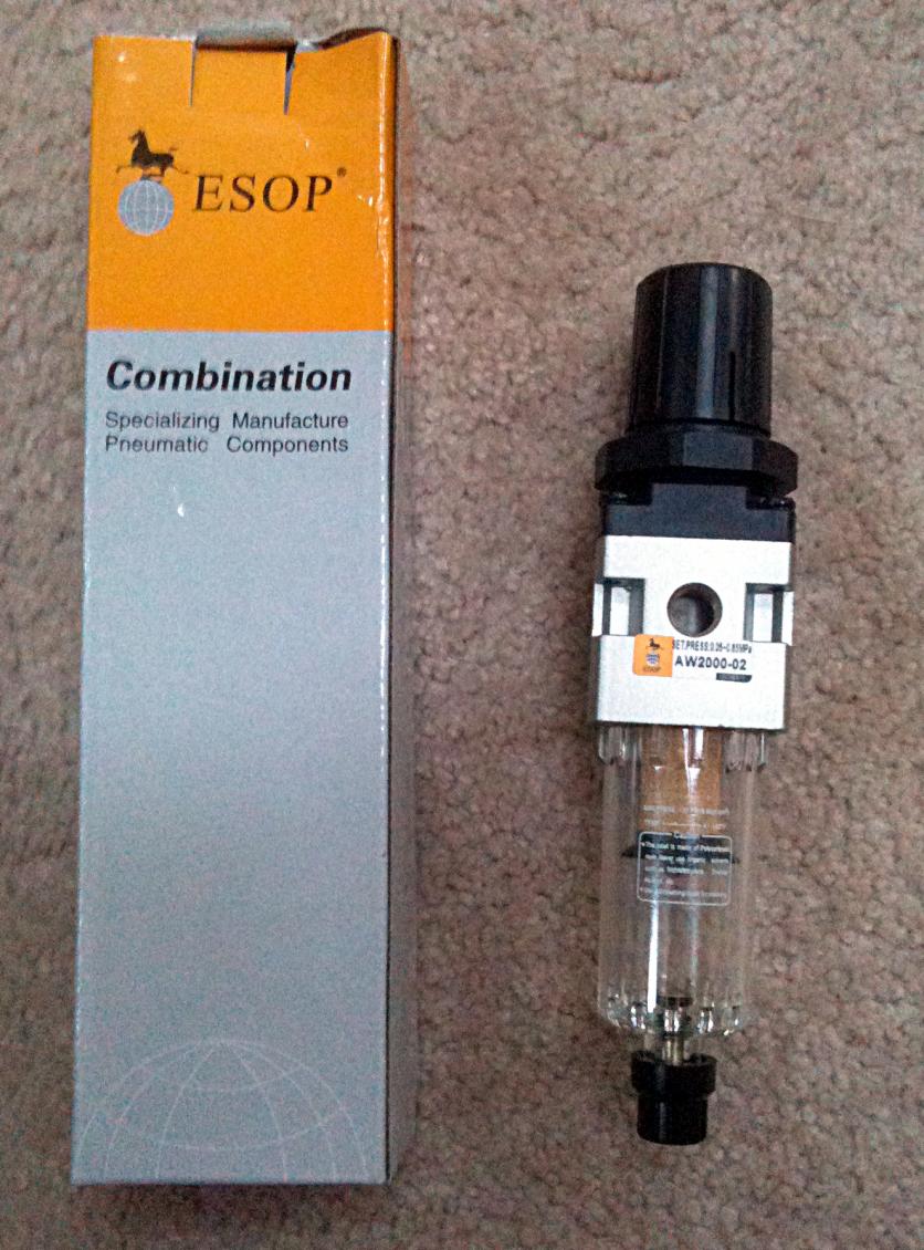

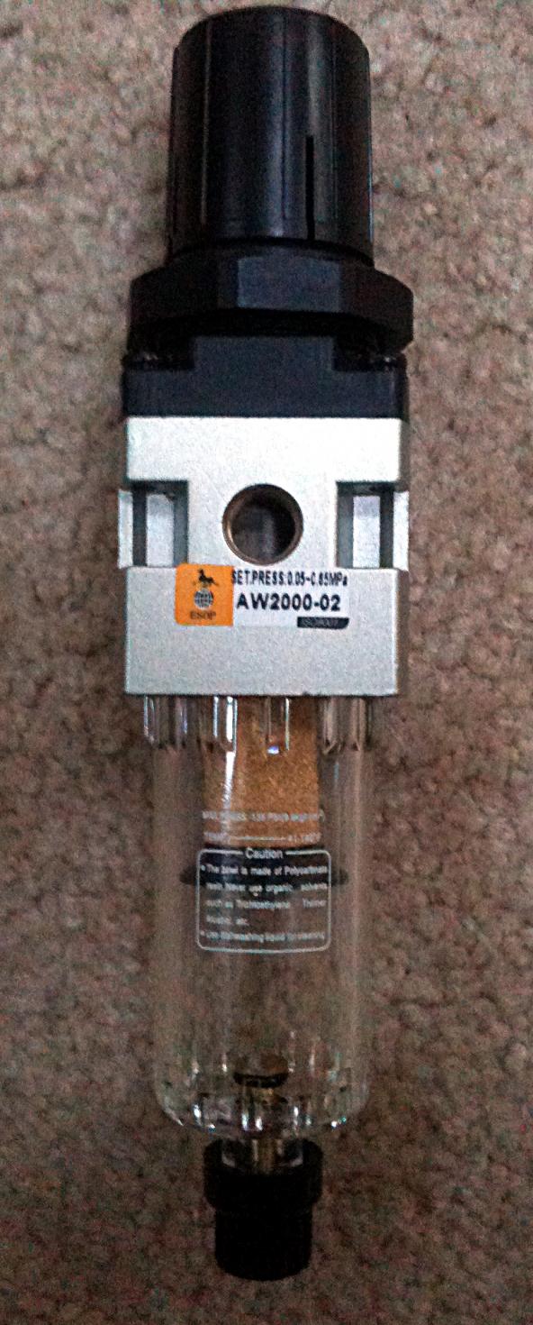

    Air Reg/filter

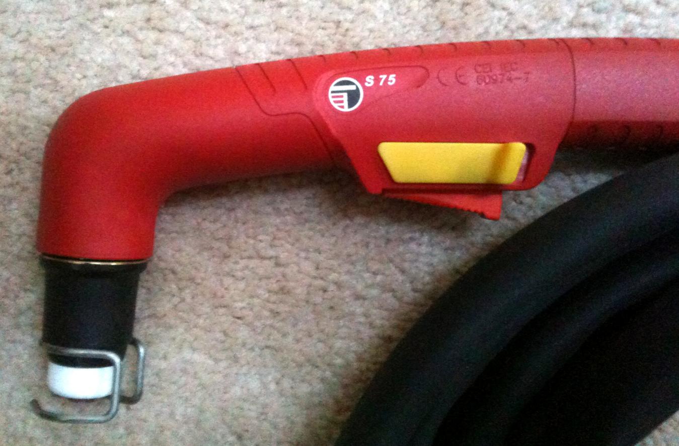

    S75 Plasma Torch

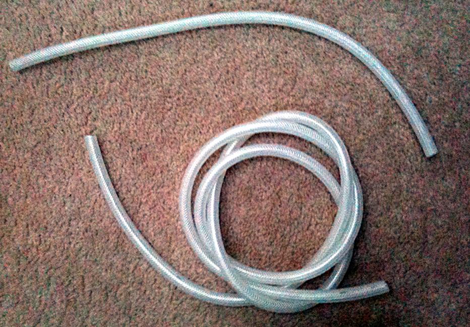

    supplied air hose

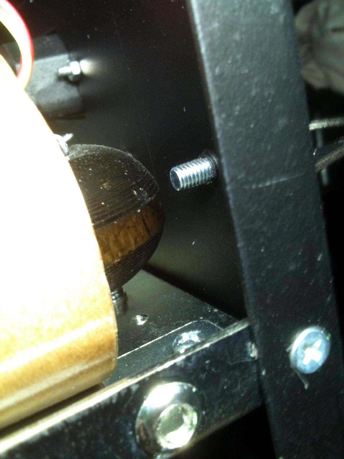

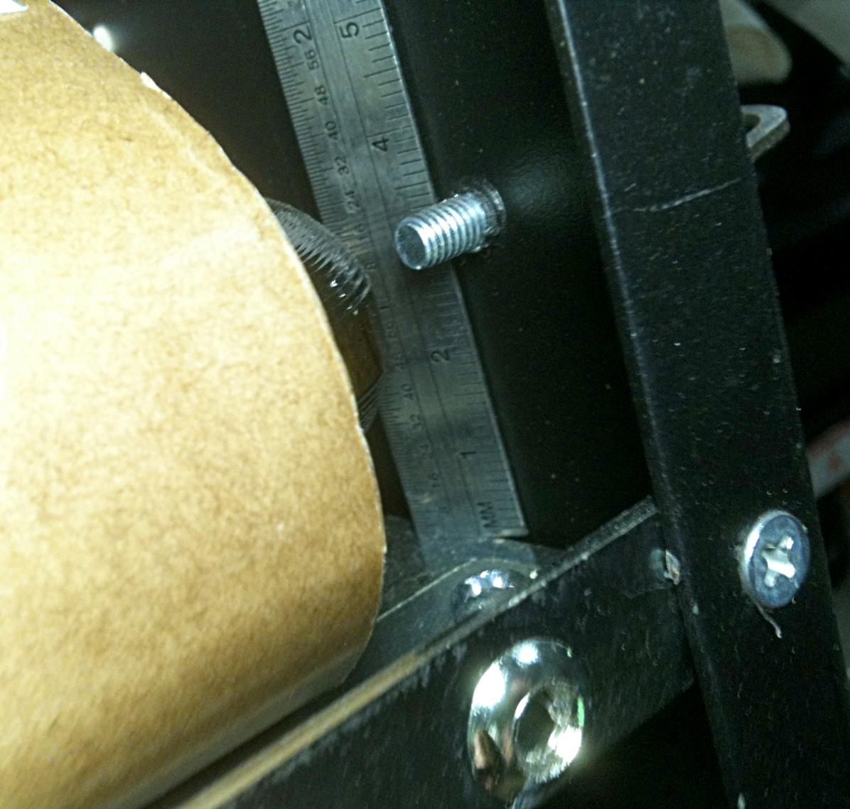

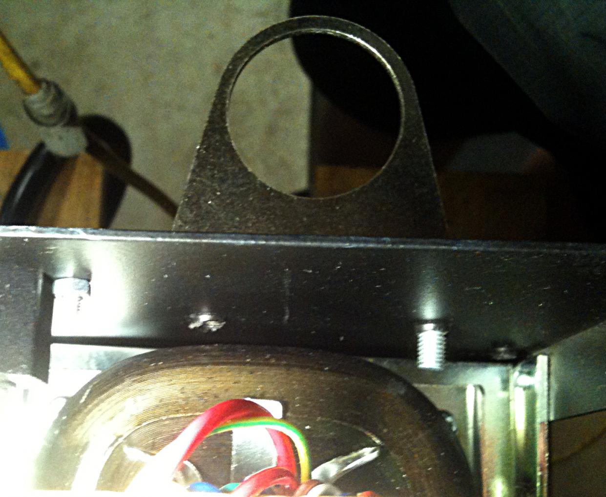

    Congratulations on your new PP256S! A word of caution, on my 2012 PP256 the supplied screws to install the Plasma air regulator at the rear of my unit were TOO long and came into contact with the windings on the transformer just inside the case at that location. I just reduced the length of the one screw that was too close and was in conflict with the transformer. You unit may not have this issue. Enjoy!!

    These units have new regulators for tig.
    The Argon regulator, as shown above (pics)
    Box has a part number: AR GH-191
    this specific part number is not in the manual that comes with it, but in the manual, all
    the different part numbers that are listed, have the same specifications.
    The pressure gauge scale reads in PSI (red, inner numbers(0-4000) and kg/cm² (black, outer numbers (0-280)
    the flow meter has two scales;
    Ar 0-25 L/min 20°C 0.35MPa
    CO2 0-25 L/min 20°C 0.35MPa

    thanks for the heads up!
    due to your advice and others having issue with the HF gap, I decided to pull the cover off my unit and take a peek, just to make sure everything was okay.
    sure enough, the same clearance problem exists with the air regulator mount as last year (surely someone at Everlast knew about this?????)
    they could move both holes down about 1.5cm and be okay (or maybe move the transformer forward some?)
    the quickest fix would be to supply 2 shorter screws.

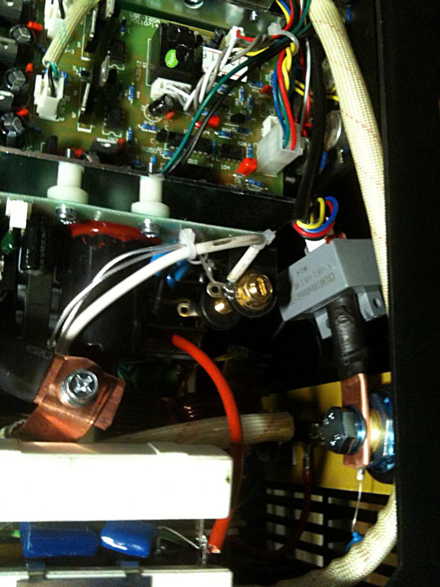

    The HF gap is new and improved quite a bit from what I've seen in other pictures... this one shouldn't move at all
    (located on the left side, front)

    Can that be retrofitted into an older model? I like that much better.
    That would be great if you can get the part.
    I have tried a number of times (more than one PM), with no luck.
    I would be happy to purchase the new points, and retrofit myself.
    How about it Oleg?
    Thanks,
    rivets
    From the looks of it, you would change the whole HF board. Probably not worth it unless you slam your welder around all the time like a mobile welding truck. The points on an inverter get so little on time, that even the old style should last a lifetime.
    I have had to re gap before. If you exercise the hf start to much, like when you weld something that you can't get a good torch position, the points move probably from too much heat.
