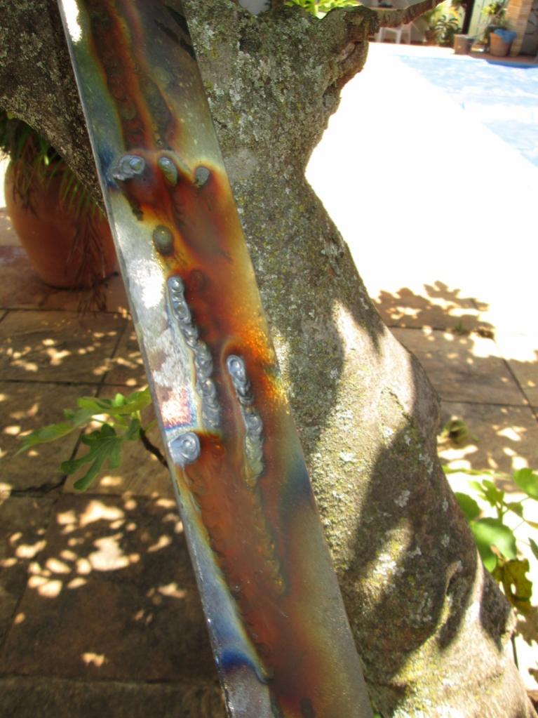

    However, I wasn't able to make a beautiful bead. While I was welding, I had the impression that I saw flames. When I finished, I realized that the bead was "burned".
    First thing I did was increasing the argon (I'm using 100% argon) from 6 to 10lpm. Then I started again. Same thing. Completely "burned". I recorded another video today, please see the sparcs coming from the welding. I think it is not normal.
    http://youtu.be/3ndXBjjzbg0
    Please give me your thoughts. What am I doing wrong? [
    Ps. There is an attached file in which you can see the weld bead. Click image for larger version.

    You're holding it too far off the metal for one. The other is that you haven' t cleaned the metal and you are burning up mill scale, part of the reason for the sparks. You do see a slight flame from the torch. It isn't what you think of as an arc, but rather a cone of plasma which looks like a flame. Another issue is you aren't steady and that torch is all over the place and it is tilted into the direction of travel. The top of the torch should be tilted away from the direction of travel. Another possibility is that you have contaminated gas.
    You might want to put something under your torch hand to rest it on, like a small block of wood. You have to be a lot more steady and hold the arc gap even at all times, as Mark said. The best thing is first to practice without an arc or helmet. Just practice moving the torch smooth and steady, holding the gap at about 2mm. You will need to be able to slide your hand while keeping the gap exactly the same. It does take practice. As Mark also said tilt the torch the other direction so the gas blows out in front of the direction you are going. The sparks are from contamination. Be sure to grind your tungsten if you ever dip it into the weld puddle. It's hard to tell from the picture, but I think I see grinding scratches on the steel you are using. If so that's good, if not as Mark said remove any mill scale before welding. Also the steel needs to be good quality. If your grinding disc has been used on lots of other things, get a clean one, as paint, oil and other things can be transferred by a dirty disc, or wipe down the metal afterwards with acetone. The main thing is that for TIG everything needs to be clean.

    I was able to do a better job today. You were right, the piece that I tried to weld yesterday was grinded. But somehow I think it was contaminated. Here in Brazil acetone is stricly controled (it is used for making drugs). Sales to a particular is forbidden. We only find it mixed with other solvents in drugstore, sold as a nail varnish remover.
    You will laugh, I'm sure you will, but that may have been the cause of the "burned bead" yesterday: Today while I turned on my unit, I realized that the internal cooler makes a lot of "wind". Yesterday I had my unit close to the area I was working. Maybe this is the cause.
    My weld is far from perfect, but I had a huge improvement. Click image for larger version.

    And yeah, having my arm resting and my body steady made all the difference. You guys helped me a lot, you were able to solve all my mistakes. Thank you.

    Yeah, I didn't think to mention wind. TIG and breezes do not mix. Be sure to shield the weld area from wind. Lacquer thinner, alcohol, or carburetor cleaner are acceptable cleaners as well. As with any solvents be sure to have good ventilation when using.

    It's really easy to contaminate the grinding wheel when removing rust, paint, grease, etc. Just the other day I ground down a urethane coupler and then tried to grind a piece of metal to prep for welding. I caught myself with the contaminated flap disc and was able to switch it for a new disc, but that would have made a mess if I tried to tig weld over the top of that contamination.
    A loss of shielding gas, dirty metal (or coated metal) , or a contaminated tungsten are all giveaways of the sparks that are seen when you strike the arc in your video(s). Also, I didn't even notice this until I just watched your most recent video, but you should be traveling from right to left (torch in your right hand, filler rod in your left hand) if you are indeed right handed.

    Put up something on top of your welding table to block the wind from taking your shielding gas. You can use lumber, plywood, a few sheets of metal, practically anything that will keep the wind from affecting your weld area. Even hanging a blanket up will give you a little shielding from the wind.

    Andy, like I said, I had some previous background on stick welding. I was not expecting that contaminants could cause so much trouble!! The wind was caused by the unit fan, then it was pretty easy to deal with that: I just changed the unit position!

    Most "burning" is cause by oxygen getting into the molten puddle, check for argon leaks, and make sure your torch is put together good. Keep any breezes away from the welding and make sure the metal is not contaminated....along with the tungsten. Good luck!
