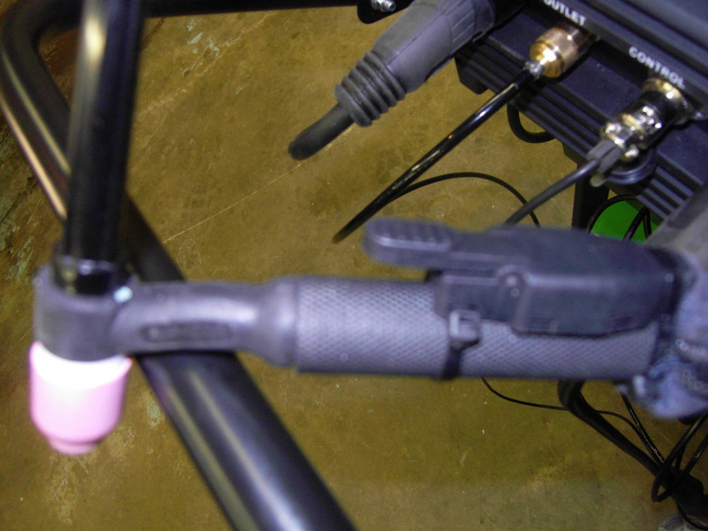

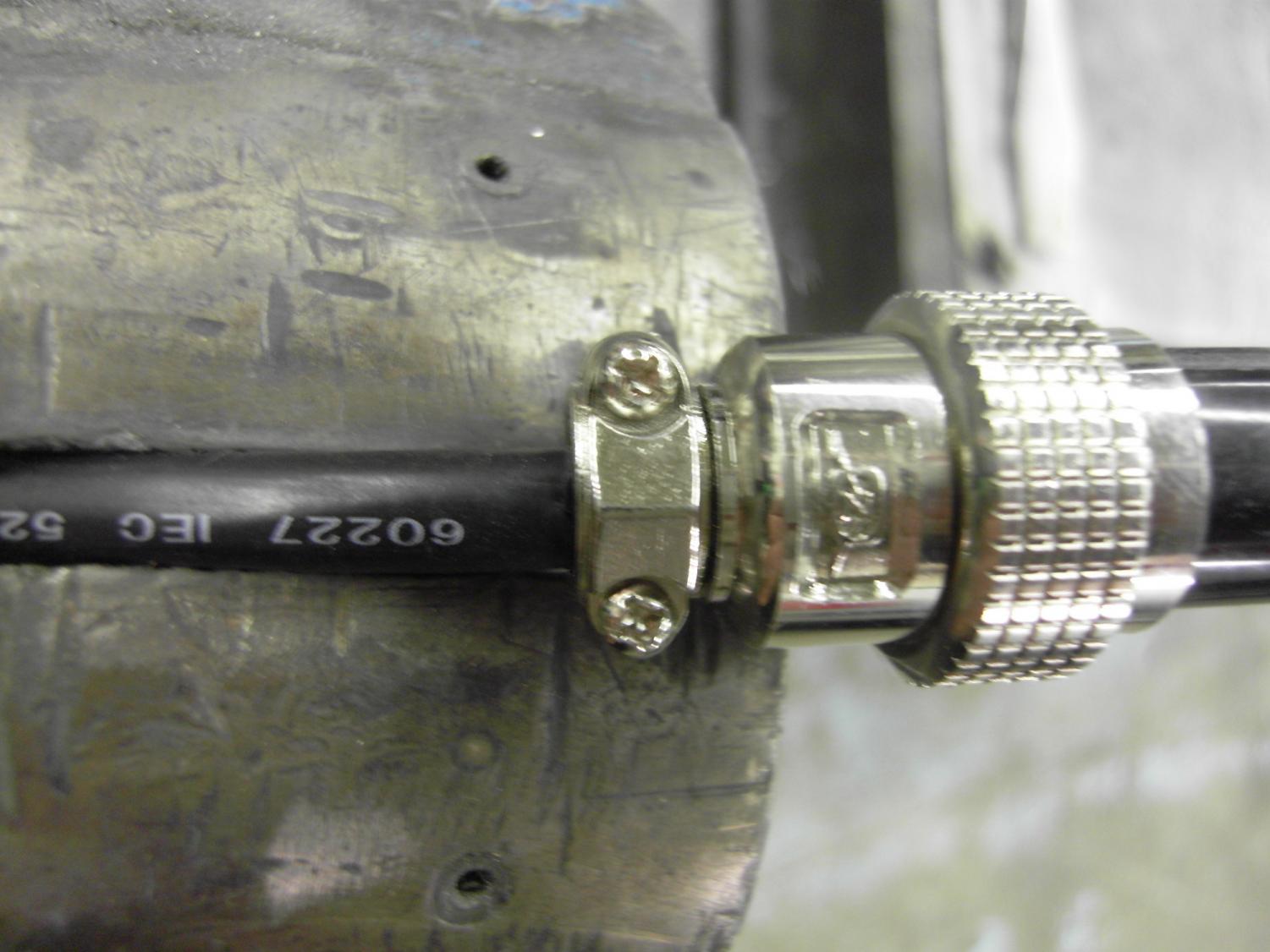

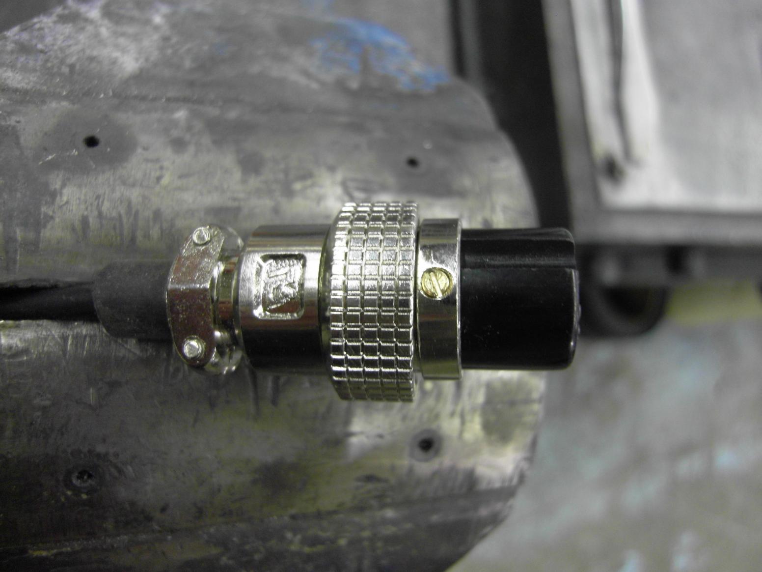

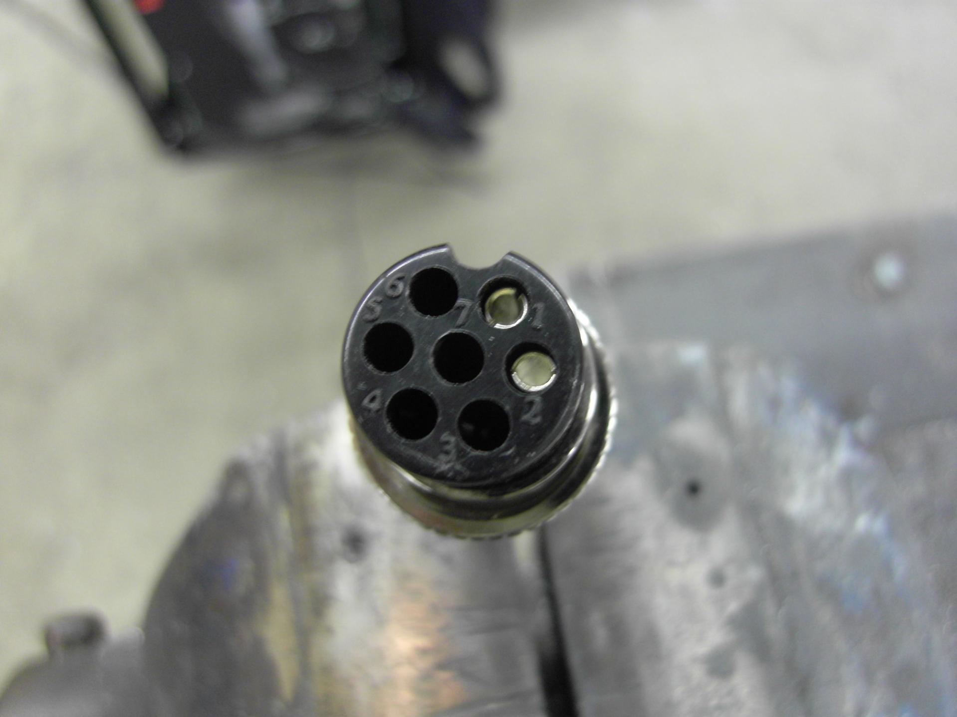

    Just pulled the pins out of the plug that is on the end of the torch for the switch 2T or 4T control. Just take the little screw out of the chrome cover and the two screws holding the wire and filler out then unscrew the chrome part you will see the spare pins squeeze them together and push them out from the wire side. The picture on #5 is plug in to the welder with the chrome cover out of the way. NOTE look at the plug end that goes into the welder and see if it has two sliver connectors if so leave it only if all the pins are there you can remove them if you have the problem. The foot pedal as all the pins do not take it apart it will not have the little screw it is all glued together.
