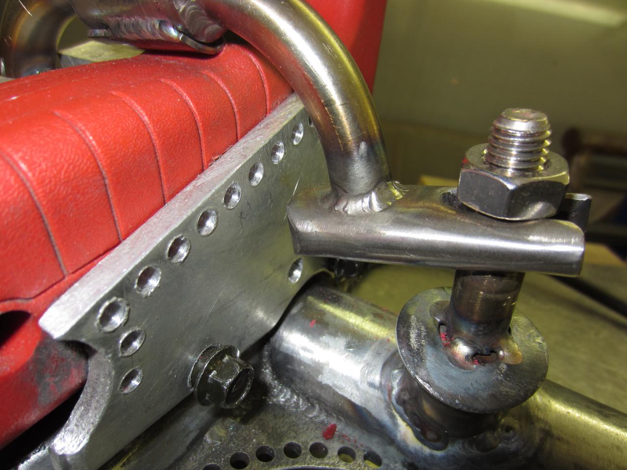

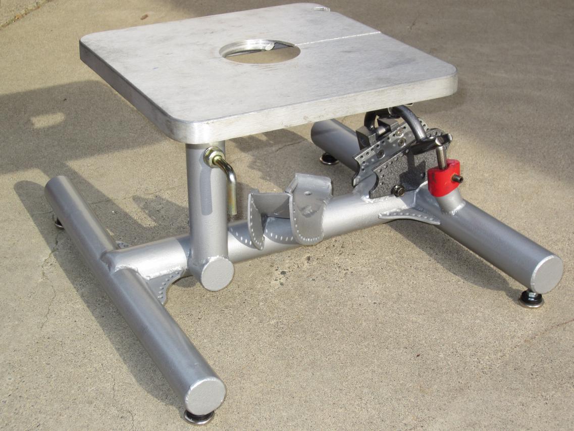

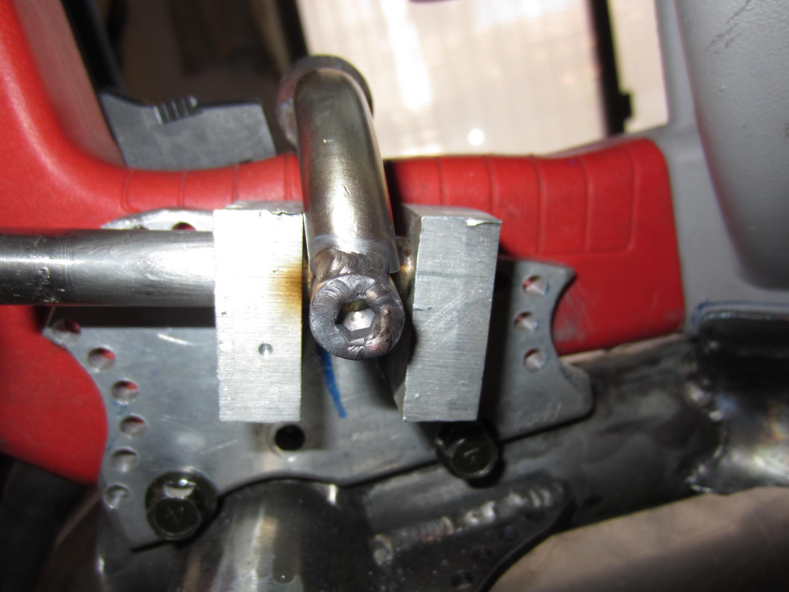

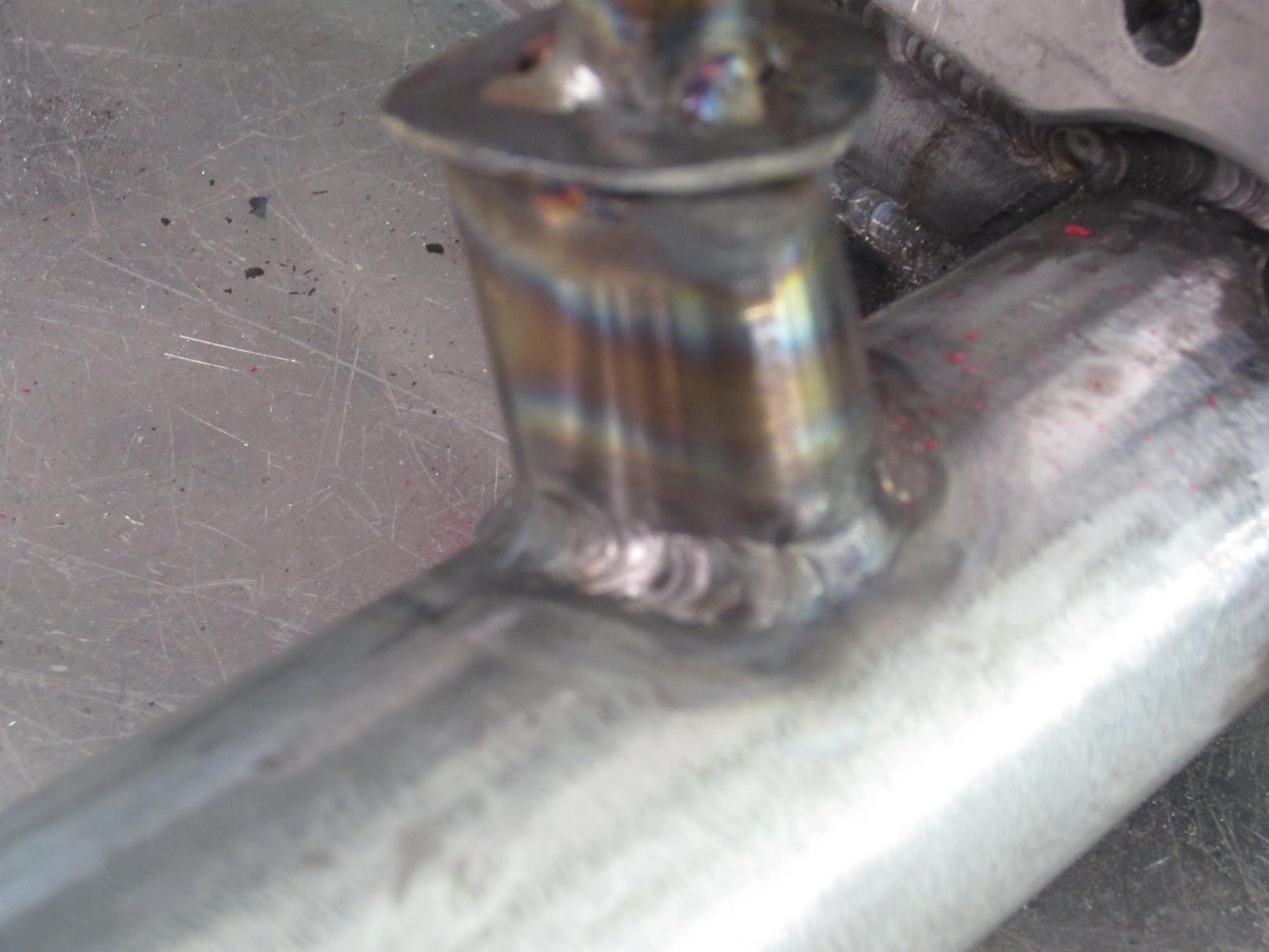

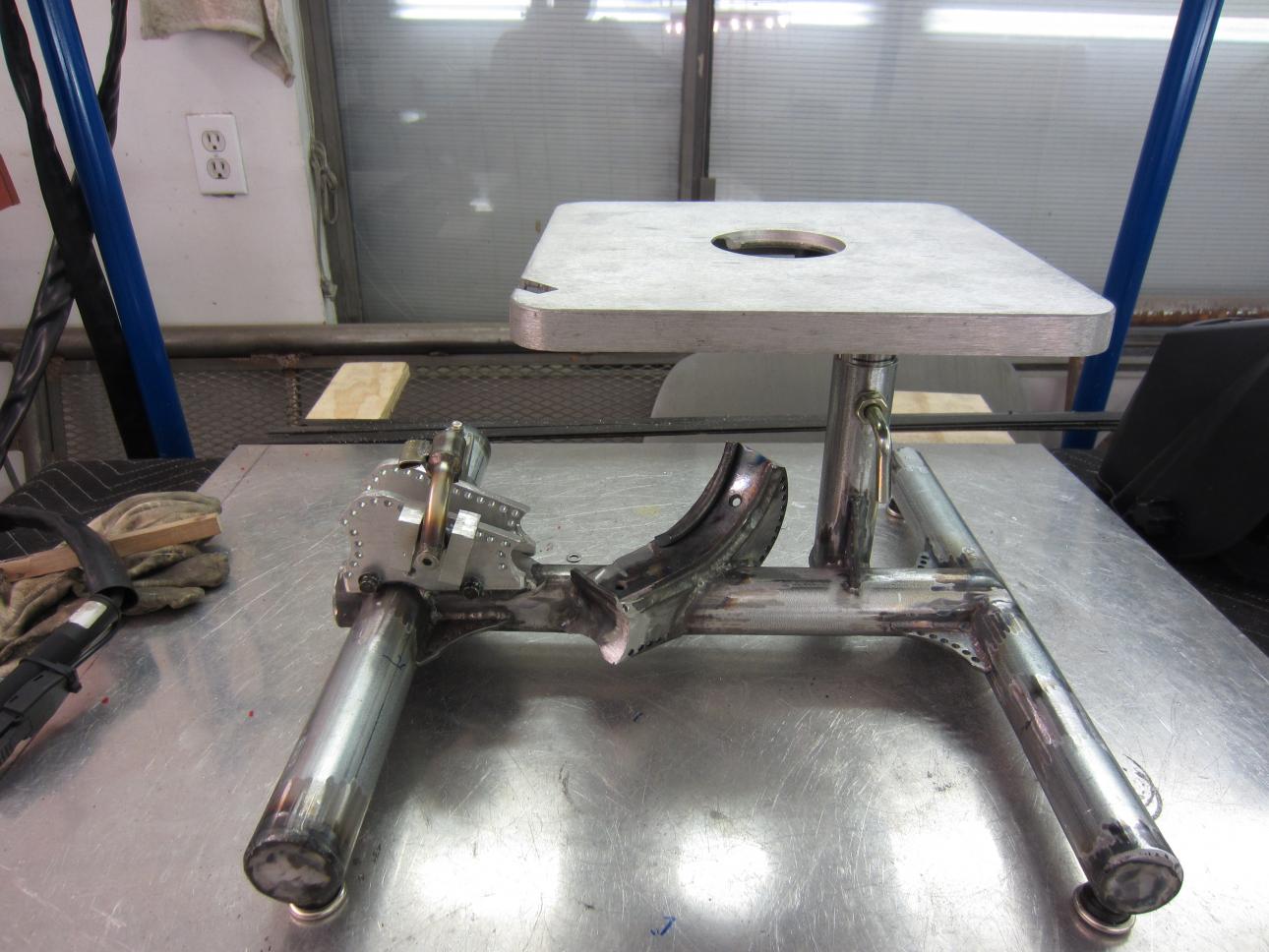

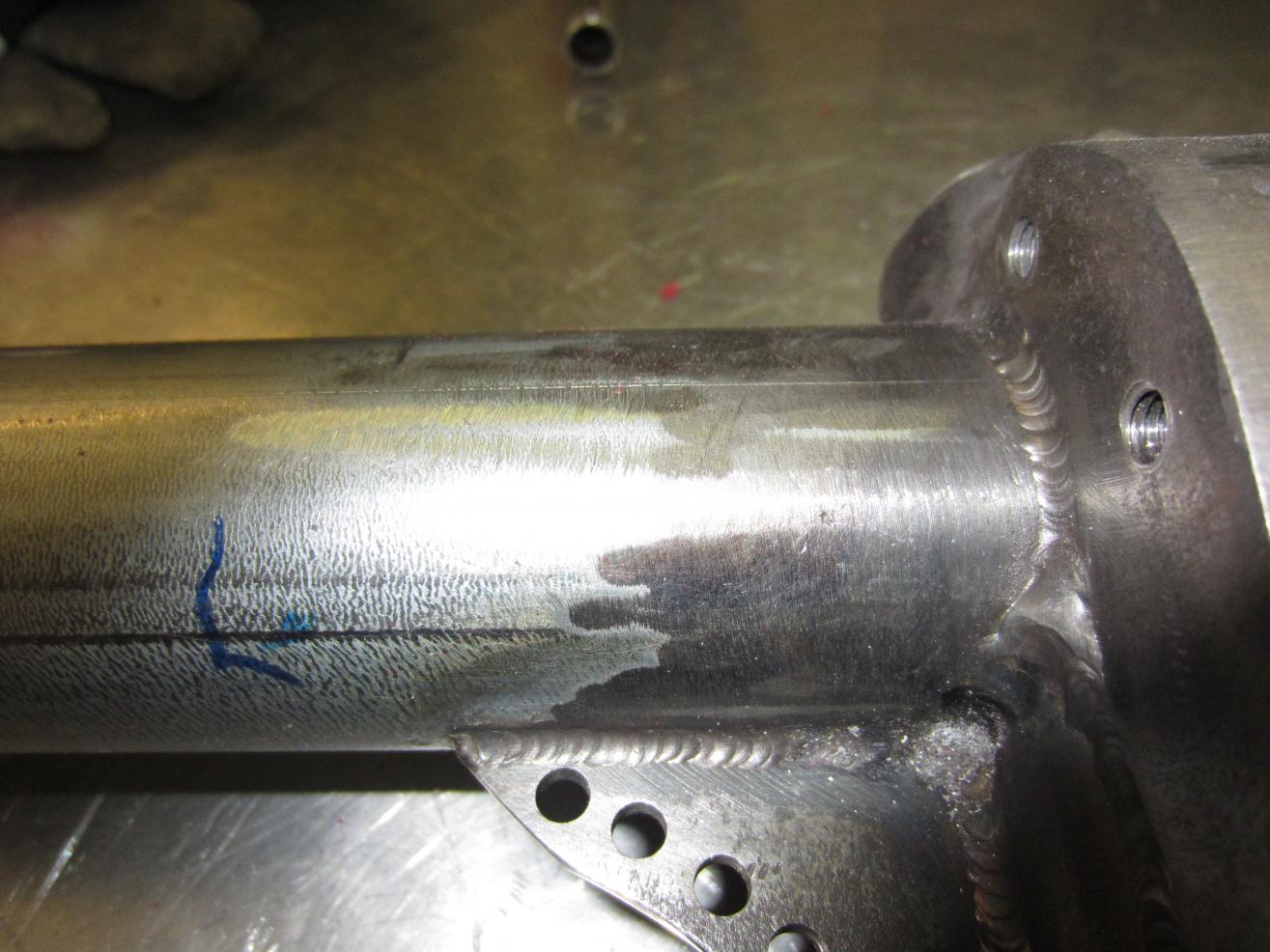

    Okay, so I'm sliding in sideways here with my final entry. My portable band saw has been a great tool for me, but I always wanted to convert it to a vertical band saw by purchasing the SWAG off-road portable band saw stand. I finally decided that money has been far too tight for purchases like that, and I would be better off making my own stand.

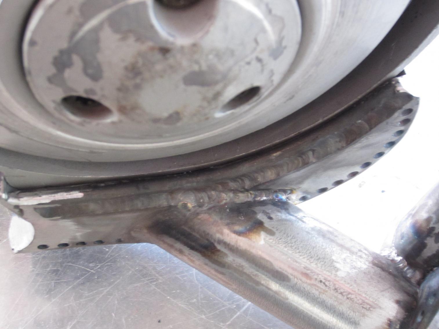

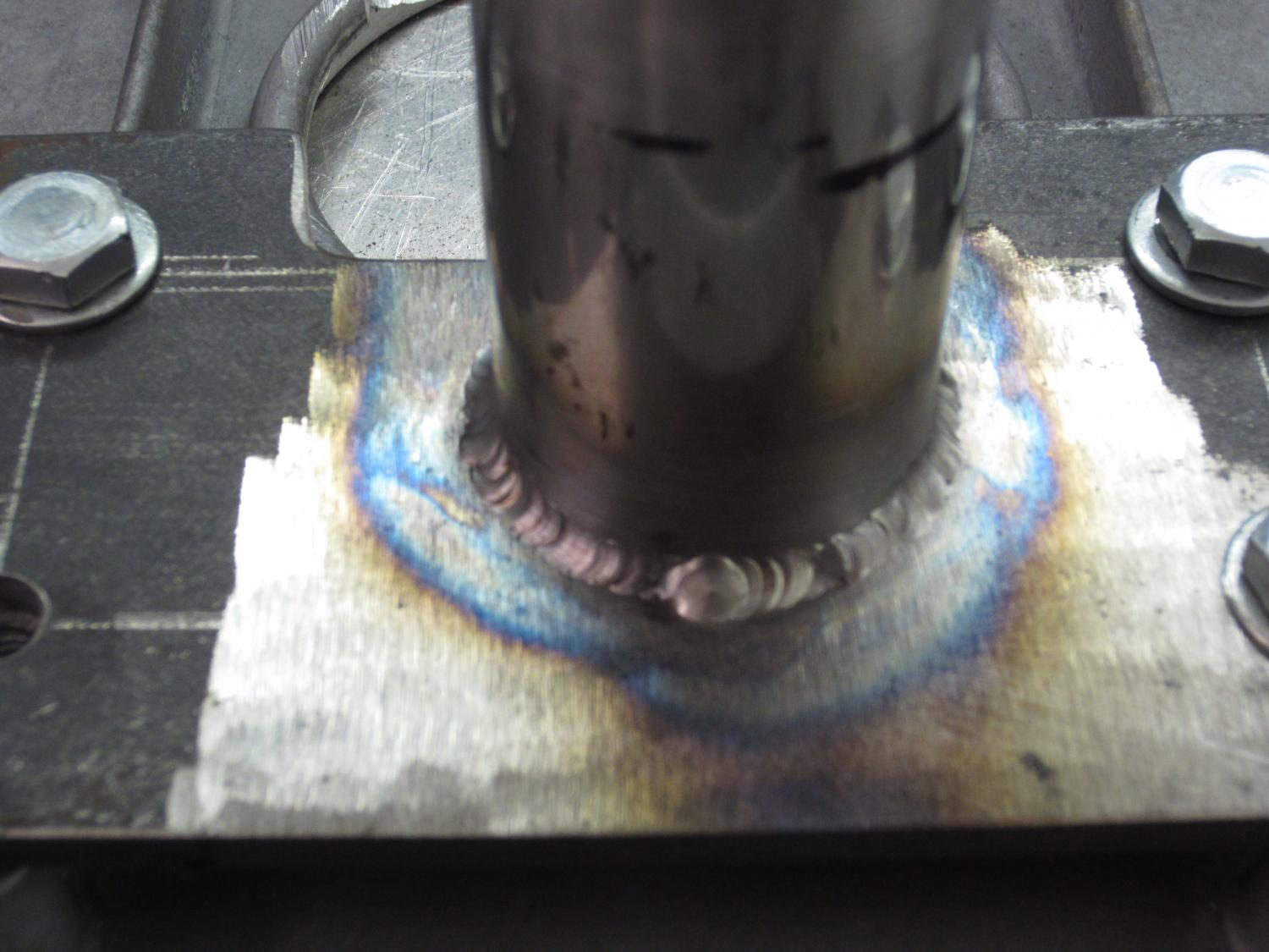

    I started out with 1-1/4" and 1-1/2" EMT conduit scraps that worked out perfectly for dimensions. The front "leg" is 1-1/4" conduit that I had to weld a small section onto (to get the proper length). Everything was coped using a hole saw, and at times, my sheet metal snips. All the caps that are welded onto the ends are 16 gauge galvanized sheet that I cut with my snips too. The front rest where the saw sits is 1/8" flat stock with 5/16" diameter steel rod formed and welded to the flat stock. The gussets in the corners are 1/8" thick hot rolled steel and the bolt on sides that secure the band saw's handle to the stand are 1/4" aluminum.

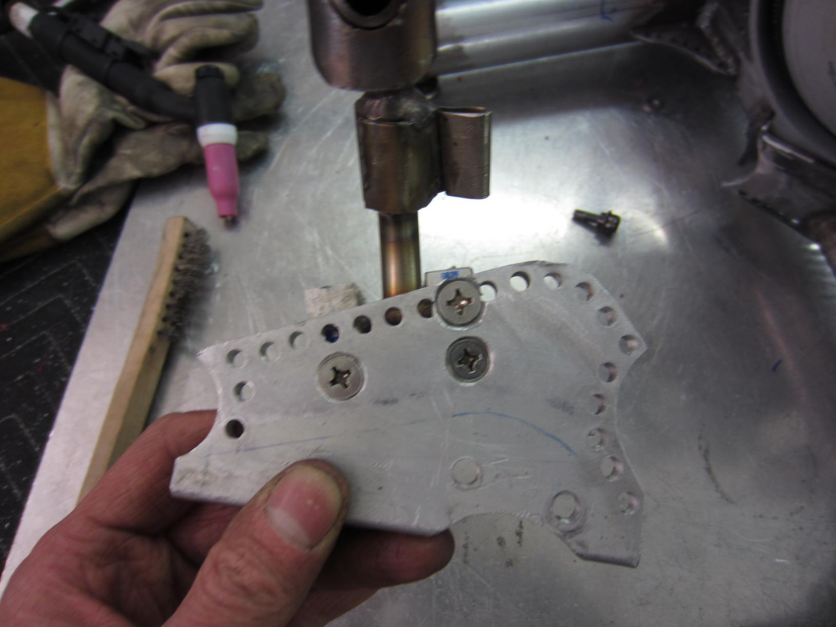

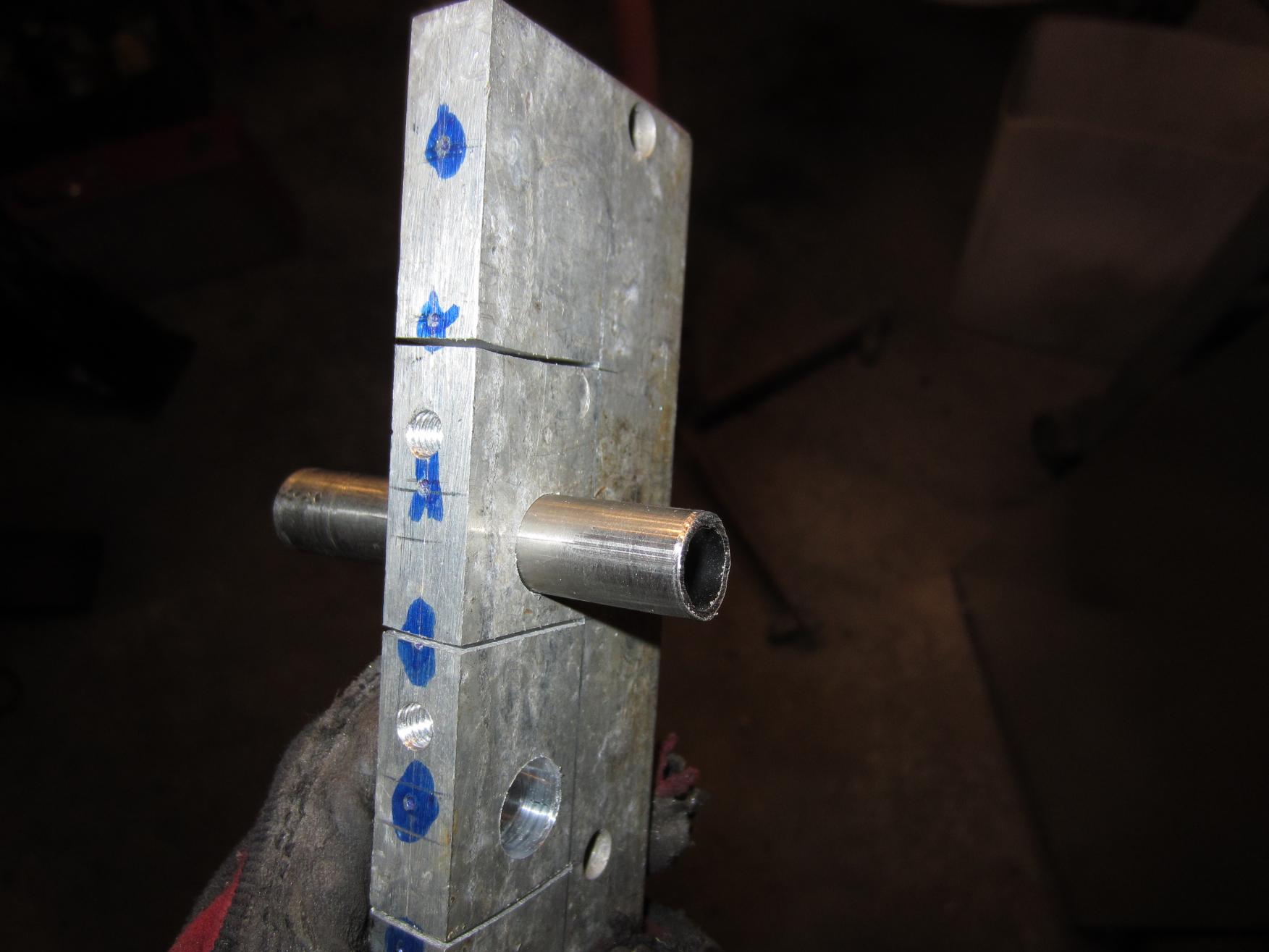

    The machine screws that fasten those aluminum plates to the stand are threaded into 5/16" thick hot rolled steel that I drilled and tapped (before welding to the conduit and the 1/8" flat stock that matches the saw's handle shape). All fasteners used on this project are 6mmx1.00 pitch except for the 10mm stainless screw that secures the trigger hold down. Fasteners can easily be changed out or swapped later if need be.
    The removable aluminum jig saw table is a cheap purchase from Ebay, and the only other item I had to purchase was the adjustable feet on the bottom, which thread into 1/4"x20 TPI flange nuts that are welded to the conduit. A short piece of 1-3/8" OD stainless tubing was welded to flat stock that fastens to the jig saw table via tapped bosses on the tables underside. An electric sewing machine motor hanger holds the table in place until I want to remove it, which means removing one simple clip and pulling the pin (motor hanger) out.

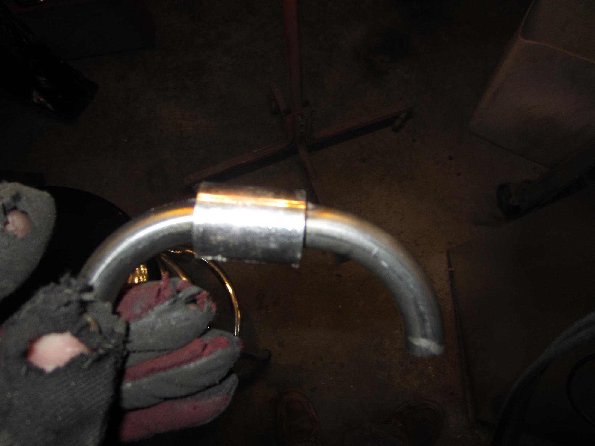

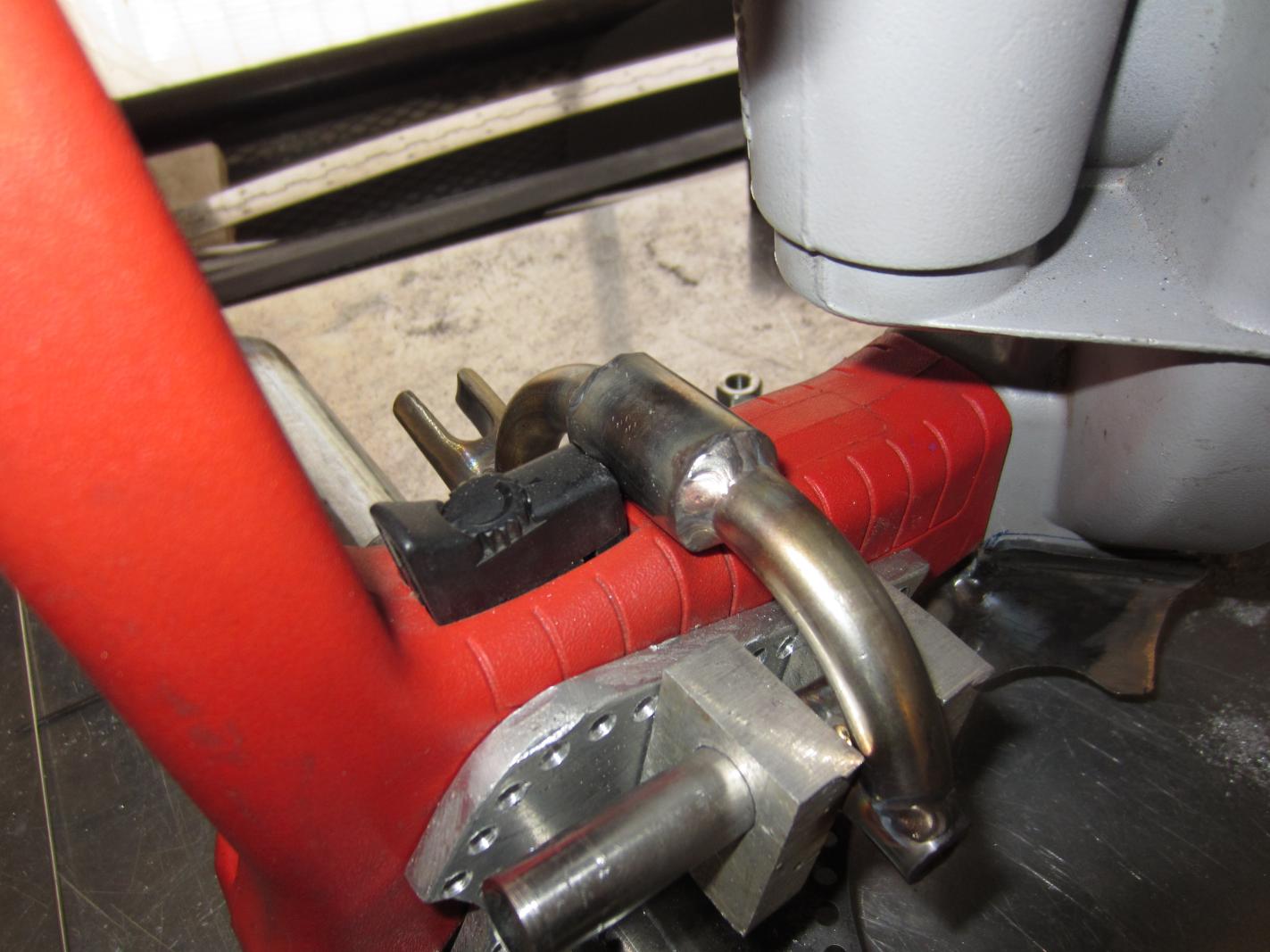

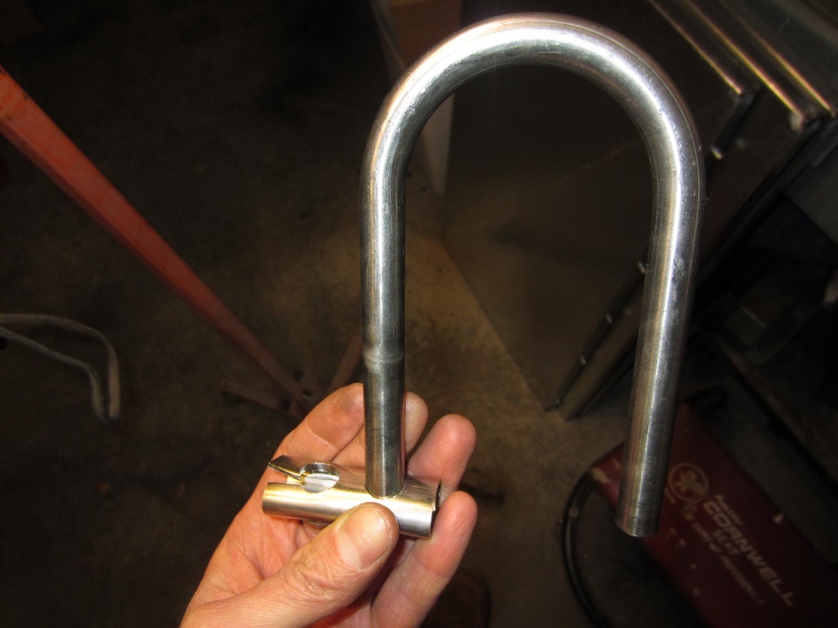

    The most complex part of this project was the trigger and handle hold down, which consists of misc. stainless plumbing fittings that are 1/2" and 3/4" trade sizes. The U-bend is 1/2" OD stainless tubing which I cut and added a stainless plumbing coupler to (in order for the bend to be the right width). The slotted portion that is welded to the U-bend is another piece of stainless tubing (3/4" diameter?) that I formed into an oval shape in the vise. Leftover sections of the 3/4" tubing were used to "box" the open part of the slot, plus the open ends.
    Lastly, the mount on the left rear of the stand is made of 1" diameter stainless tubing that I shaped into an oval so the bolt head would fit snugly before welding. I covered the top of the mount using a flat washer, I fit a sleeve of 1/2 stainless tubing over the bolt to shim things the proper amount so there wouldn't be a chance of tightening down too much. I don't want to crack the band saw's handle or break the trigger!

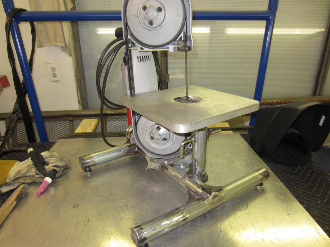

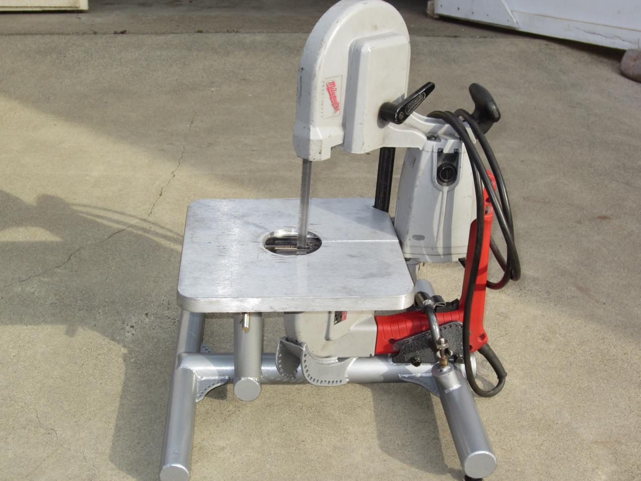

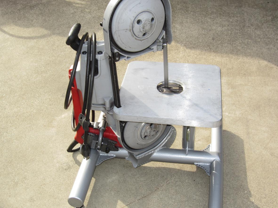

    That's pretty slick looking... nice work! Got any overall picture of the saw mounted into it, ready to a cut?
    Sorry, I was in the middle of adding more pics when you posted. I appreciate the compliment! I worked my butt off on this, and was basically shooting in the dark. I knew what I wanted, but I had to change things around as I went. Pretty much the standard when fabricating from one little vision of the end result that's embedded in your brain.

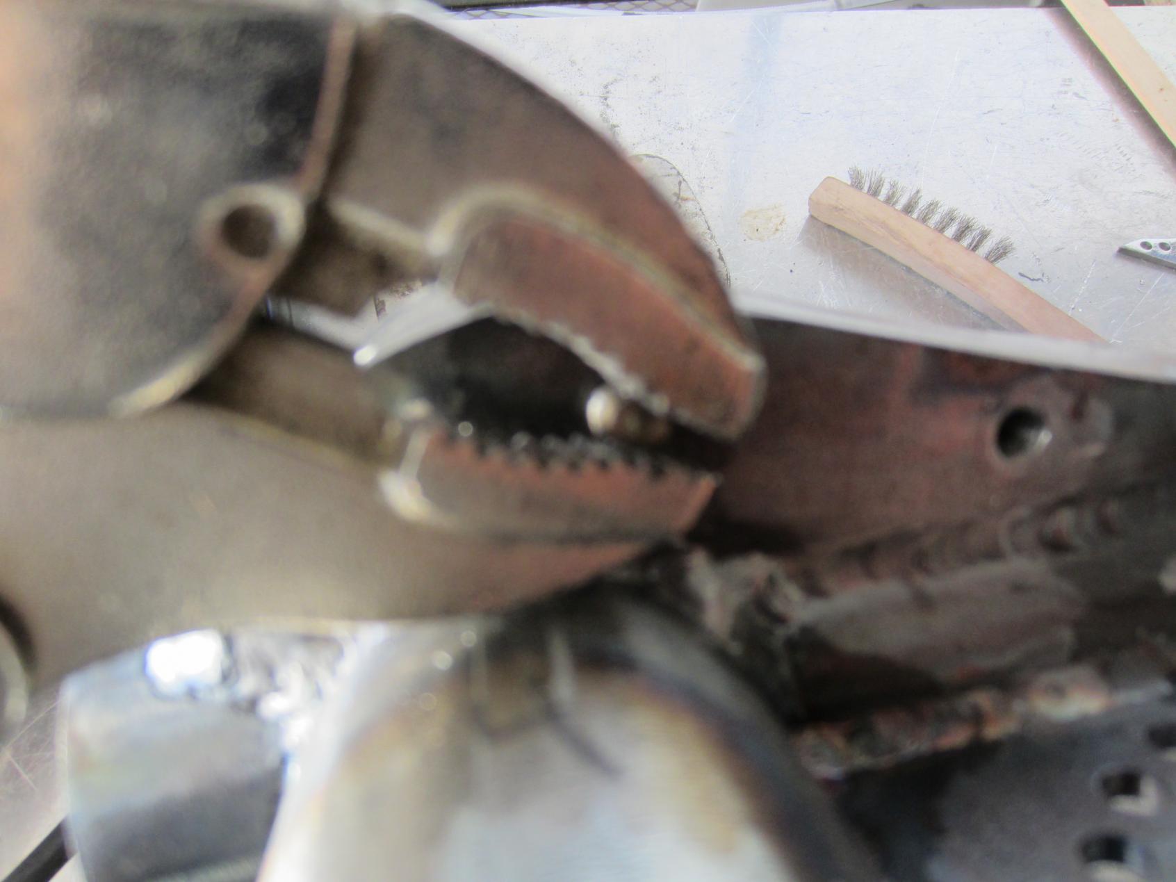

    I forgot to add that one "hurdle" that I ran across was snapping a stainless socket head screw off while removing the aluminum plates! I wasn't happy about that and ended up having to heat the screw up and using a little wax to coax it out with Vise Grips. I wasn't about to use anti-seize before painting the stand (as that stuff ends up EVERYWHERE before the cap is placed back on the bottle!).

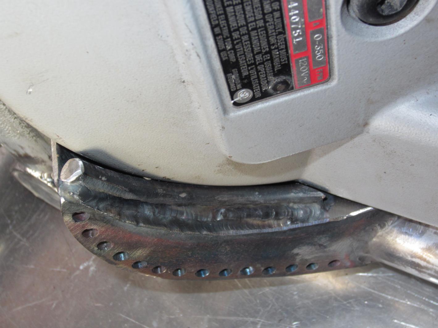

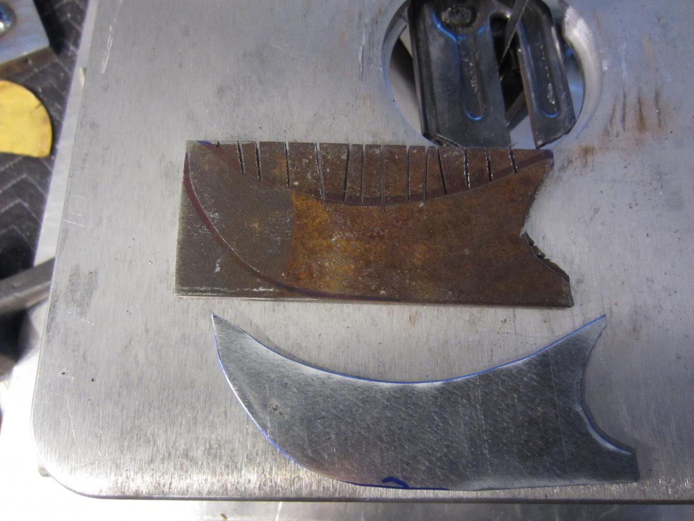

    I was able to find a few more pics of fit up, and developing the needed patterns from sheet metal for mock up.

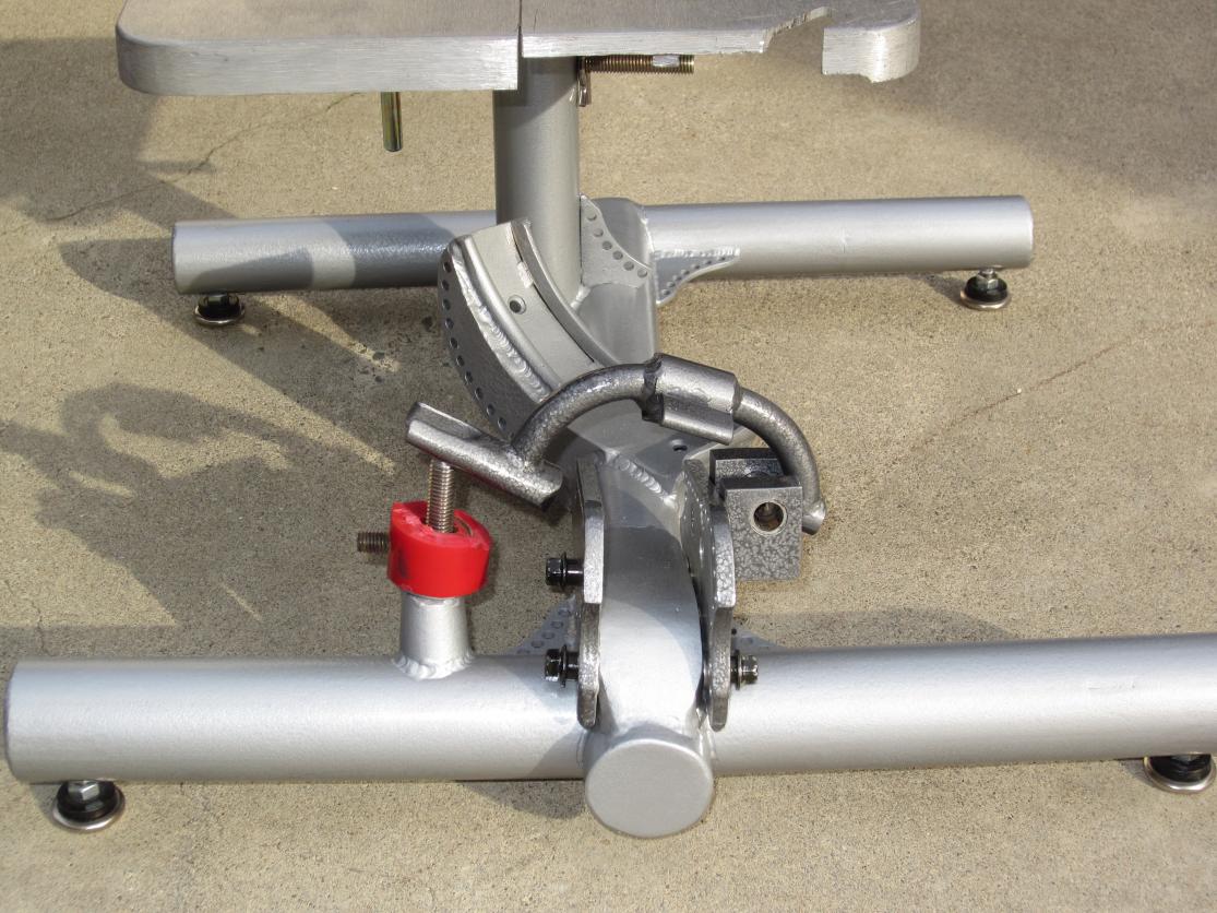

    As you can see, the stand breaks down easily so the saw could be used freehand...But it probably won't once I get the stand painted and everything put together! The stand's dimensions allow me to fit this stand (with the band saw attached) into my job box at the end of the day without trouble. I forgot to show a pic of the plug that fills the hole in the jig saw table. It's just a simple piece of 1/4" aluminum.
    The best part of this project was the fact I used the saw and stand while I build the stand! The better part is that as of now I am DONE with it, and done posting pics and typing about it for now! My cold cough syrup has me seeing cross-eyed and blurring right now!

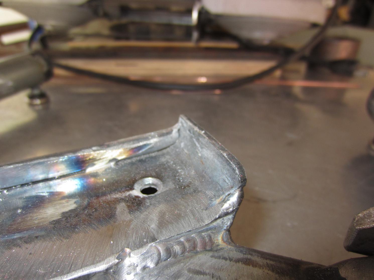

    Trust me, it took me a million years to figure out that design! I started off by noting that the saw would stand on it's own (assuming the surface was completely flat), so I thought I'd just bend up some material to support it that would connect to the conduit. I actually forgot about the saw standing up (on it's own) for half a day, and it was still standing when I came back.
    Anyways, the main base is 2" wide 1/8" flat bar that has a flange bent up on the back, and I have 5/16" steel rod welded on both sides to act as guides so the saw "drops into place." The rod didn't show up well in the pics though.

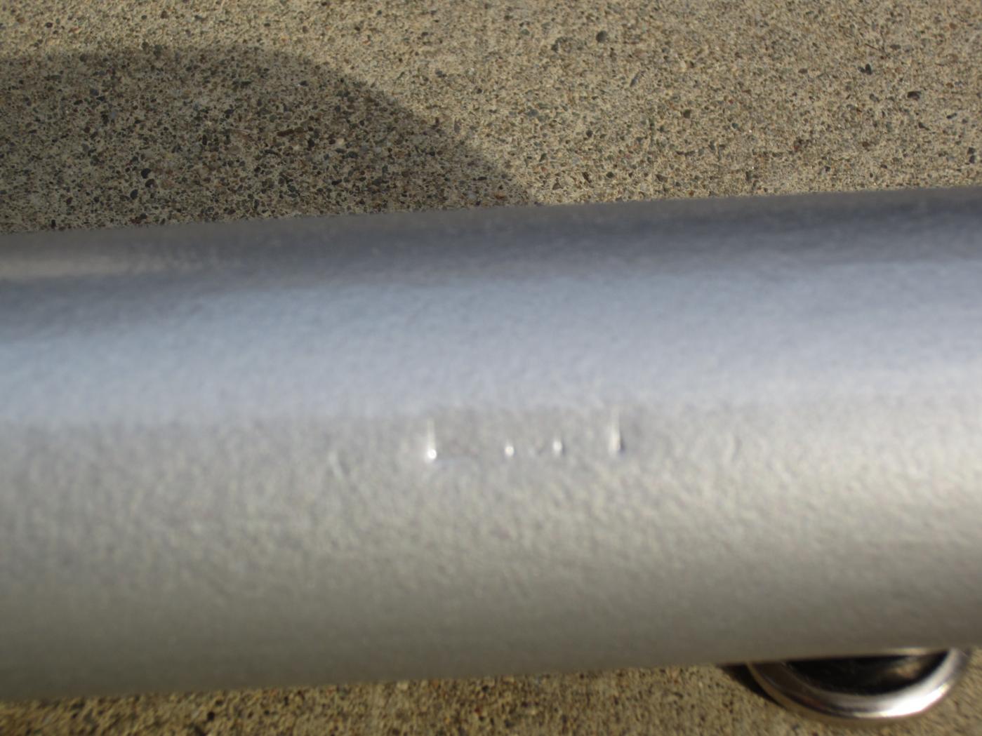

    So I managed to get the band saw stand sanded and painted yesterday, but it was still too wet last night to handle. It turned out okay considering I ran low on spray paint. For some reason I have like 20 cans of spray paint that are only 1/2-1/4 full, yet I won't throw them out (they're still good, right?)! I was planning on the textured silver showing up better, but the 2 coats I sprayed on were pretty thin in order to get everything covered evenly (and still make my stamped initials show up...The letters "EMT" are not my real initials, BTW!).
    I found a brand new aftermarket urethane shift coupler for one of my VW projects and decided that it would work well as a stop on my saw stand. Had to coax it to the right shape using my flap disc (which is now contaminated heavily with chunks of red urethane-go figure!).
