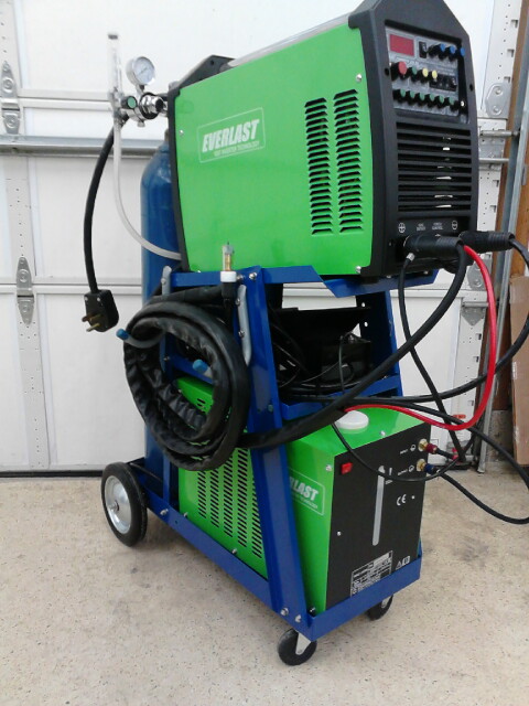

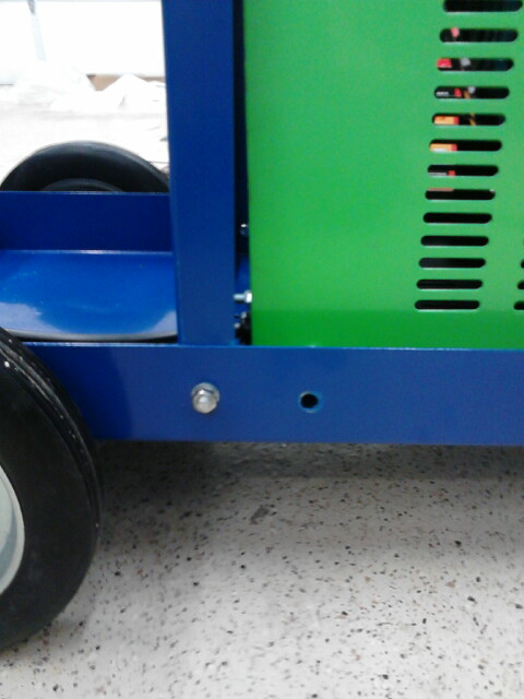

    I purchased a Harbor Freight welding cart the other day. Needed one for the new tig welder. I was not sure it would work but with a coupon it was only $25.00 dollars. It was well worth the money as it worked very well with some light modifications. You have to drill a few holes to make it work. The one photo shows the holes moved back one inch to allow the cooler to fit on the bottom shelf. Also had to cut out the back for the air that is exiting the water cooler. I also attached two hangers from Home Depot to hold the torch. I used both brackets that came with the cart on the other side to hold the ground clamp. Also had to drill new holes at the front of the middle shelf to make that work. The only thing I need to finish would be a 5 foot velcro strap for the Tig machine to keep it on the cart just in case.

    Very nice looking setup...Colors look good together ...lol. looks like they where made for one another.
    That cart is one of the best deals going...especially with the coupon. I have 2 of them. One for my plasma cutter and one one for the tig machine.

    I had no idea that you could get anything in blue at HF. That cart doesn't appear to be overly stout, but it looks like it's handling your Tig and water cooler just fine. How does it roll with all that weight on it?
    Here's a picture of one of my carts with the better wheels on it. That's my DIY tig torch water cooler on it. Works like a charm.

    It also came with a free screw driver set. Gave that to the wife to tighten up all the handles that keep comming loose in the kitchen.
    The cart rolls fine on my floor. I would not roll it outside alot. If ou use your welder everyday this my not be for you. But for a home owner this is the best deal you can get.
