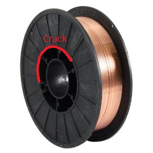

    Ok I hope this makes since. I have an I-MIG 200 and lately I've been having issues with the wire spool binding on the shaft that it turns on. It still turns and welds fine but it makes this terrible noise like a tupperware burp (farting). I'm using a 10 pound spool of wire. I put a little oil on it with my finger and it stopped for about a day but now it's doing it again. Am I the only one having this issue? I don't like how the spool rides on the washer rather than the shaft. Is there some sort of adapter I could get to increase the size of the shaft hahaha? No but really. I hope you get what I'm talking about. I'm sure this binding will eventually cause a problem with the wire feed motor so I want to take care of the problem ASAP.

    Remove the wire from the machine and check the plastic spool for cracks at the edge of the hub. If it's cracked the wire can pull down into the side of the spool as it rotates causing it to bind. Click image for larger version.

    I'll check the spool again for damage later today when I get home. The binding is on the outer edge where the spool comes in contact with the outside washer. That's where I put the oil and the noise stopped for the day. I like the adapter option allot. I don't like the current design. I'd rather have the welder not accept the smaller spools of wire (I have no need for them) than to keep this current setup. I might be alone in the thought though. The wing nut isn't too tight. If I loosen the wing nut the spool won't sit properly.

    Yea, check for burrs on the spool too. Do you have any wax? Candles? You can see if they helps. Be careful with any sprays, or take it off, spray and put back on so nothing gets on the wire. Make sure no cracks like mentioned (check on the inside too, could be there).
    They do get bounced around in shipping and 10-12lbs all on top of each other. Also make sure the end of the wire is not sticking out and making the noise.

    So here is an update. I didn't change a thing just let the spool of wire run out and swapped put in a new spool. No more noise. I think it may have had something to do with old sticker gunk on the spool. I went with a MUCH CHEAPER MIG wire from www.usaweld.com this time and love it. Two spools for the price I was paying for one Hobart spool.
