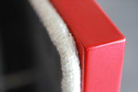

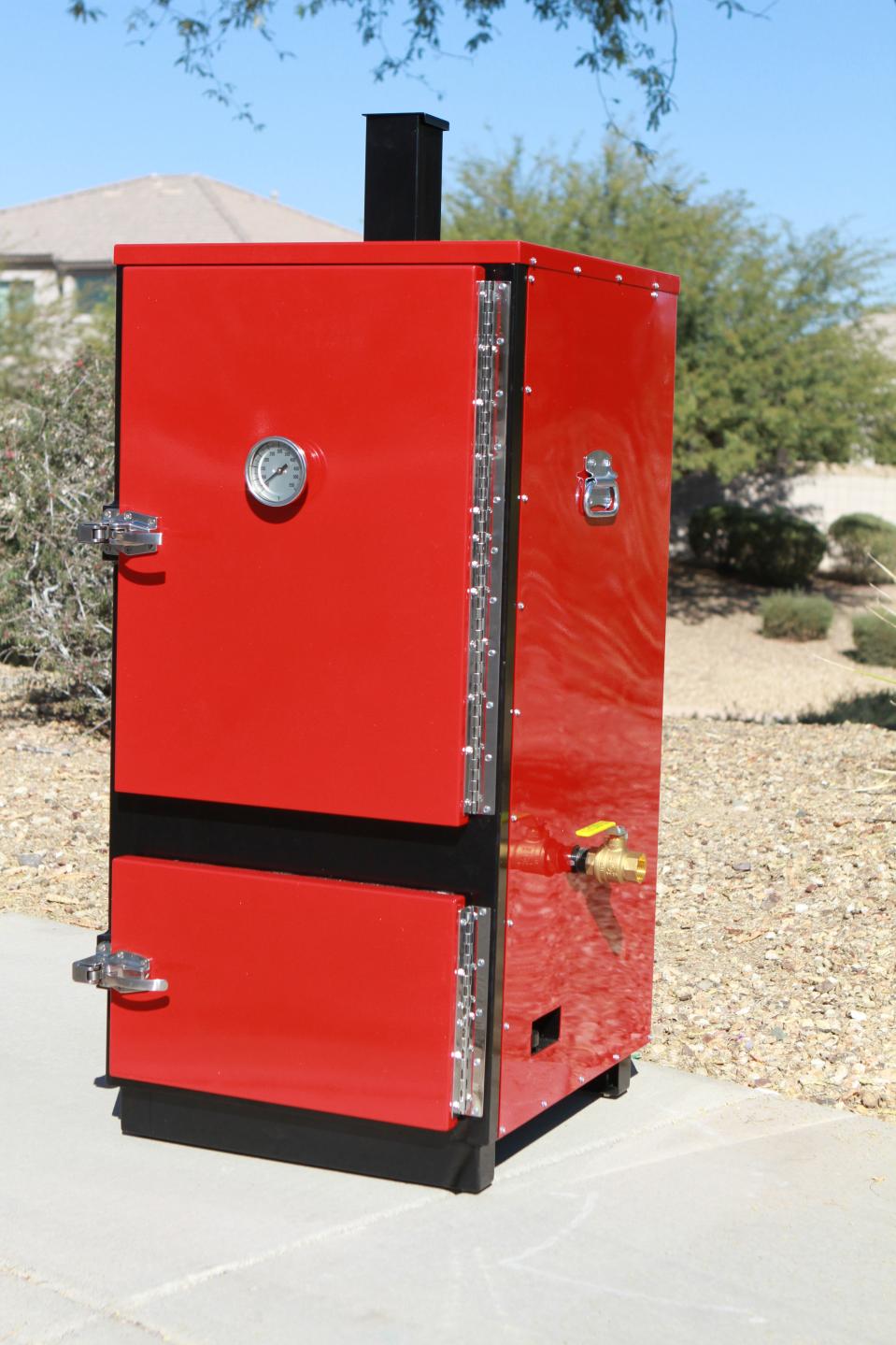

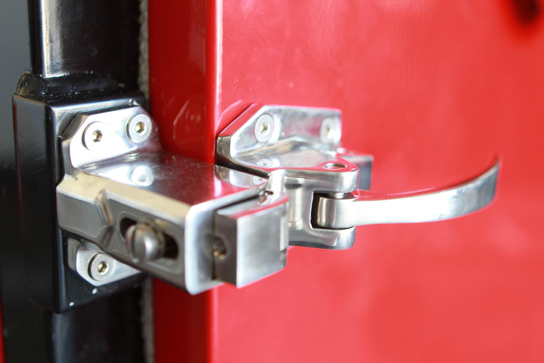

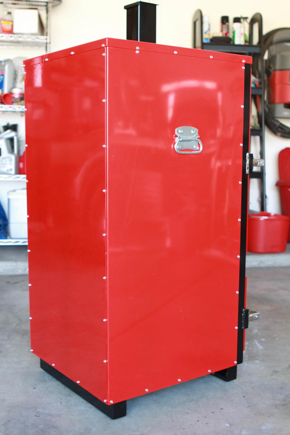

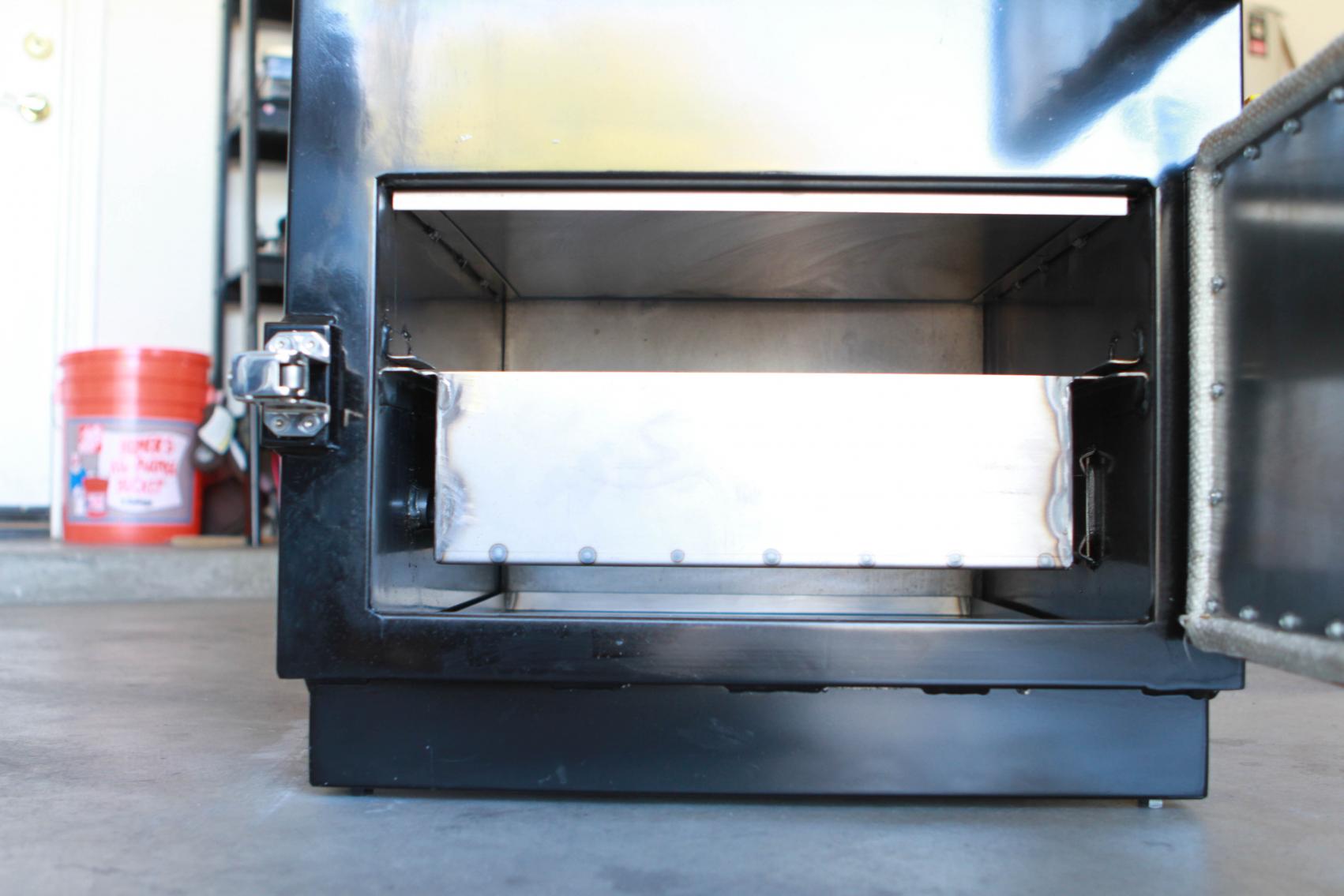

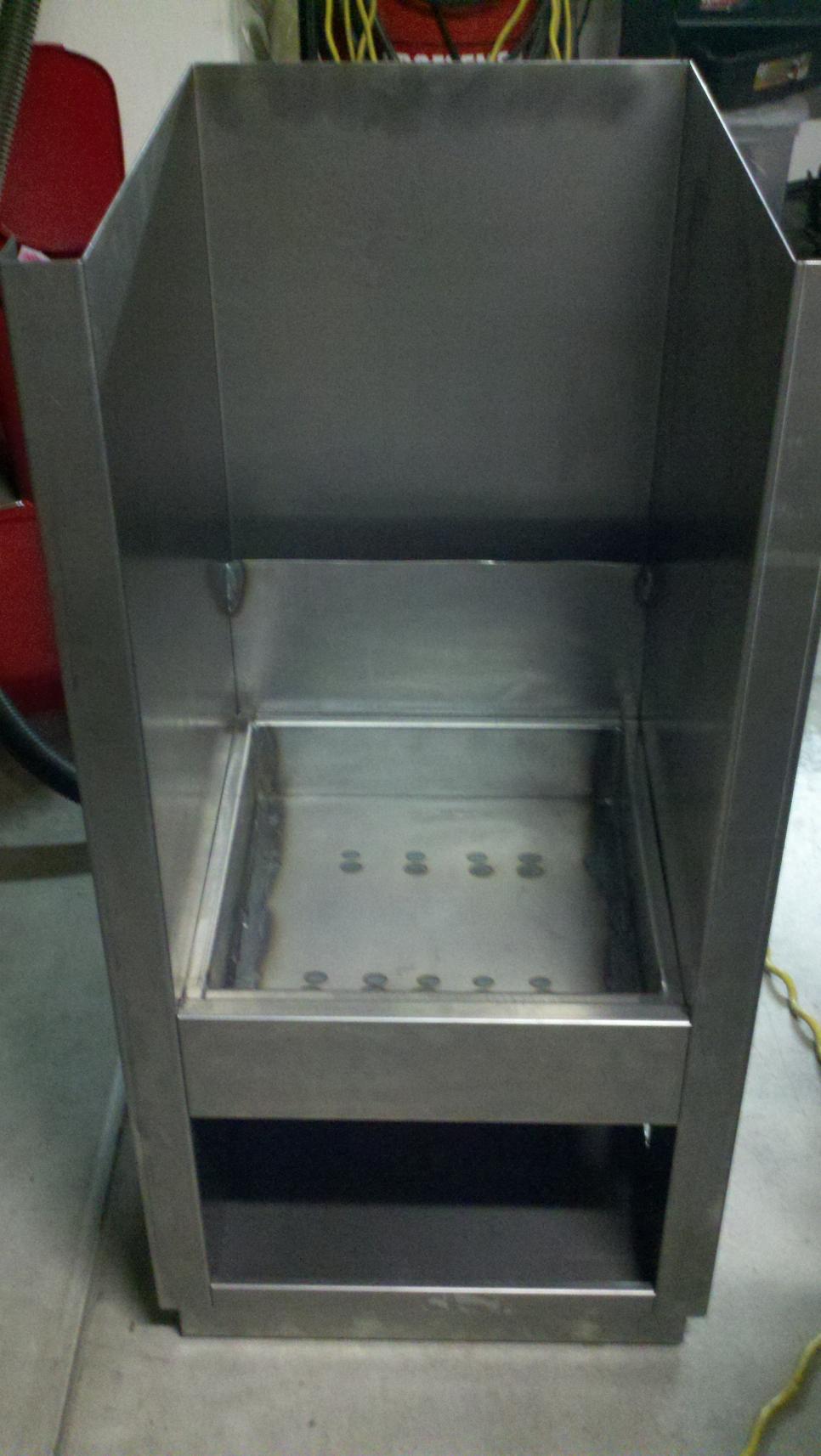

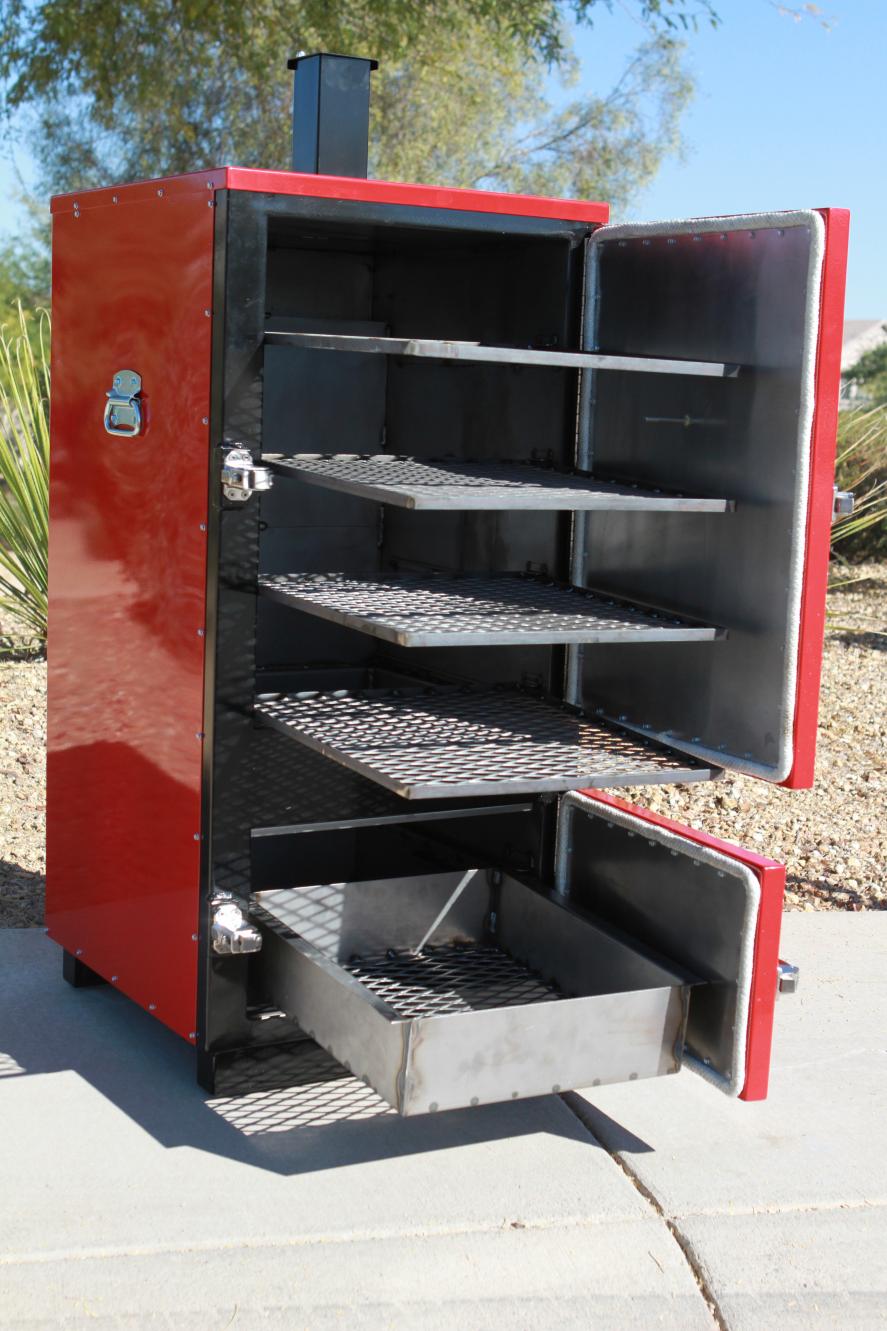

    This is my third major BBQ project that I have finished. I have a new air flow design where the fire is under the cook box as the other two BBQs I have fabricated. Between the fire box and the cook chamber is a heat deflector and a 4 gallon water pan that is 4 inches deep. The heat comes up the back false wall and then exhaust is on the sides starting about 5 inches above the water pan on both sides of the cook chamber. The outside of the BBQ is insulated with two inches of insulation and covered with powder coated sheet metal on the outside. I have stainless steel push to close latches, so opening the doors is very easy with no flimsy latches to fuss with.

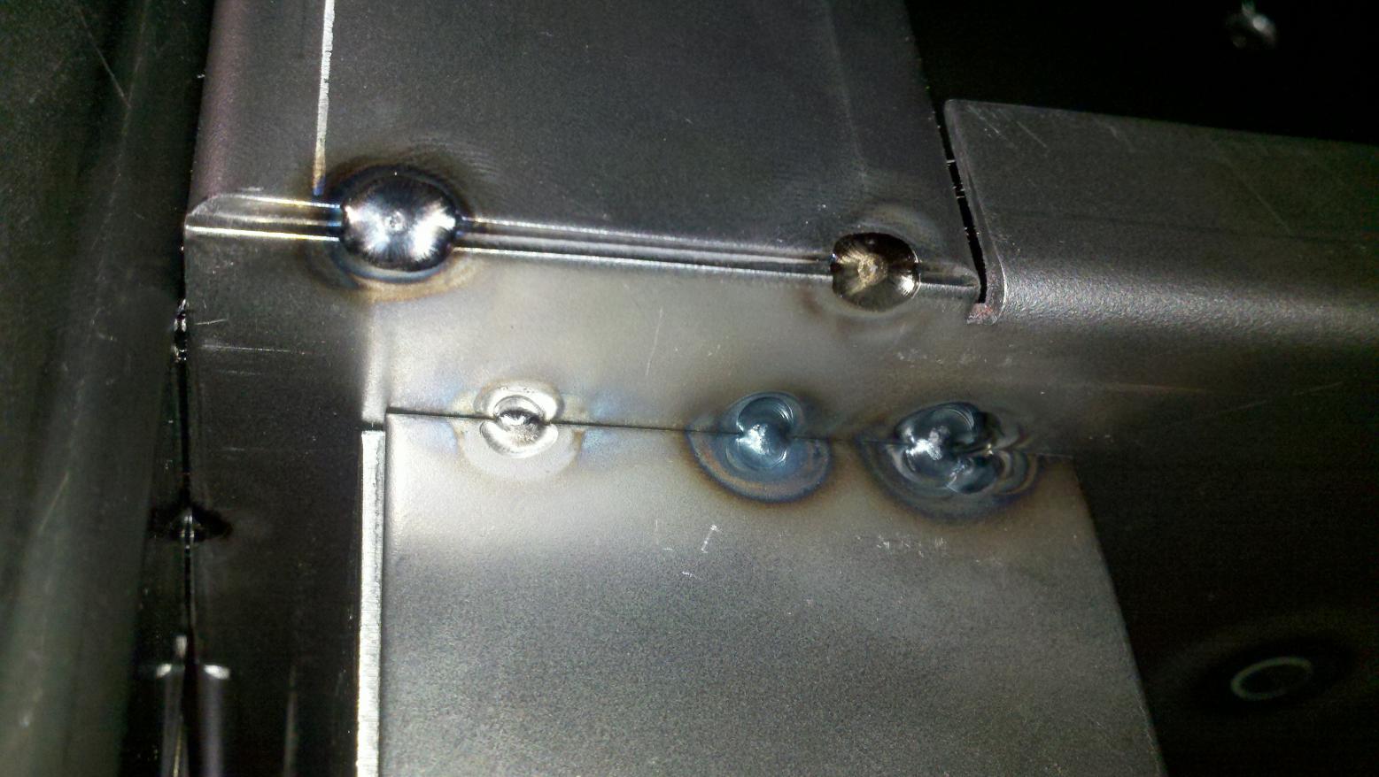

ID:	9521Metal fabrication was 12 gage for the water pan, 14 gage for the main part of the cook chamber, and 18 gage for the doors and sheet metal. I used the 250 EXT to tack up the project and then most welding was with my Miller 252.

    I outsourced the metal bending and I assembled everything and made a few custom components. The total project was about 750 each, but I had 3 cut out and had to make some major modifications to two because the first did not have the best results due to the air flow path.

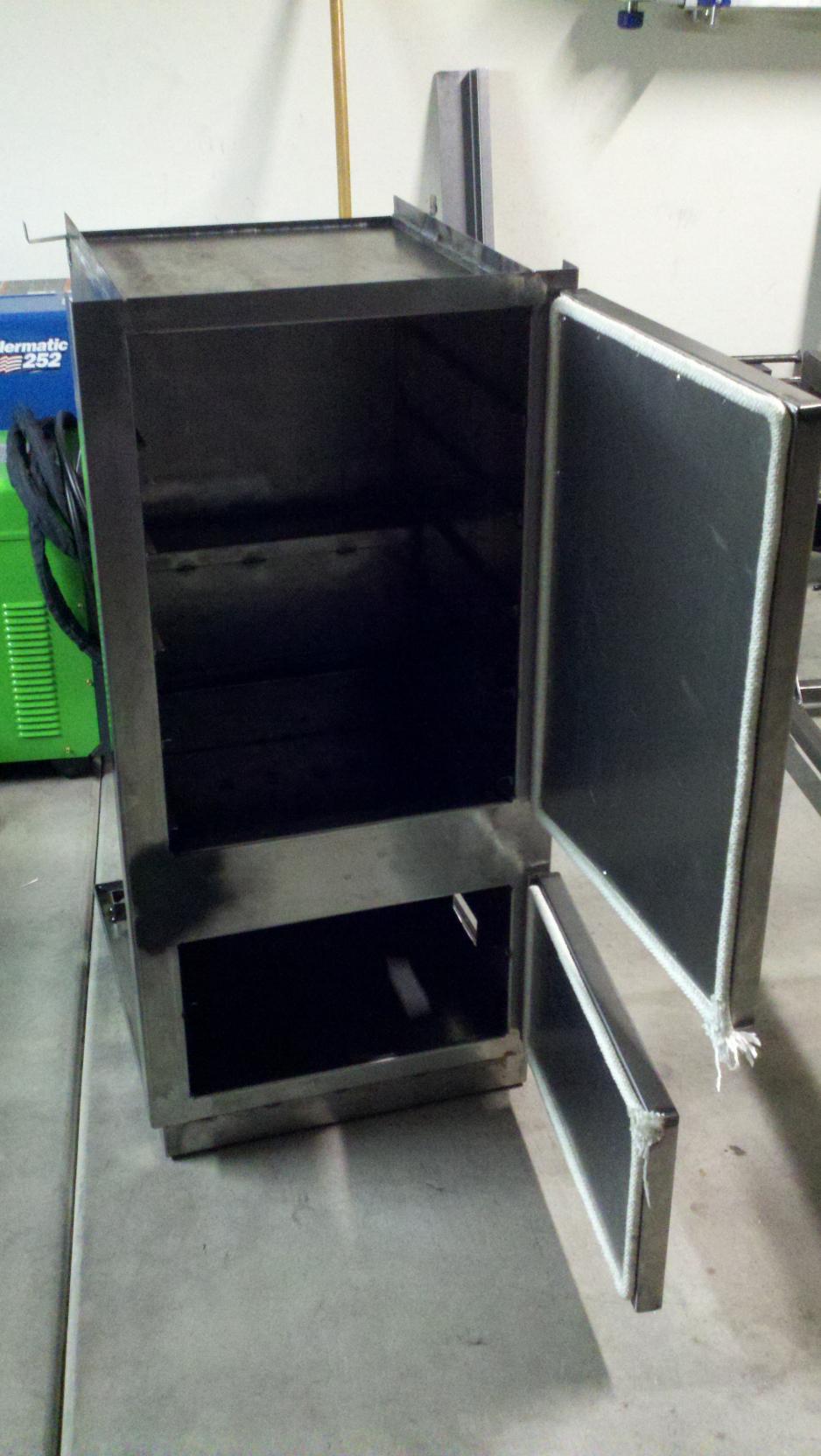

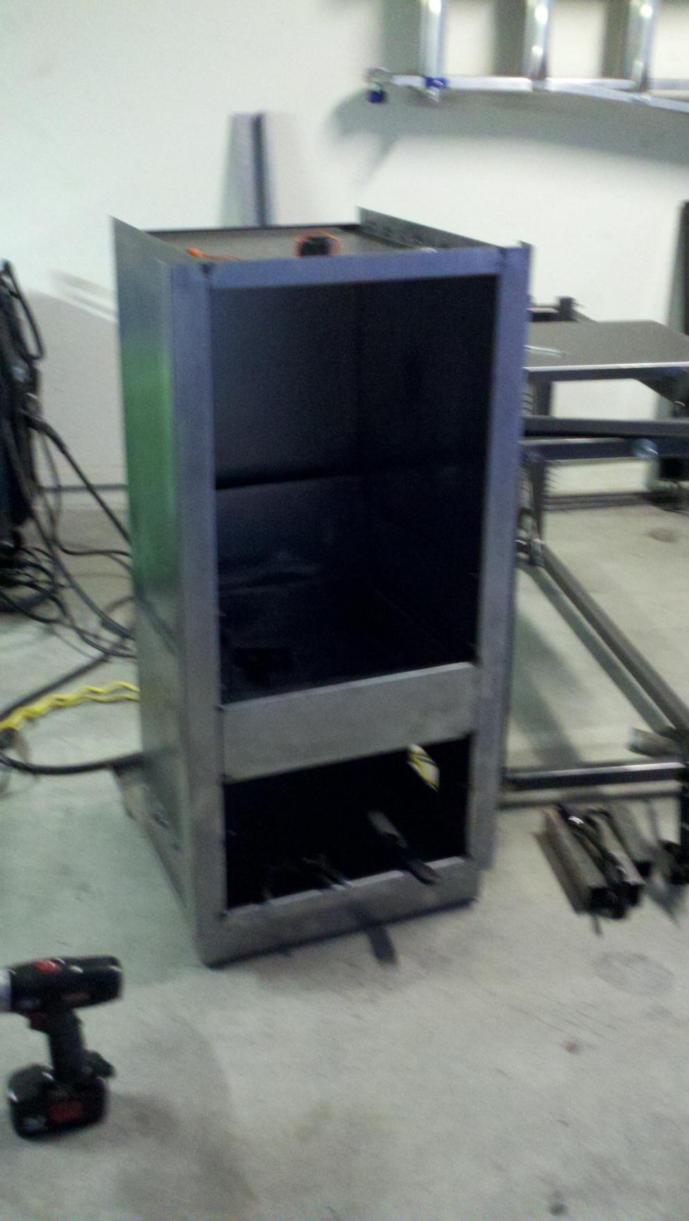

    It does look store bought but better. I would love to see some of the fab pics. How long did it take to put together?
    The total build time is about 40-50 hrs but I am getting better and should be able to do it in about 20 hrs with some changes I will make to the next few.
    Attached are some pictures of the build:

    $750 is the build cost, they are for sale for $1750, and leading brands that are not even close to the quality are sale for $2000+.

    I would love to build one of these. What gauge metal if the body?
