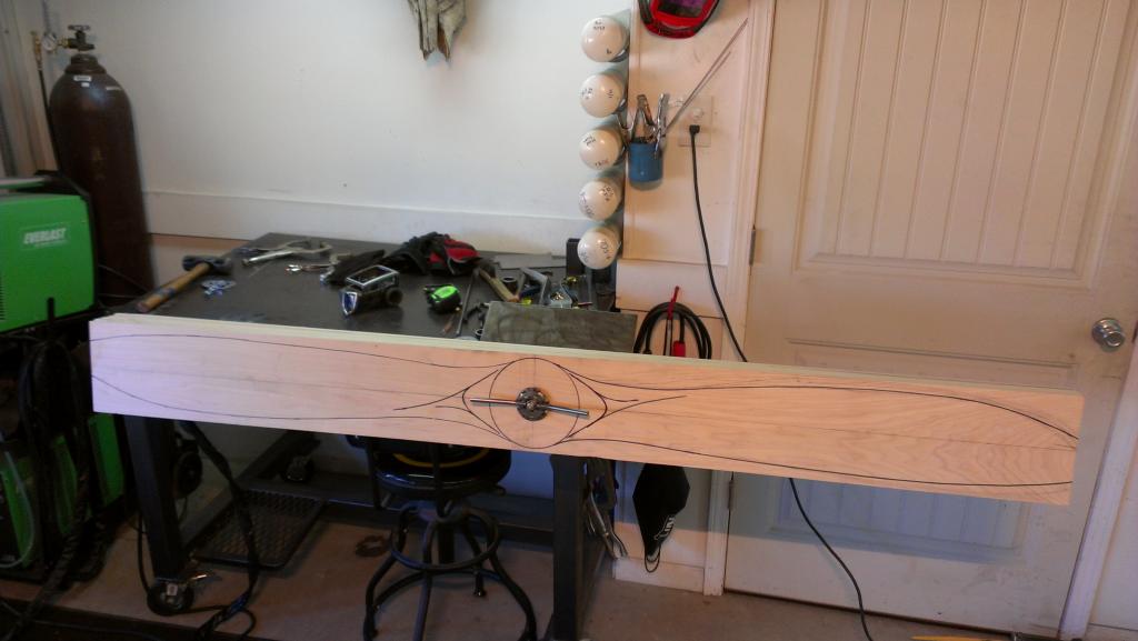

    I wanted a wood propeller but didn't want to pay for one so I decided to build one myself.
    I started out with 5 pieces of 1x8 @ 6' long and glued and clamped them overnight.

    Then I drew out the propeller on the wood and put it on the mount to cut the bulk of the wood off to get the shape.
    I used a sawzall with a 12" blade to cut the rough shape.
