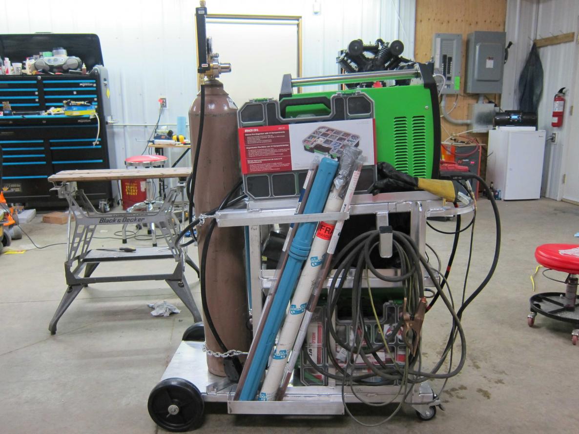

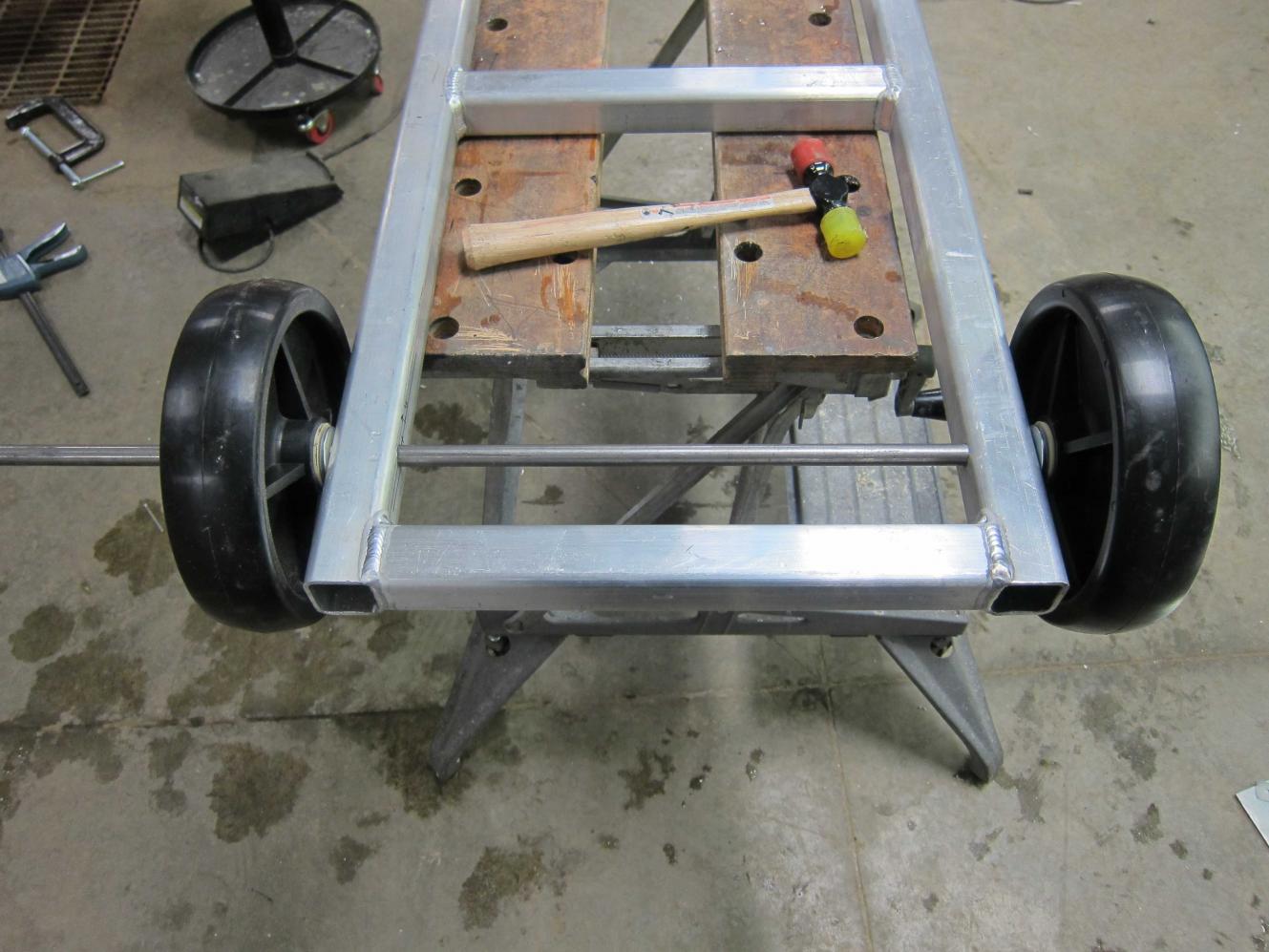

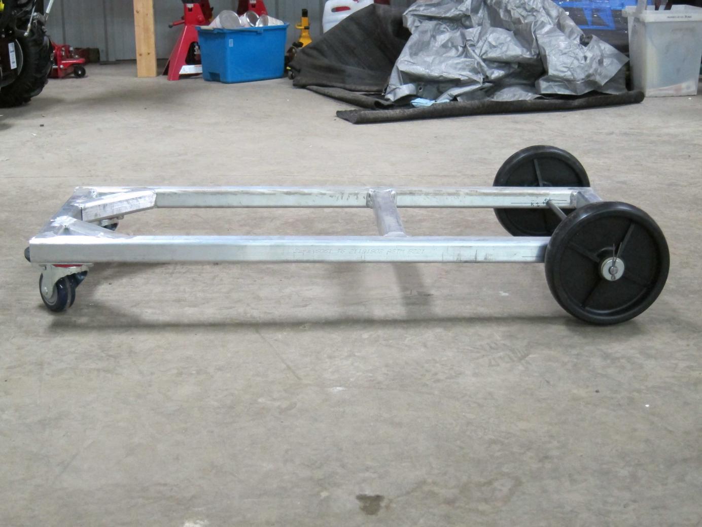

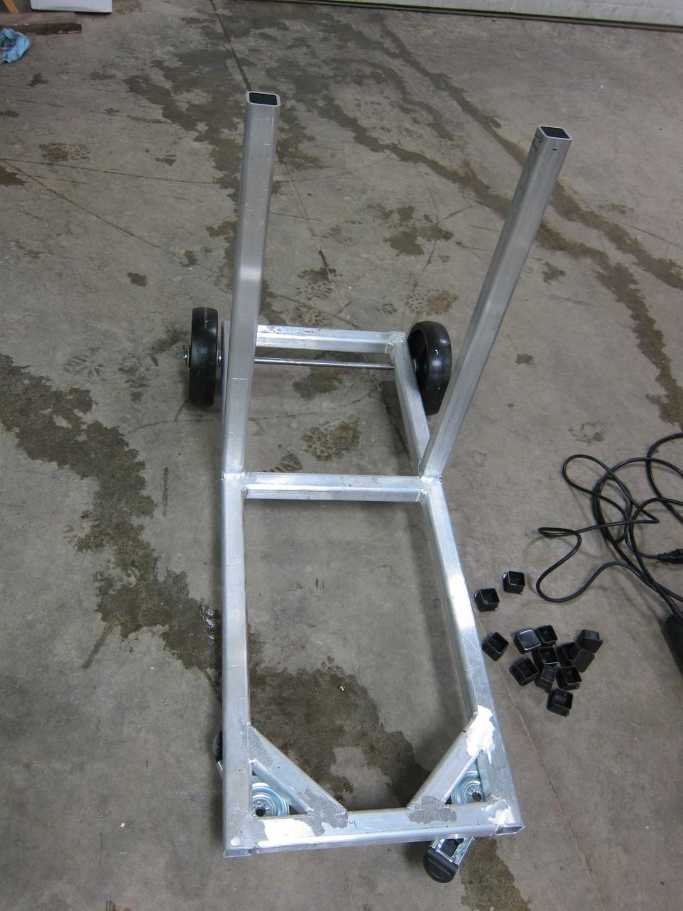

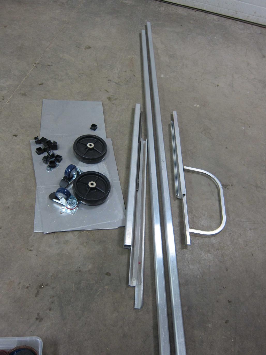

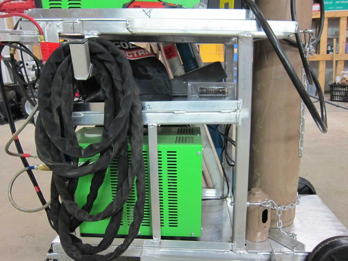

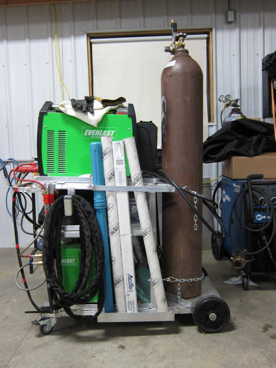

    Bought my first house and it came with a 30'x60' shop so time to make a welding cart for my 250EX and not have to worry about making it too compact. During my Xmas vist to the parents in another province I managed to get some "scrap" aluminum from my father, mainly 3/16" sheet & 1" angle. He had a Pro-Tools bender and made me a handle.
    So off to Casterland for the wheels.The rear is 8" with bearings and the casters lock the wheel as well as position.
    I wanted the basic cart design, but one solid and made from aluminum using 1-1/2" sq tube x 1/8" wall. 1/2" axle shaft.
    I wanted the cart wide enough to add tool compartments for extra nozzles etc., so I went about 16" wide.

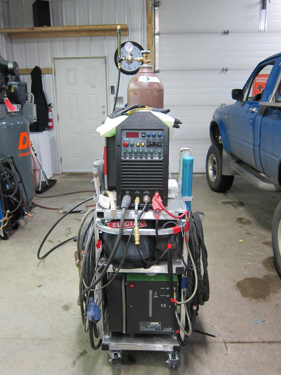

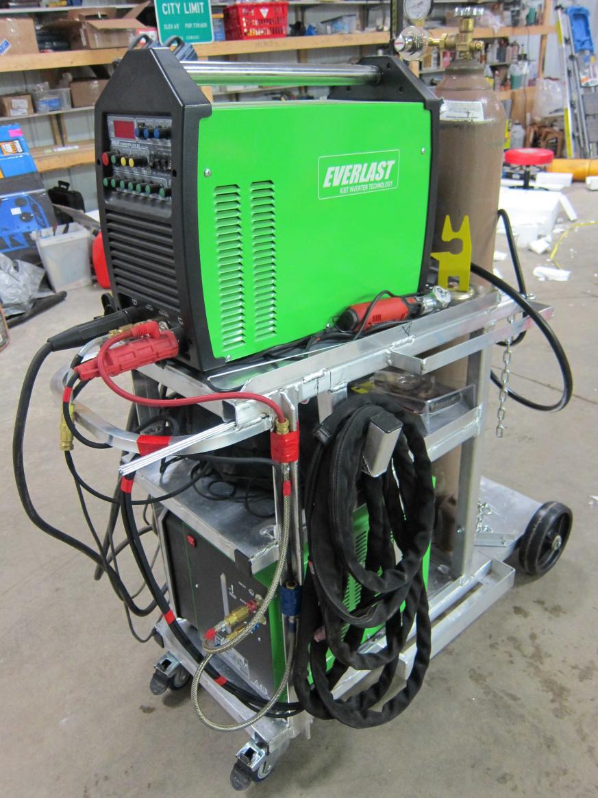

    I didn't take enough pics during the actual construction so here is the finished cart. I left to top tubes open to store some rods which I like handy when welding.
    The middle level is large enough for a pedal and helmet.Click image for larger version.

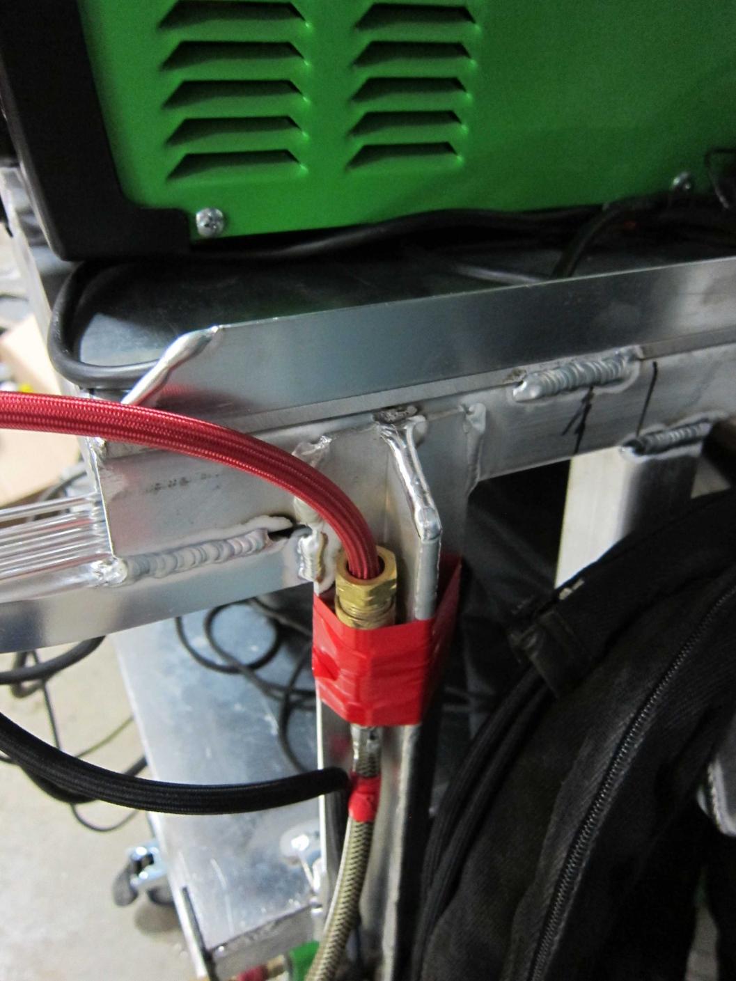

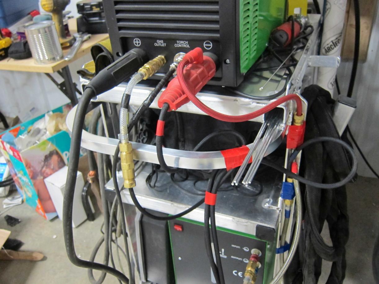

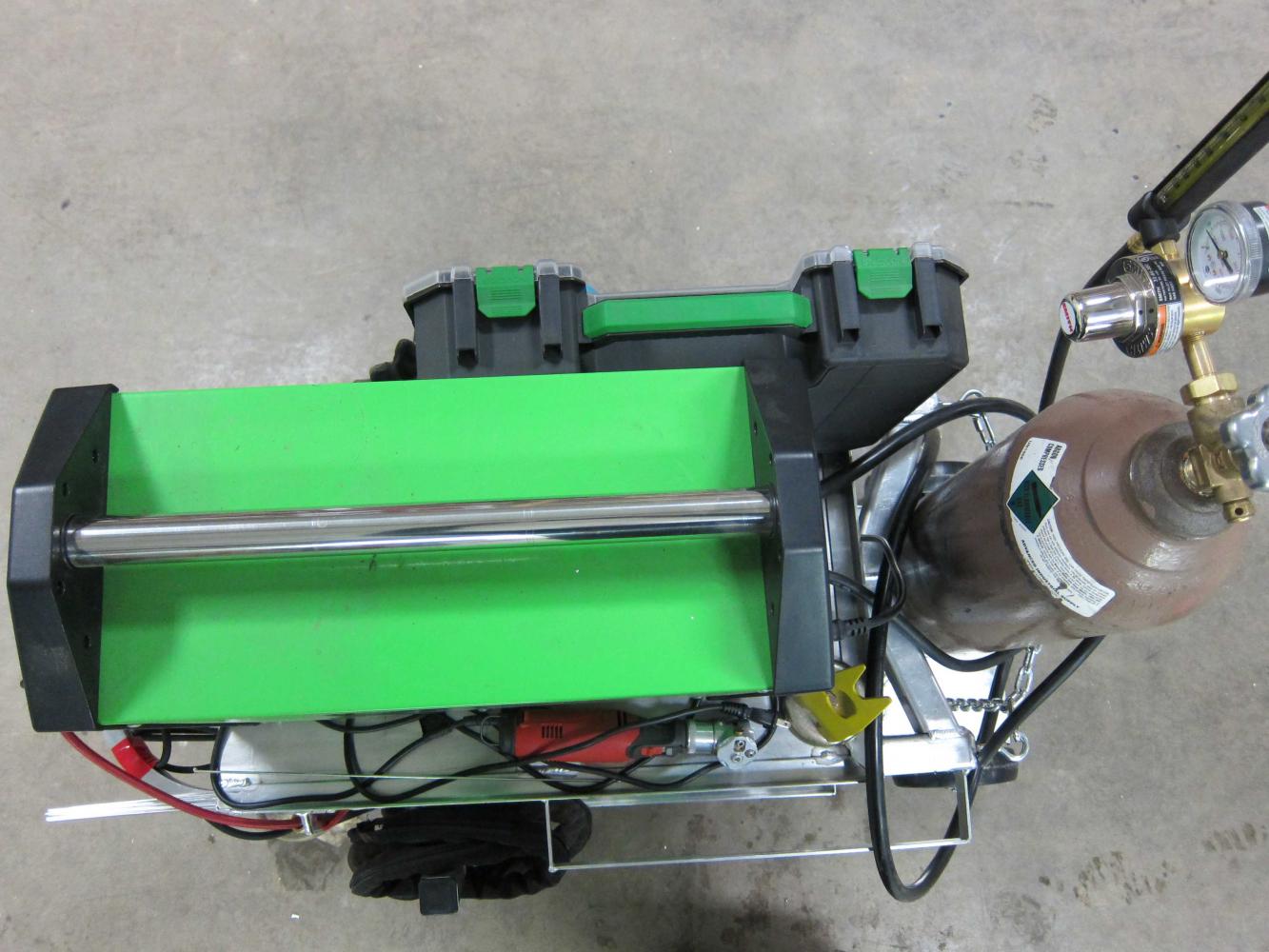

    I melted the sharp edges of the angle so they were smooth for the hoses.
    I cleaned the hoses up and using tape.Click image for larger version.

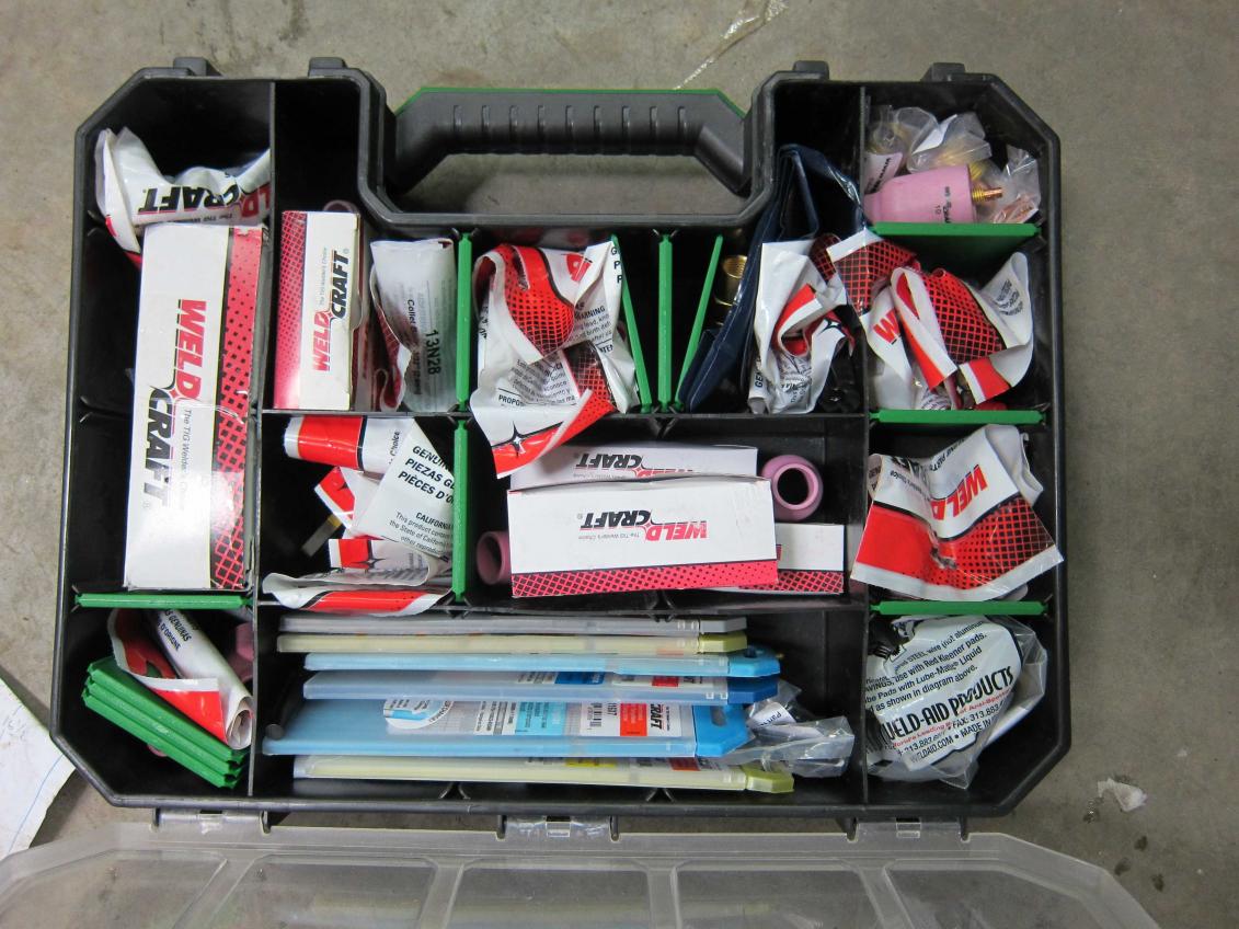

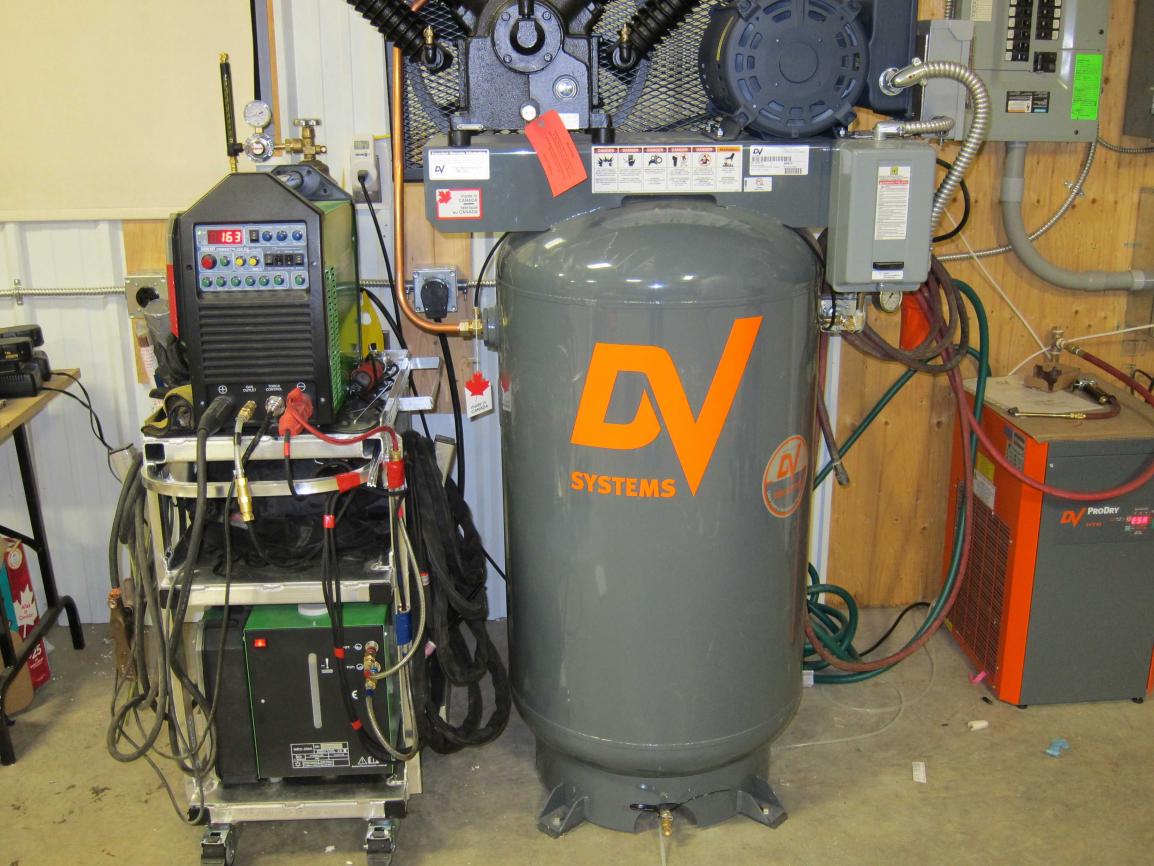

    There's seriously a store named Casterland? Simple ... no nonsense ... to the point ... I like it! Kind like "Tipsy's" for a liquor store or "Rug Emporium" for ... well ... it's pretty obvious, I suppose.

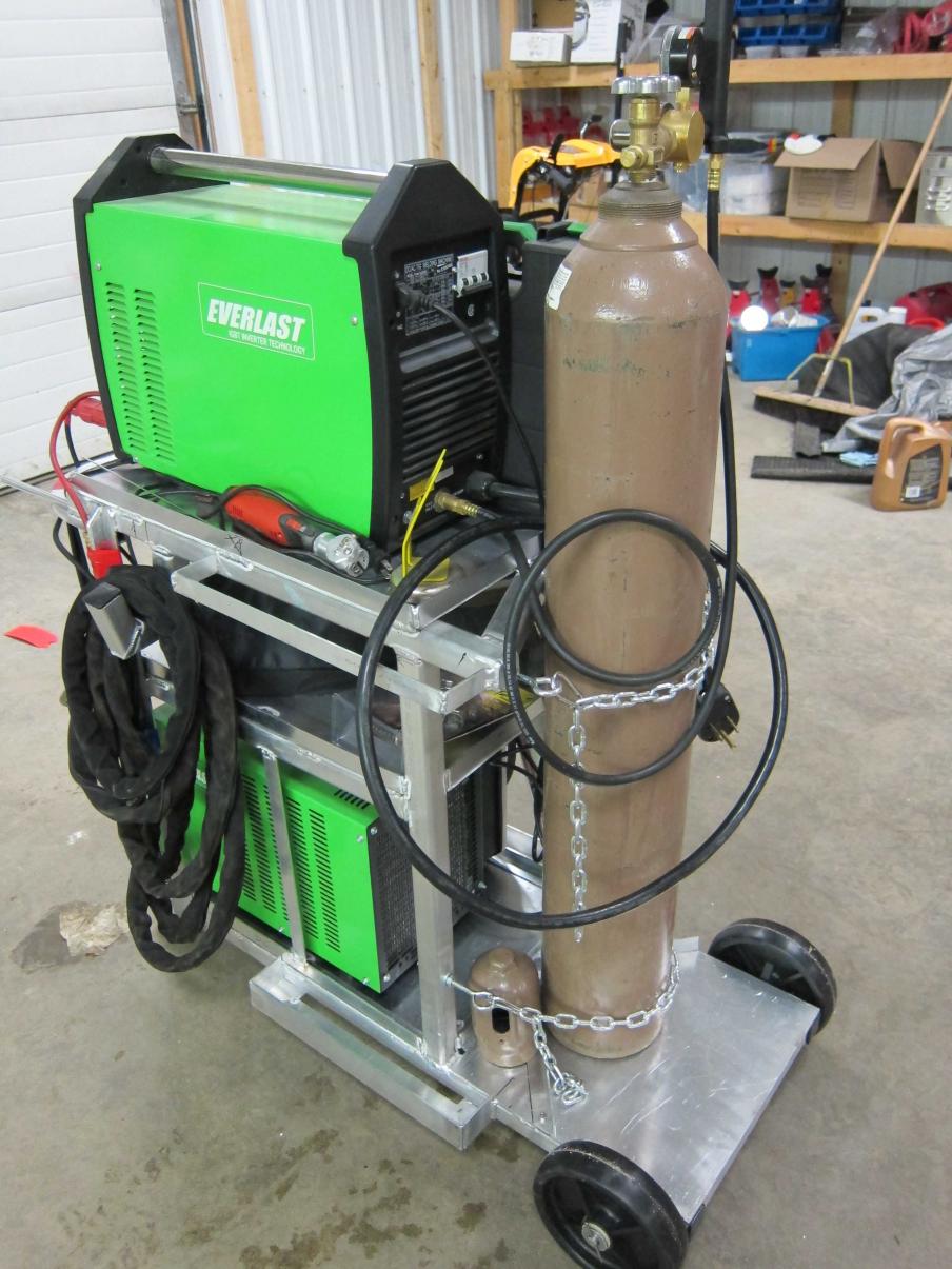

    Looks really nice. You said you're about 16" wide - how about front to back? 32" or so?
    And where did you find those small-parts bins with the green latches? I've seen them with yellow latches (Dewalt-branded), but never with green. The green is appropriate, given the branding of hardware sitting on the cart

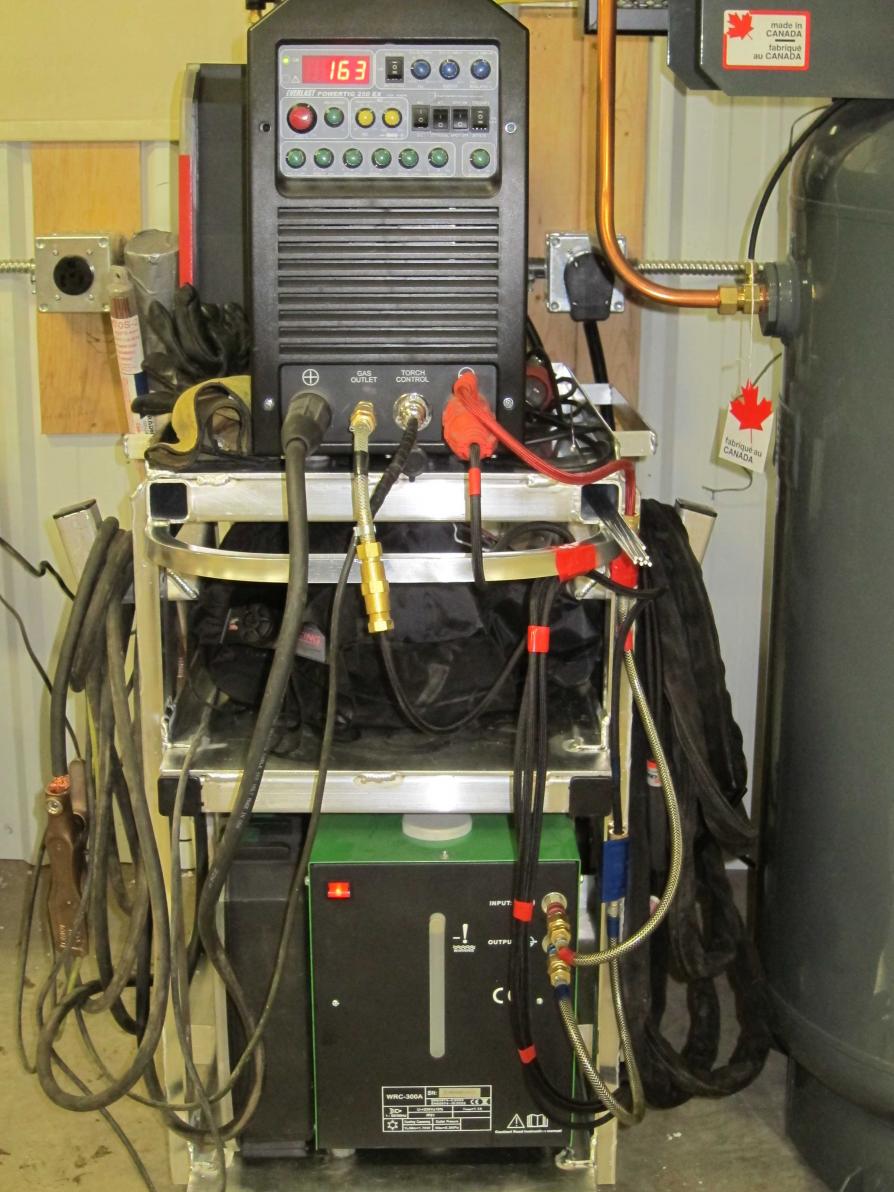

    It's new home beside the 7.5 HP compressor.Click image for larger version.
    This local Casterland store is cool and they sell the plastic end caps for the sq tube to boot
    http://www.casterland.com/
    The plastic boxes are from these guys
    http://www.stack-on.com/categories/s...s/products/180
    I got them from my favourite local tool store, http://www.kmstools.com/ that puts them sale everyone and then. They have Millermatic 252 going on sale for $2200 and 30A spool gun for $1000, which is decent pricing for Canada....I just might have to snag these this weekend.
    The top two shelves are 25" long. I'm glad I made them longer because I forgot about the Everlast put the gas conection near the center back..would have been better to place it on the side to avoid the tank.
    The bottom shelf is 40" long which is probably 5-8" longer than required but I cut this from an end sheet my father had laying around and did not have the cooler or welder handing to size it uo so added a little to make sure.

    I especially like the hook on the side that allows you to hang your TIG torch and leads out of the way! Don't worry about not taking enough pics, I find myself in the same boat after finishing a project. You get caught up in working and forget to pull the camera out to snap shots of your progress during the build! I can't wait to get an A/C capable welder after seeing everyone weld up all these fancy aluminum projects! I miss welding aluminum!

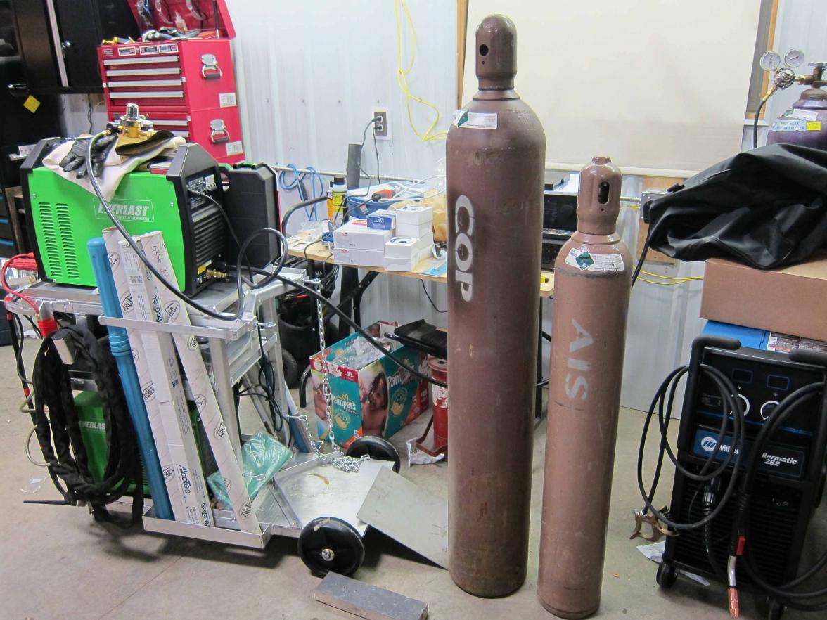

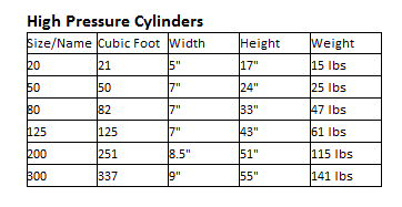

Name:	Cyl sizes.png

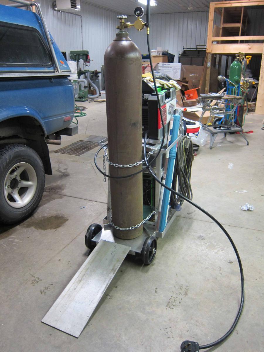

ID:	9855Well when I made the cart I planned for a possible larger tank in the future, but thought I would never get one until I got a killer deal on tanks when I bought my Millermatic 252 a few weeks ago and decided to get some tanks they gave me what they called #300 tanks for $200Cdn (Ar & C25 fills were $98ea, & O2 fill was $38)
    I was told I could trade up my 125 cu ft for the difference in price which is about the same I paid for the 300's so it should just be the cost for fill. I got a Spectrum 625 Extreme on order with them Click image for larger version.

    All I can say is the these #300 tanks are heavy as hell. I needed a ramp to get it onto my DIY TIG cart. Have to make sure the #300 tanks get loaded into my truck with the valves pointed in first. Tempted to get a gantry crane in the shop for these bad boys.
    I see why the Millermatic 252 now has a low running tank rack.

    Those larger tanks are a total pain to move since they are so slippery and awkward, but you only have to move them once in a great while since they almost never run out of gas! That is one thing I miss about using the welder at my old job....they had one big 330CF cylinder on the welding cart, and 4 backup 330 cylinders in the cage! Endless supply for building home projects at work!
    Come to think of it, I saw a cool dolly with some sort of hydraulic ramp on it for moving the heavy cylinders by yourself and loading them into your welding cart (without using all those pesky swear words!). Someone built it and posted pics on one of the welding or hot rod forums. Wish I would have saved the pics I saw since it looked like a really good idea!
    We have two dollies and normally two people the handle the big tanks, well worth it when you see the price and duration on the gas. I still have two 150's for TIG, but might trade them up this year. Just like having a backup tanks like Andy mention.
