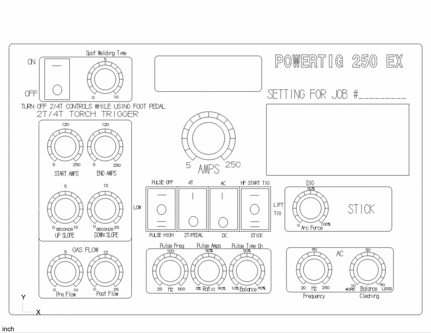

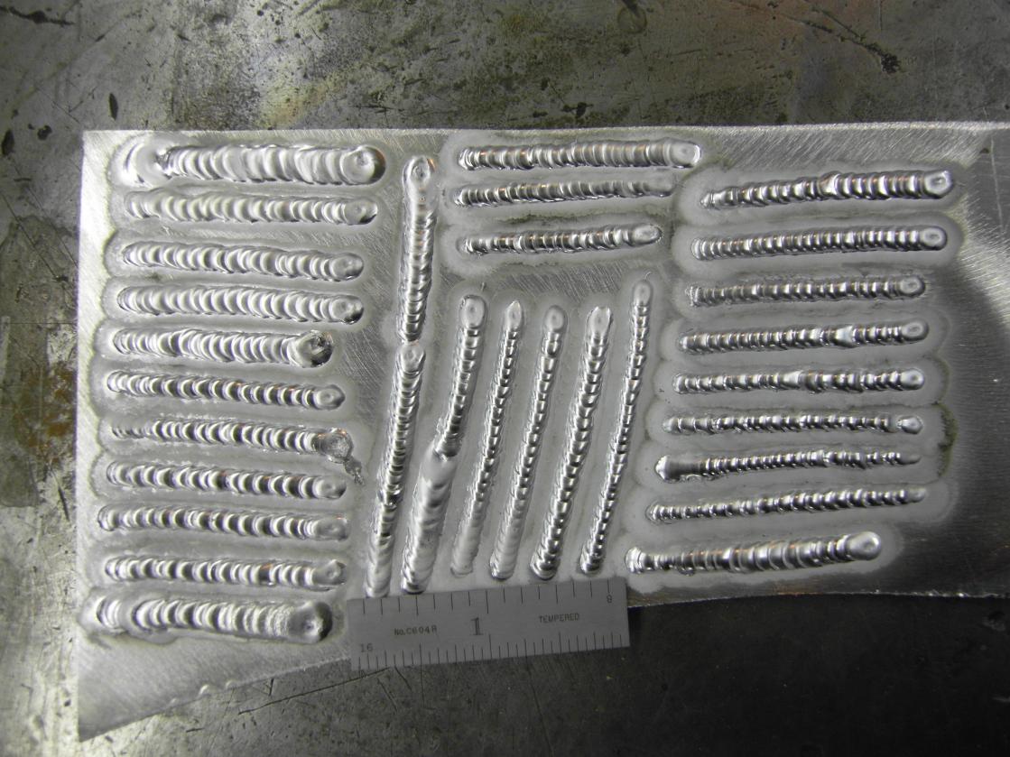

    Had some time to play with my the new 2013-250EX lots to learn over old Hobart 400 pound transformer type welder has done me well for 36 years. Made new panel note drawing to the 2013-250EX I got if someone need PDF file PM me and I will send it to you.

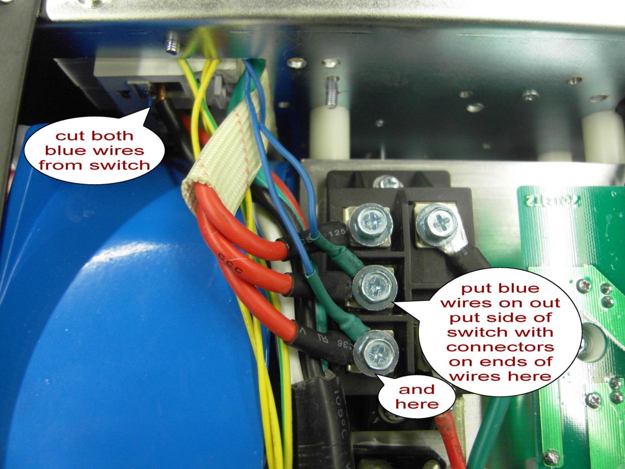

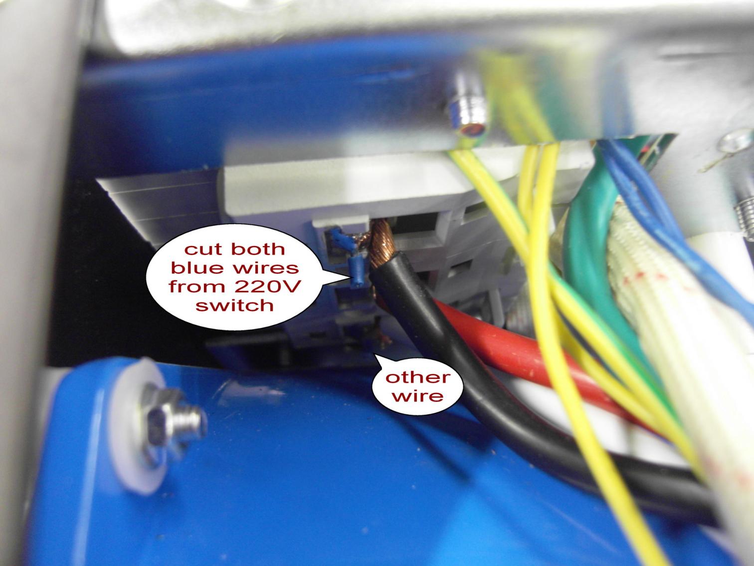

    Problem I have and would change on the 2013- 250EX the 220volt for the water cooler should be hooked up to the main switch to turn the 220 volt pump on when the welder is turned on. You turn off welder the pumps is still running you turn the pump off it is a problem for me the old weld turned off the pump turned off welder on pump on I will say no more.

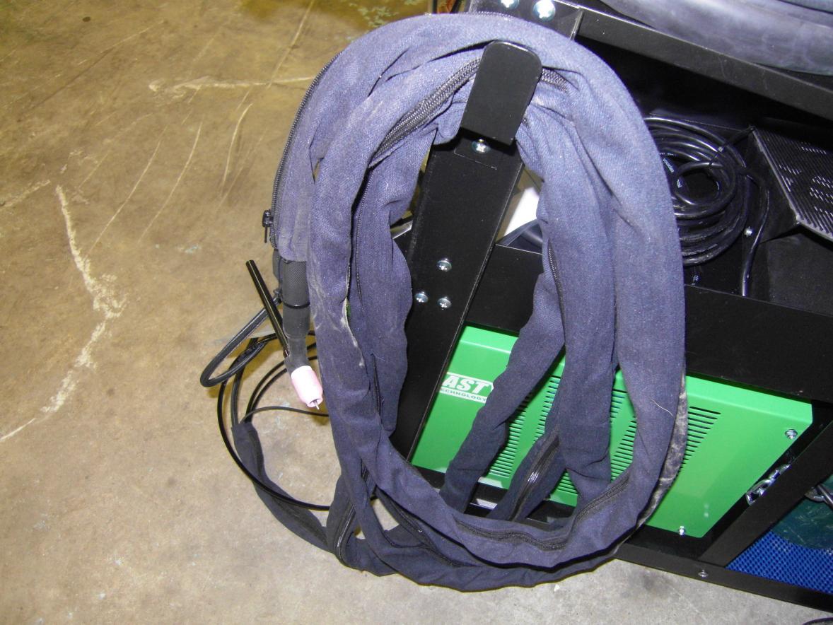

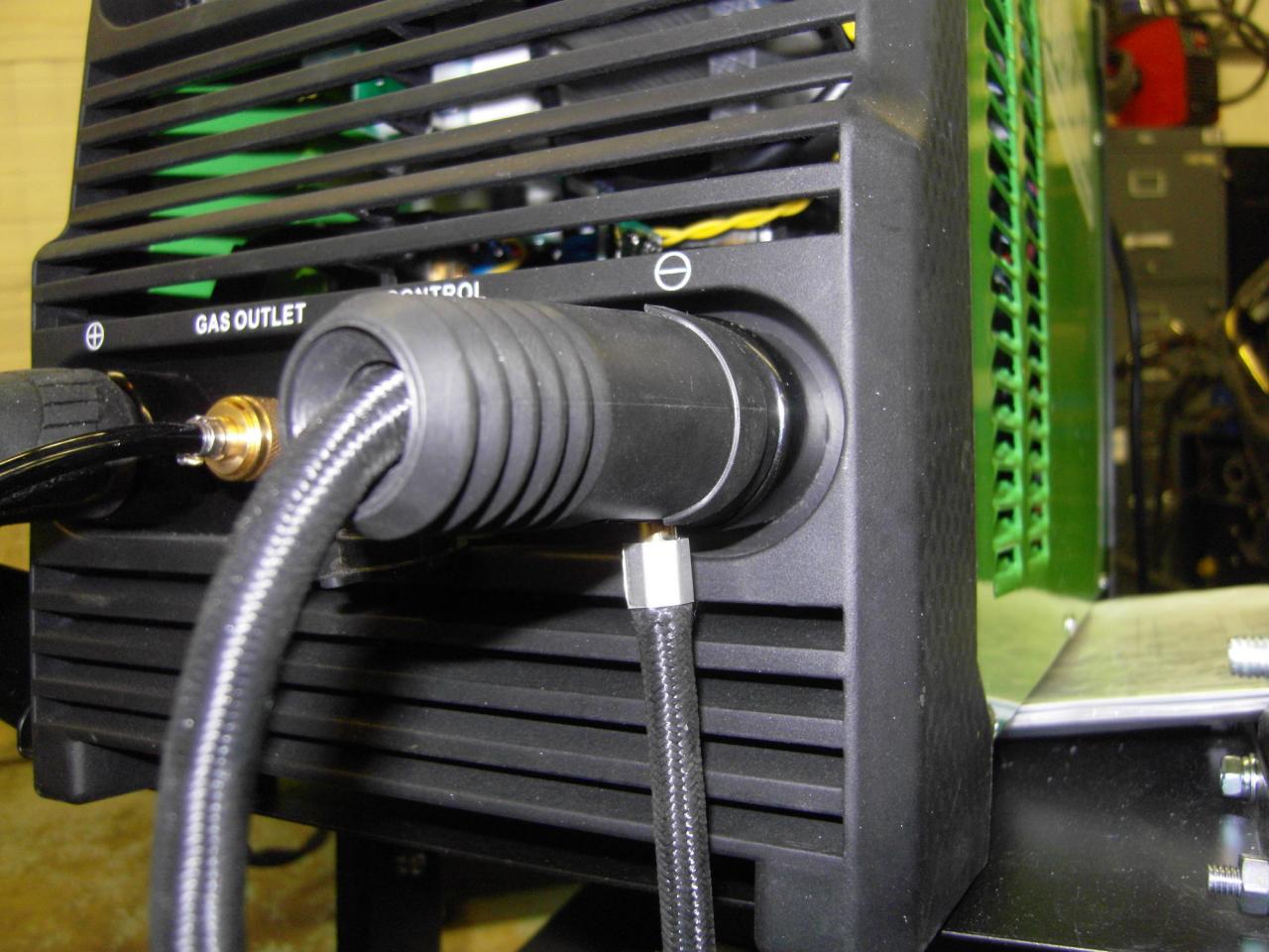

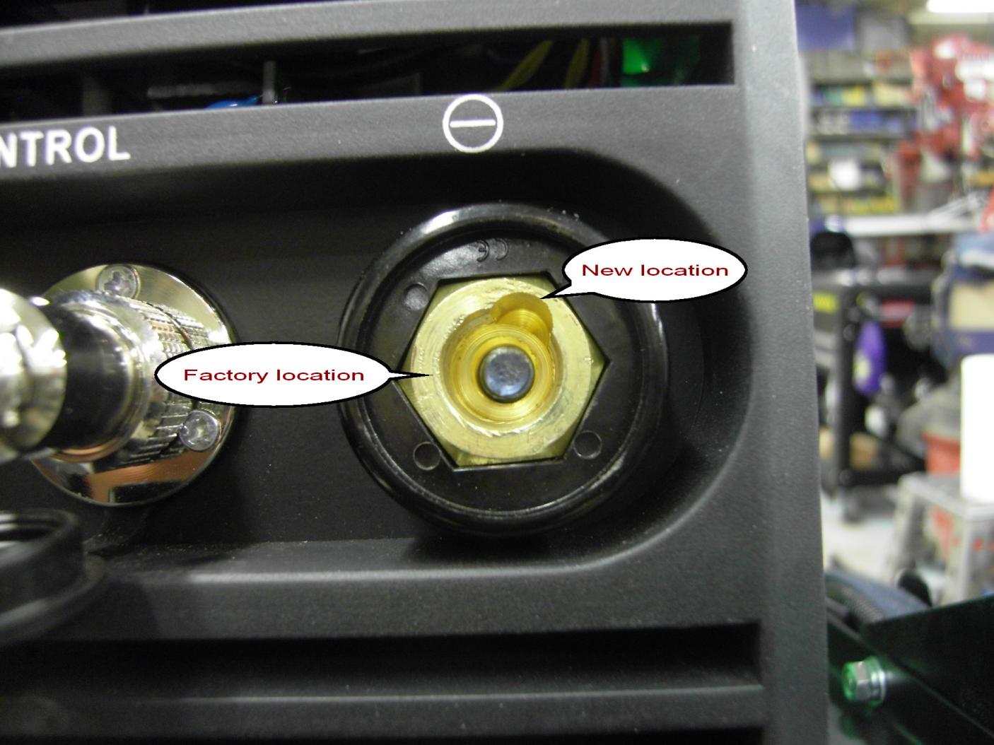

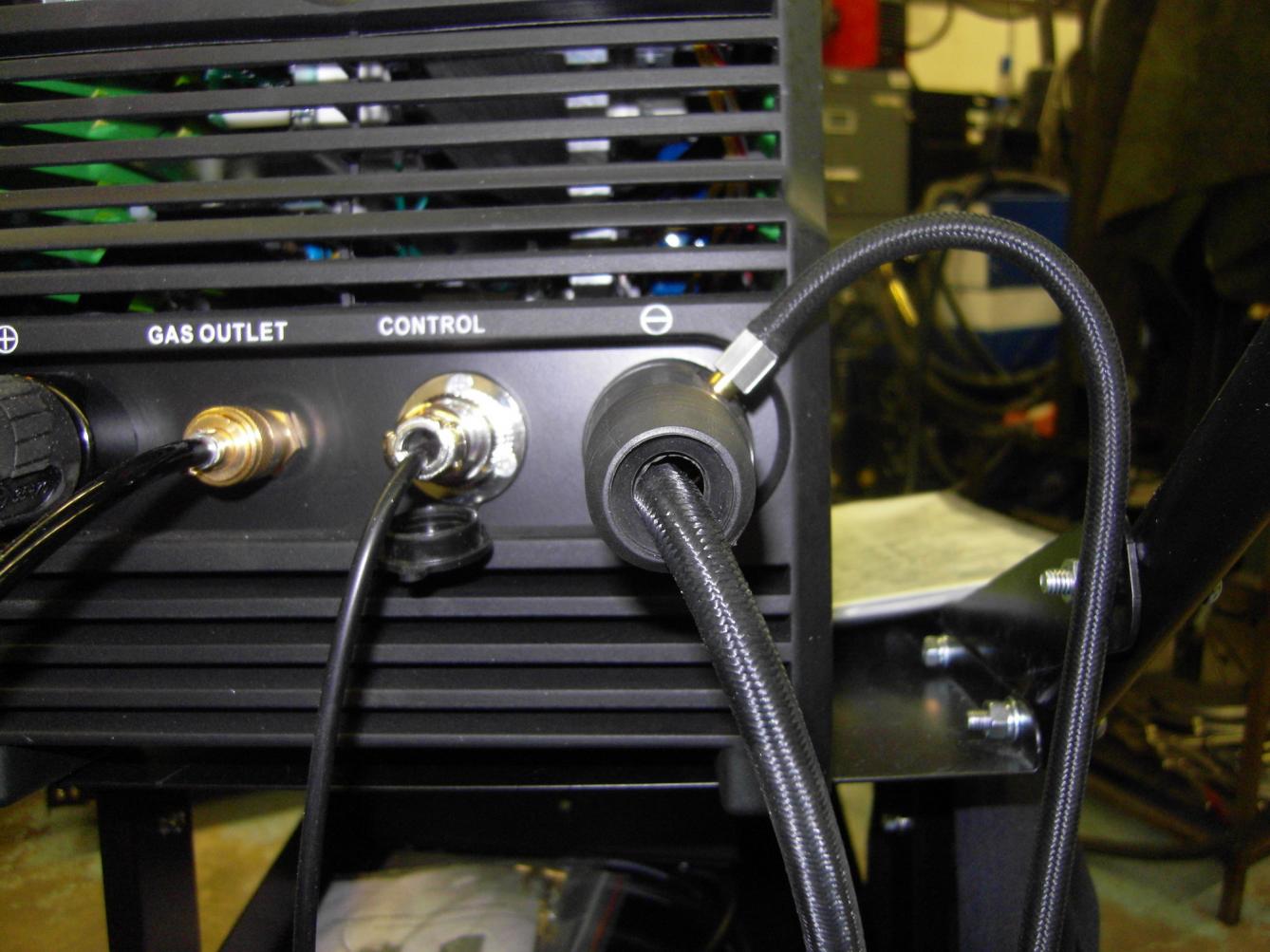

    Change number three the tig gun quick disconnect should be at 2 O’clock not at 9 O’clock that is the pin locking mechanism the hose to the water cooler pointing at 2 O’clock and has a sharp turn to get to the cooler so I change mine to have the hose at 9 O’clock down see Pics.

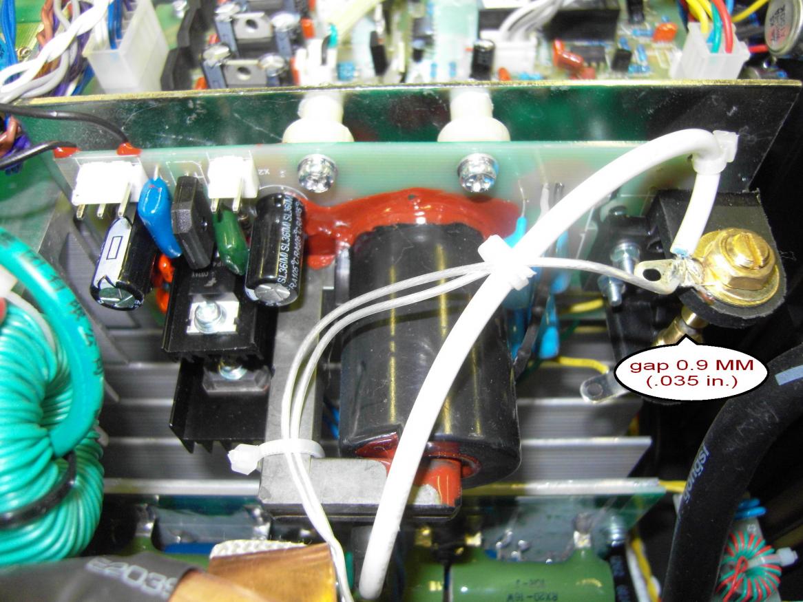

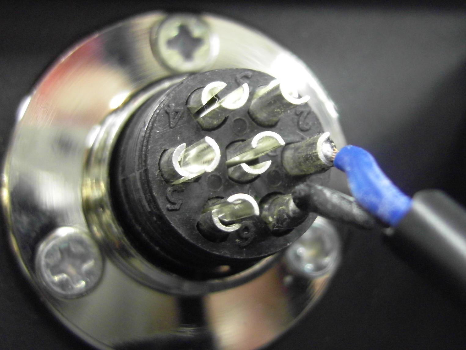

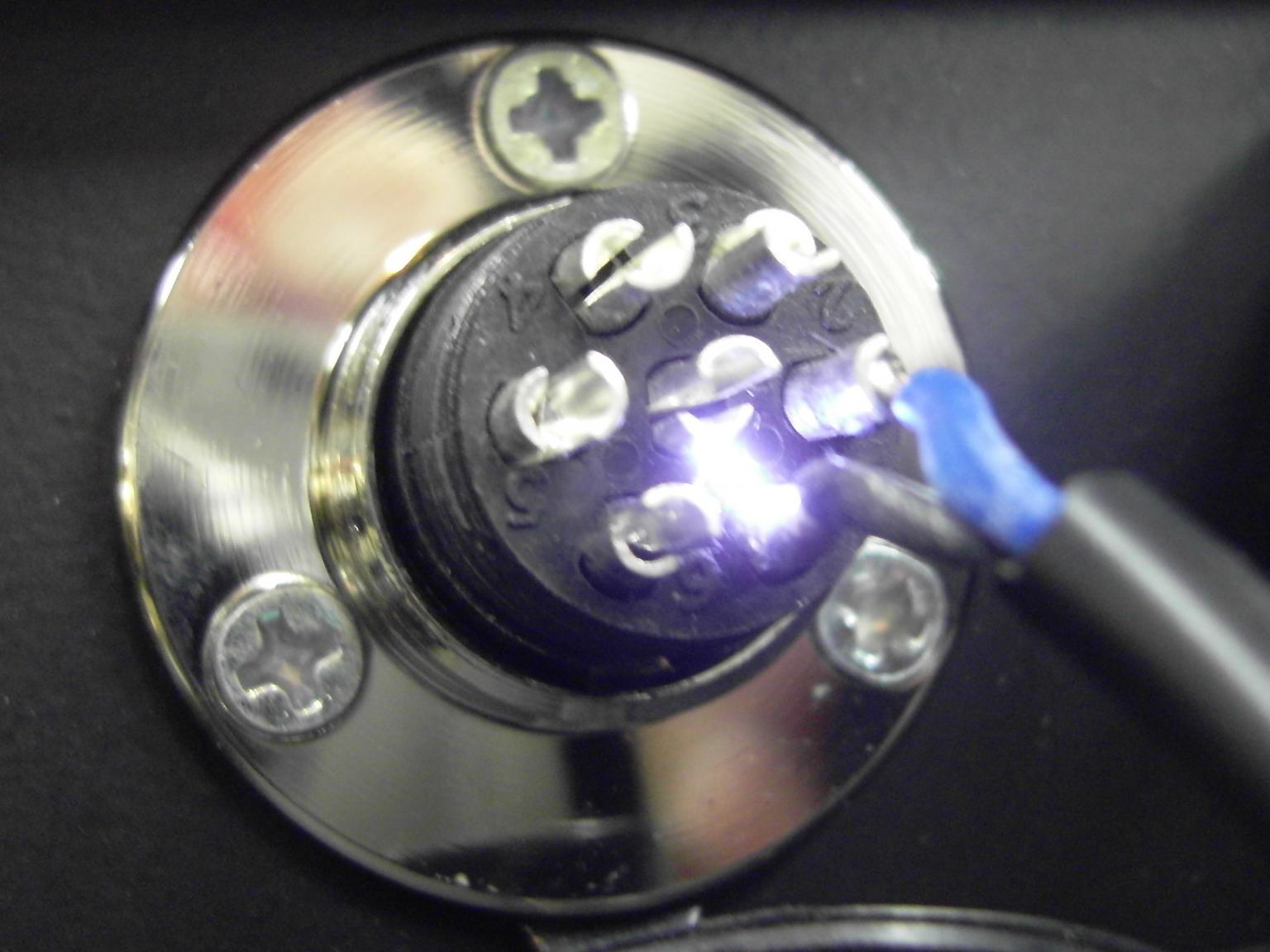

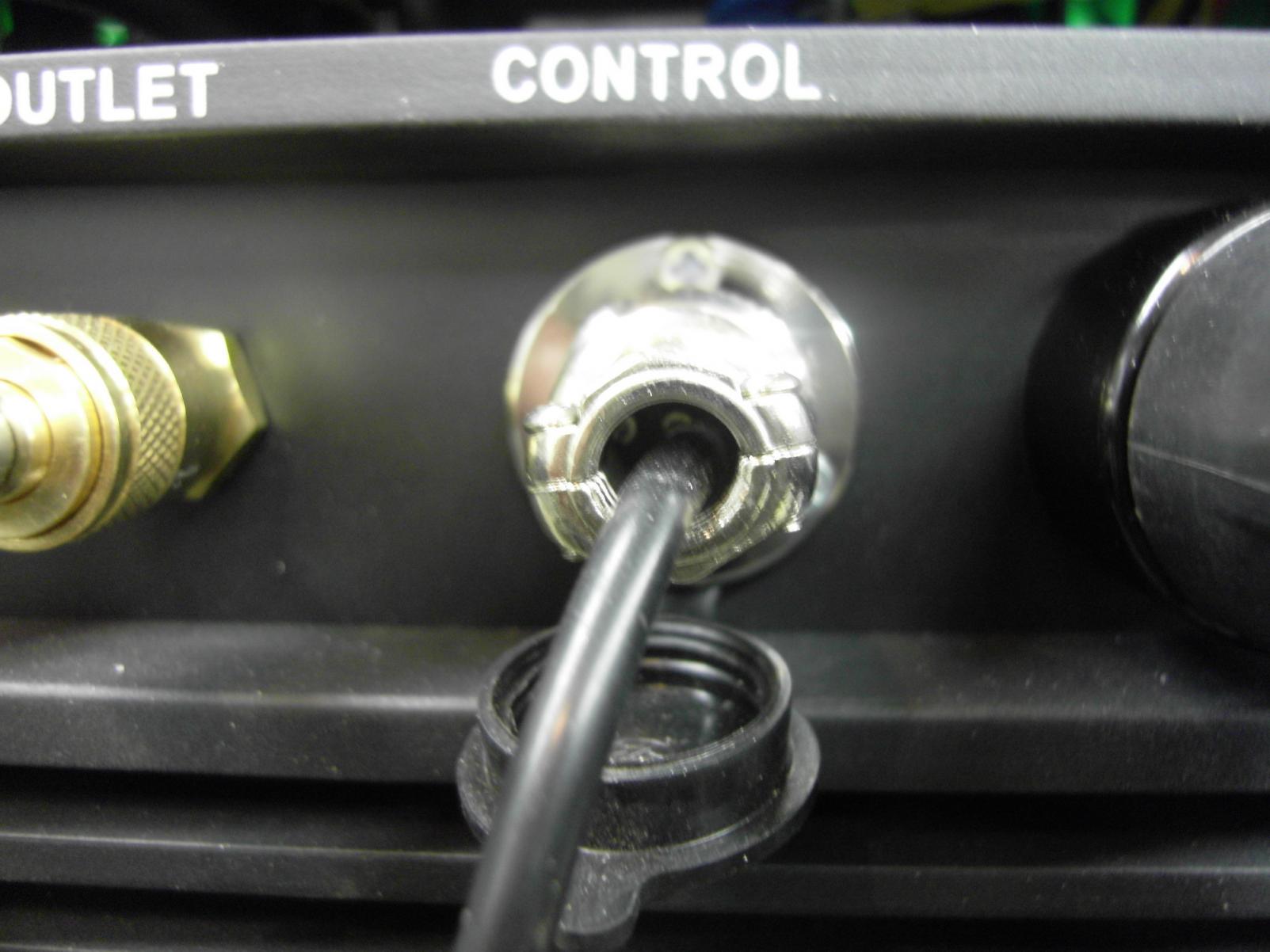

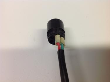

    Is this normal for the HF to keep jumping inside the torch/pedal control plug?
Name:	EVERLAST 2013-250EX PANEL NOTES Ref..jpg
ID:	9640Click image for larger version.

    Thanks for the quick review. I' think I'll definitely be changing the rotation on my quick connect. I'm not sure but I don't think the arc should be jumping inside the plug, check your points gap to make sure it's at around .035", which according to spec , is optimum.
    I imagine the arc will jump at the point of least resistance. So if your torch gap to the work is larger than the gap between the HF terminals in side the plug, it will jump at the terminals. The way to fix this is to insulate inside the terminal. If i get this issue on mine I'll probably pump some silicone caulk into the terminal to isolate it better.

    It seems Dinse plugs don't all clock the same. It's nice that it's an easy fix to get the lines going stress free. Last thing you want is a kinked water line. I agree that the cooler outlet definitely should be switched. Knowing myself, it is something I will have to modify once I get one for sure. AFAIK the control plug should be all low voltage and current lines, something sounds strange if you are getting arcing. Maybe some HF leakage from the nearby Dinse terminals? Something that needs to be taken care of ASAP. Are you using the HF ground point on the back?
    I put a line on the HF nut on the back but that did not do anything. See pics lots of arc in the plug will have to wait and see if tech will give me some ideas.
    Switch OFF on tig handle
Name:	250EX Plug Switch OFF.jpg
    Switch ON on tig handle
Name:	250EX Plug Switch ON.jpg

    I take it that is the torch switch plug. Does the foot pedal plug do any arcing? (I would guess not.)
    My guess is that you have a HF leak inside the torch cable, probably near the switch. I would look for where that is and insulate it. It can't be good for the welder to get HF leakage into the control circuits. I'm surprised that is hasn't caused a problem. Must be built pretty tough.
    The HF bolt on the back is the same chassis ground that your power cord is connected to. If you don't give it a shorter path to ground than the power cord offers, there won't any benefit. I don't think that's the problem here though.
    I have not seen the inside of the 2013 250EX, waiting on Oleg there. I have emailed and not heard back
    Is this with a foot pedal or just the torch switch? Best to get Ray ext 207, he should be up on any changed in the machine.

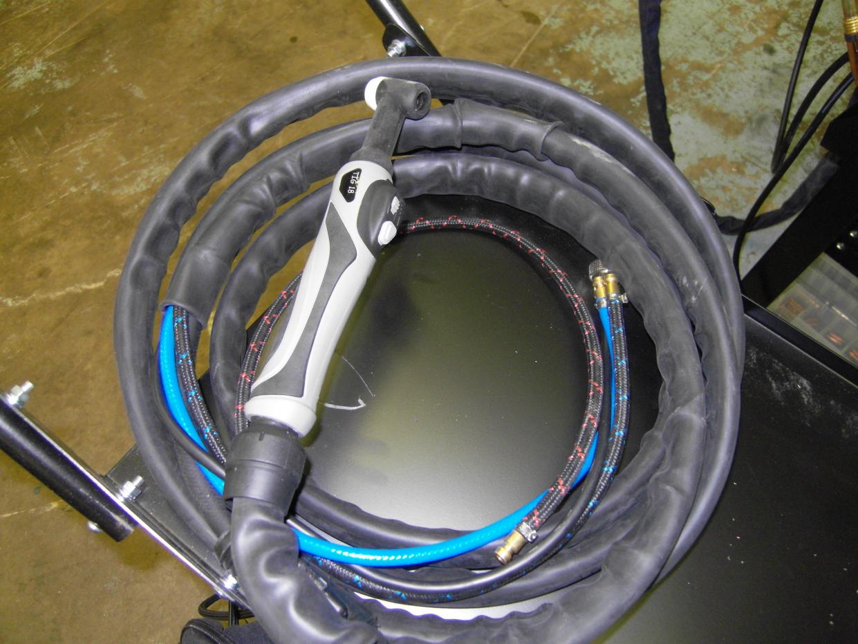

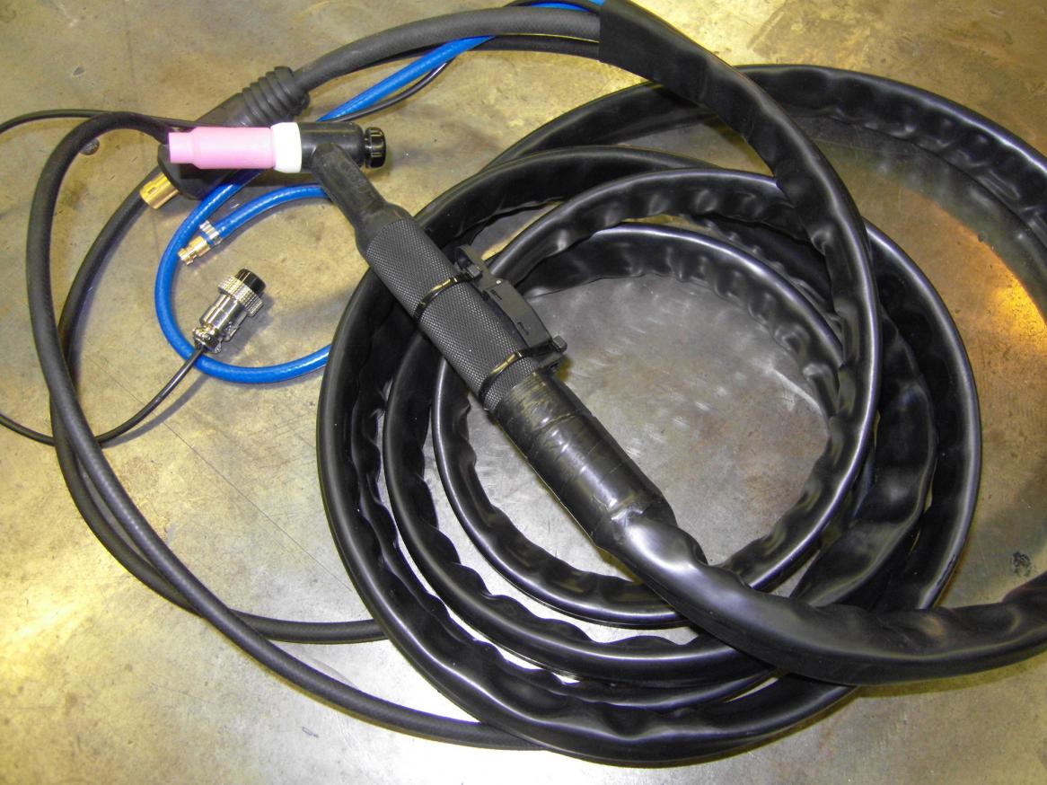

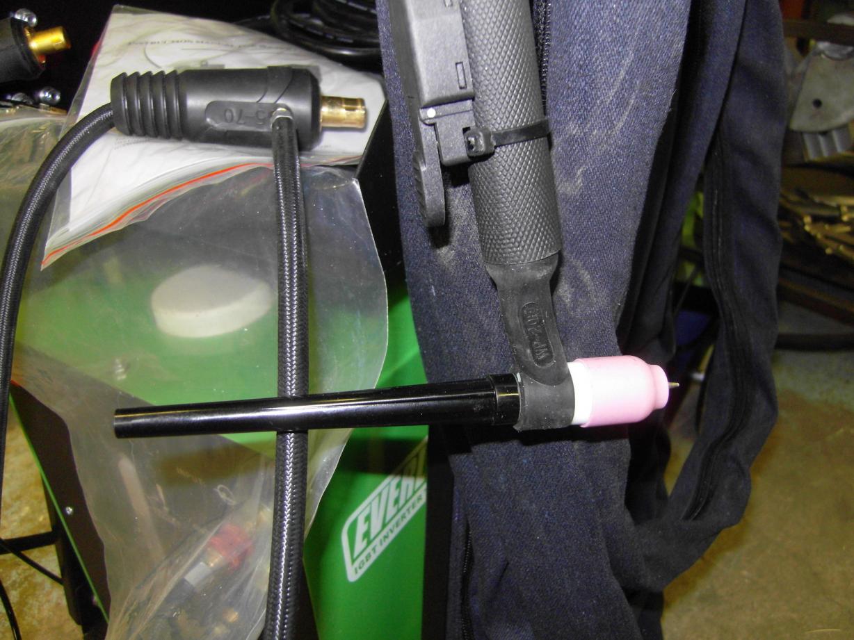

    What are the torches like that come with it? ANy pics?

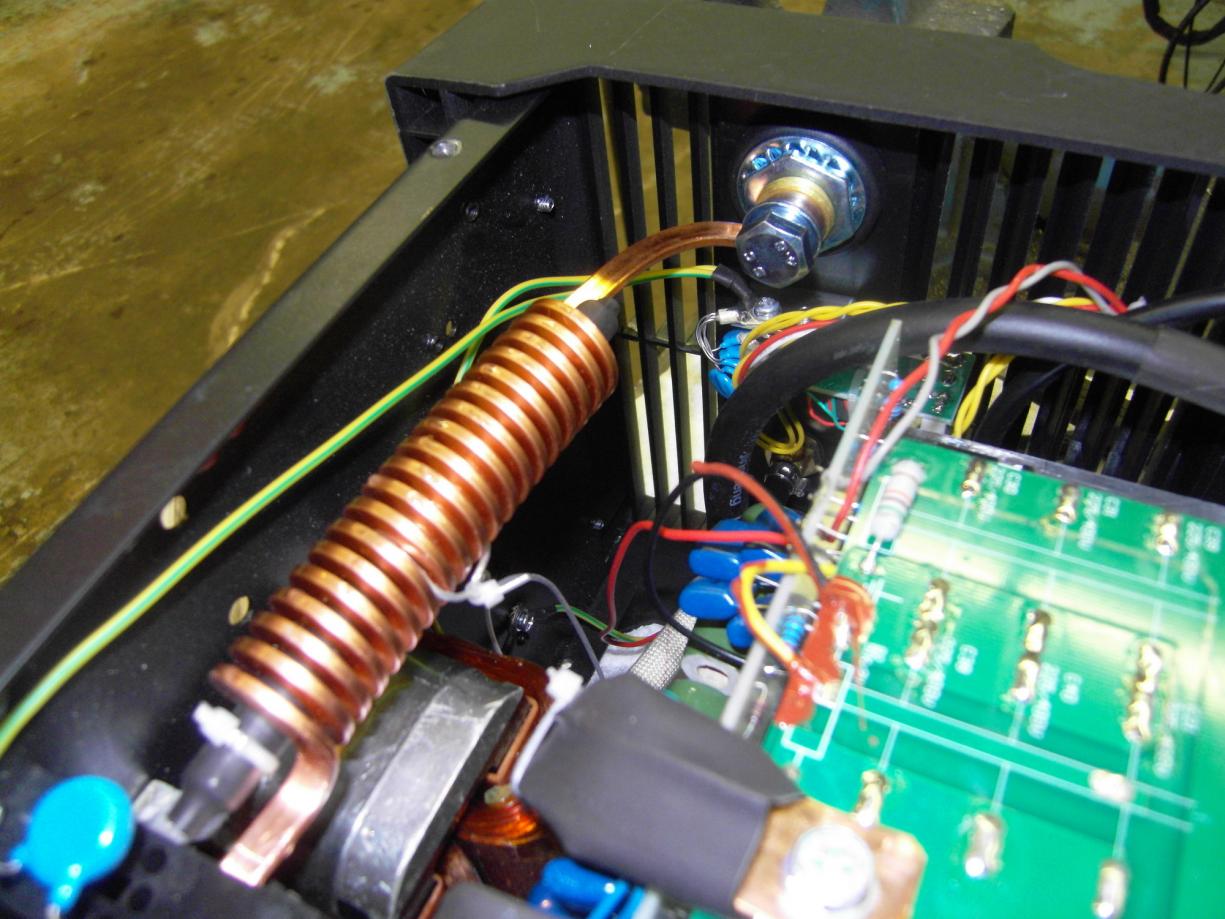

    There's a wire laying against someplace the HF circuit runs inside likely or the point gap is off. There' not been a major change in circuit layout, other than beefing up some circuit components.

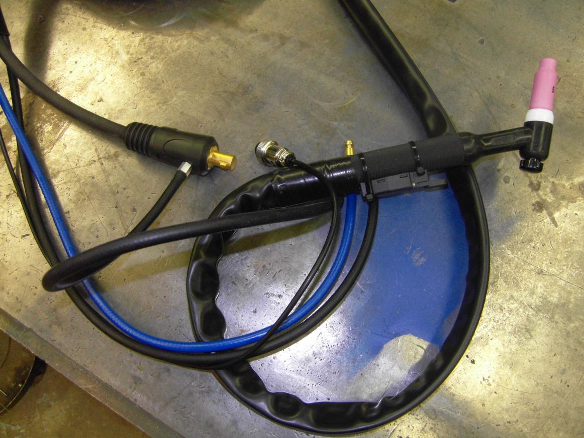

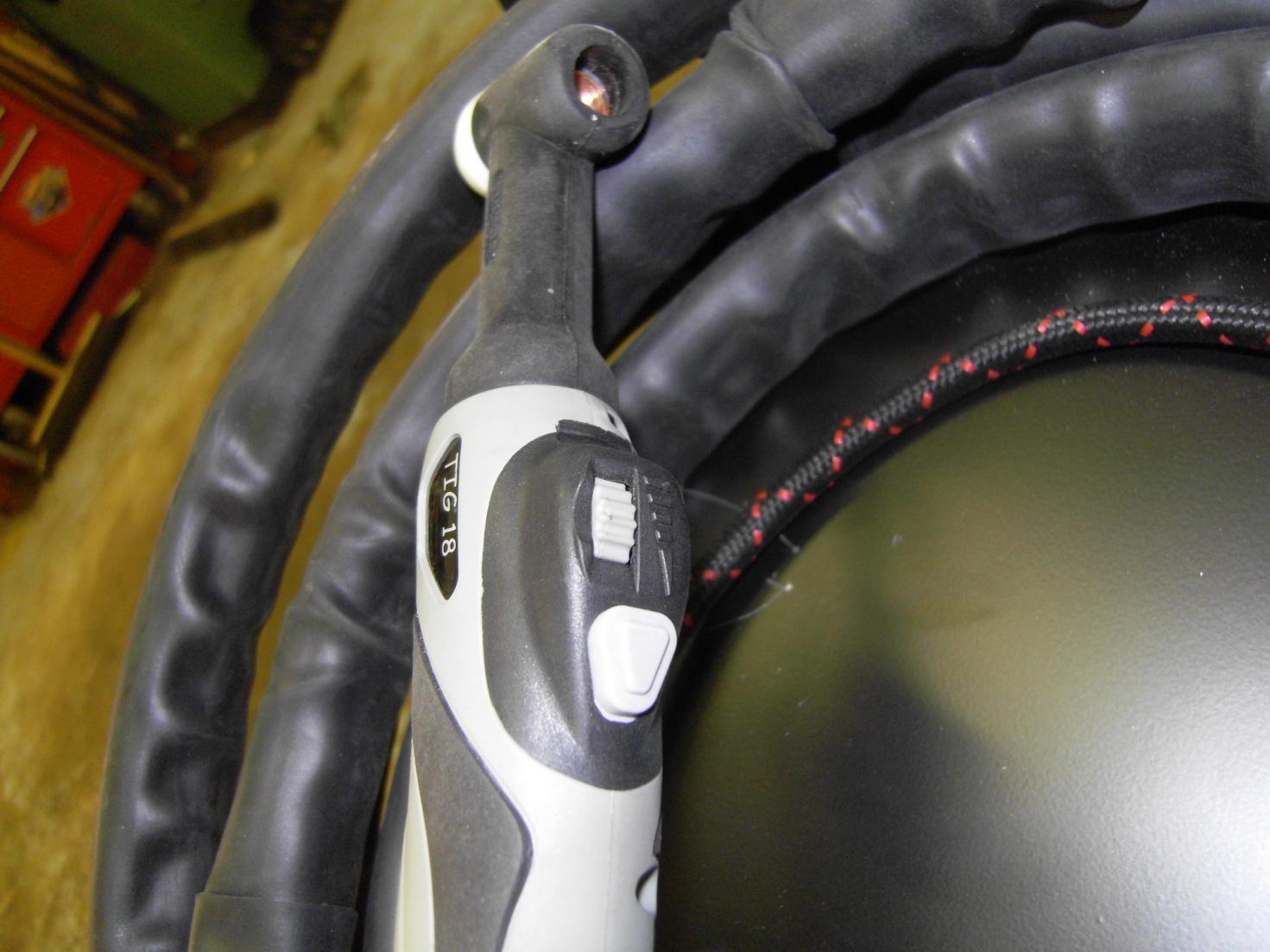

    I ordered a WP-20F 25ft that I am using now and a WP-18 Amptrol Torch I will try later got all with the 250EX welder at the same time.

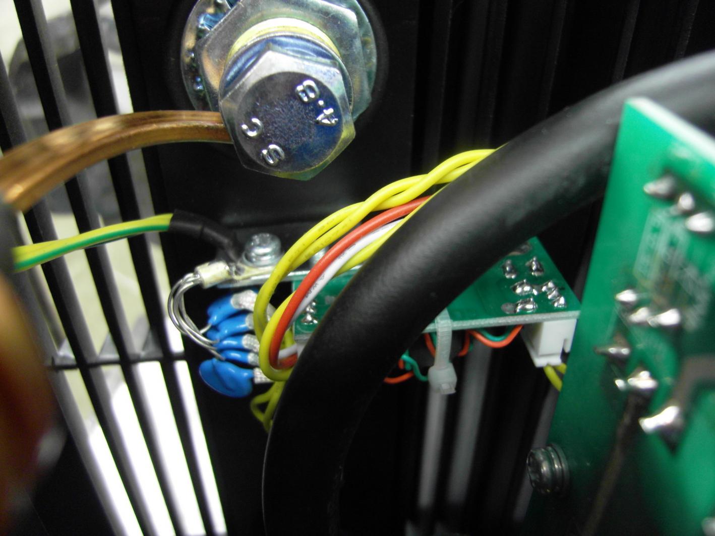

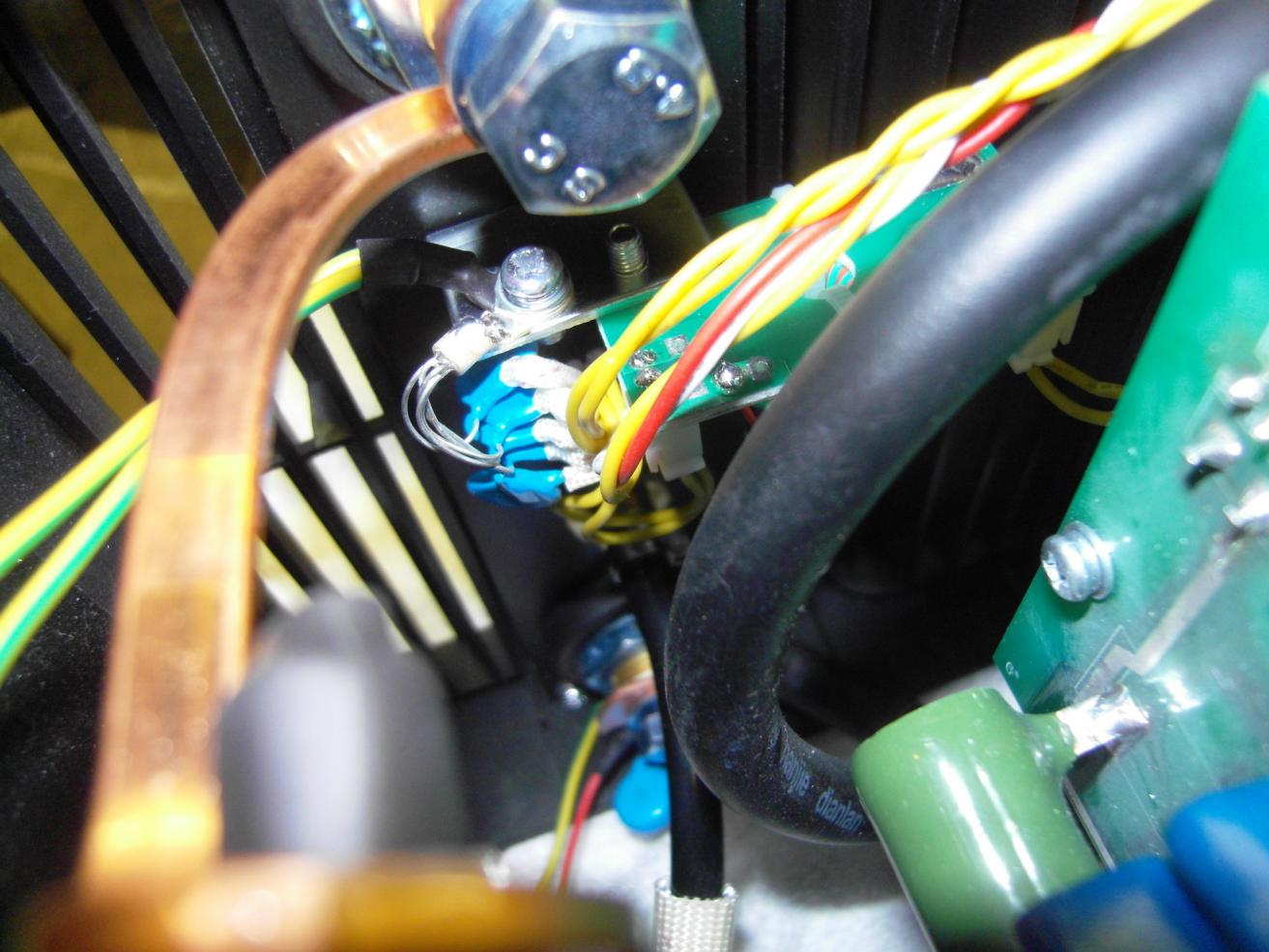

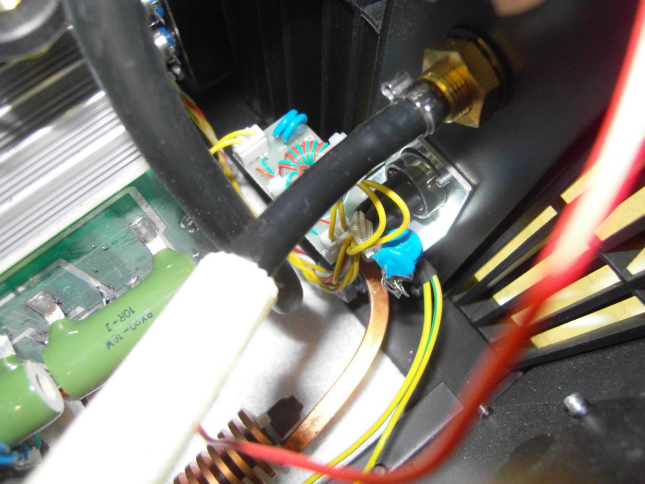

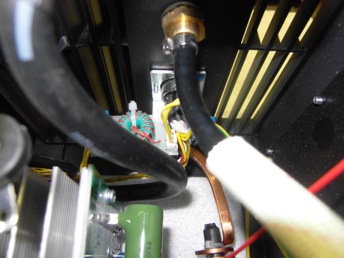

    Well some pictures of the inside. Point gap 0.9MM or 0.035in.
Name:	control plug 1.jpg
ID:	9664Click image for larger version.
Name:	control plug 2.jpg
ID:	9665Click image for larger version.
Name:	control plug 3.jpg
ID:	9666Click image for larger version.
Name:	control plug 4.jpg
ID:	9667Click image for larger version.
Name:	control plug 5.jpg
ID:	9668Click image for larger version.
    I like those new points, it's a huge improvement.
    My quote: Problem I have and would change on the 2013- 250EX the 220volt for the water cooler should be hooked up to the main switch to turn the 220 volt pump on when the welder is turned on.
    My fix since I had to open the case to take pictures of the HF. So this worked just fine now on weld on water cooler.
Name:	reconnecting wires.jpg
ID:	9670Click image for larger version.
Name:	switch cut blue wires.jpg

    could you show a couple pics of the torches that come with it?

    I do not know if I will ever use it, I got a Weld-Craft WP18-25 water cooled and CS300-25 air cooled and CS310-25 water cooled all new with many spare parts for the torches but I am waiting for a CK liner amp-control for my other torches I use tig handle amp controllers all my welding life so foot pedals are out but have them just in case the amp controller get damaged it is a backup. All this is on top of the Everlast tig torches I got.
    Problem fixed take out all the pins that are not used the factory torch dose not have them that comes with the machine little heat shrink now know more arcing.
