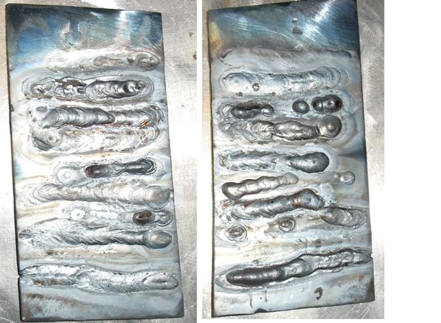

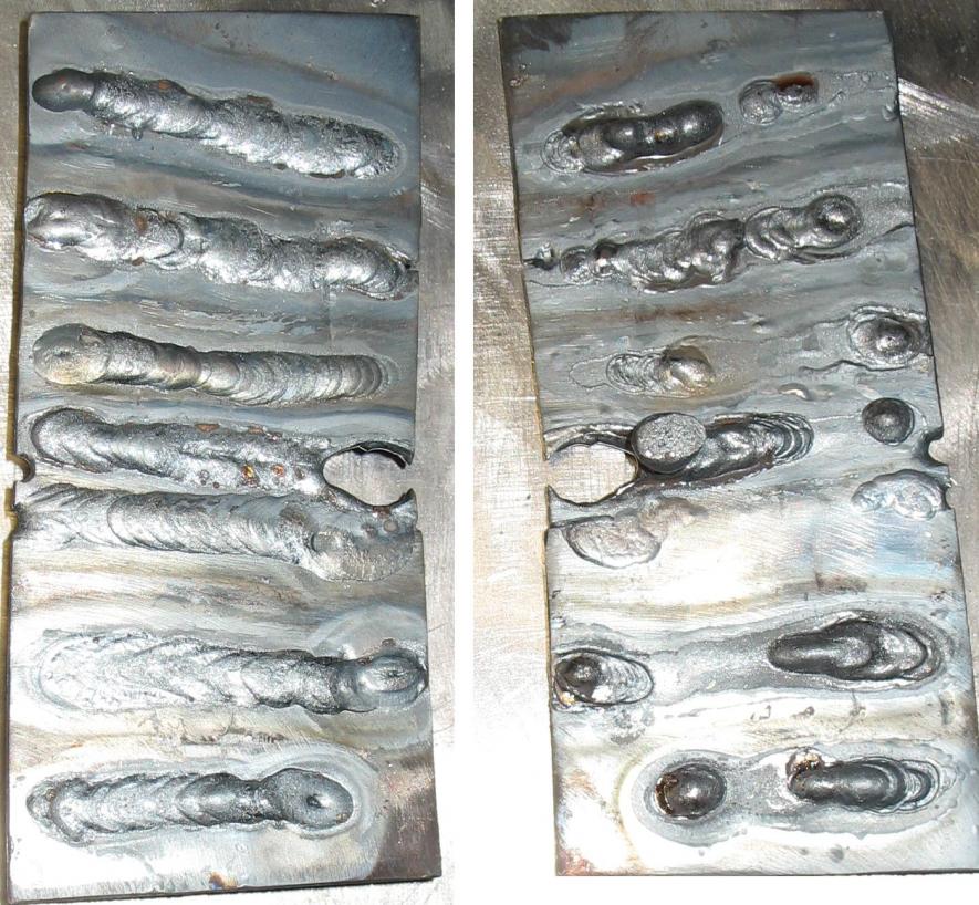

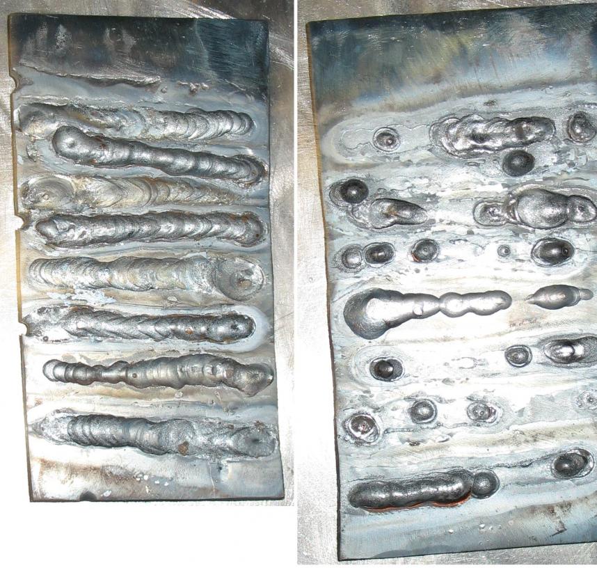

    Looks like to much amps (heat) and you are using to big of a welding rod for 1/8 steel. You should use 1/16 welding rod and less amps (heat). By what I can see in the pics it is taking a lot of heat to melt the rod and 1/8 plate is too hot. Using less heat and a smaller rod should help. Need to know gas flow and the distance you are holding the tungsten away from the work piece it might be to far all takes practice.
    3/32 isn't too big of a filler rod. In fact, the filler rod should be about the thickness of the metal or less. So this is fine. I suspect you are holding your torch too far off. Keep the arc to about the thickness of a quarter away from the metal. You are trying to compensate the distance and the heat spreading out with more heat...and that doesn't work. This is where you should try welding with the torch switch so you learn careful manipulation of the heat, and learn what amps you need to use. You should try to set it for about 80 amps or so. That should be enough heat. Other areas you are going to fast, no doubt to prevent burnthrough.

    Thanks for the responses guys. I was setting the power level following the 1 amp per .001 inch guideline and maybe taking that too literally. I may have the torch too far off. When I do a dry run my arc length seems good. When I did these beads it seemed at the end of the weld I was further away than at the beginning. It's a lot to think about when things look like they aren't going right. Next weekend I'll cut some more pieces and try out 80 amps and let you know how it goes.
    I thought about using 1/8 filler and 1/8 tungsten to go along with the 1/8 thick steel. I have 1/8 tungten but only have 3/32 and smaller filler rod, and for the 17 torch I don't have a 1/8 collet. I have 1/8 for my 9 series torch but to do the trigger switch I need to stick with the 17 torch. I'll pick up some 1/8 stuff next time I'm at the welding supply store.

    It would also help if you would clean off the mill scale as mill scale does not burn off well with GTAW.
    I would also try out some lap, corner, t, butt and edge joints.

    I would say that you need to start out using no filler rod (with the foot pedal), just simply run the torch along your metal in a straight line generating the smallest bead you can get....I'm talking about a bead that is nearly invisible! Forget the torch switch for now. The idea here is to learn what you need to watch out for in order to produce a weld that isn't too hot. Being up close and personal while running your beads is something that is necessary too. Many people tend to TIG weld hunched over while squinting from a distance, and I've found that you really need to be "right there" in front of the bead to see what's going on.
    Once you get to that point where a simple fusion weld looks good (isn't dark grey in color, has a nice ripple pattern, etc.), increase your heat just enough to melt your filler metal, and start adding rod. As Paul mentioned, you may have an easier time using smaller rod when learning. Larger rod means more heat, which can complicate things for you if you don't know what to watch for. Too much heat is easy to do when TIG welding. Keep the beads small if you can help it.
    I think DVA's suggestion of welding lap and corner joints is perfect, and I'd start there using your 3/32" filler rod. You can fuse weld a lap joint using low heat, then go over the top of your fusion weld with a "normal" bead that uses filler rod. Keep the heat low enough on the fusion weld to leave your top plate's corner intact (not rolled or melted off) so that you have a visible line to follow for your top bead. Then start stacking your lapped joints together to form more lap joints to weld.
    You can weld corners together on 2 pieces of flat stock (say 6" long) in the flat position, using a piece of angle iron below to clamp your flat stock to. The flat stock will be welded together in the position that resembles an upside down letter "V". Then you take all of your upside down "V's" and put them together to make the letter "M". Then weld your "M's" together to create one long "MMMMM." All the legs of the M would be at 45 degree angles (not straight up like the keyboard version of "M" shows), so it would technically look like this: /\/\/\/\/\

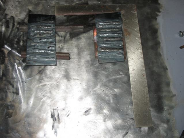

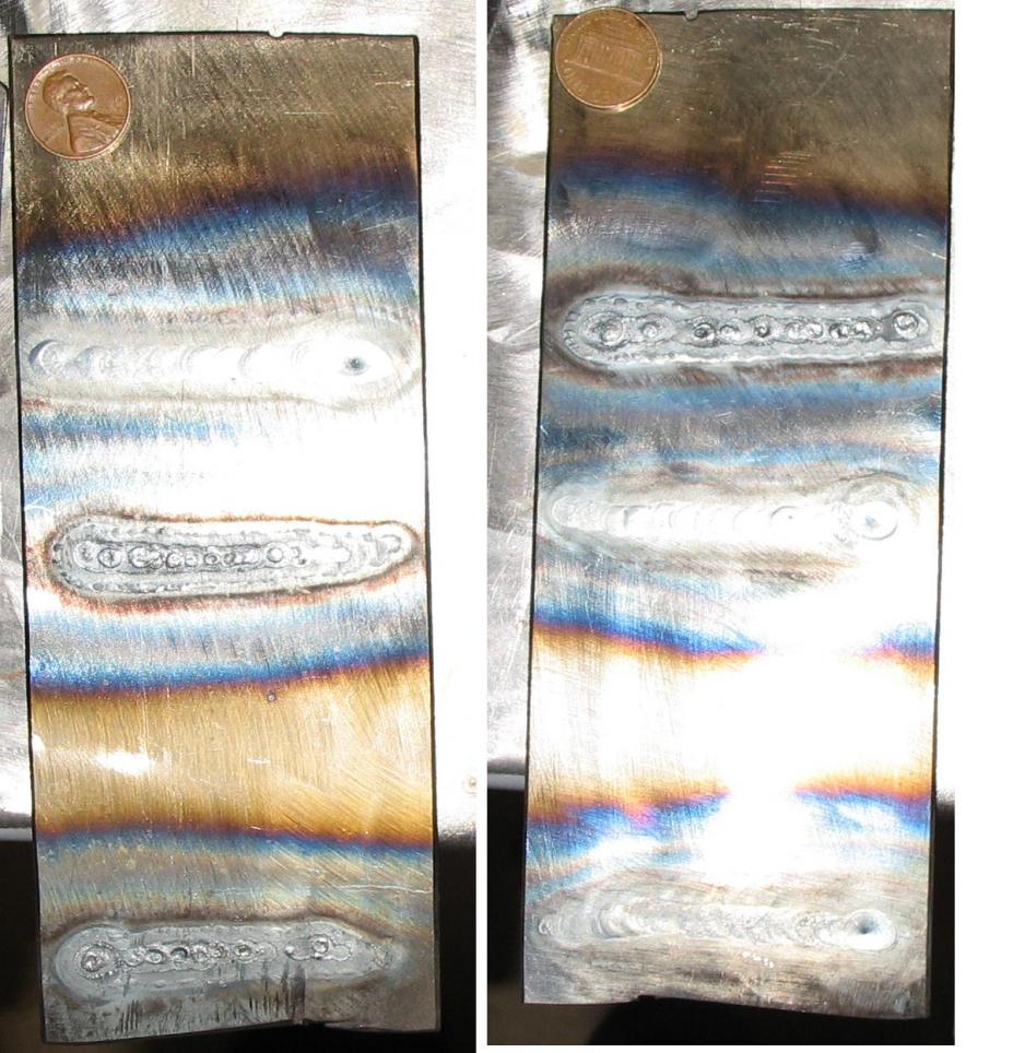

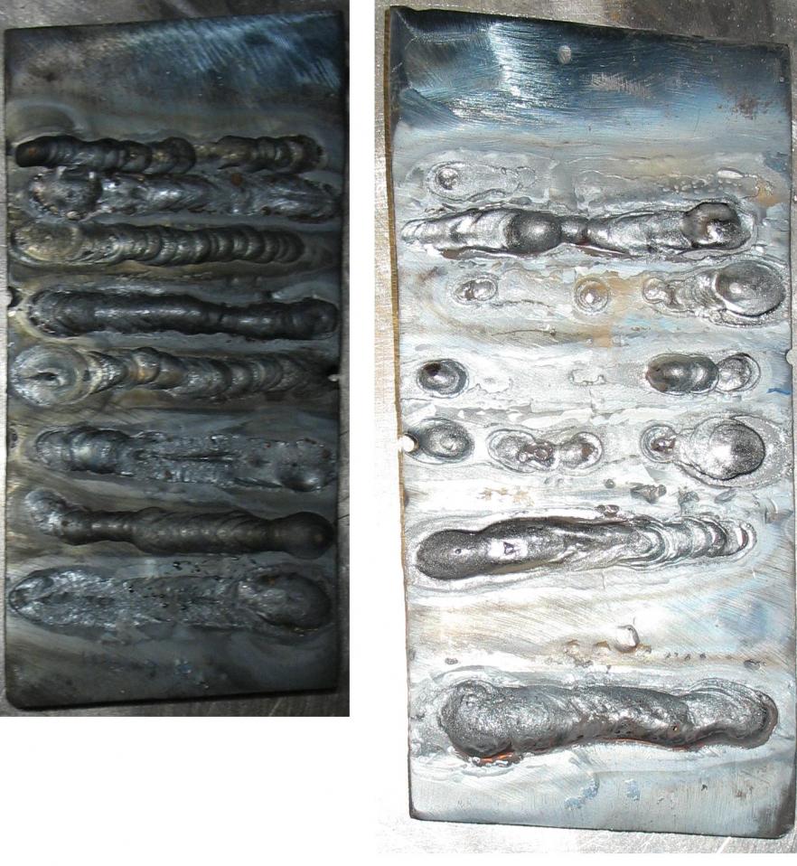

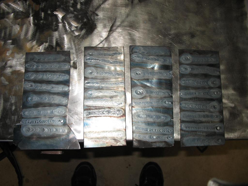

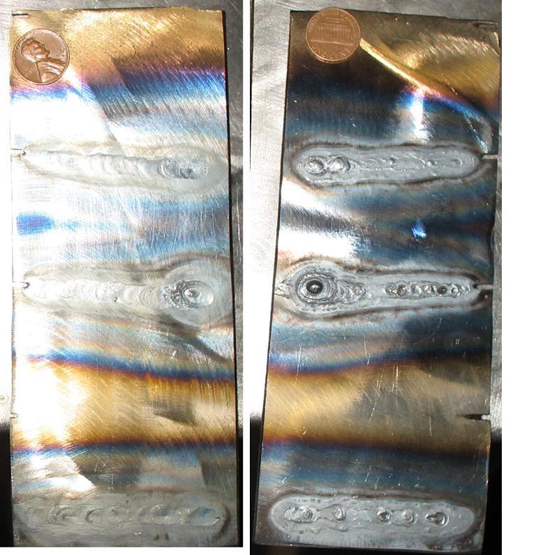

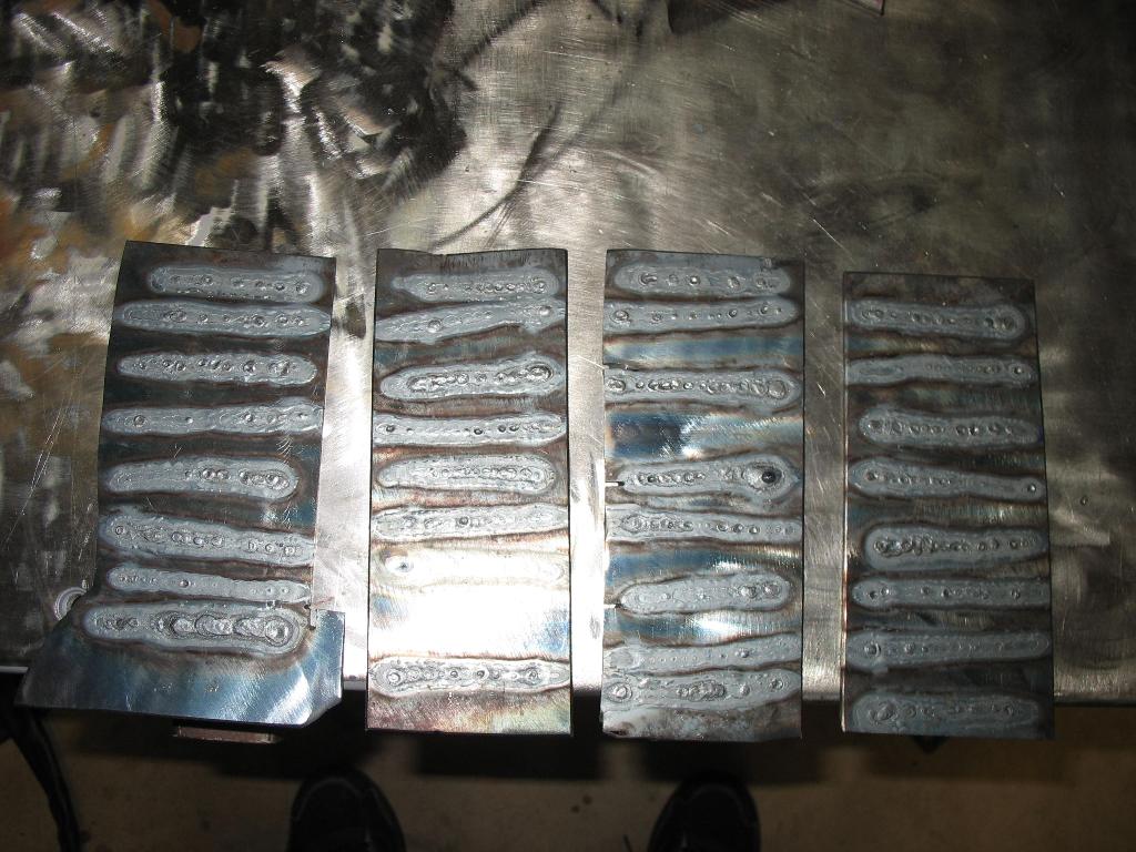

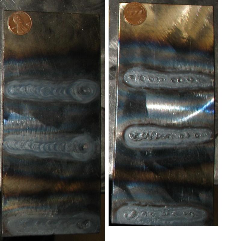

    Here's some pics after running with 80 amps set on the welder. 80 amps is a whole lot better than 120 amps! This just doing beads with no filler rod, trying to get a good handle on torch angle and arch length.
    Andy - I want to keep practing with what I've started with and build up from there. I think I want to get confident with angle and arch length and the power set on the welder side without being uncertain of the power setting with me at the foot pedal. I'll add in the foot pedal later.
    I figured out that after doing a whole lot of beads all of the metal becomes a HAZ so I put in some pics after 3 welds on each of the 4 pieces. I put the penny in for something of a known size for those beads. I then did more beads and I do think I had too much arch length in the begnning. On the pics with more than 3 beads I do see where the bead is more narrow due to me getting closer with the arc length. I'm getting better with the arc length sometimes but I want to get more consistent with more practice. I've had this a year and haven't practiced enough and been unhappy with other results so I'm finding a lot more patience now to practice more. I also had a Harbor Freight welder that was lift start so "Noob" might not be accurate but I've already "blah-blahed" too much!

    Try running beads with filler rod. Just lay the rod flat on the surface and run you puddle on top of the rod. That will help you with travel speed and your torch angle. After you get the hand of that you can practice dipping the rod. I've thought about purchasing that several times. It would have to be comparable to Miller Maxstar at a fraction of the cost.
    Oct 2011
    Litchfield Park, AZ
    370
    Looking better but still getting excessive penetration. Adding filler material will help pull some of the heat out of the weld and prevent the burn through.
    It would also help to do a lap joint, as there will be two pieces of material to pull out the heat. You can run a lap joint without filler material (autogenous weld) just as you were doing with one piece of material but you will be melting the two pieces together.

    I would also check your gas flow. Looks very "chalky" When I've had welds like that, increasing the gas flow helped.

    Sometimes using too little of amps can make you sit around too long waiting for the toes of the puddle to wet in...that will make the back burn through. If you set your heat, and torch angle right you should be able to to move, dab, move, dab.....ect. The torch angle should be slanted to the side just enough to keep the puddle from bulging under the tungsten and contaminating it as you add filler. If it's slanted too much the filler will ball up and melt to early and drip before the puddle causing irregular looking weld bead. You need to keep the arc length as short as possible, get the right torch angle, amps, get filler rod angle right, and move at the right speed. TIG is not the easiest to make look pretty, but when you get it right, nothing can touch the micro sized super tight weld bead size. Good luck!
