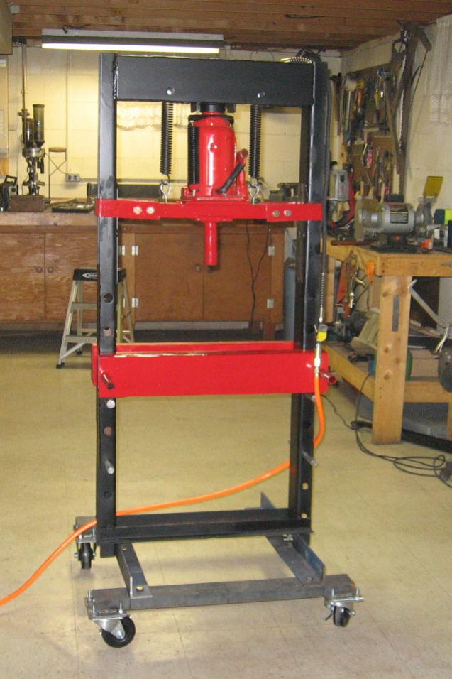

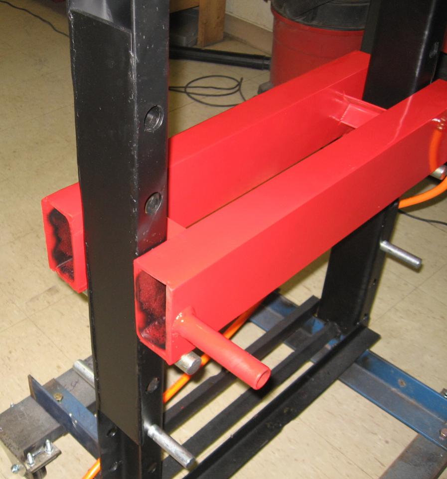

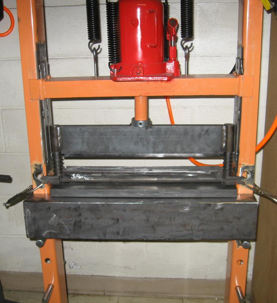

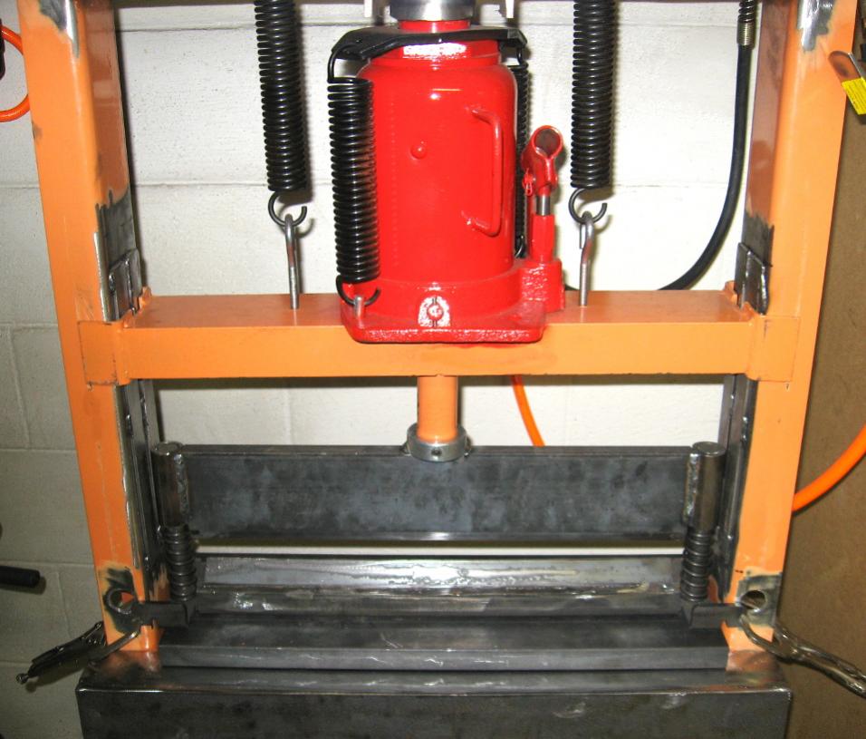

    Ok, I almost finished up the Harbor Freight 20 ton Hydraulic press upgrade to 35 tons. All I have to do now is reinforce the frame on the sides and paint. I should be good up to 75 tons with this now.
    Here is what I did:
    Reinforced the top with 5/16 plate on both sides.
    Reinforced the bed with 5/16 plate on both sides.
    Added spacers to the frame to keep the bed straight.
    Updated to 1 inch grade 8 pins for the bed.
    Added 3/4 inch rod at the bottom to stiffen up the frame.
    Added a SWAG OFF ROAD press brake.....very nice.
    Added an air/hydraulic 32 ton jack which actually has a rating of 70,400 lbs. (35.2 tons actual)
    Here are the photos:

    The SWAG press brake is a great little kit. Very easy to put together and works great.
    If you can find the Harbor Freight hydraulic press on sale, then it is worth updating to a heavier duty version. Plus if you can find a good air / hydraulic bottle jack at a good price, then this is the way to go. But if you can't, then building your own is probably a better rout. Overall, this press now rocks.

    Steve,
    It looks good.
    Air over, if you use it a lot, is a nice feature. I used mine the other day and I am sure I pumped the jack at least 100 times if not more.

    What do you have the press sitting on? Rubber plates to cut down noise and vibration from the air/hydraulic jack? Considering how much weight you've added to the press assembly, and how high most of that additional weight is located, is it any more unstable or top-heavy because the base hasn't been broadened (or bolted to the floor)?
    Everlast PowerArc 140ST
  9. #29
    I think the operator's manual for the HF press outlines that it should be bolted to the floor. I thought I saw somewhere in these threads that Steve was planning to do that but I can't find it now or maybe I'm just imagining it!
  10. #30
    I am going to bolt it to the floor. Right now in order to slide it around so I can work on it and not mar the floor, I put some furniture sliders under it.
    Yes, it needs to be stabilized but it is pretty stable as is but I will not risk not having it bolted. Safety first!
    Also, I noticed that the pressure pin is not straight on the carriage. So I am going to build a new carriage to make sure it is straight. I have noticed a slight bending to the left when I put the pressure down. So I will add a removable rider to the side of the carriage to ride up and down the side supports to keep it straight.
    I am sure as I use this thing more and more that I will have to modify it even more. Probably reinforce the SWAG brake and a few other things. I'll play it by ear.
    The question was asked if I would have been better off building one from scratch. I can now say that yes it probably would have been better. The HF 20 ton Harbor Freight press at $149 out the door was a good deal. For most folks, that press is more than enough. Modifying it to me was fun.

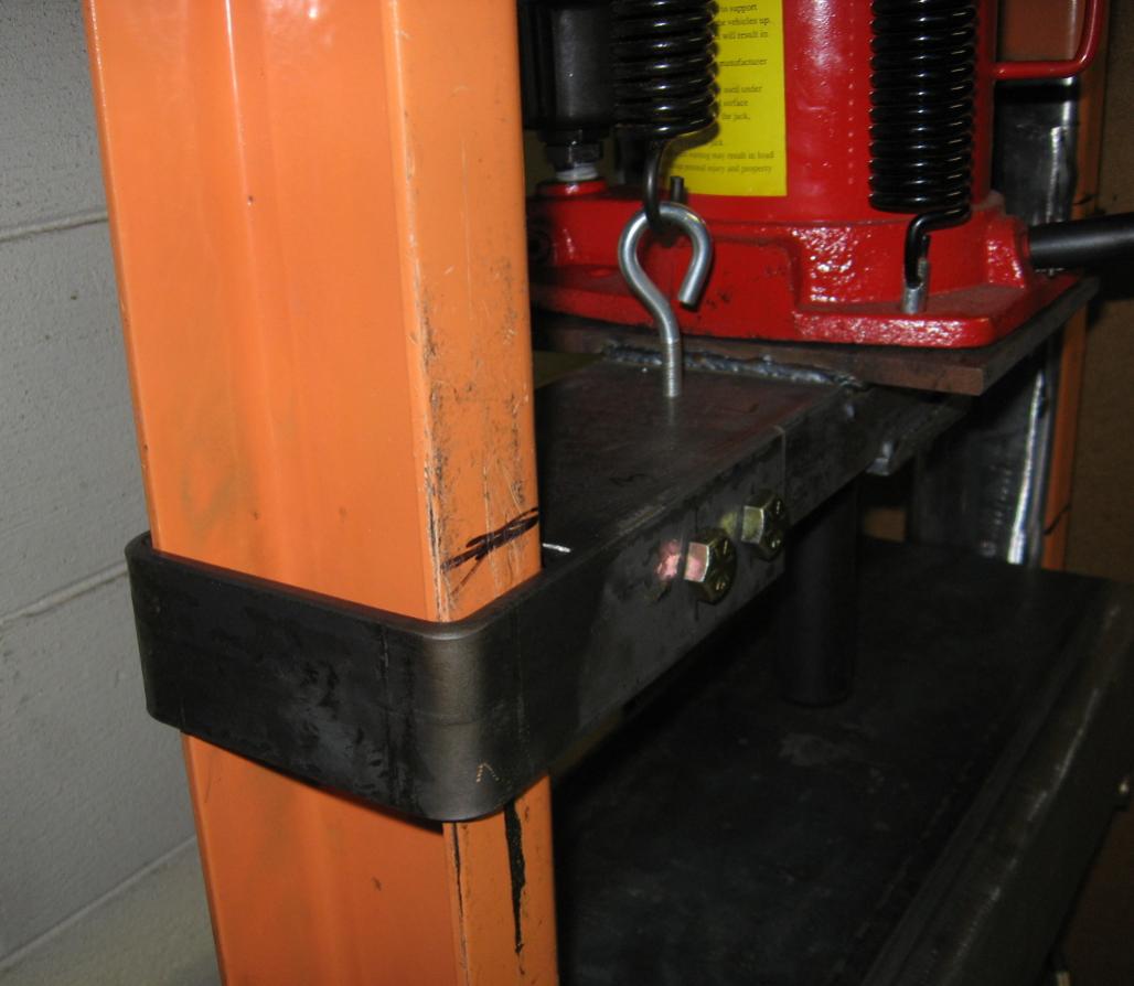

    Thanks. Yeah, the press can now take quite a bit more along with the 1 inch grade 8 bolts I put in. The 32 ton jack bent the 3/4 inch pins a little.
    I also noticed that the pressure post welded to the jack carriage was not straight and when I put the pedal to the metal, the press would bow to the left a little in the direction of the offset. So I am now in the process of building a new carriage to make sure that the pressure post is absolutely straight. I hear that is a common problem with these presses.
    I am also going to weld in some schedule 40 1 inch pipe in between the C channel on the main supports plus afterwards weld some 5/16 inch plates to the outside of the C channel on the supports. That should really stiffen this up and allow if I want to, to go to a 50 ton jack.

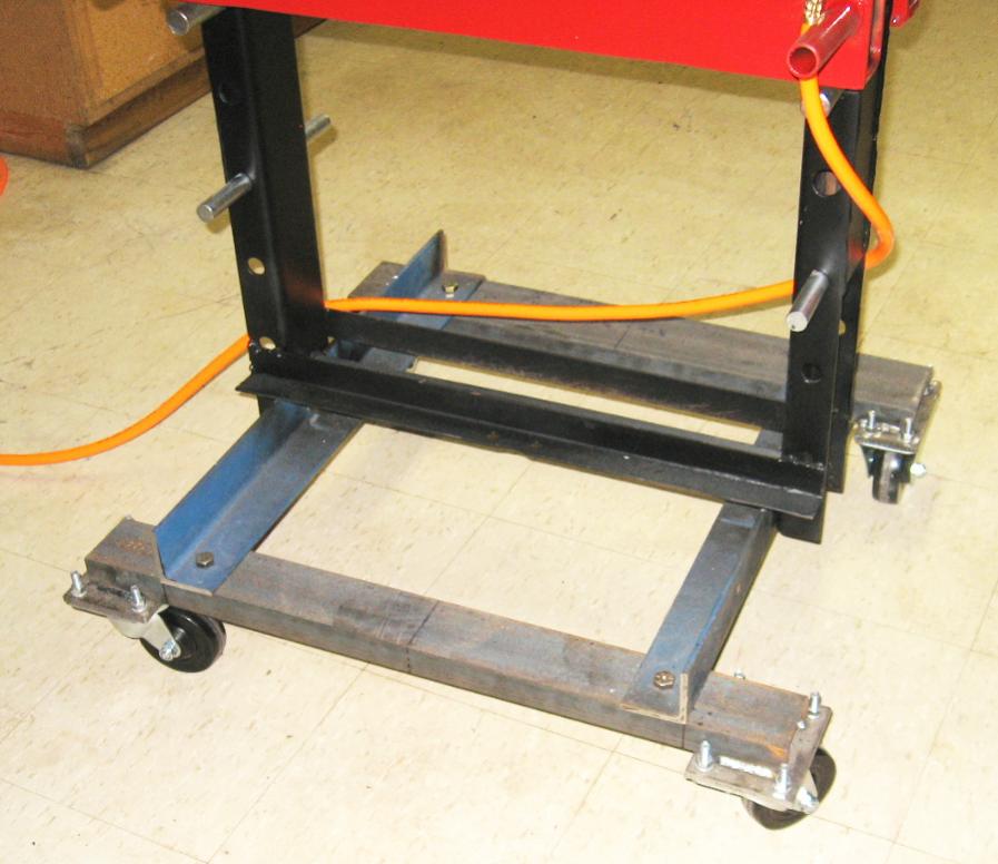

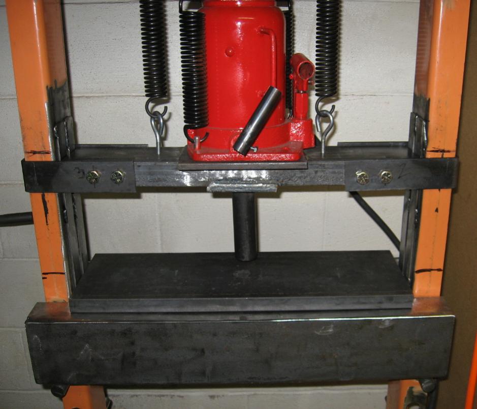

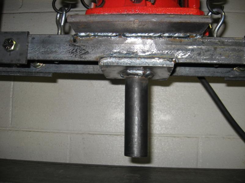

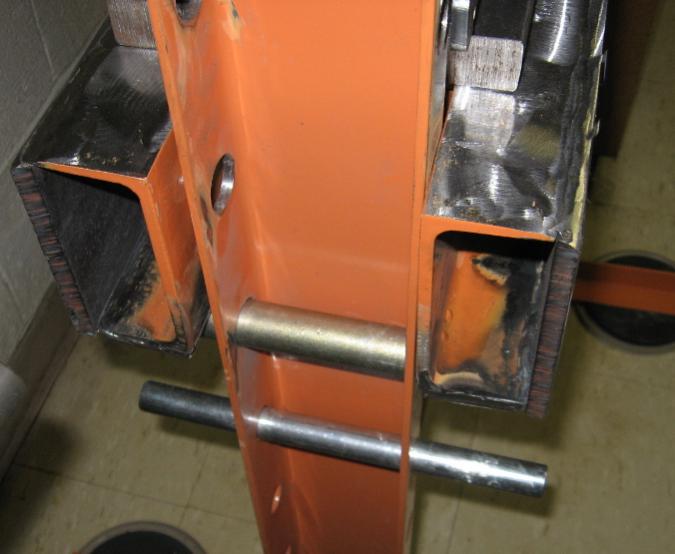

    I did one other modification yesterday. Went to the metal store and got some C channel and build a new jack carriage. The factory carriage was not too good with rather poor welds and the pressure pin was not too straight which ended up putting some lateral pressure on the frame. So I also got a 1.5 inch diameter 8 inch grade 8 bolt and cut off the threads and used that as a pressure pin.
    I also bent some 1/4 inch x 2 inch plate and made some guide straps for the carriage and bolted them to the carriage with 1/2 inch grade 8 bolts. That SWAG press brake works pretty good! I then added a 5/16 inch plate under the jack for better support and also built a valve wrench out of small tubing.
    Today I will also add some 1 inch schedule 40 pipe to the pin holes and then weld 1/4 inch plate to the main frame C channel to box it in.
    I'm doing that to in the future be able to use a 50 ton air hydraulic jack or maybe a pure hydraulic motorized drive.
    In the future, I will probably put some wheels on it instead of bolting it to the floor. I found it to be pretty stable as is but I do see the need to wheel it around.
    Here are some recent photos of the new carriage.

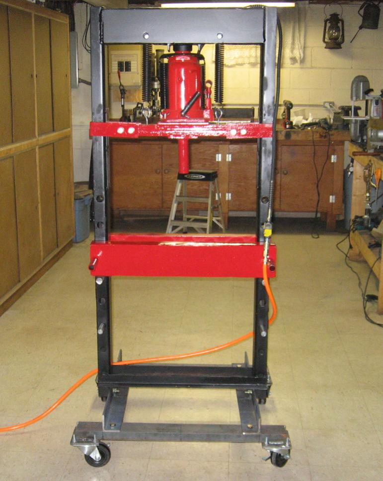

    I think I am pretty much done with the Harbor Freight mod to make it a 36 ton press. I did reinforce the side rails and added schedule 40 tubing into the holes which I expanded to 1 inch for the 1 inch x 14 inch grade 8 bolts for the bed pins.
    I also added wheels to the base as the thing was getting pretty heavy and was hard to push and was marking up the floor. I upgraded the angle iron that was the legs to a thicker version for added strength. The wheels are rated at 250 lbs each. The weight of this thing now probably a bit over double what it weighed bone stock.
    I also added some grips to the bed to make it a little easier to move it up and down. The bed now weighs in at 87 lbs. as I have reinforced it with 5/16 inch plate on both sides.

    I really like this press now. The Harbor Freight press is pretty nice as is especially when you get it for under $150. I needed a bit bigger press but the ones available were way too high price wise. I could have built one from scratch but when the HF press went on sale, I could not resist and saw a chance to make it even better. Plus it was fun modifying it to make it do what I needed it to do!

    Not much HF left in there.
    Reminds me of something another mechanic used to say about some cars. "You just need to jack up the radiator cap and install a new car under it."
