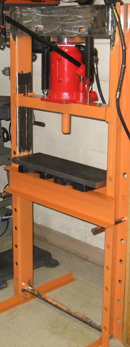

    I got a great deal on an excellent product from HF which is their 20 ton hydraulic press. $149 out the door. My old 25 ton press cracked after 20 years of use so I decided to get the HF 20 and modify it. The press is a bit sloppy with the pin moving front to back and right to left way too much so I did a bit of modifying along with increasing the tonnage to 32 with the addition of a new air/hydraulic jack.
    The HF hydraulic press is rated for 20 tons which is plenty for most but I am going to be bending some fairly thick metal and I wanted the air / hydraulic option so the hand 20 ton jack was replaced with a 32 ton a/h jack.
    The press itself is pretty heavy duty but will not withstand 32 tons without reinforcing it in key areas.
    On the top, I added on both sides some 5/16 plate that I cut with my Power Plasma 50. What a great machine! Cut through it like butter. I probably could have gotten away with 1/4 inch plate but I may in the future go to an even heavier tonnage. So 5/16 was it.
    On the side C channel, in order to tighten up the sloppiness of the jack carraige, I added some 1/16 inch by 1 inch by 12 inches of flat bar metal to both sides of the C channel supports. Had to grind it down a little to allow for smooth movement but it was worth it. I also bent the small C channel in on the carraige to cut down on front to back movement.
    On the bottom, I added some 3/4 inch rod to keep the supports from bending. It really stiffened up the whole frame.
    To top it off, I added a 32 ton air-hydraulic jack. Had to cut out the old circular top of jack guide and replace it with a larger one to fit a 32 ton jack. I cannot describe how much nicer it is to have air hydraulic instead of the standard pump jacks. I mean like magnitudes better. It changed this press from being a pain in the butt to use to one that I look forward to using. It is that much better.
    Had some problems with Harbor Freight mig wire. I won't use or buy it ever again. It was oily and would not weld worth a darn. Arc was erratic and welds were poor. I would not recommend Harbor Freight mig wire. There are many lists on the internet about which HF products are good and which are not. I would recommend checking it out before you buy!
    I would also recommend that anyone who has a Harbor Freight Hydraulic press to get a good thick piece of steel to put over or under your cast iron arbor press plates. Those cast iron plates have in some cases broken apart with some force so they can be dangerous.
    I could not have done this without my Power Plasma 50. I cannot say enough about how great that machine is!

    Do you think the bed and pins will take 32 tons ?
    I recently reinforced the bed and changed the pins to 1 inch along with reinforcing the C channel on the sides with 1 inch diameter opening grade 8 washers welded in place. I found out last night (after reading the manual) the the jack I am using is actually rated at 72,000 lbs. and not the 64,000 lbs I thought it was. So it is a 36 ton jack even though I thought I bought a 32 ton.
    I have noticed that the bed did bend a little with 36 tons on it noticeably even with the 1 inch x 8 inch plate on top of the cast iron plates. So last night (at 3 am) I welded the 5/16 inch plate to the bed along with adding the 1 inch pins (made from grade 8- 1 inch by 1 foot long machine bolts) and welded on the washers. The pins are not getting any marking on them like the 3/4 inch factory pins were getting and now the flex on the bed is a lot less.
    The jack carriage modification really helps with pressure pin stability. I was not happy with the way the carriage was moving between the C channel supports with movement right to left and forward and back. Like about a quarter inch each way! By adding the sixteenth inch thick metal on both sides to the C channel, it stopped the movement and bending the tabs on the carriage stopped the forward and back movement. Now it moves almost like a high end hydraulic press with no wobble on the carriage.
    It should be illegal to sell these presses with a manual pump jack. The air option is so much nicer and quicker.
    I had to scrap my old 25 ton manual pump hydraulic press after over 20 years of hard use. It was developing cracks and the jack was leaking pretty badly. I also needed a little bit larger press so I put the old one up for sale on Craigslist with the new 20 ton jack that came with the Harbor Freight press and it sold in a day for almost the price of the new air hydraulic jack.
    Overall besides having to move the press from my garage upstairs and down to the basement several times, this was a pretty fun project to do.
    How was the 5/16 plate welded on, along the inside of the C-channels?
    Miller 252
    PowerTig 250 EXT
    I welded the plate on the outside so the C channel is boxed. It now is really heavy and will not bend too much. I put a dial indicator on the bed prior to welding the channel and it was deviating by .11765 with the jack at max. After the welding, the bed deviated by .0162. Quite a difference. The bed when used not reinforced, would bend back but would not bend back totally. I would lose about .001 of an inch. Not a lot but over time would add up if I use this a lot. Now that it is reinforced, I cannot measure with my digital dial indicator the return. I think It's going to be good.
    I may end up reinforcing all the C channel on the main frame with plate. I have noticed a slight twisting on the frame if anything is not exactly straight. I may even add an external C shaped frame at the back of the press to keep twisting down.
    This press now can handle the 35 Tons the jack can output. And it now weighs almost twice what it did when I got it!
    I wouldn't use grade 8 bolts for support pins because the harder steel will shear instantly rather than bend or deform. A grade 5 bolt is a better choice for shear stress.
    That is an interesting comment.
    I did a bit of research and before I made my decision, I needed to know the shear strength of a grade 5 and a grade 8 bolt at 1 inch thick.
    Here is what I found according to Mark's standard Handbook for Mechanical Engineers:
    Here is the link: http://www.rockcrawler.com/techrepor...ners/index.asp
    A one inch grade 5 bolt shears at 58,900 lbs.
    A one inch grade 8 bolt shears at 71,500 lbs.
    The surface area where the bolts will contact the side of the frame has been doubled with the addition of 1 inch grade 8 washers welded to the supports on each hole. Each pin or bolt would have two contact points each for a total of four contact points with the frame. So each contact point would have at least 14,725 lbs on them. But, the tops of the pins will have no pressure so you would have to increase the pressure on each of the points to about 17,600 lbs on each contact.
    So, yes I could have used grade 5 bolts and it would have a very good safety factor.
    Each grade 8 bolt has a shear strength each that is at about the capacity of my hydraulic jack. Just one bolt alone!
    The safety factor in having 4 contact points (which has been increased in surface area) is way more than I would ever need. The grade 8 bolt has 12,600 lbs of more shear capacity (over 6 tons) over the grade 5 bolt.
    I highly doubt that I could ever break these bolts with the setup I have. But I agree, a grade 5 bolt would have saved me some cash and would have been just fine for my use.
    I may in the future go with a 50 ton air hydraulic set up. The grade 8 bolts would still be fine for that. The only thing that I would have to worry about is the frame which could be a problem. I am going to eventually install tubing inside the C channel and also add 5/16 plate to box the frame in for even more strength. I want to do some hole punching and a 50 ton press would really be the cat's butt!

    Ok, I almost finished up the Harbor Freight 20 ton Hydraulic press upgrade to 35 tons. All I have to do now is reinforce the frame on the sides and paint. I should be good up to 75 tons with this now.
    Here is what I did:
    Reinforced the top with 5/16 plate on both sides.
    Reinforced the bed with 5/16 plate on both sides.
    Added spacers to the frame to keep the bed straight.
    Updated to 1 inch grade 8 pins for the bed.
    Added 3/4 inch rod at the bottom to stiffen up the frame.
    Added a SWAG OFF ROAD press brake.....very nice.
    Added an air/hydraulic 32 ton jack which actually has a rating of 70,400 lbs. (35.2 tons actual)
