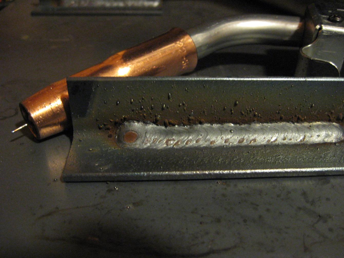

I went out to the shop and made a little demo weld. 11 gauge HR steel, 19v, 220 wire speed on the display (reads amps when welding) 75/25 gas.
I haven't learned how to minimize the BBs Click image for larger version.
ID:	9258 Any tips would be appreciated.
Excess Gun angle increases BB.s Pushing may help as well. You can tune the arc force, and reduce the wire speed or increase the voltage to reduce the BB's. After optimizing these settings, you can also go to an 80/20 or in my case a C18(Air Gas proprietary blend). Try dropping your wire speed to 200...What brand wire and wire size are you using?
