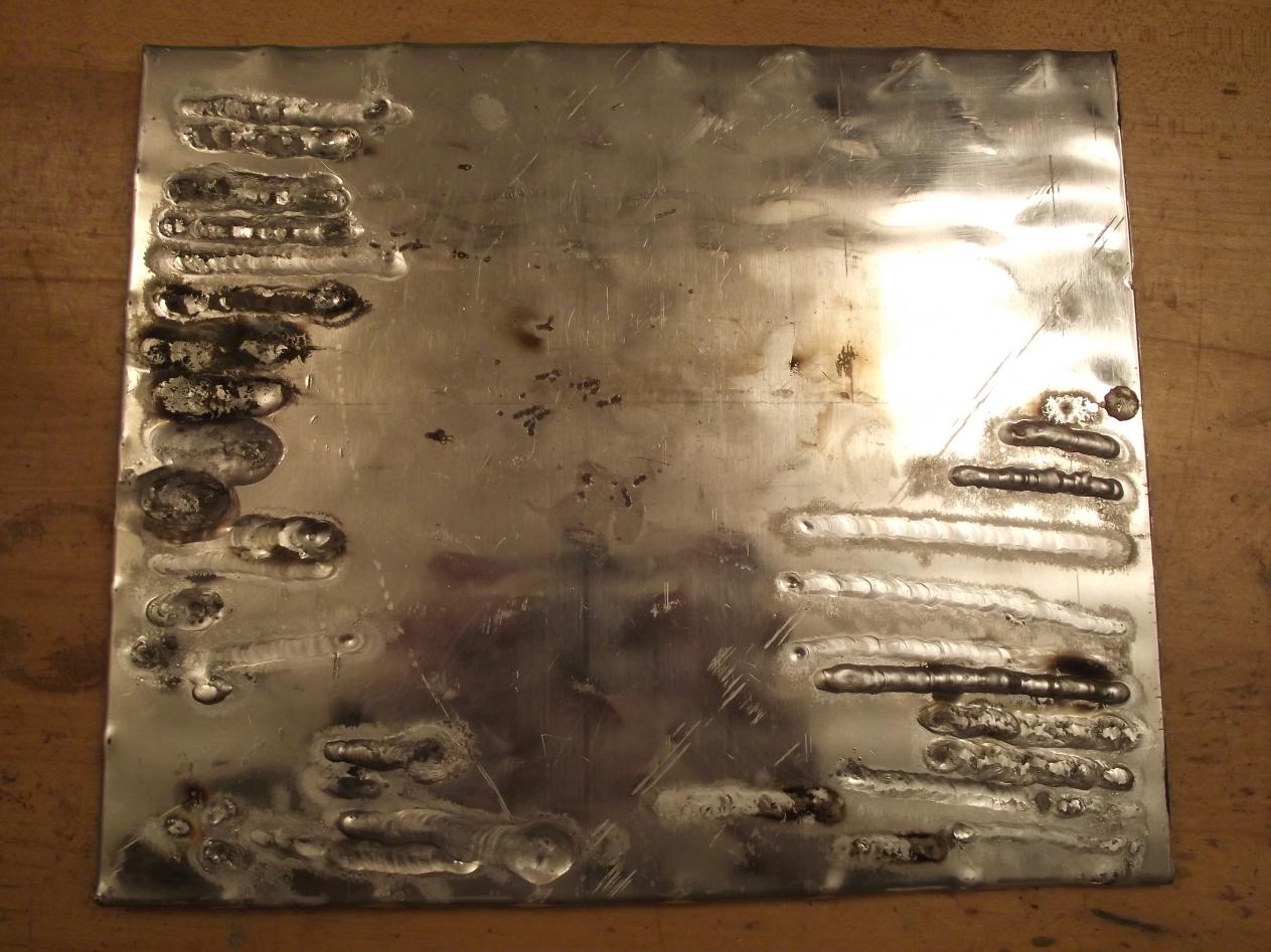

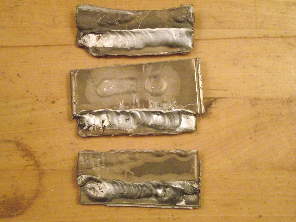

    I thought I'd try the "pad" that Jody recommends, but it quickly became clear that I need to RTFM some more (and get more practice). Eventually I got around to some lap joints. What is the cause of the sooty looking coating on lap #3 at the bottom of the photo?
    For the lap joints I scored a piece of 1/8" x 3" flat and broke off 1 x 3 pieces (roughly). The surfaces you see are all the underside of another weld, and all those pieces went from "shiny" aluminum to the brown discoloration. Is that overheating the base material? Controlling heat was a problem. The puddle would turn from fluid to ropy, and I was trying to recognize a pattern for what was causing it.

    Skip the joints until you can push a puddle and do some bead on plate welds.
    The black soot is likely caused by you touching the tungsten to the aluminum puddle.
    Did you clean the metal before starting to weld? It doesn't really look like you did. Try starting off with a flap wheel or other abrasive disc cleaning on the aluminum.
    What settings on the machine, what tungsten and argon flow?
    Was the ground clamp clamped to the workpiece?
    Once you get better, you can get away without cleaning the material as much and with more out of position and unusual joints.

    If you do tip the tungsten, resist the urge to just keep going. Stop and swap tungstens or grid off the aluminum coating on the one you dipped. It will make a big difference. Also grind or brush off the area of the plate where it went poof, and remove all the black soot, or just move to a fresh area. Cleaning action will break up oxides, but not much more. If it doesn't look clean, it isn't. Aluminum and stainless both have to be squeaky clean to get great welds. Do the grind/brush, then the wipe down with acetone. Also if your rods have been sitting around give them a wipe, too. If the rag comes back dirty, do again until it doesn't. Aluminum oxidizes up instantly after you grind it. The cleaning action will take care of that, but anything more, you have to remove before you start.
    Any idea of what your amperage was? Use a larger cup than you do for steel, and I would back down the flow like Sportbike said. A #8 will need about 7 lpm or so, more as you get bigger. I think tapping the pedal is a must or dial in some preflow. Either will do the same thing. You want to hear the argon flow settle down before the arc starts. How long that takes will depend on your setup. Usually just a second or so, but it's a sound thing, you can hear when the blast is gone and the flow is steady.
    Maybe use a little less stickout, so you can have the edge of the cup touch the work before the tungsten hits the puddle. That will help guide your height and keep the dipping down. Be sure to have a good prop and arrange yourself to be able to hold the torch steady.

    It looks like you've got some workpiece overheating going on with the small coupons on the right pics, with the heat running away. Counter-intuitively, the cause is using not enough amps (and traveling too slow.) Start with those small coupons close to room temp (not pre-heated) and move a little quicker with them to "outrun" the heat.
    The heat build-up didn't seem as much of a problem with the larger piece on the left pic. It looked a little cleaner as well. I prefer welding aluminum without the largest cup size possible... I prefer about a #6, or even a #5 works very well. Gas lens is not very important on aluminum, either.
    Practice getting a good torch angle, so that your filler rod doesn't melt before getting it to the puddle. Learn to recognize the puddle, and consistently and precisely adding filler, and maintaining proper torch angle. When you feel ready for a change, try the flat coupon joining (laps or butt welds with tight fitup are good. Tack both ends first, then weld the middle.) You could even focus your practice on just making good tack welds (it may not be easy.) Best tack weld needs to be not lager than your final weld bead is going to be (so you can make it disappear afterwards.)
    Keep at it... Doesn't look bad for a first go.
