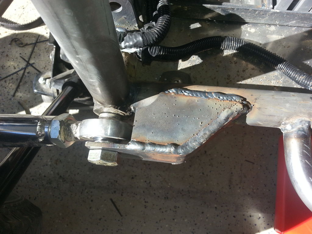

    I moved on to the rear suspension after that. Got the new arms in, but before I did I had to take them to another buddy and have him move the mounts backwards a few inches so the shocks would clear the frame.

    Added in some extra support for the rear arms and made sure everything was in double-shear.

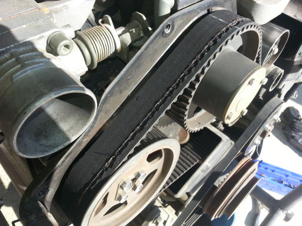

    Turns out I had a nut or bolt that fell into the timing cover and I didn't realize it. Tore up the brand new belt and the drivers side exhaust cam skipped a tooth. I put a new belt on it and it fired up again. Luckily no major damage was done.

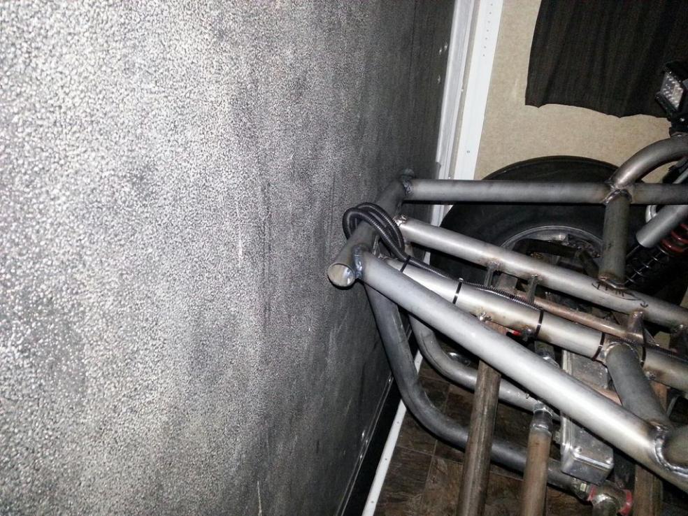

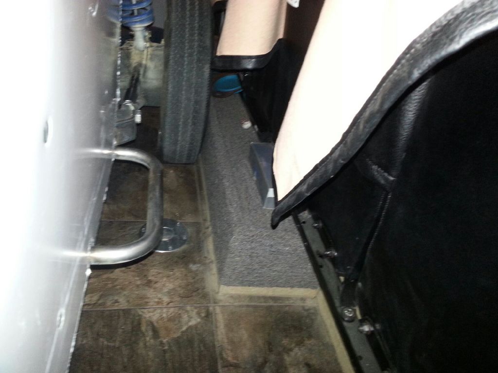

    Now it was time for the real test, does it fit in my trailer? This was really the only reason I built a buggy instead of buying one, because a normal 4 seater wouldn't fit in my trailer. With almost no room to spare, it FIT!

    When it slipped a cog, it could have slightly bent a valve just enough to keep it from building the power it needs.
    Mark may have nailed it here. Definitely do a leak down before investing in any tuning work. Even just some air pressure in the plug holes at TDC will tell you a lot.
    Either way, congrats on getting it out for the first time! That's the big reward at the end of all the work.
    How is your radiator mounted? Is it solid to the frame or floating?
    It was down on power before it slipped the tooth. I'm gonna do a compression check on it as soon as I find my tester, but I think a lot of it has to do with the exhaust. Radiator has two standoffs that slip into rubber gromets on the bottom, and two tabs that bolt to the frame on the top. Between the tabs and the frame I put a 1/8" piece of rubber sheet. I'll try to get pictures tonight, as it took me all weekend to finish the radiator mounts and get the gas tank sealed up. Dam pinholes in aluminum suck. Guess I just need more practice as aluminum welding. New tank holds 11.75 gallons with the sump, which is so much better than the 6 gallons before.
