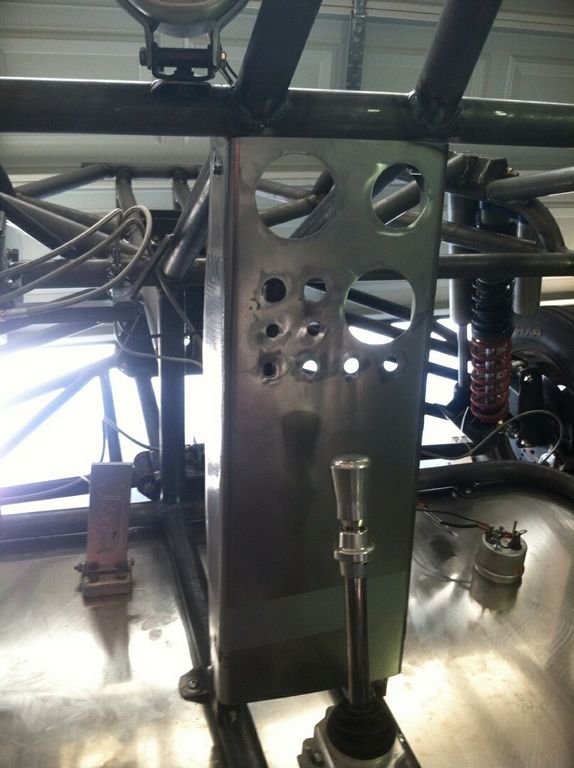

    Got to work on some of the electrical. I'm not a neat person and my buddy volunteered to help me wire it. I think the dash came out looking pretty decent. Eventually I'm going to have a pro redo all the sheet metal and put in a new dash, but for now this serves it purpose.
