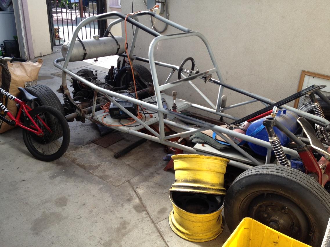

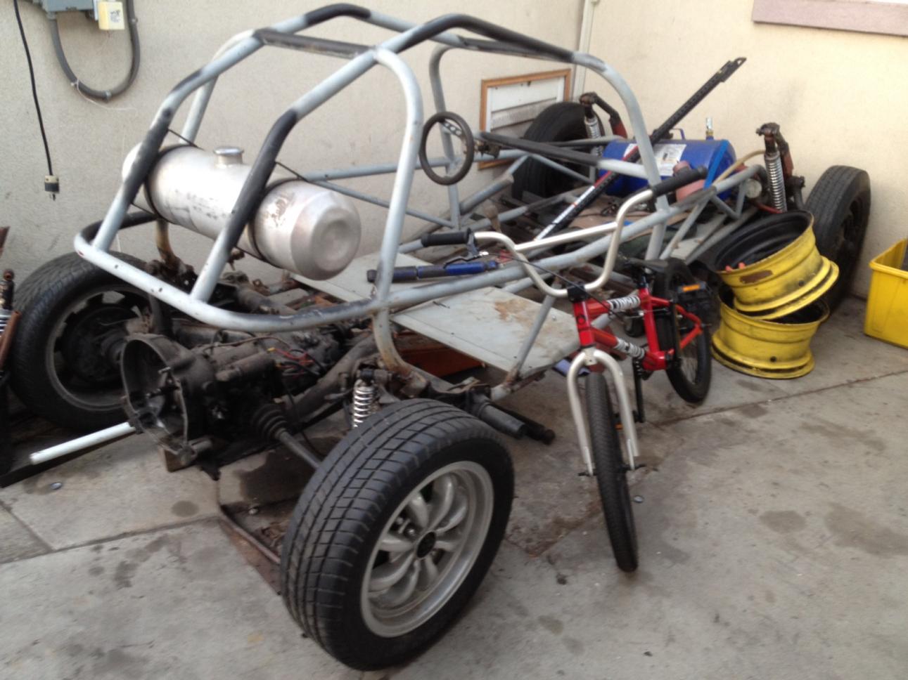

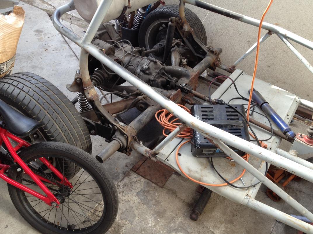

    I picked up a sandrail frame for a project and am going to be building it up over the next few months/years. I figured I would start this thread now and use it as a complete build thread as I make progress. This is what I'm starting with:

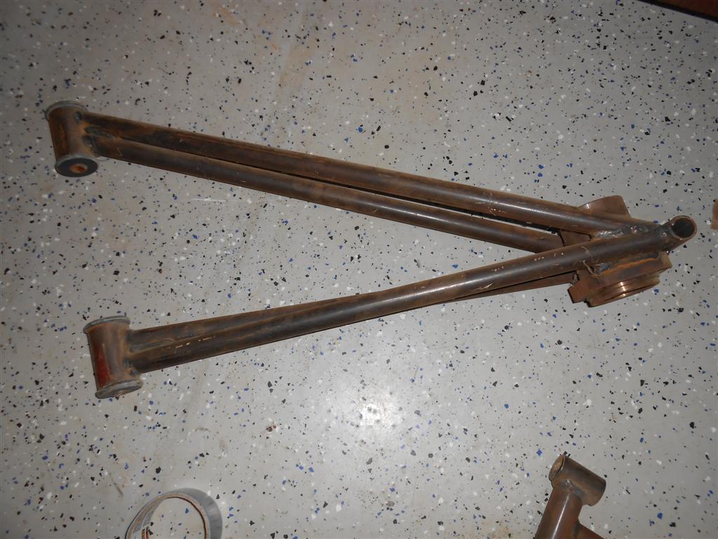

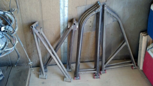

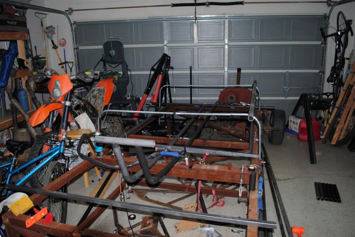

    The front beam and complete rear end are going away. I picked up a set of A-arms for the front, and 5x5 trailing arms for the back that I need to modify to fit the micro-stub 930 cv's that I want to run. I also picked up a complete 1995 300zx motor for the back of it. Came with all sensors, wiring and ECU, so it should be relatively easy to get it to run. It will need an exhaust fabricated up though, because the headers point the wrong way right now.
    The next part of the project was going to be building up a frame jig out of 2x2 steel tube. Just so happens the guy I bought the A-arm from has one made for his rail and he is letting me borrow it. Its a pretty nice 4x10 foot table, all 2x2 inch square tube with leveling feet and castors built in. Will save me at least a couple hundred on tubing and a bunch of time not worrying about making a straight table. I should be able to start cutting and welding in the new frame next week.
    EDIT* Also, if anyone needs one, I have a pretty stock 1600 dual port that I'll be selling with the entire IRS and trans in the pic. Let me know and we can make a deal.

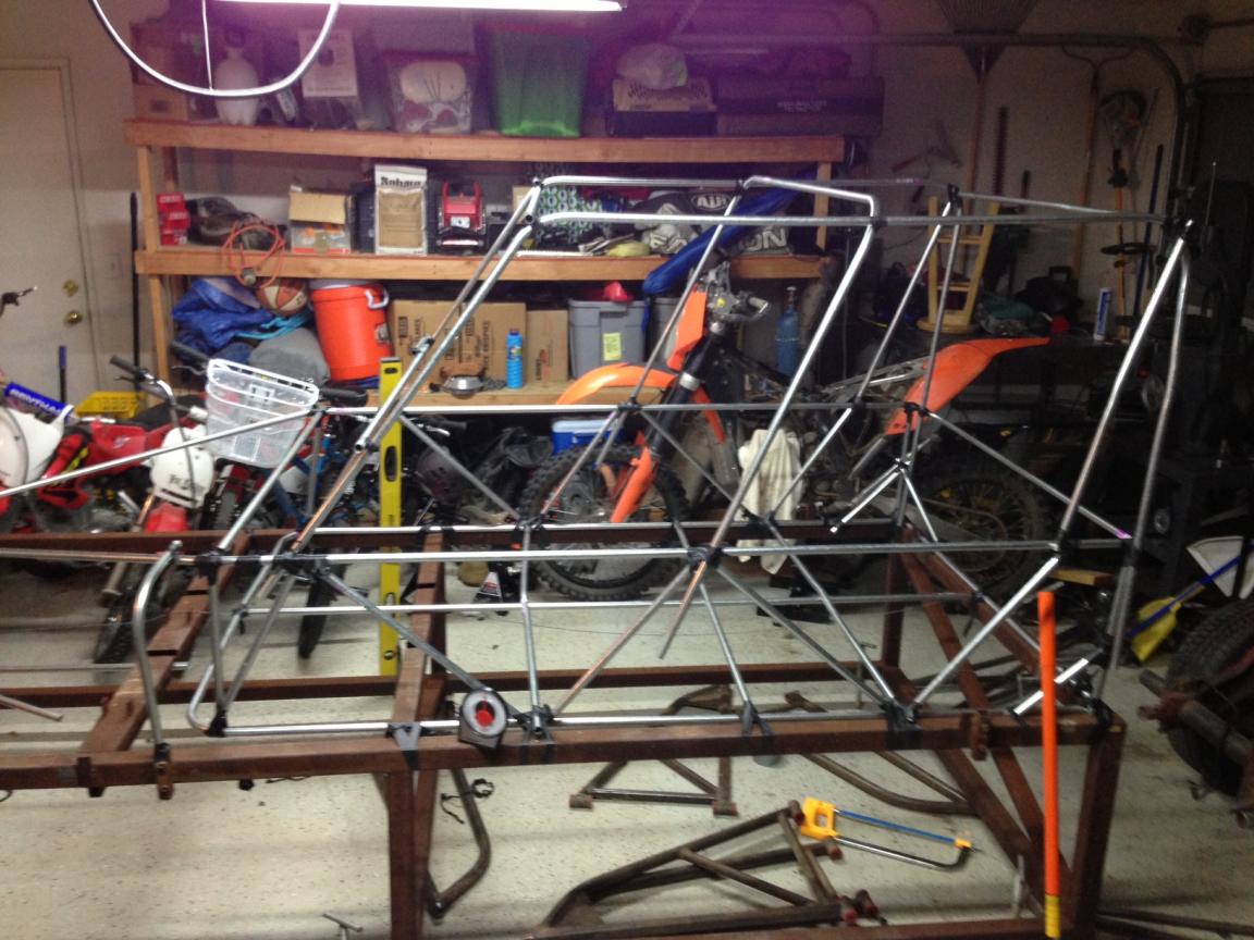

    Decided the other frame wasn't even worth trying to save. Designed one myself that should just fit inside my trailer. Started the mock-up in 1/2 inch electrical conduit so I can get an idea of what it looks like without spending real money on tubing yet. 100' of tubing is 17 bucks. The bender cost me the most and was almost 25 bucks in it self, but still worth it. I should be able to finish up the mock-up tonight and go pickup some real tube tomorrow and start cutting and bending.

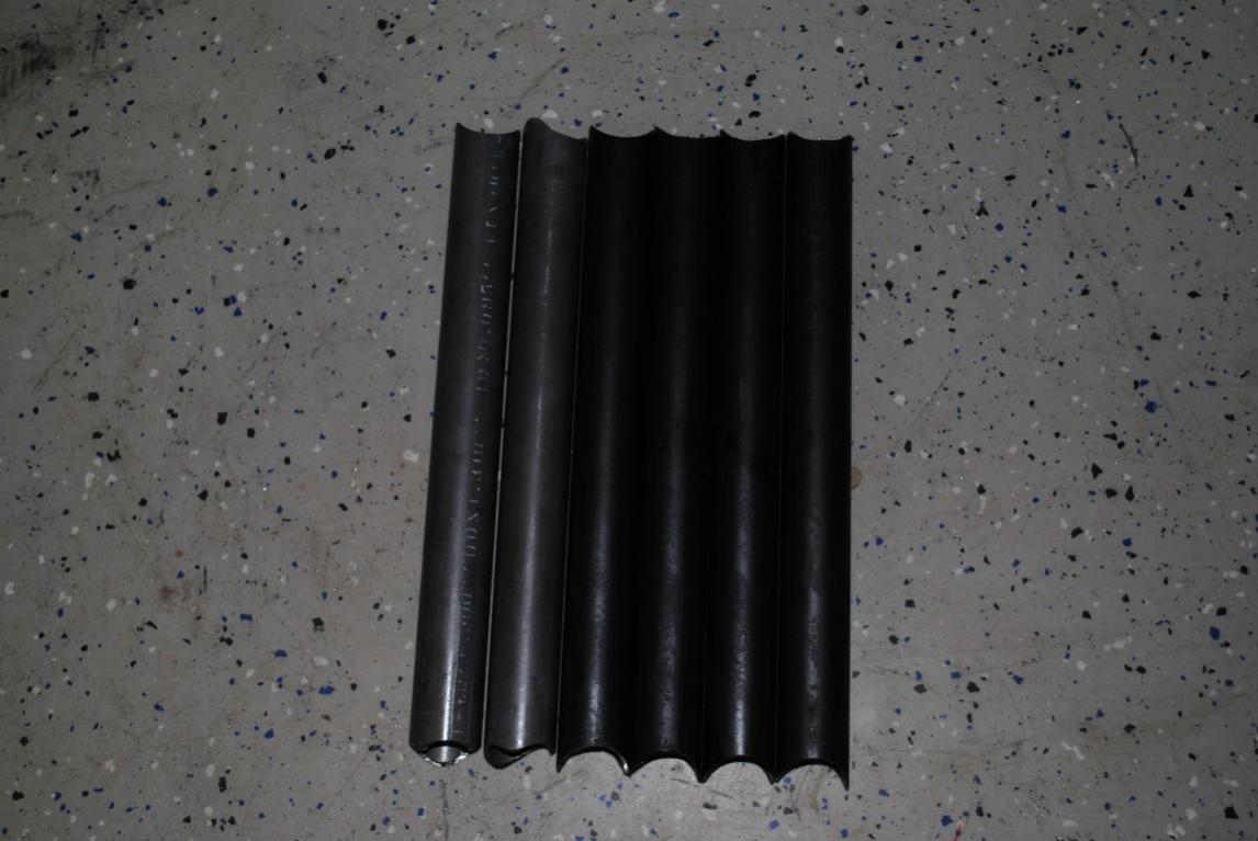

    Well, I tried to start the build a tuesday and it didn't go well. Got to the metal supply shop and they changed the price of steel on me. Over the phone they quoted $27 for a 20' length, got there and it was $40 for an 18' length. They said the guy on the phone quoted me the standard 1018 price and not DOM pricing, so the steel is going to be quite a bit more than I thought. I also mocked everything up assuming I could get 20' sticks of steel, because almost all the long pieces I need come in at just under 10' in length. Now that I can only get 18' pieces, I'm going to have to buy almost twice the amount of tube I was planning on, because I'm only getting a single 10' length instead of 2 out of each piece. There is another place that will sell me a 24' length, but the price is $75, so in my opinion its worth it to buy the 18' and have all that extra tube laying around. Also, they only had 2 18' pieces in stock, so I bought both of them and they said they would order more for me and have it in by yesterday.
    I also made my first bends in one of my covetted 10 foot sections, and screwed it up. The bends came out really nice and were exactly the angles I needed, so I was happy at first, but then I held it up to the mock up piece and found that my two bends were about 6 inches too close. After about an hour of trying to figure out what I did wrong it hit me. I scribed the tube where I wanted the bend to start, then loaded the tube in the bender backwards, basically putting the bend on the wrong side of the scribe. Steep learning curve, but I should have it figured it soon. I have enough lengths of tube left to get 2 or 3 pieces in place and tacked together, so hopefully I'll do that tonight/tomorrow. If I can get out of work earlier enough to go buy pick up some more tube I'll be able to get much further along this Sunday.
    The Parallelagram cage design will collapse on the first rollover. I would recommend flipping the "B" and "C" pillers to angle towards the "A" piller so your cage is in compression.
    The rear mid-crossbar has been moved back around 6 inches so the rear cage arms now come down at an angle like you suggest. Also, what isn't shown is that there will be an engine section added on to the rear so it will also have arms coming backwards at ~45 degrees off the top of the roll cage to tie it in as well. The "B" pillar can't be flipped because you won't be able to get in or out of the back seat, but the "C" and "D" pillars if you will will have the correct angles to suppost the cage properly.
    EDIT* The "B" pillar has also been brought closer to the verticle for better support as well.

    Ok, Good to here as i do not want to see anyone hurt. Can you at least make the "B" piller vertical? Are you going to "X" brace the "B" and/or "D" pillers?

    Planning on "x"ing in the top of the roof, and depending on radiator mounting location, will either box the C or D pillars. Also going to put a Y in the windshield tied into the front suspension points. Not going to x the "b" pillar, but I am going to gusset the a,b and c pillars with 3/16 plate, prolly just a simple triangle gusset with ~3 inch legs. If I take the b pillar vertical, it only leaves me with like 14 inches across the mid-rail to get into and out of the back seat. I know its a small car, but thats a little too tight. Leaving it at an angle gives me about 18 inches for both front and rear seats.

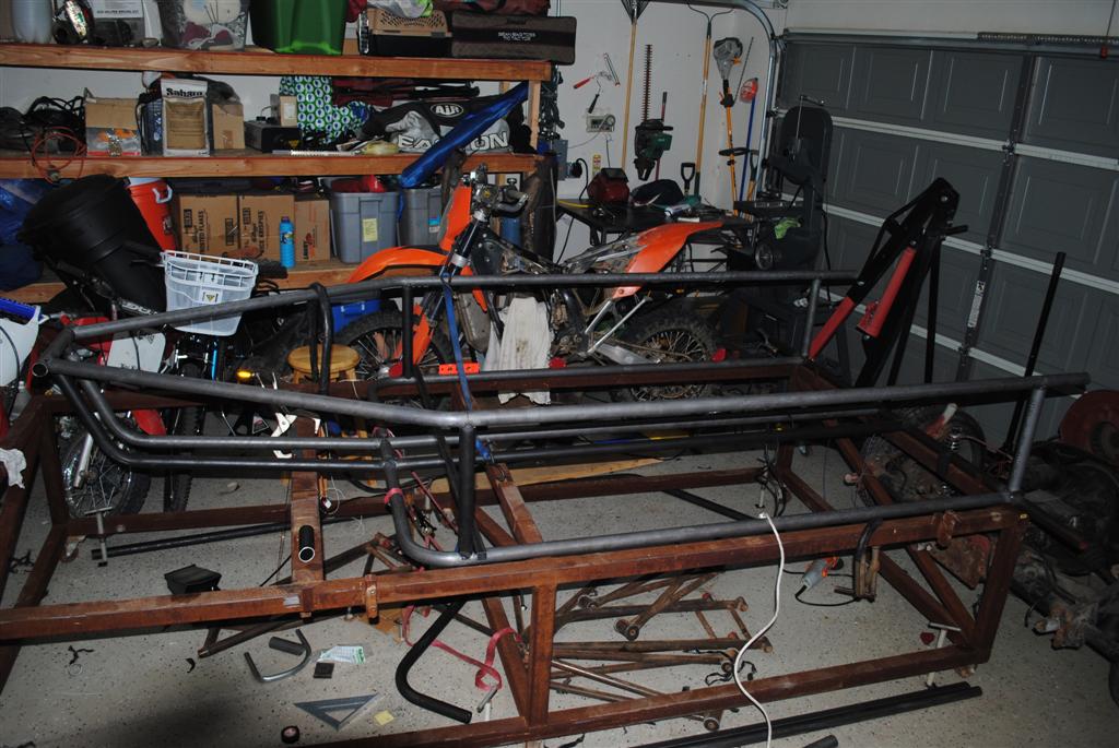

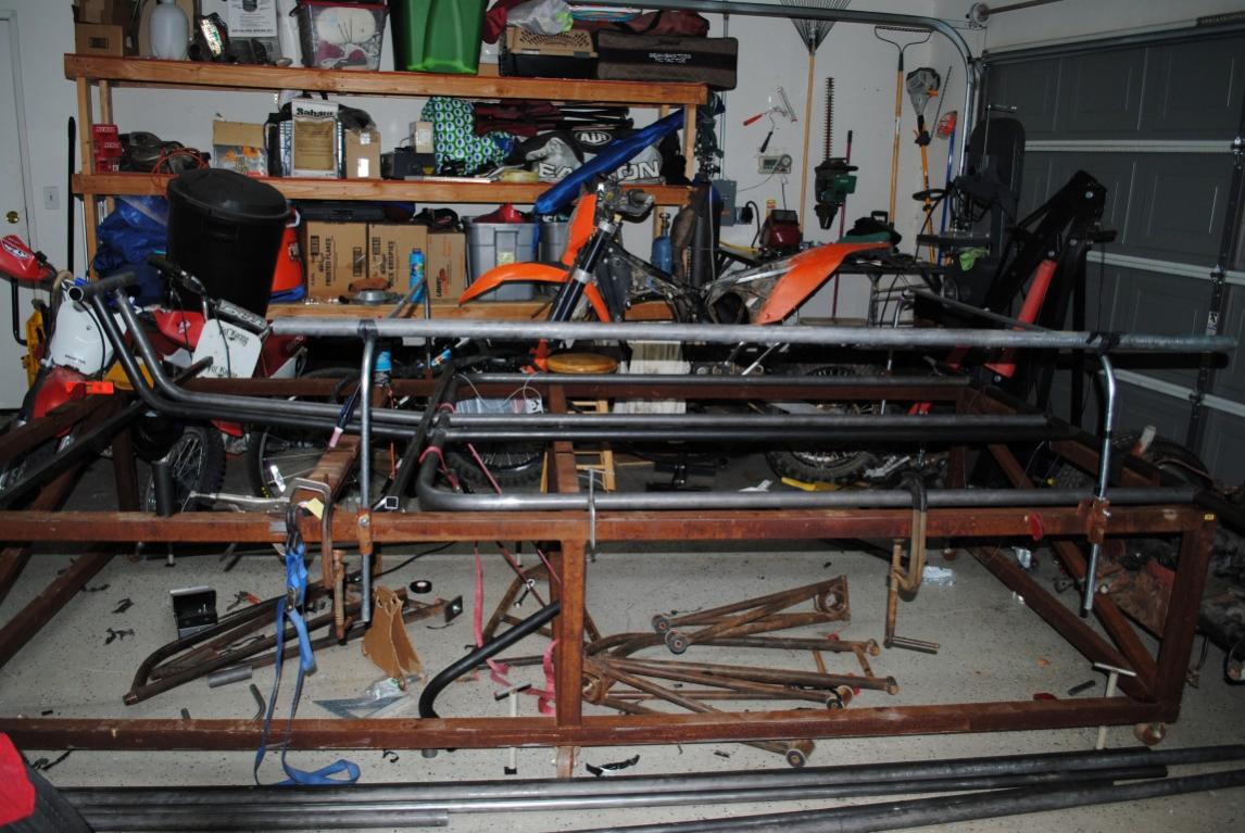

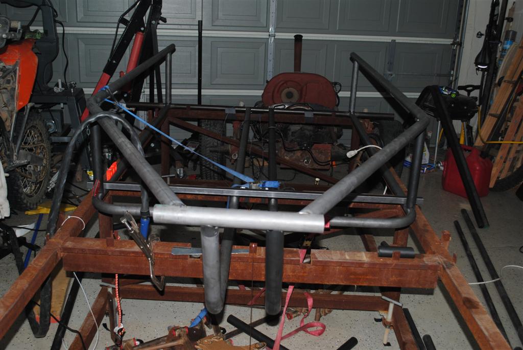

    Had to work saturday so I didn't get much done then, but I got quite a bit accomplished today. Laid out the bottom layer and tacked it together. Made 6 uprights to hold the midrail and got them all notched up. Tomorrow I should be able to bend the midrails and get them tacked in pretty quickly.

    Poewr I-Mig 205P
    Powertig 185

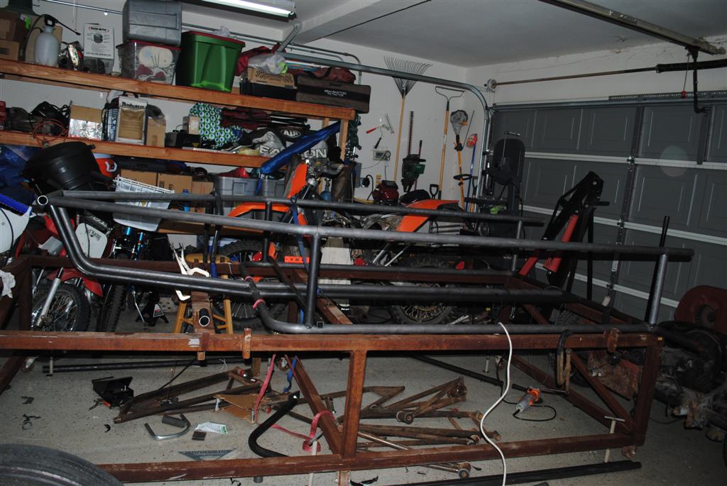

    Got the mid-rails tacked into place tonight.
