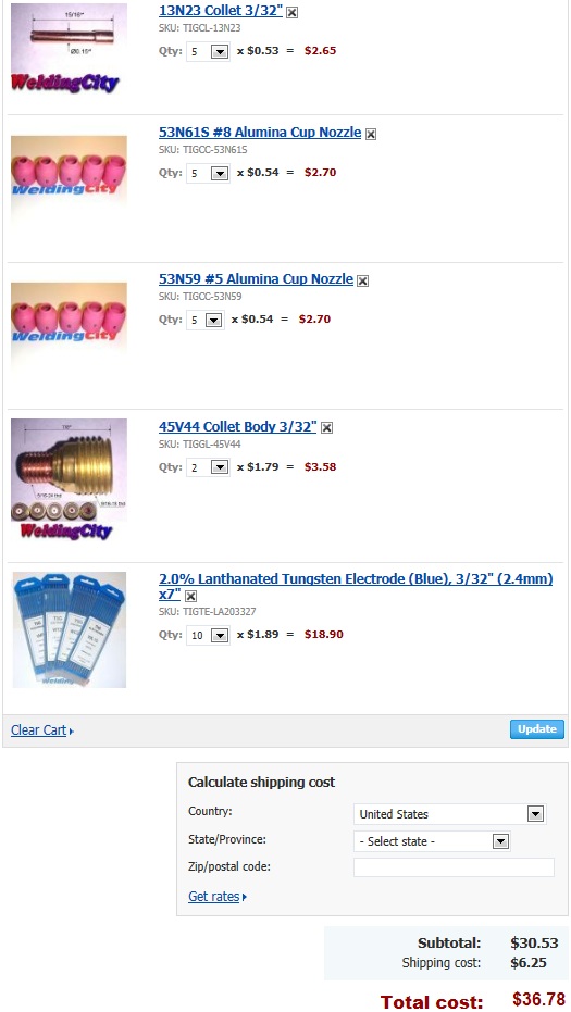

    I am new to TIG so more or less trying to figure out the little things that are needed. I had some classes a long time ago [like 40 years] so that will not be much help. Love the videos on you tube though. I can watch those for hours. Way better than my wifes Dr Phil!! I am looking at Part# AK-4-Pro, from arc zone which is a kit of various torch parts. Is there any compatibility issues with with the wp20f torch? I bought a 125 tank yesterday. I have the personal protection equipment already. Going to get a variety of different tungstens up to 1/8 as well as filler rod. Nearest welder supply is about 20 miles from here and hate to make a ton of trips. Money is not the biggest issue just yet but nearing the end of money I saved from not smoking in 2012.

    I would not buy that kit from ☠arc-zone☠ since you'll be paying a lot for parts you'll probably never use.
    Here's a list from weldingcity.com that will have you covered for a long time. Click image for larger version.
Name:	9_20 tig torch kit.jpg
ID:	9211 You can add the length back caps you need for $1.79 each.

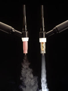

    Same to you phil. This mill is a variable speed. Fun to work on but not that much fun. It came with a static phase converter which basically provides for the 3rd leg with a bank of capacitors. This is at a loss of about 1/3 power. With a 3 hp motor I lose 1hp. I thought I'd try this and see how it works for me before changing it. The VFD's are nice though and will probably go with one on the lathe at some point[south bend 10L] but I need to find a 3 phase motor for that. Some day! Back to tig torch consumables. Thanks to Zoama for the tip[. I am interested in know what the difference is between say the gas lense you listed and a collet body [13n28] collet [13n23]? What is actually needed here with the WP20F? IS the Gas lense you listed a better system? Or is it an additional part to it? Just trying to understand the way these work. Also, I am anticipating learning to weld thin material[alum/steel/stainless] ,Is the 3/32 a "catch all" size? Or should I include another? Prices are sweet on the web site you aimed me at! When it comes to Tungstens ,are there any that should be avoided? In the sense that there could be low quality/problem causing sources? I checked tracking on the welder and it is out for delivery. Shop is warming up as we type. With 3 degree this morning it is a little chilly. Although I am anticipating a warm up to 13.
    The parts I listed are all you'll need to start welding. The gas lens simply replaces the standard collet body and gives better gas coverage. This pic shows a standard collet body and cup on the left and a gas lens on the right Click image for larger version.
ID:	9218 The CK push on style pictured looks different from the ones I listed but they work exactly the same. The gas lens ceramic cups have threads inside and screw onto the gas lens. 3/32 2% lanthanated tungsten will work well for most of your welding. The ones weldingcity.com sells are high quality 7" and the 10 piece box will last you a long time, probably years. I use these same parts myself.
