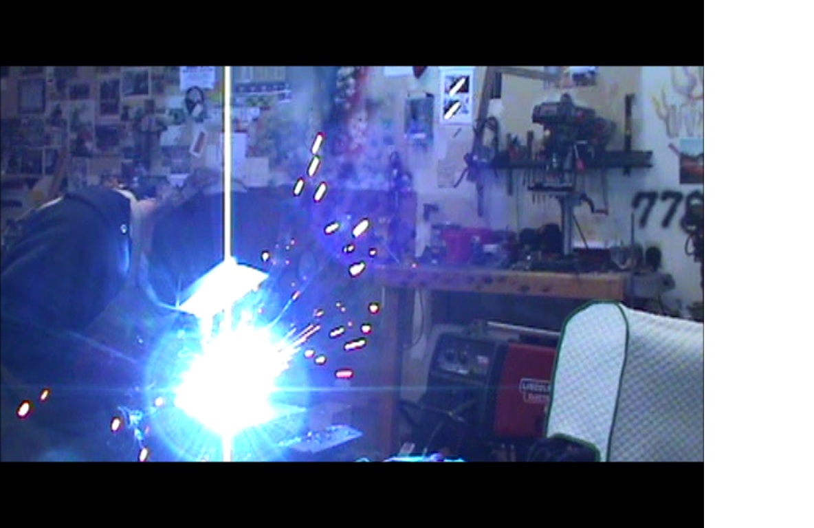

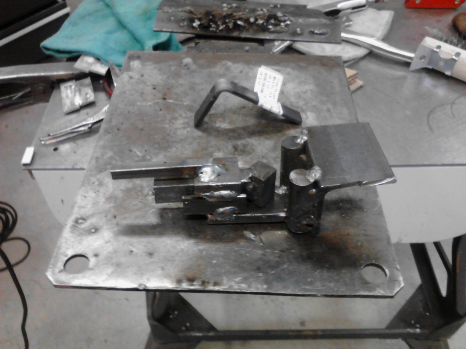

    I'll post a link to the video after I up load it to Youtube ... but this is a little tool I made for making sharp bends in flat stock the pictures aren't great but the video will give you a better idea ... the pictures are of me welding it, tempering the blade and a shot of it finished.Click image for larger version.

ID:	9162 It's made to fit in a vise and will give you a nice clean 90 degree bend in 1/8" stock.

    Mild steel doesn't have enough carbon content to harden or temper. The best you can do with it is to case harden the outside by cooking carbon into it with case hardening compound. Also if you do have a medium to high carbon content hardenable steel, there are are some that are air hardening, some oil, and some water, as well as a few special alloys that are dual hardening, meaning that they will harden in oil or water. You have to use the proper quench for the type of alloy. If you water quench oil hardening steel it will cause cracks in it, as the quench is too fast. The best way to test unknown steel is to heat it to critical temp, then quench in oil. If it gets hard you have oil hardening steel, if it doesn't, then do it again, but quench in water. If it gets hard you have water hardening steel, if it doesn't you have mild steel. The easiest way to test for hardness is to see if a file cuts it.
    Thanks Rambozo ... I wish you were here to set me straight BEFORE I posted ... just when I think I've got it dialed a pro steps in ... UR AWESOME! That's why the disclaimer ... ooops! I feel so small ... should I delete my youtube post?

    Rambozo I've read your posts for a long time and I respect what you say ... on the other hand what I have done ... I've tested and it works ... that's my only indicator ... I respect you're opinion and vast knowledge ... I truly do wish I could consult with you before I post ... then perhaps my confidence would be more intact. Thanks U ROCK!

    Railroad spikes are typically .12% carbon, with "High Carbon" versions being .30%
    Neither one is really a "high carbon"
    Leaf or coil springs shoudl be a good candidate. Torsion bars from trucks should be as well. Maybe rear drive axles.

    Yeah, the home knifemaking guys have a lot of info on different steel alloys used in lots of things to be recycled. A few make Damascus type knives out of timing chains (no idea the carbon content of them). Gears are a good source for high carbon steel, too. Try to learn spark patterns from grinding. I can't say I'm very good at it, but it would be a useful skill to have. If you get a few samples of known alloys you can use them to compare spark patterns. Also gunsmiths have a ton of info on heat treating different kinds of steel for different purposes. Remember that just heating and quenching will make high carbon steel glass hard and just as brittle. Drawing back or tempering it is what lets you select the strength and hardness. You need to learn the colors of hot steel from straw to deep purple black, so you get the desired results. That is one of the advantages to case hardening mild steel, you can have a hard surface, with a soft core that won't break. Again the knife people will often do selective hardening to make tough blades that won't bend or break. You can also anneal high carbon steel back to a soft state for machining or forming, then harden it and temper to a finished state more than once.
    And depending on use not everything has to be, or even should be hardened. For a home shop I would guess that a mild steel bending die would do the job fine. After all look at how many are just welded up angle iron parts.
