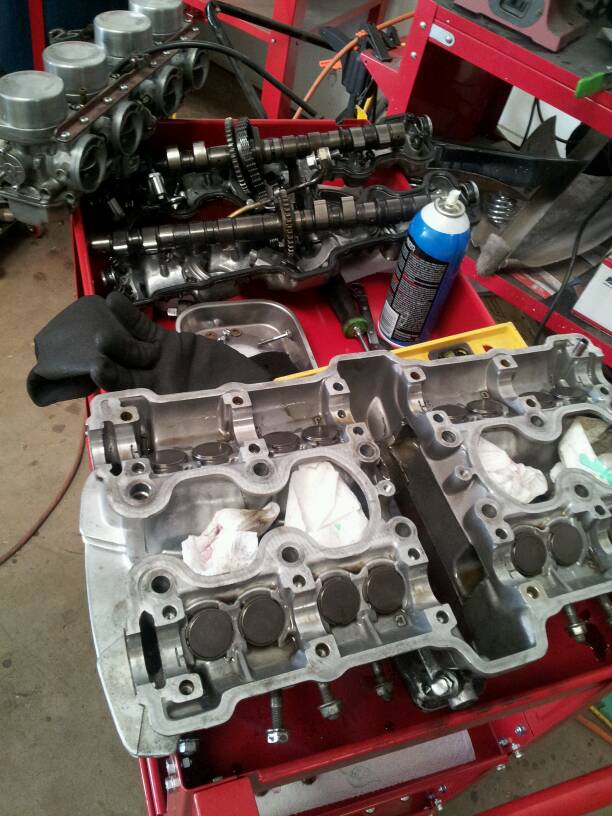

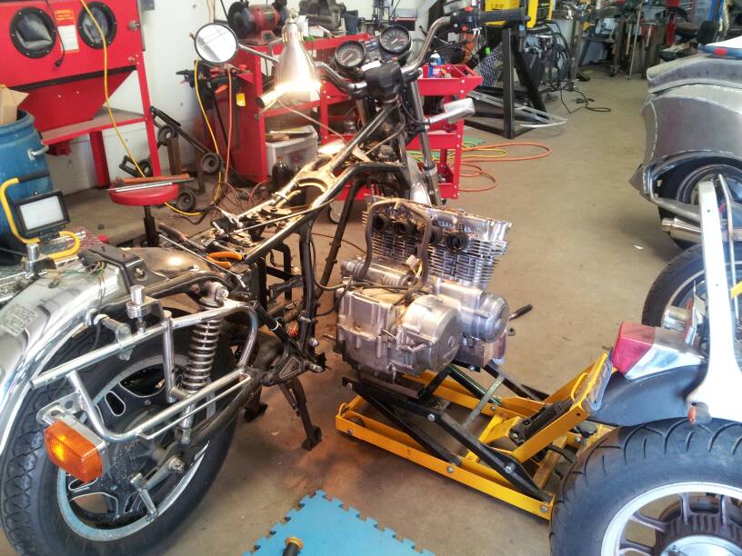

    So, a customer brought in his bike because it was bogging out.
    it's a 79 honda cb 750 in great condition. only 8100 miles on it.
    It had been garaged for a while, and another shop 'did some work to it' to get it up and running. I found a really bad intake leak because the carburetor set was installed crooked and while the intake boots were replaced, the 33 year old clamps however, were not. Did a compression check, failed. leak down test, leaking head gasket... boo.
    This other "shop" rebuilt the top end... but they sent out the head work to a machine shop... i know, because the head rebuild is the only thing that was done properly on it. Head gasket was improperly seated (read: they didn't. just torqued it and sent it off), cam cover gasket leaked around the caps at the end of the cams, carburetors installed crooked so they leak, and when they adjusted the cam chain tensioners they didn't tighten the adjuster lock nuts down, do they've constantly been pushing too hard into the cam chains. luckily, there's only a couple hundred miles on it, so no real damage done.
    It's not hard to do good mechanic work. You just do it right... that simple... it's not like it 'may or may not' work. when you do the steps to fix something, do *all* of them, in the right order, and in the correct way, it works. Simple as that.
    irks me, is all. On this particular type of motorcycle, removing the head means pulling the whole engine out of the bike because it lacks about 1/4" of clearance to get the head off the studs with the motor in the bike. Now there's a bike with the motor pulled out, with the top end disassembled, having nearly brand new gaskets and parts taken off of it and replaced all because some ham-fisted mechanic decided to cut all the corners they could and shafted their customer... for what?

    Some pictures of the aftermath.

    If you need any parts or build advice on them, Contact Jay Esbach at APE Race Parts. He started his business on early 70's CB's. I'm sure he still has parts for them and would love to help bring one back to life. That one looks to be pretty straight forward, but if you need anything hit him up. www.aperaceparts.com
    oh, this is an easy bike to work on. Made even easier by the fact that the dealership screwed up the head gasket when they replaced it, so it came right off in one piece. No gasket scraping required... The copper compression rings weren't even set right so it looks like it had never been used.

    Update...
    Got back into the rebuild on this guy today after the long weekend and realized that the previous "tech" used rtv on the head gasket around the cam chain housing between the 2nd and 3rd cylinders...
    Guess which cylinders were leaking compression into the crank case: 2 and 3.
    Rtv is not for head gaskets.
